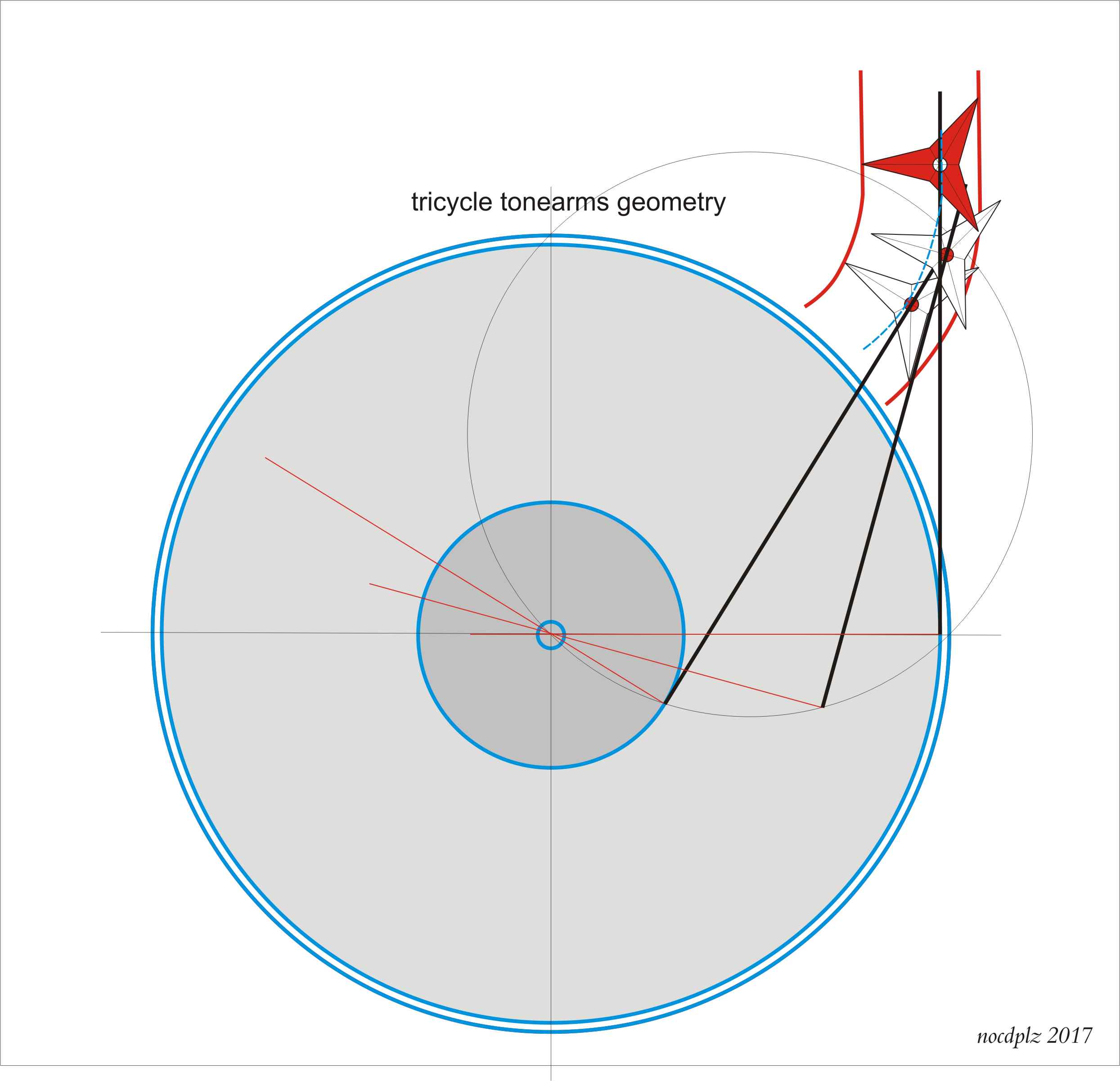

I can not calculate them, so I've got it graphically (my graphical program allows to rotate complex objects at any chosen point).
Doing so i've found that the center of bisectors does not work, while the center of the circumscribed rectangle is ok. Do'nt ask me why: the wheels bring a different basis in every point of the curve: really complex.

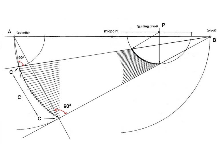

Dear 2wice, that's what i'd found in my graphs. (attachment) And it's drawn considering just triangles, not wheels! Since you did the math of that curves can you explain to me? It was shocking for me.
I've read (#1133) that you made a mechanical model on 3 jewel bearings on a rigid triangle, tracing 3 guides: can you show us the results? have you got problems?
Since you use the Thales semi-circle, I'm surprised that the three black lines do not converge to a single point at the edge of the circle. The inner two lines seem to be right but the outer line crisscrosses with the other two. I'm baffled. 😕
In your next drawings, can you add a straight line from the spindle to the converged point for easier illustration?
Oh, I see. The outer black line's other end does not touch the Thales circle. Never mind. Duh!

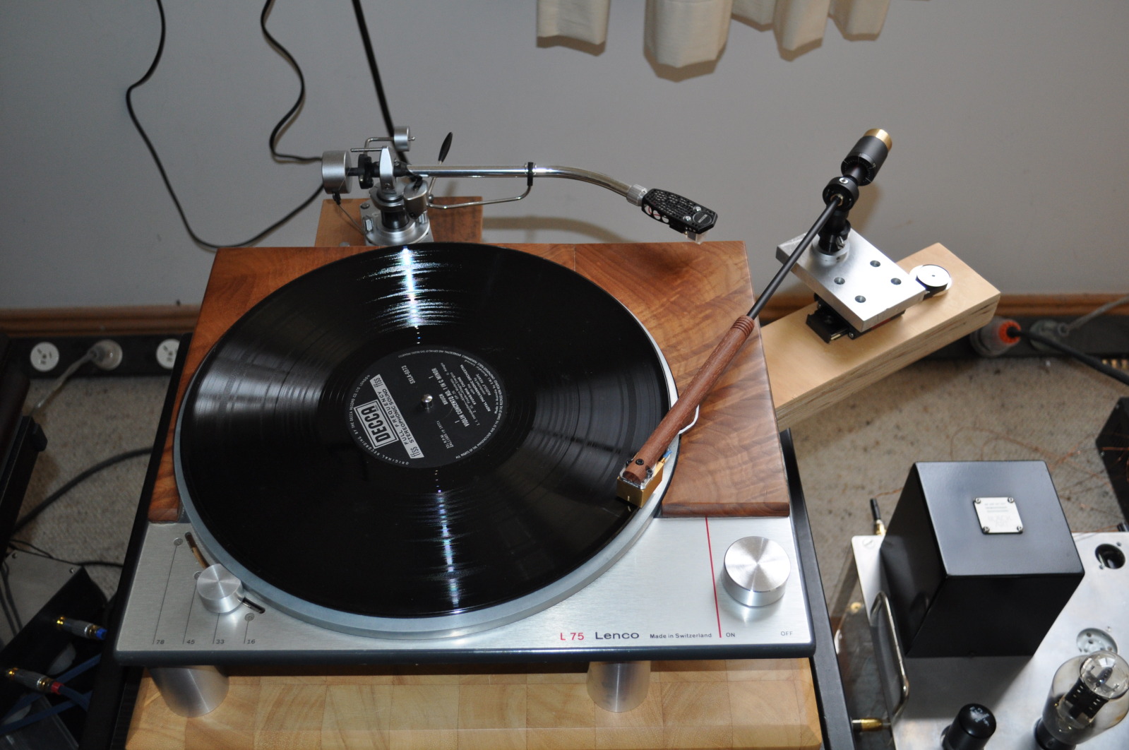

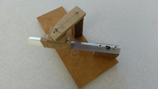

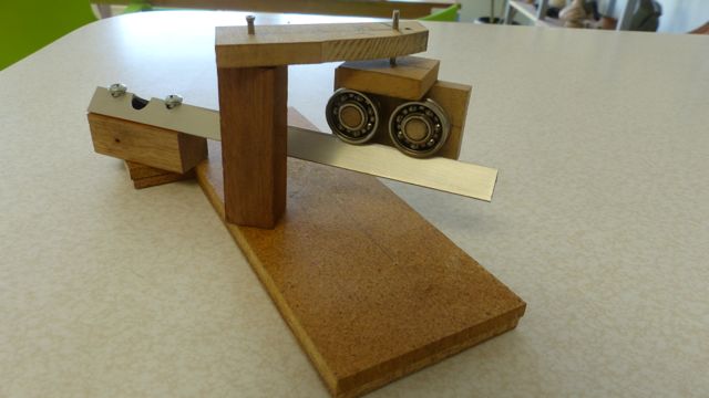

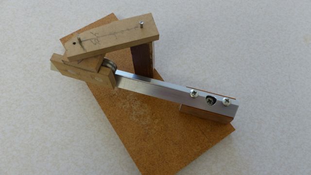

DD, Is the model in the photos something close to your split plane idea? The geometry will work, but the construction comes with all the usual caveats about bearings, precision, etc. I haven't included the front arm, vertical bearings, or headshell.
If I made a serious attempt at building this one, I'd sling the bearings under the track so it would be supported at two points including right under the vertical bearing housing and close to the CW. I'd probably steal some ideas for the bearings and track from our passive linear tracker friends.

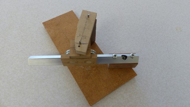

I think you got the idea. It's not how I visualized it but the concept is similar. I thought of using two rollers on axle acting as carriage AND vertical bearings. Below is something I rough sketched up a year ago using a string as the guide since the stylus is always moving forward. But my friend told me when encountering eccentricity the string might slack and create problem so maybe something with rigid like a thin carbon fiber rod as guide. It's probably better to have the main arm under the track like your suggestion. Again, this picture is from a year ago and I might do it differently now. But since it's the only sketch I have so I posted here. I wish I have the graphic skill like Carlo's! And yes, taking idea from other genres of arm is beneficial to any DIYers.

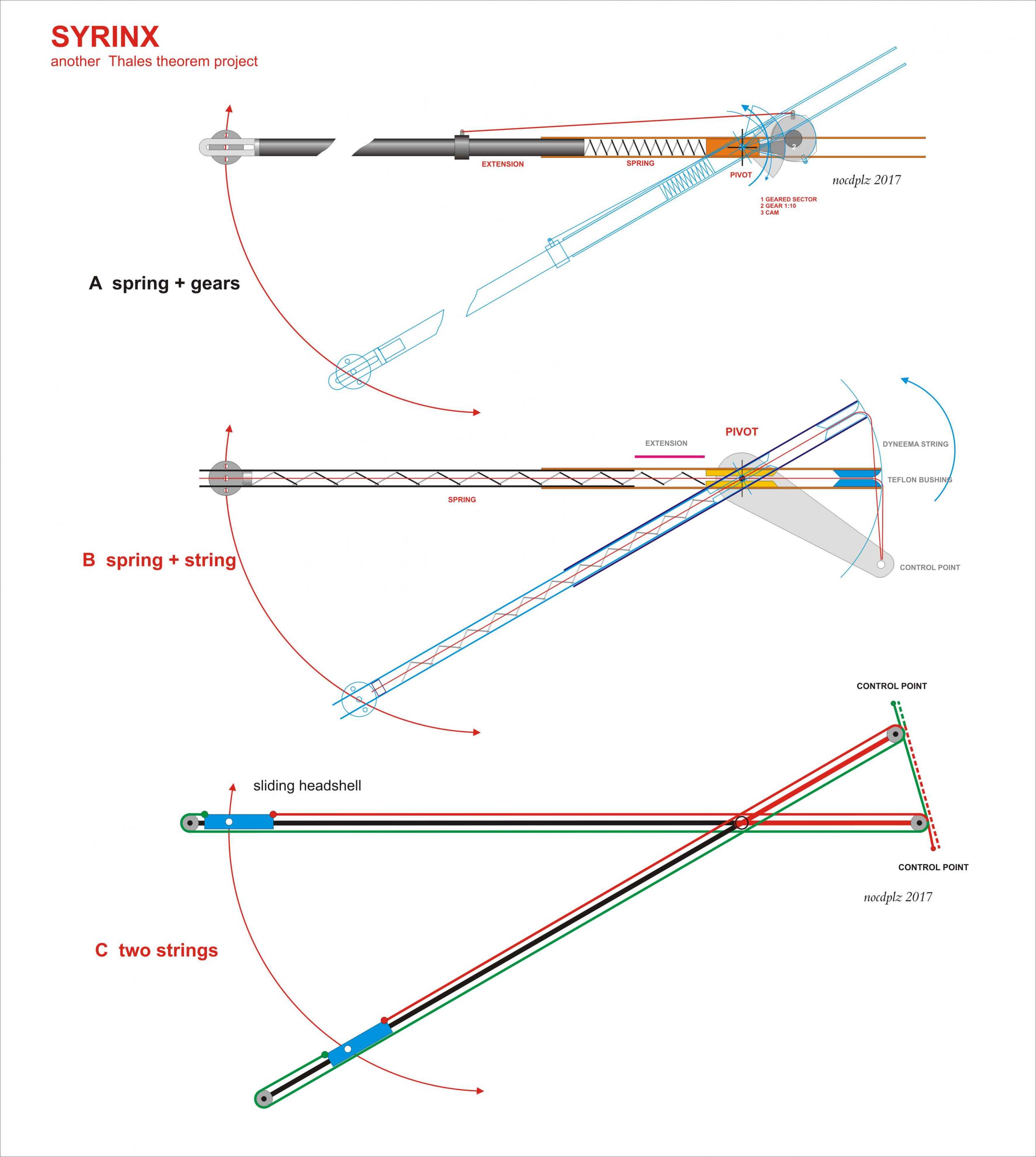

Dear Direct driver, beautiful paintings are hanging in museums: we need just drawings that clearly represent a project. Your is so good that now i can see what I could not understand from words. This is the essential: a clear drawing is also nice, a nice one that can not be understood not only is ugly, it's stupid!
It seems that the tricycles were abandoned (after my tests, I understand why!) for an extensible Thales? The separation of the planes is indispensable for not having VTF variations, isnt it? great!
I'm still in doubt to entrust the movement only to the stylus drag, a very weak and very variable force. I'm afraid that if we can reduce all the frictions of the pivots, the stylus will overcome the tangency point until bending prevents it from going further: so we will have again the tracking error and the skating we wanted to avoid.
Working on mine, after a first mock up of B solution (incredible, it elongates with just 3 grams! so, how weak must be the spring in a well built tonearm?) I came to this C, with two strings.

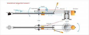

Correctly interpreting your drawing, Dd?
flanged bearings may avoid strings?
Brilliant! Thanks Carlo for visualizing my thoughts. Your graphic skill is such an asset to this thread!
Some thoughts on the arm:
From an ergonomic standpoint, the main arm should be at least 6" long so the counterweight is not touching the platter, unless you have extra wide platter a la EMT 927. You can of course make it extra short like the Trans-Fi arm or other airbearing short arms and make the counterweight not low hung. I originally wanted the main arm long enough so the vertical bearing is on the same plane as the platter to have consistent VTF. But a shorter arm has its benefits too. It's a designer and user decision.
Having the horizontal carriage above the main arm makes any guiding system easier so the main arm is not in the way of strings or rods or magnet or whatever. This is really taking the Dynavector 'split-plane' idea and give it a twist. The horizontal bearings have a hole that wires can thread through or make a plug so user can swap out arms. I want the main arm and rollers able to be detached from the horizontal rails so it's easier to mount cartridges. Or you can make multiple arms+rollers pre-mounted with different cartridges for flavors.
The roller design can be other bearings like pin wheel bearings or even make the main arm vertical movement completely independent from the carriage. I just like the simplicity of forward movement AND vertical movement accomplished using only two ball bearings.
The arm-lift is tricky though. Because your pictures have it installed on the horizontal bar that it has horizontal movement during play and if you're not careful you can swipe out and destroy the cartridge! It has to be a two hand operation: lift cartridge up with finger lift and then apply lever to hold arm in tilt position. There should be a more elegant solution. Thinking....
The guiding mechanism needs elaboration. If we use a single string, the tie point has to be at the mid point of the axle to comply with the Birch geometry. We can drill a tiny hole through the axle midpoint for the string to pass through with a tied knot at the axle end going to the other tied point. As I said, eccentric record can possibly create slack in the string and lose tension intermittently and that can cause problems. I think your two string approach can be adopted into this design just as Doug's approach can be also adopted. I think the fun part of this kind of design is to come up with creative ways to 'cheat' the geometry. 😉 Conceptually, it's pretty simple: we must make the arm move forward and/or extend longer as it tracks closer to the spindle and the Thales semi-circle is our guide.
Another approach using only pivot bearings instead of linear bearing is to use a parallelogram for the top horizontal part. You will end up with at least six pivot points instead of two rollers. It might look too Rube Goldberg though.
