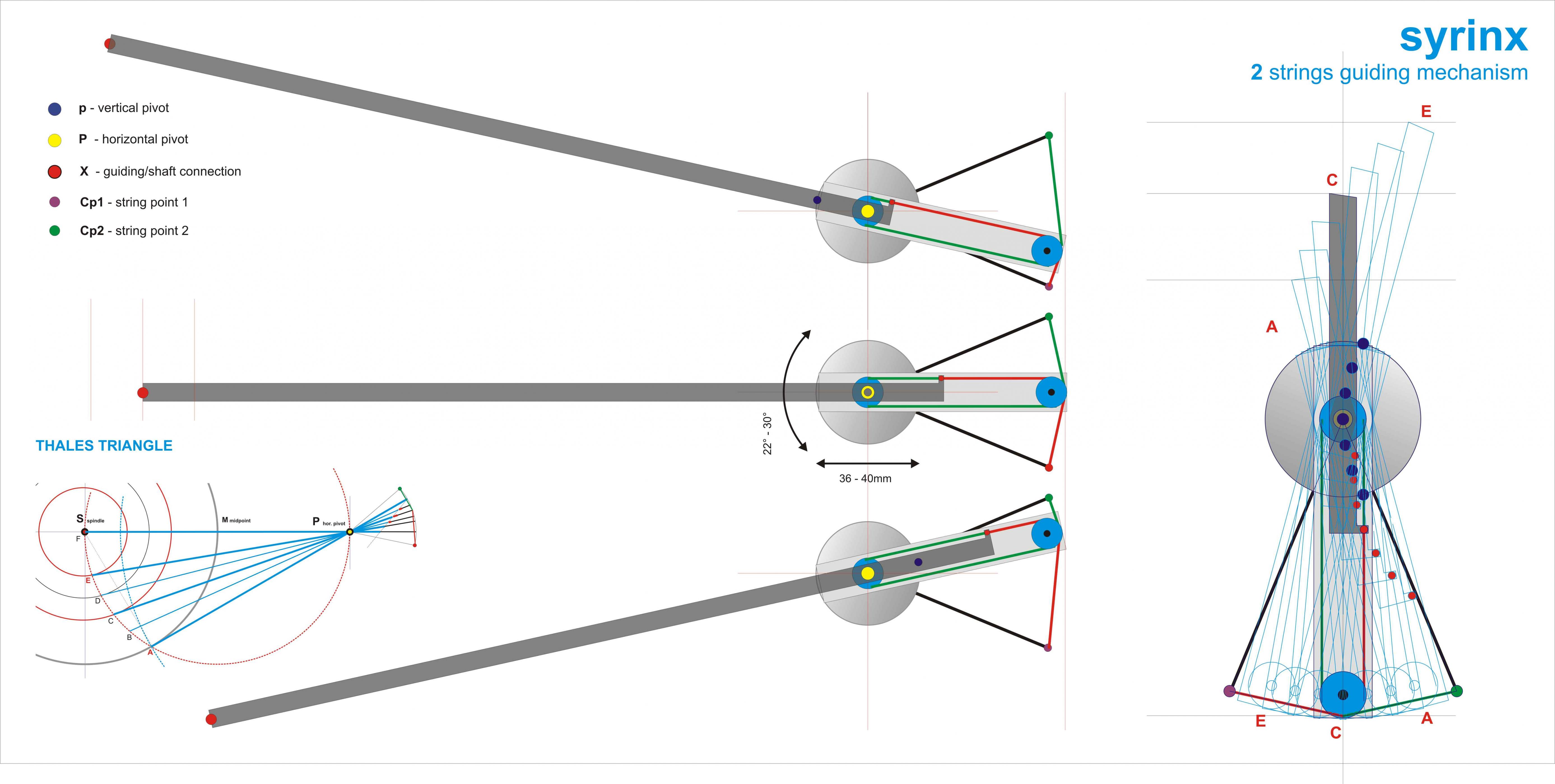

Hi all. Impressive debate on this arm, thank you for all the helpful contributions. An extensible arm is the most obvious consequence of the Thales triangle, and the driving system is a 1: 1 hoist, used for thousands of years to move objects. But simple things are sometimes like "the purloined letter" by E. A. Poe. Easier to find for a child than a detective.
Some posts made me think that my drawings were not clear, so I did a new one, hope better. Unlike opinions, graphics may be verified: a good advantage for all, author included. (thank you Doug, great work, now waiting for your advice).
I've previously said what was to say about my project, possible advantages and residual doubts: this thread deals with geometries and this I've tried to do, searching solutions for a zero offset, and a proper geometry for skating.
There are still around what Ray defines arm's problems, which maybe do not generate skating technically, but similar issues. I have some ideas where to look, but I'm glad to leave the hunting to experts, better if armed with graphics.
Of course I also have my opinions and my myths: eg. that azimuth is most relevant than the tracking error (just look at the shape of a stylus) eg. vectors breakdown, eg.that getting the needed side force (not too much) from offset is not stupid at all. (post #1241)
So if this arm will sound like a good Baerwald for me will be a great success . As 2wice rightly said, the goal, and pleasure is to experiment, not to make the best arm in the world at home
ciao - carlo

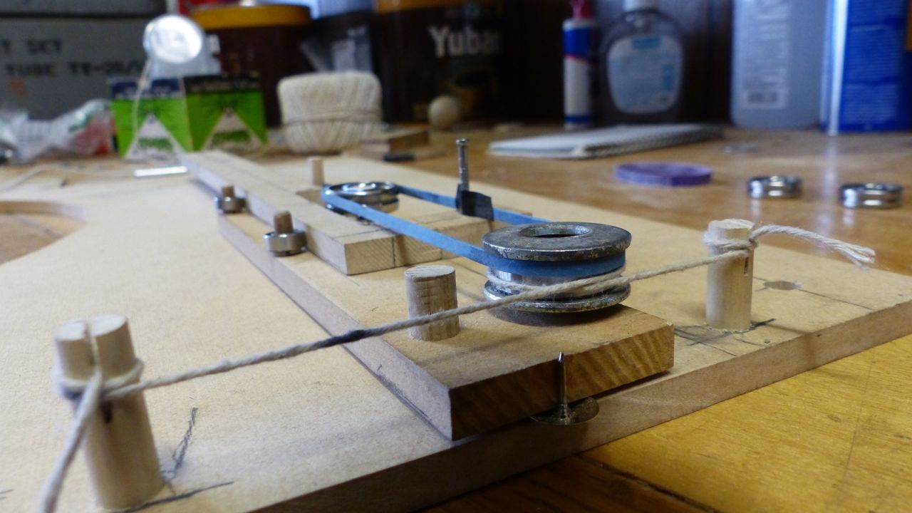

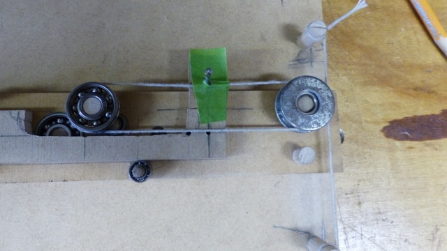

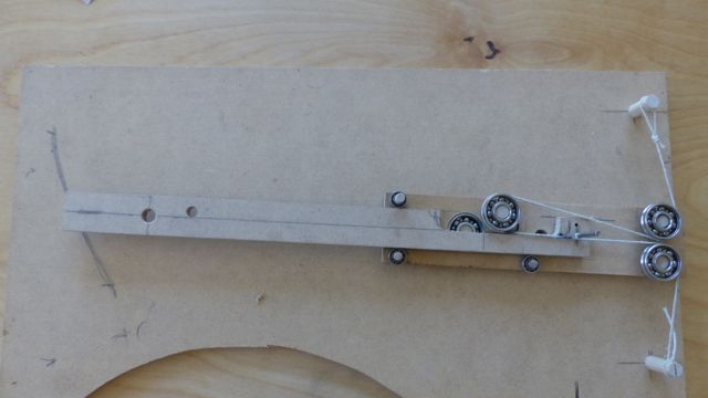

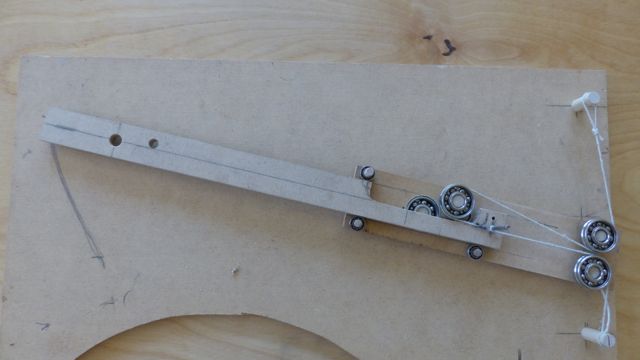

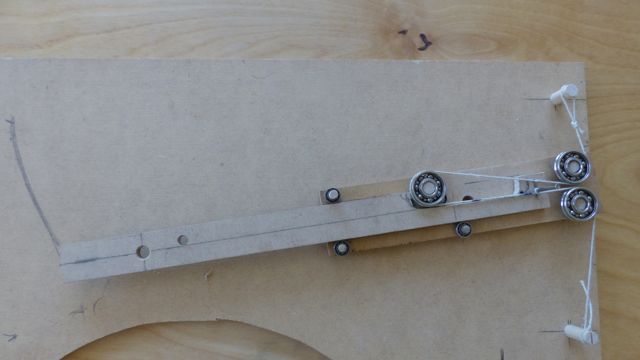

I built a rough interpretation of Carlo's very interesting design. The extension mechanism seems to confirm his remarkable drawings.
Would you please perform the string test of diyrayk on it? I bet it would skate.
Dear Alighiszem, let's see if I did the same reasoning: if the arm rotating elongates (1.3mm / degree) it also must be true that elongating it will rotate = skating.
But: the side force generates the torque which then converts rotation into translation with a 4: 1 advantage (ratio between the two levers). The rotation due to the stylus drag would happen inversely, so with a 1: 4 disadvantage.

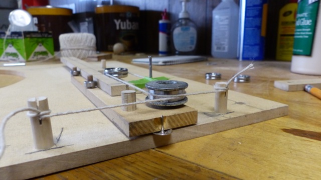

I don't think the arm will skate at all. However, the string and pulleys will produce too much friction. The tighter string is, the more accurate the cartridge position is. Tight string will generate too much friction. It will put too much distress on the cantilever although I have to say it is a clever design.
Carlo,
I did the string test. The model rotated and extended very well despite considerable friction. It also "failed." I'll talk more about that in another post.
It may be possible to use two bearings instead of three for the extender. I found that moving the string connections behind the rear edge of the bearing helps reduce tension and bearing load.

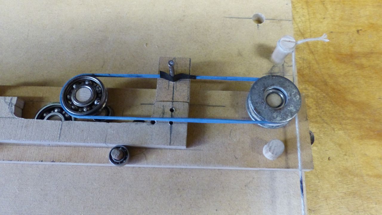

My own concern about string tension and super10018's question led me to the rubber band idea in the second set of photos.
Super10018,
String tension is a concern. I found that the string can be a bit lax without causing problems for the model. Real life? Who knows? I considered a tape or belt and your question prompted me to try the rubber band. It works, but again -real life?
Super10018,
My model of Carlo's design "failed" the string test as did the other six PLT arms, including a Schroeder clone, I tested.
Although I've argued otherwise, there seems to be a consensus, supported by Frank Schroeder, that the DIY PLTs here skate, but the point, the challenge, of this thread is passive pivoting tangency, not skatelessness, so unless there is a claim that skating indicates tangency failure, I'm not sure I understand why that hobgoblin keeps raising its head.
Pivoting LTs have been designed and built to move to the right and forward simultaneously and continuously when force is applied at the stylus. So when a string is attached to the front and pulled, they move forward and to the right. It's what they are supposed to do. If pulled from the front, they move right. If pushed from the left, they move forward.
Failure, for these arms, is to not do that.
I believe the apparently simple string test is a poor indicator of stylus drag because, like most analogies, it leaves out important details, some of them contradictory. For instance, it's badly out of scale in direction, and magnitude. In addition, it can't address the time factor, and, most importantly, doesn't isolate stylus drag from the other forces working on the arm.
To the extent there are skating problems for PLTs, there are very likely good solutions. Maybe the posters who have thought a lot about the problem could analyze the particulars of PLTs and offer their ideas.
