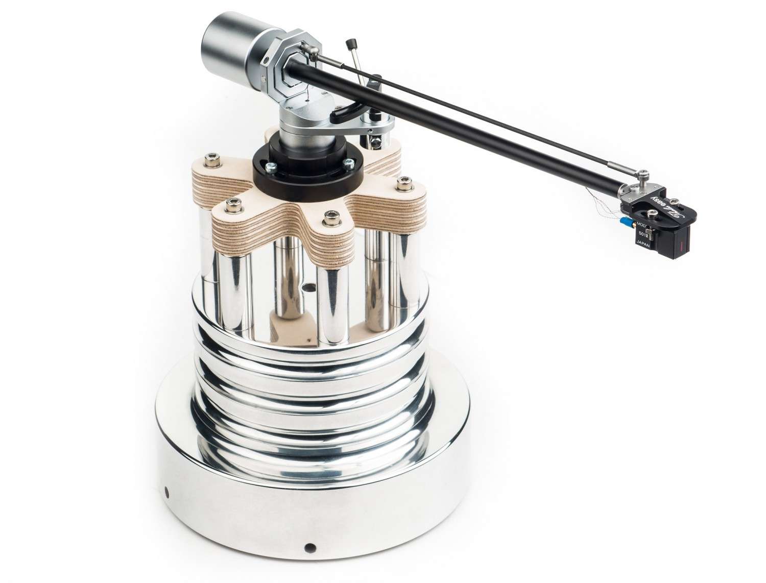

Hello Frank, welcome back.

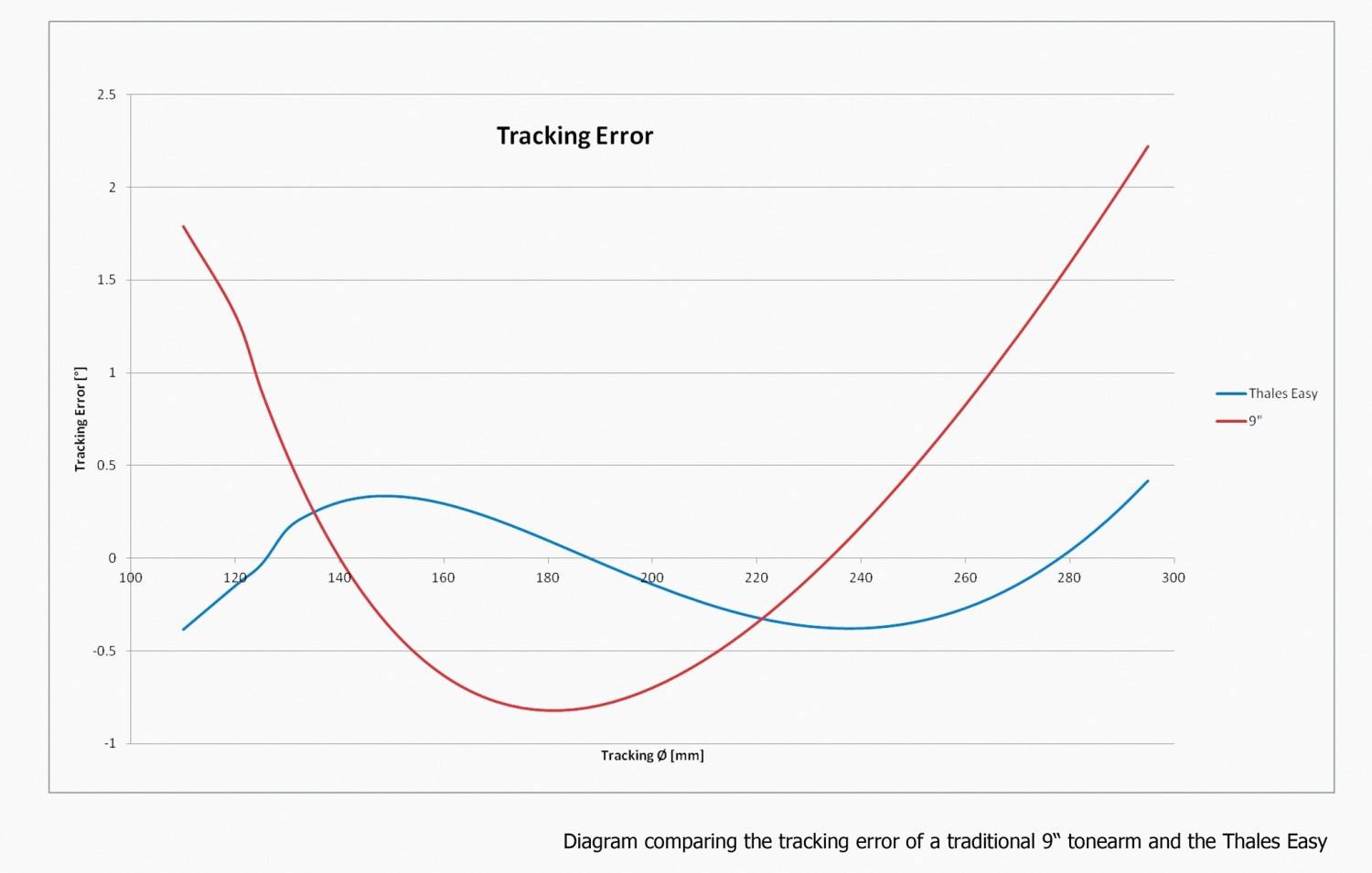

Frank has opened the bag and released a fairly critical cat (Schroeder's Cat?) with his suggestion about tracing a floating, non-circular pivot point. After wrestling with his LT design for a couple of years, I finally tried doing that trace. I tried hard to fit a circle to the trace, but it just wouldn't happen. I gave up and accepted the odd comma-like shape. Later, that same shape showed up in the plots 2wice posted back a bit and, interestingly I thought, in John Ellison's plot that DD just posted. I don't think Ellison understood what he'd found. If Jonathon connected the dots in his tables, he might find the same shape.
I think Ellison's plot also answers aligezhem's question about how the stylus can not trace a circle across the record: Because of the influence of the pivot, the forward motion of the swing arm is not linear.
I worked with the Birch Thales design partly because I could post the results without stepping on somebody's patent. There are side forces inherent in the Birch arm, but I've found they can be nulled fairly easily because of other inherent aspects.

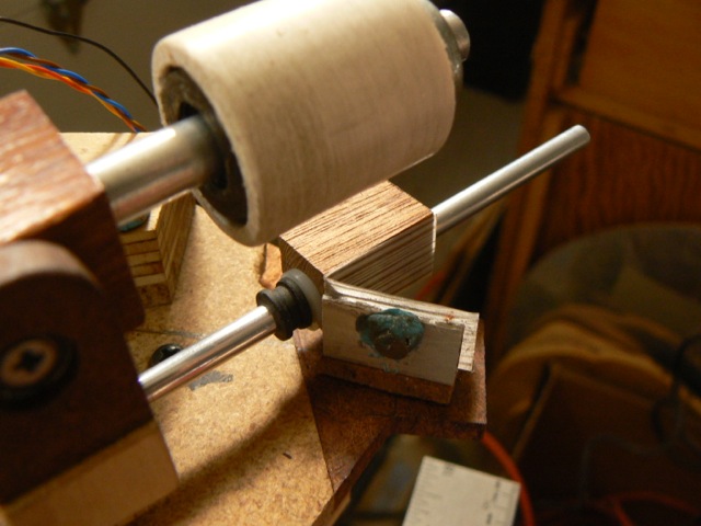

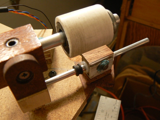

I think I've come up with a way to use the comma shape guide, but unfortunately it will be mechanical rather than a magnet and will give up some important advantages. It is more difficult to build than the single fixed pivot and I haven't been able to do it yet.
Jonathon, if you solve the construction hurdles, my guess is that you'll be very pleased with the sonic results. I certainly hope so.

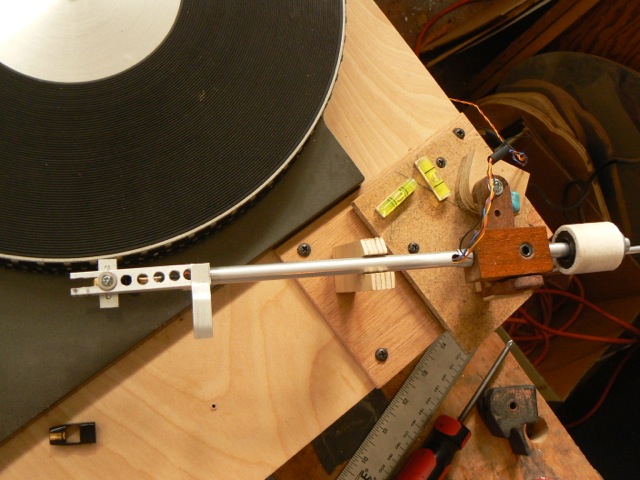

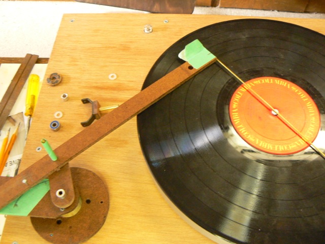

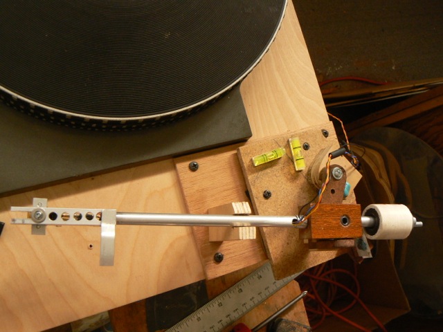

The smallest error off tangent turned out to be an arc of an ellipse on my plots, spent nearly 4 days looking for the function of that ellipse. When I found it, I didn't know what to do with it. 🙂
Hi Doug,
Yup, I was here for the celebration. The city appeared to be almost as packed as it did 25 years ago...🙂
Your last photo shows what I suggested very well. And it makes obvious that, by using this method, one can place the guide point anywhere it makes sense("real estate"- and force-wise). The required curve just won't be a circle segment
The guiderail then has to be made with a high degree of precision...
Btw, a circle can be seen as an ellipse with both focal points being congruent....
Determining the function for the ellipse one finds to work for your arm would help programming a CNC machine that mills the guide...

The 2 pivot point can also be placed outside the curve, then you get a scissor motion that can be controlled with a belt drive. The main problem is the fact that skating forces varies much more with this kind of arm, to a degree where they are hard to handle Ina simple way, and where one can ask how sound degrading they may be

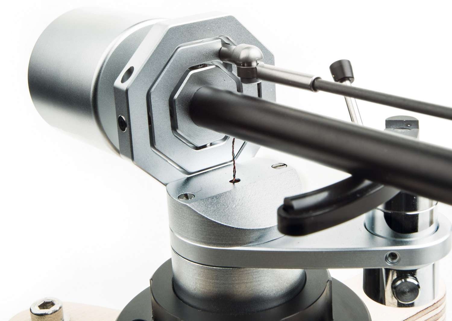

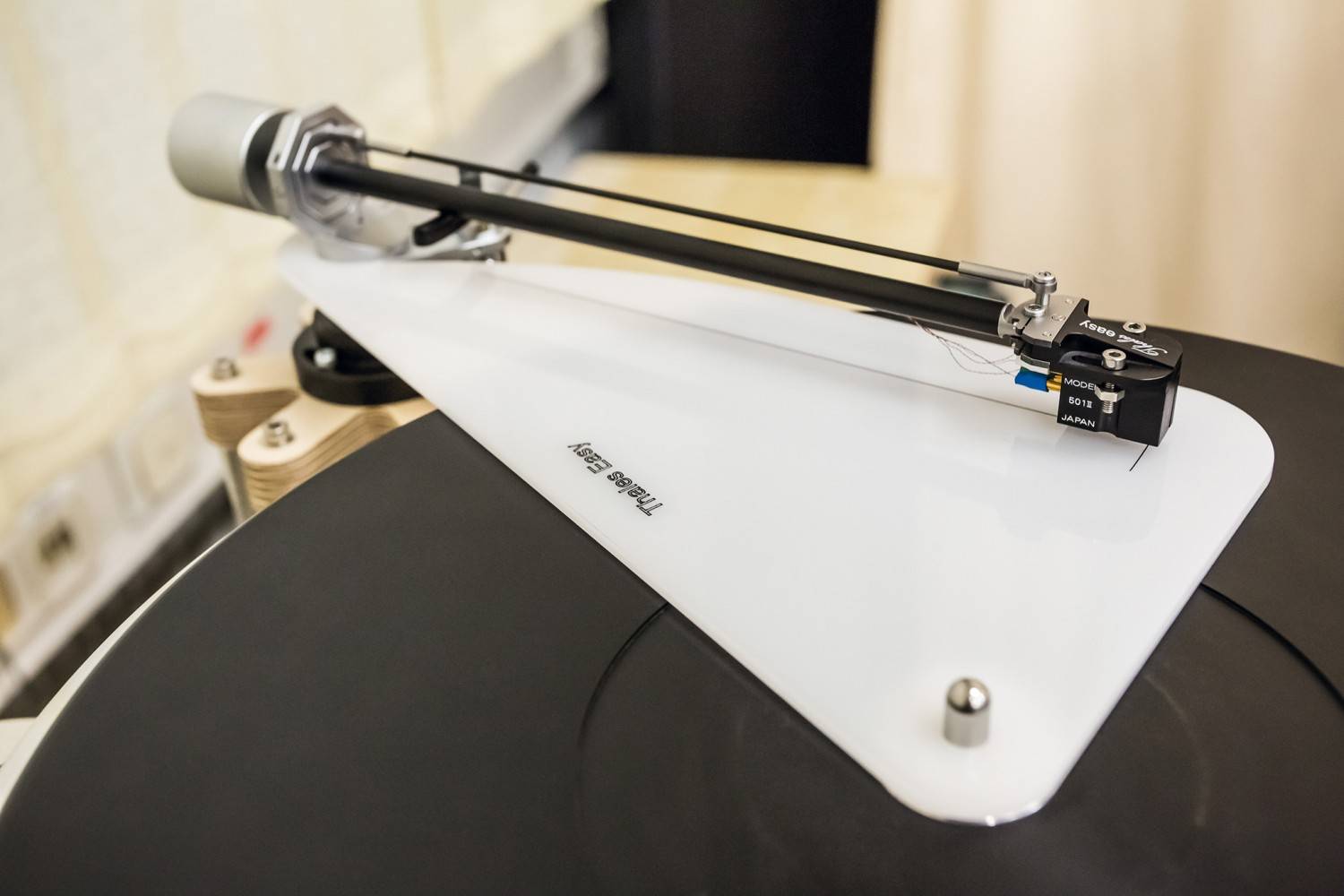

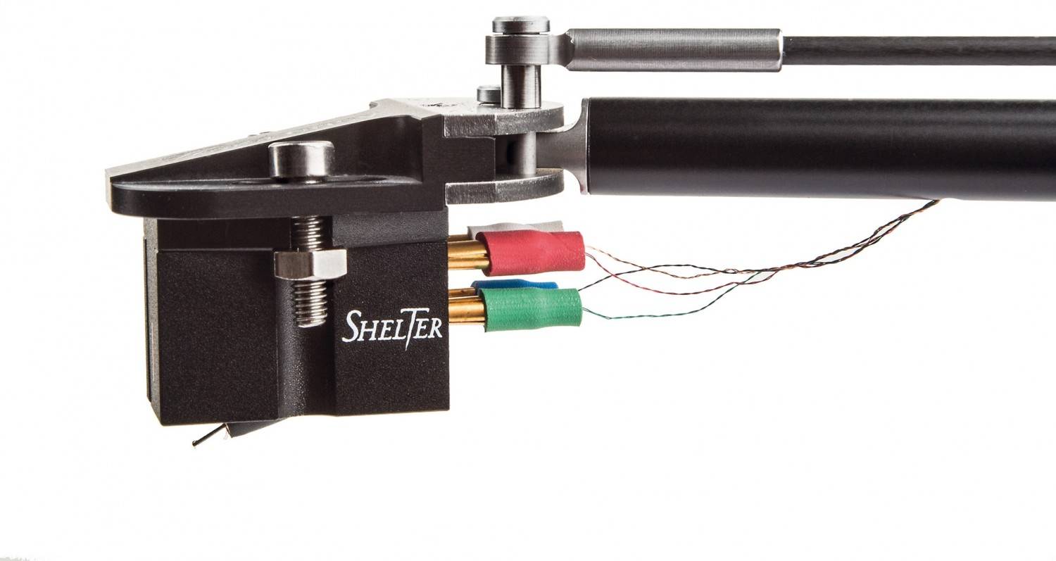

Hi Directdriver:
I wasn't necessarily suggesting an SME-style headshell, but some kind of detachable headshell would be convenient for cartridge installation (if accompanied by a precise gauge).
In the context of a Birch-style tonearm design, I can't think of any benefit in having the forward pivot capable of vertical articulation. If anything, placing the vertical pivot above the LP is a potential trouble-maker, since it guarantees that both effective length and VTF will change whenever a slight warp in the LP pushes the cartridge up and down.
IMHO it is better to integrate the vertical bearing with the guiding pivot P. The swing arm can then be of any length that you like - 6 inches would be fine, or even something as short as on Micha Huber's designs.
If you are referring to 43.32379mm, that comes from plugging your numbers of 320mm Thales circle diameter and 218mm swing arm length into the design methodology that I suggested in post #835http://www.diyaudio.com/forums/analogue-source/165878-angling-90-tangential-pivot-tonearms-84.html#post4146768, and letting step 7 calculate where guide pivot P should be and what the optimal diameter should be. A Birch-style tonearm should have three null radii (where the tracking error is zero), but if the guide arm length is inappropriately chosen, the number of null radii falls to 2 and the tracking error increases considerably. It is better to choose a swing arm length, decide where you want the three null radii to be, and let those tell you where to locate guide pivot P and the guide arm length.
It was for this reason that the 40mm length for the guide arm needed to be increased, and 43.32379mm was the number used for the table below (it is probably possible to round off some of the decimal points by choosing different null radii, but this would also change the tracking error peaks, and their distribution). Note that in this particular version of the table, the first number in each line is the pivot-to-spindle (D-A) distance. As before, the second number is the groove radius, and the third number is the tangency.
Thales circle diameter 320mm
swingarm length 218mm
guidearm length 43.32379mm
spindle-to-guide pivot distance 256.10914mm
spindle-guide pivot line vs. spindle-pivot line angle 2.856526 degrees

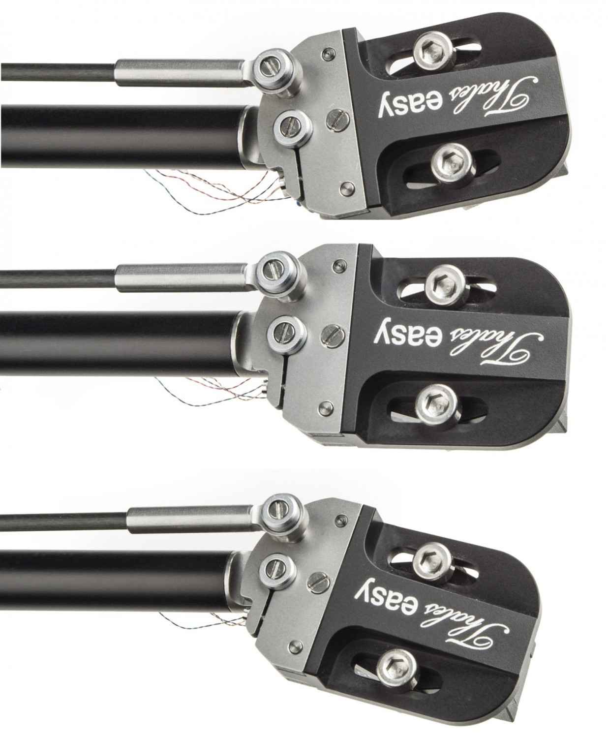

Hi Doug, directdriver, all: Been a little busy with year-end social responsibilities and preparations for the CES. My analysis of Doug's 320mm, 218mm, 39mm geometry has come to a halt at the mid-way stage, but I plan to finish this once the CES is over.
The tracking error graph of the Thales Easy tonearm that directdriver posted should be no surprise, and illustrates that, rather than being linear trackers in the strict sense of the term, these and Birch-type tonearms optimally have three-null geometry. Using Excel to convert the previously posted tracking error tables into linear graphs should show similar shapes.
Once we see start seeing graphs of the tracking errors (rather than number tables), it may be time to consider the impact of linear groove velocity on the tracking error audibility, and how to best choose the null radii. A simple way would be to prioritize the lowest error numbers (regardless of linear groove velocity), similar to the Baerwald philosophy of conventional two-null tonearms. A different way would be to weight the tracking error against the linear groove velocity so that the distortion that the ear hears is more consistent across the entire LP surface. This would be closer to the Stevenson philosophy (or as a less extreme approach, the recent Uni-DIN), and should push the three null radii closer to the LP label.
All of the above written under the assumption of a constant guide pivot B, rather than a floating B.
kind regards, jonathan
There's a mechanical problem with a long swing arm/short pivot arm Birch variation. The headshell is inherently rests uncomfortably close to the platter, but by splitting the guide into two hinged parts, the headshell can be moved farther away.
There is a small magnet - under all that blue tack - and a small attractor in the wooden part which keep the hinge closed during play.
Following jcarr's lead on the tracking ability of short arms renders this moot, but I just prefer longer arms and it was fun to figure out.
