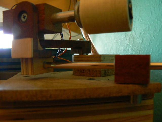

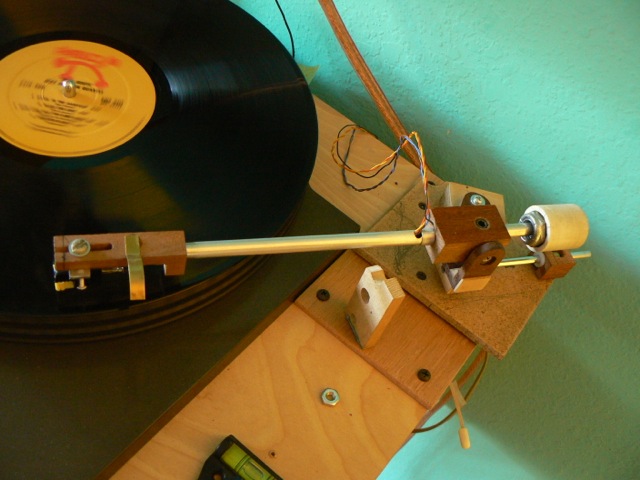

Just a quick update.
I thought the first Birch style arm I built would work best with low compliance cartridges, but an M3D didn't sound right so I tried an AT95E at 2 gr and an AT120E at 1.2 gr. They worked beautifully so these arms are lighter and swing more freely than I expected.
I built a second arm with some changes in the geometry, the number of bearings and their arrangement, and, most importantly, the heim joint was replaced by a bearing/bushing combination. The new arm was designed to be simpler and lighter. It is lighter and will track with an ADC at 1 gr. Simpler I'm not so sure of.

Thanks for the update, Doug. Very cool! Glad you're putting your creativity in refining and redesigning the guiding rod mechanism.
I wonder if using a tuning fork or chopsticks style would work for guide arm, similar to the bearing concept in a Simon York tonearm or what Mark Kelly did with his tonearm, to further simplify things?

I hated to give up the Heim joint because it was so simple, but getting the right degree of free movement in any given specimen proved hard. The new purpose built guide is definitely better.
The dual chopstick/tuning fork guide will work, but there might be weight and alignment problems because it will have to be mounted on the arm. There's no reason not to try it, though. The pivot itself has to be a single rod to prevent binding. Two short rods mounted on a bearing might work, too.
This arm has a modified version of Simon York's azimuth control. His control won't transfer directly to this arm because on his arm it swings fore and aft as the arm moves vertically. On this arm, that control is stationary because it's mounted on a bearing instead of directly to the arm.
A super simple version of the Birch arm could be built using a combination of York's unipivot and the chopsticks - might result in a nicely damped arm.
