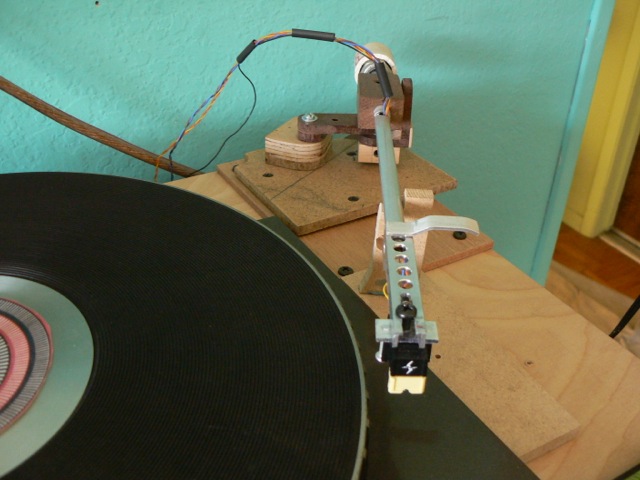

The resonance results bothered me so I built a lighter aluminum headhshell which brought the Effective Mass down to about 3 gr and both resonances down to about 11 Hz and I think I can hear a difference. If clear detail and sharp soundstage are the hallmarks of an LT, this arm definitely is one.

I really like the angular appearance of that Polish arm. I hope it sounds as good as it looks.

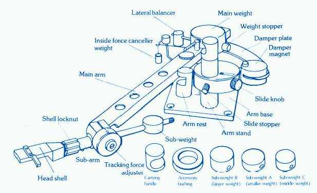

Just to be sure: Is the "guide arm" the one that pivots at point P and supports the "swing arm," which carries the headshell? My Thales diameter is 320 mm, the swing arm is 218 mm, and the guide arm is 40 mm.
In case Jonathan might have different nomenclatures, let's revisit the Birch drawing I posted multiple times before so everyone is on the same page. Below is a tentative system.
"Guide arm" = P to D (or pivot base)
"Swing arm" = C to D (or Main arm that holds the cartridge)
Thales triangle = A + B + C
Doug, Ralph: Yes, we are using the same terminology. P to D is called guide arm, and C to D is called swing arm or main arm. A to B is the diameter of the Thales circle, and A + B + C is the Thales triangle.
I need to take another trip through my previous drawings to refresh my memory as to the exact procedures that were used, but the final group of drawings (468mm Thales circle, 156mm swing arm) plots the angular deviation across the LP at 0.25-degree intervals.
I am in the process of making new drawings (partly to reconfirm the design procedure), initially with a 345mm Thales circle (345~365mm is the approximate length of a 12-inch tonearm). The swing arm length is provisionally 115mm, but I could make drawings for different swing arm lengths to see how the angular deviations work out. I have unfilled drawings for Thales circle diameters of 310mm and 330mm, so I suppose that I could work through Doug's geometry (320mm diameter Thales circle, 218mm swing arm, 40mm guide arm) to find the configuration with the lowest angular deviation.
The starting variable is the Thales circle diameter, but a second variable is the swing-arm length ratio (of the Thales circle), and a third variable is in where the tonearm designer decides to place the 3 null points (where the angle of cartridge stylus to platter spindle is truly 90 degrees). Change the LP radii that the null points are assigned to, and the position of P will shift. IOW, there are quite a few permutations that should be considered and tried for any given Thales circle diameter.

How can the respective angle not be 90 degree in a Thales circle?
Hi alighiszem: When designing and using physical parts, the guide arm must have a fixed length, and the swing arm must also have a fixed length (unless a length-adjusting mechanism is implemented, which would introduce additional bearing errors).
In my investigations so far, it looks like these two fixed lengths (in conjunction with the guidance to a single point B) cause stylus positions C to wander both inside and outside of the Thales circle as the tonearm traverses the LP (referring to Directdriver's post #824). IOW, the Birch concept seems to give three null points where stylus positions C reside exactly on the Thales circle, and depending on how the tonearm designer chooses the null points, the maximum tracking error will change, and how the tracking error is distributed across the LP will also change.

I have OCD so I took the liberty to reorganize Jonathan's lists with the corrections he provided, mainly for visual ease. Thanks to Jonathan for his contribution to this thread.
Here are some numbers that should illustrate the trends that I have been talking about.
First triplet of number lists involves a Thales circle diameter of 345mm, and a swingarm length of 115mm (one-third the Thales circle diameter). The variable is in where the three null points have been set. As you will see, shifting the null points alters how the tracking error is distributed across the LP, and the maximum tracking error, but it also affects the optimal guidearm length (and the location of pivot position P, but let's leave that for another time).
If you refer to the drawing that directdriver posted, the B-C-C "triangle" has been chopped up into 0.25-degree segments for analysis. A finer grid than 0.25 degrees will give more accurate results, but would involve more work. For the time being, I chose to use a moderate grid that is fine enough to establish the general trends, but isn't too taxing of a workload.
In each list, the lines marked with # are the null points that I chose. The lines marked with * are the tracking error peaks that resulted, with the caveat that a finer grid than 0.25 degrees may show slightly different results. Line 64 is the innermost LP groove, line 01 is the outermost LP groove, but the 0.25-degree grid starts with line 64, making the difference between lines 01 and 02 less than 0.25 degrees (considerably less, in this particular case).
After the line number (01-64), the first number in each line is the distance between the measurement point and the platter spindle (strictly speaking, this isn't the LP radius, since it includes the distances by which the momentary stylus position C oversteps or understeps the circumference of the Thales circle).
The second number in each line is the angle between the BC (line between pivot and stylus) and CA (line between stylus and platter spindle).
Any difference between the second number in each line and 90 degrees is the tracking error, which is the third number in each line. I have only added the third number for the tracking error peaks - so that they stand out on their own.
Once again these employ a Thales circle diameter of 345mm, but list 4 reduces the swingarm length to 100mm (15mm less than the 115mm used in lists 1, 2 & 3), while list 5 increases the swingarm length to 130mm (15mm more than the 115mm used in lists 1, 2 & 3). The tracking error peaks could presumably be reduced a little by adjusting the null points, but only to the extent of better "averaging out" the errors.
Altering the swingarm length (while keeping a fixed Thales circle diameter) not only changes the tracking errors, it also changes the optimal guidearm length (although this may not be obvious from just looking at the number lists, it will be obvious when you try to work out the optimal geometry).
jonathan carr

The short swing-arm length reminds me of the Dynavector "split-plane" design and I like the idea of using SME style detachable headshell for versatility, unless you're a rigidity freak. If you add an extra pivot on the DV arm, it resembles an imaginary Birch arm with short swing arm. The DV style of guide-arm above swing-arm provides another option to implement a Birch arm.
A shorter swing arm would place bearing D over the LP surface, but as long as guiding pivot P is able to cope with both vertical and horizontal motion (in the manner of a normal tonearm), bearing D only needs to pivot in the horizontal plane and can be kept compact.
Again, Dynavector style.

I prefer the swing arm to be about 6 inches since that would clear the platter even if you use some unconventional low slung counterweight and would not touch the platter, except if you have a 14" platter. A 8" swing-arm is short but it's long enough to deal with warp records. Once again, I am thinking of the DV style, ie, guide-arm above swing-arm.

The photo illustrates a very good practical reason for not using a swing arm much over about 180 mm (7"). The mounting geometry is very restrictive so this 218 mm swing arm puts the cartridge right beside the platter and there's nothing to do about that.
