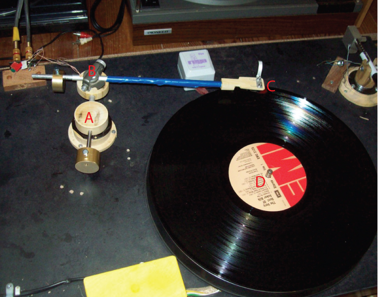

In that case, where is offset angle? It looks like 90 degree to me.
Point B does NOT pivot and is at a fixed angle therefore point B is the offset angle. If there's no offset, it would be straight from point A to point C, which is the effective length. Again, it's not that different from a Dynavector arm, except it has a much shorter arm for vertical movement. If the arm is tangential, BCD would always be a right triangle. It is not.
Gus' arm adds unnecessary mass and geometric confusion to a conventional pivot arm but if it sounds good to him then that's all that matters. He can of course alter it or align it differently to see if there's further improvement.

I do intend to make some changes. This was always just an experiment. The other two conventional arms both perform better than expected, especially the 12".
The whole point of knocking up the test record player is so that I can mess about without doing any damage to the good decks.
As an aside, the test deck is a bitsa. The platter and bearing is from an AR EB101 and the motor from an old Dual. The pulley was miles too small. As I don't have a metal working lathe, it was necessary innovate!! The shaft on the motor is the same size as the axles on slot racers so I used a wheel which has a strong grub screw fixing, stuck a couple of thick brass washers onto the wheel, stuck it on the drill press and used a file to shape the pulley!! The strobe disk shows that it is dead to speed, the dots staying still with no movement at all. Quite impressed with myself😀

Yes. You are right. I understand it now.

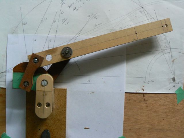

I'm a bit confused about the Birch arm. Surely if there are two pivots, there would be no control over how the arm behaves. The present pivot would have little or no force applied as the one under the arm would move about or perhaps, even pull the whole shebang forward without moving across the record at all. I need to have a look a the Birch in order to understand.

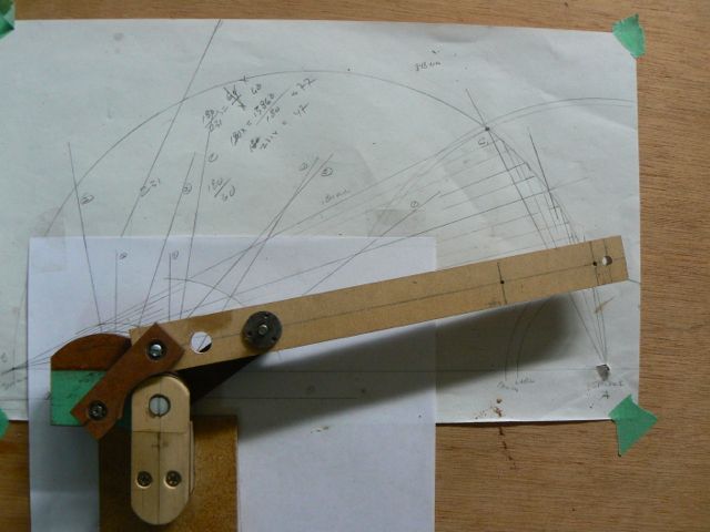

Well, good though it sounded, the 90 degree arm wasn't better than my 12" so it's been modified.
It now represents my take on the Dynovector arm. Much simplified of course. The mastic around the wires is drying right now but tomorrow I will wire it up and we will see what we will hear.
Just the one horizontal pivot so I still need the big weight to even the load on the bearing. A simple rod stops the small arm from dropping too far. manual for the mo but I reckon I can figure out a lift of some kind.

When I first started to work out a working Birch Thales arm I wondered if some sort of pantograph arrangement set at the pivot might work. I finally got around to testing that and it does. The dual pivot arms create a virtual control point and just eyeballing the swing arm tracks tangentially quite accurately. The arm swings smoothly and easily even with cheap bearings.
Next I need to get a real swing arm with vertical bearings built.

The Dynovector type arm is now playing and sounds very good, much better than my previous effort which I guess is not too surprising, given the geometry. I like the idea of the short arm. It feels like it should be better resonance wise and certainly sounds very even. It has bought a lot of detail to the fore whereas the Rega tends to smooth things out a little.
Mind you, I would find it hard to choose between this one and my bog standard 12". Given the simplicity, I think I'll stick to the 12" on my main deck.

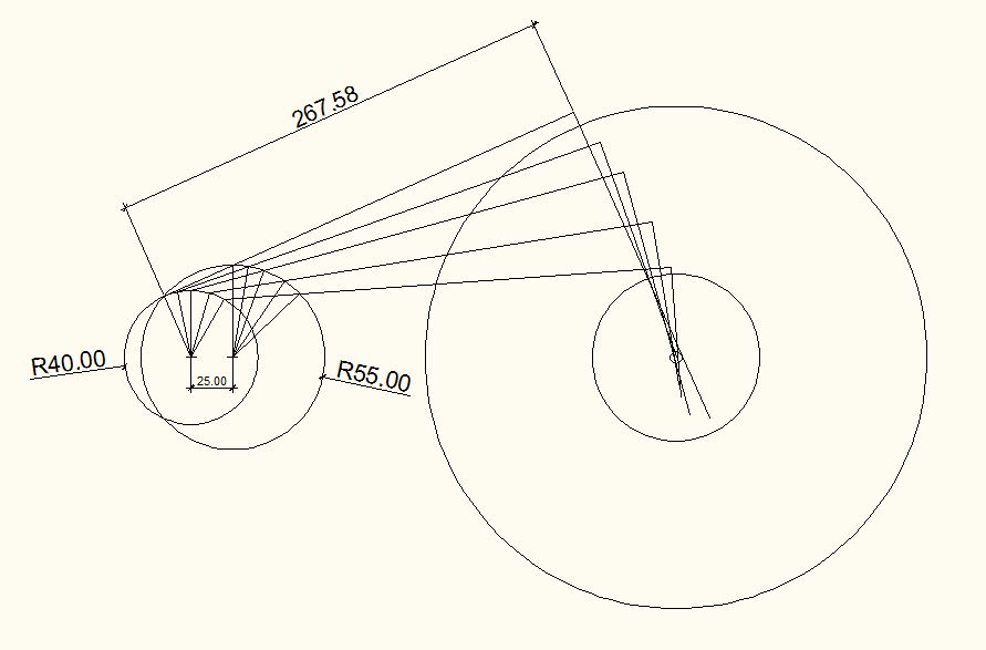

This is what I have come up with after 30 minutes on Autocad:
This is done by trial and error, but hopefully there could be some basic math at the bottom of this.
Steen

Steen,
Thanks for posting the CAD drawing. I can't do that, either. I have to draw everything with a T square, a compass, and in pencil. Your 30 minutes have you headed in the right direction. Replicating the original Birch drawing in CAD might be a good idea and I suggest checking Jonathon Carr's posts about the importance of null points. I know, bunch of damned numbers, but it's worth it. I don't quite understand why this idea hasn't surfaced before because it's strongly implied in the Birch drawing - just kinda sitting there. With any luck, there isn't some snag I'm just not aware of yet.
