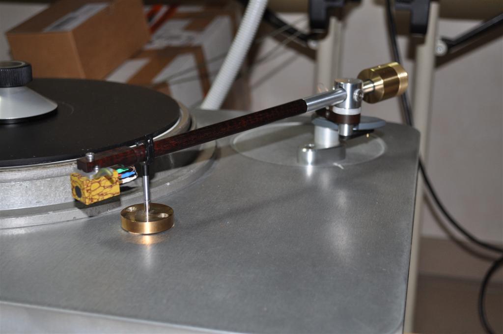

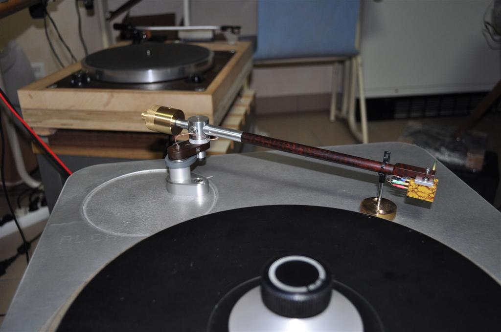

More images of the Schroder LT arm from European Triode Festival 2011 and I believe Frank's system with the LT arm won the turntable shootout.
It is still kind of enigma, how this arm works.And how it will behave on the records with substantial eccentricity.
I just wish there's a picture of the guiding mechanism underneath the pivot and that gray color cantilevered plate that covers everything.
I don't see eccentric records being an issue for this arm. It would behave just like any other pivot arm. As long as the guiding mechanism is low friction and geometrically precise, I believe it will work just fine. I'm just curious about how the "magnet guide rail system" works. All will be revealed when we get to see what's underneath the pivot... I'm surprised this arm is still under the radar and hasn't been discussed in more mainstream press. I want to see more of this type of products, since the advent of the Thales arm.

when do we get to see underneath? Is this beauty non-active, meaning non- powered (don't want to say passive)?
What is underneath is purely mechanical. Yes, this is a passive device. Non-active, no motor or sensor system. That brown cantilevered plate is holding the main arm for only horizontal movement. But to keep the arm tangent something has to guiding the behavior of its pivot and all that mechanism is hidden underneath that gray plate. Said to be magnetically coupled and tunable in the guiding mechanism. When do we get to see underneath? Good question. It's still not commercially ready yet so my guess is Frank will release it when the patent gets approved. Maybe sometime next year? I have no idea and cannot speak for Frank but I sure look forward to seeing more of it and having Frank discuss more about it. It's a very elegant design. I hope see more products like this--that is, addressing tangency without resorting to air-bearing or motor--in the future.

Hi Nanook,
Sorry to interfere, but my new arm is different in several ways to either the RS Labs arm, which, by no means, is a tangentially tracking arm(a common misunderstanding, often repeated on the net for a lack of understanding the idea behind it), or the Garrard, BJ, Van Eps, Simplicity or Thales arms, which ALL feature an offset angle, thereby requiring a form of skating force compensation(most elegantly realized in the Simplicity arm).
Skating force/skating compensation = varying preload on the cantilever.
On my new arm, 1,5 milligrams(possibly near zero in the production version) will deflect the arm vertically, 5mg or less horizontally(preloaded bearings, no slack)
When properly mounted, there is no skating force to be measured.
All passive linear trackers require a certain amount of force to "move" the carriage. The resulting deflection of the cantilever is often larger than the tracing error in properly set up pivoted arms. It gets worse when excentric records force the cartridge to "yank" the entire horizontal eff. mass back and forth.
I do not mean to bash existing solutions(I really like the Simplicity and the Cantus arms), but some have obvious drawbacks and some have drawbacks easily overlooked. They can still sound better than existing pivoted arms, it's just that there is more to the sonic performance of a tone arm than the tracing error(or lack thereof).
