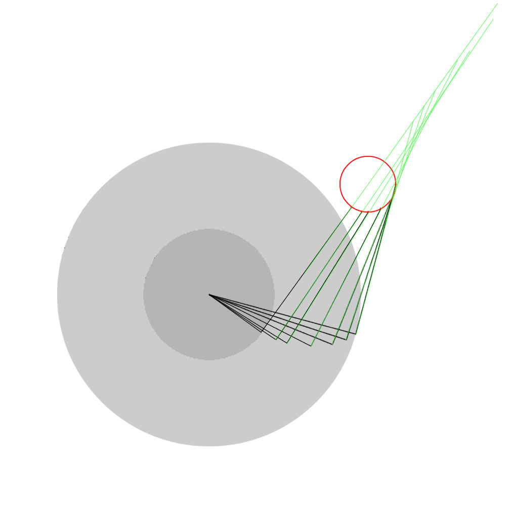

No that's not true. DDs supposition is correct, the geometry is a variation on the Birch geometry.
I wanted to verify to be sure, but no, i was right (or you wrong). No convergence at all.

To be more precise, the only convergence point is where it is supposed to be: at the vertical of the record's axe. This may-be look like the Birch design, but, in fact, has nothing in common.

I wonder why some people on forums can be so affirmative, specially when they are wrong ;-)
Possible but I doubt it, I think it's more likely that your drawing is insufficiently accurate. The line spacings appear to vary randomly which doesn't inspire trust.
Do you have the actual dimensions at hand? There's no substitute for geometry.
Easy to make you own drawing. Do not need any precision to demonstrate. It is not a question of "trust", try-it and make your own evidence.

OK, that's an interesting case, you appear to have designed to minimise the radius of the "chariot" disc. As per DDs comments above, this maximises the relative length of the second arm (segments DC in our constructions) and moves us further away from the Thales circle.
Accordingly, the fit to Birch geometry is quite poor. For PD = 28, DC = 155 and AP = 190*, I get a Thales locus at 235 mm and a maximal error of 0.6 mm which should correspond to a tracking angle error of about 0.4 degrees. Increasing the "chariot" radius by a few mm so that it's a straight line at zero radius decreases the maximal error to 0.2mm.

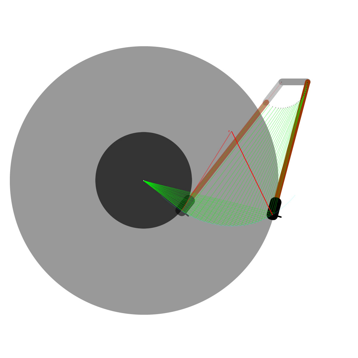

But, if you are about a purely mechanical thing on the same geometry: attached a schematic. Just replace the servo with a secondary articulated arm between the Diamond axis and the point Z, and you'r done. The two articulated arms can be under.
I think that, if any error, it will be very minimal (No error when servo).

Your "Diamond Axe" is actually the centre of the Thales circle. The errors depend on the relative dimensions of the arms.
The errors for the case you posit (designed, as you said, for a servo) and for a version which works better passively are in post #245. To eliminate the errors one of the circles in your diagram must be replaced with a non - circle, for example an arm whose length (radius) varies.

I already have, in posts #219 and #222. Change the numbers as you require.
To understand the relationship, take your last drawing and extend the arc centred at Z to make a semicircle from the spindle. This is the equivalent Thales semicircle.
Now extend all the green lines backwards to their convergence. They should approximately converge at the opposite vertex of the semicircle.
The degree of non convergence can be used to estimate the error angles.
How can-i explain, 'without to gone around in a circle ;-)', that, in my design, they do not converge ? At all. I'm outside of your Thales figure.
And, however, the error angle (if mechanical) is very minimal, less than any classical arm, mostly situated in the first1/3 of the record, nothing to worry about as you can see in my last draying.
You can't, because it isn't true.
You admitted it yourself by drawing the arc through the stylus loci. This arc forms part of a Thales circle. Your particular circle misses the spindle by about 3mm but that's simply a matter of accuracy. The distance from the spindle may be used to estimate the errors which as you say are less than for a normal pivoted arm. A small modification (increasing the diameter of the "chariot" by a few mm) reduces the errors greatly.
BTW your design won't work at all as a purely mechanical arm as stylus drag will force the chariot to rotate until the forces on the arm balance.

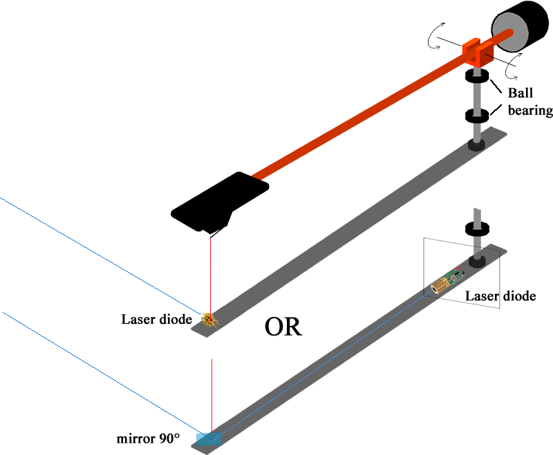

"I see a complication arising from having the optical pickup being located at the record spindle. How do you resolve this difficulty?"
Good question. I am still trying to figure out how Esperado's design detects tangency. It appears there has to be some form of laser or sensor system located at the spindle area but how it is implemented is the question. Perhaps I didn't read careful enough of his comments. Care to elaborate?
As I said earlier, I like the design's smaller footprint but it creates unnecessary geometric complication. A Rabco style tonearm may not be the simplest design but at least it's simple to understand...
Good question. I am still trying to figure out how Esperado's design detects tangency. It appears there has to be some form of laser or sensor system located at the spindle area but how it is implemented is the question. Perhaps I didn't read careful enough of his comments. Care to elaborate?.
A little drowning is better than thousand words.
To sense the laser diode, this kind of thing could be perfect.
But you can think instead to use a LED, reduce the diameter of the emitted light by a slit and two photodiodes in a Weston bridge to measure.
The sensor has to be situated just under the record spindle.
Not very complicated.
