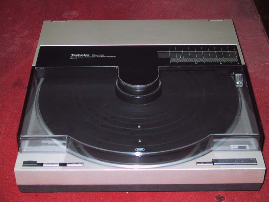

To conclude, i would like to point out the most intelligent radial arm turntable ever:
Technics SL7.
Technics SL-7 Owners Manual, Service Manual, Schematics, Free Download | Vinyl Engine
The arm, his chariot and his motor was in the cover: you do not have to wait for it to be parked before opening the cover. Brilliant. This plate was able to detect the size of the record, and was fully automatic if you like: one button press.
That the one i use.

For me, the Technics was absolutely perfect: you cannot hope something better. Heavy, easy to run, and the size was just 30cm X30cm, the exact size of the 33RPm. More, you where obliged to run the turntable closed, so, no dust. And it was not a so expensive turntable.

I had never found something more intelligent, simple, and well produced than the Technics SL7. This turntable resume the state of the art, for me the best turntable ever. Direct drive plate, with no flutter or rumble. Non resonant rectangular profile short arm ( in the cover, so easy, so clever), Automatic detection of the size of the record (speed and initial position of the head, with a brilliant simple detection light detection system): you open the cover, put the record in, and press a button to play. Open the cover any time to stop, or wait the turntable to do-it itself. The turntable is very heavy, the smallest you can find, with a good suspension, and no resonnances nowhere. There is a dumping mass witch press the record on the top to eliminate his vibrations. I have added an anti-static brush moved by the chariot to eliminate the durst while playing, and changed the 'plate cover ?' material for an anti static silicon heavy one. Well, only one inconvenience: no way to scratch with it ;-)
