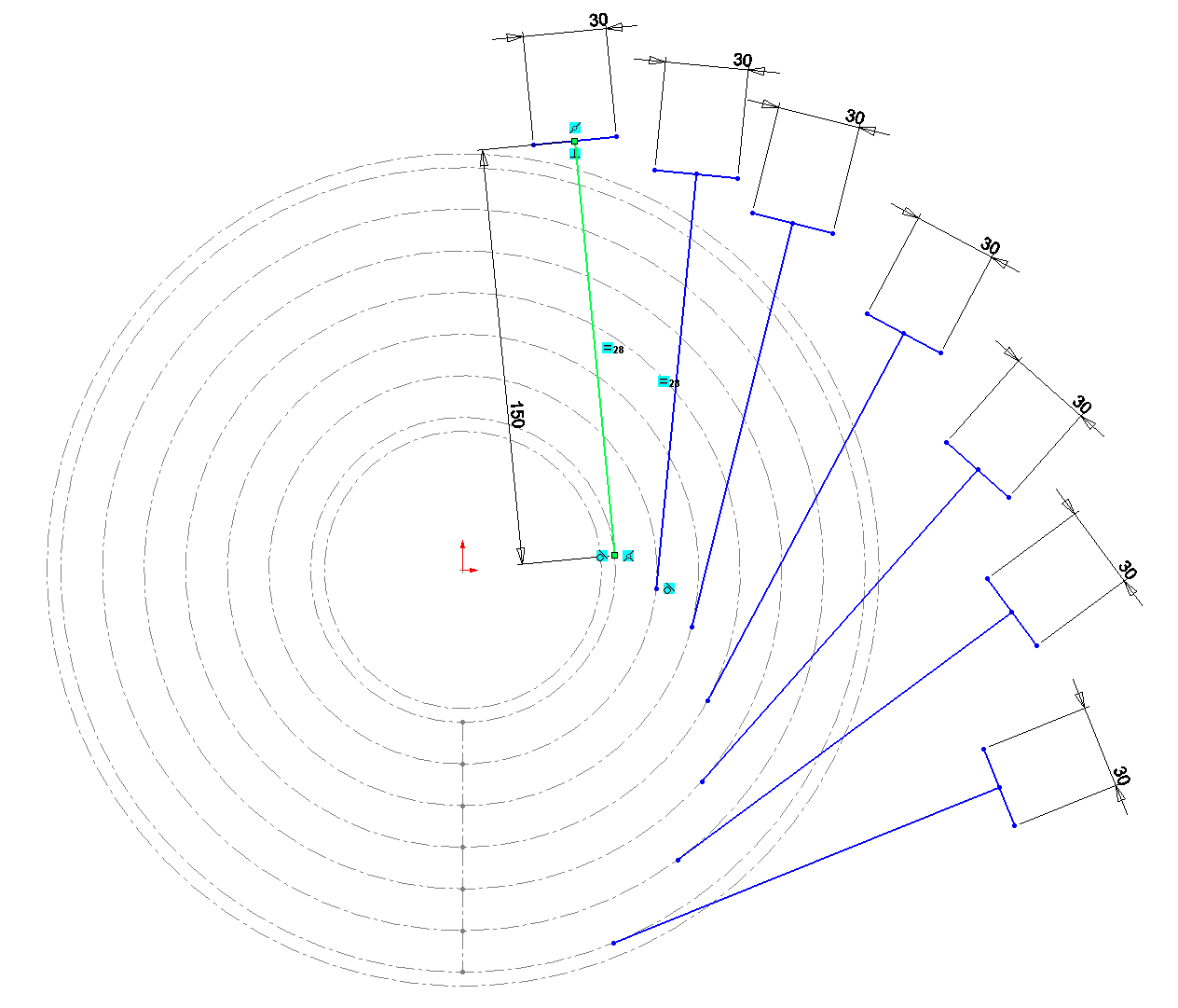

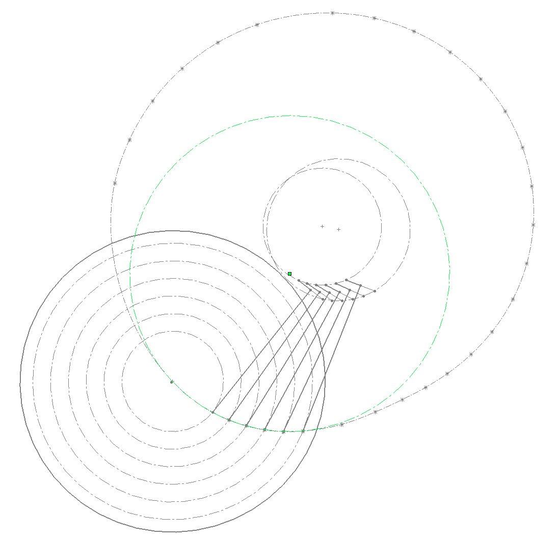

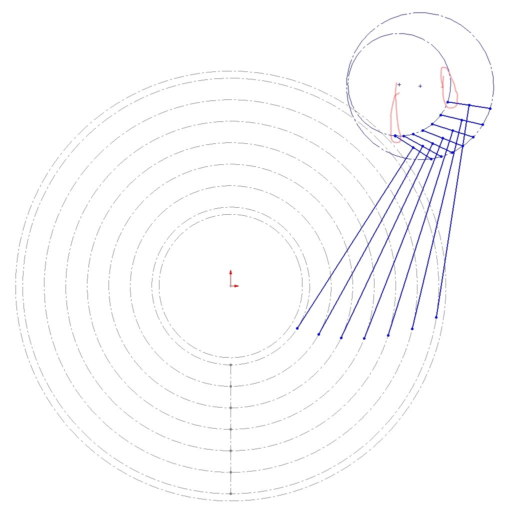

There is nothing wrong with it, it provides tangential tracking. You just need to add an antiskating device.I am probably missing the point here.
But what is wrong with the approach I suggest here.
(I don’t see what’s wrong, but it is so simple there must be something wrong with it.

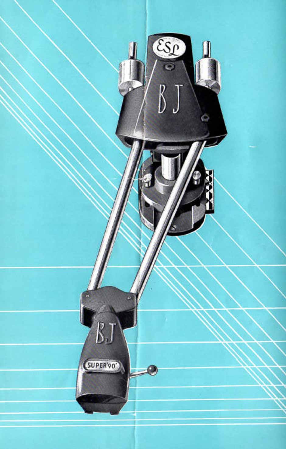

This is one of the many attempts to ensure tangential tracking using fixed centre guide links. Unfortunately the cross member pivots do not follow fixed circular paths as the stylus follows the Thales circle, which it must do for passive tangential alignment. The points attached to the tonearm describe curves named Limacons, which are associated with circles rolling on circles. I don't know how your rear pivot centres and radii are derived but they do not ensure tangential alignment at the stylus.I am probably missing the point here.
There is a movie with some lines :
and some drawings:View attachment 1031781View attachment 1031780
The first video below illustrates a typical case of the arrangement in your diagrams. The paths of the cross member ends are shown (green and blue) to be limacons, not circles. Adjusting the parameters makes no difference.
Numerous geometries have approximated these limacons by fixed circular paths. A true tangential geometry is shown in the second video.

Following a Thales circle is only one way to construct a tangential tracking tonearm but not the only one.Unfortunately the cross member pivots do not follow fixed circular paths as the stylus follows the Thales circle, which it must do for passive tangential alignment. The points attached to the tonearm describe curves named Limacons, which are associated with circles rolling on circles. I don't know how your rear pivot centres and radii are derived but they do not ensure tangential alignment at the stylus.
According to the video the tangential alignment is achieved with at least very good approximation.
The video angle and resolution does not allow any reasonable assessment of the tangential alignment. Furthermore, the 2 diagrams explicitly illustrate the Thales circle as the basis for the tangential alignment claim.Following a Thales circle is only one way to construct a tangential tracking tonearm but not the only one.

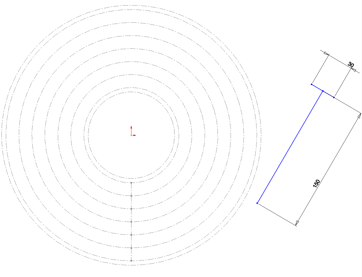

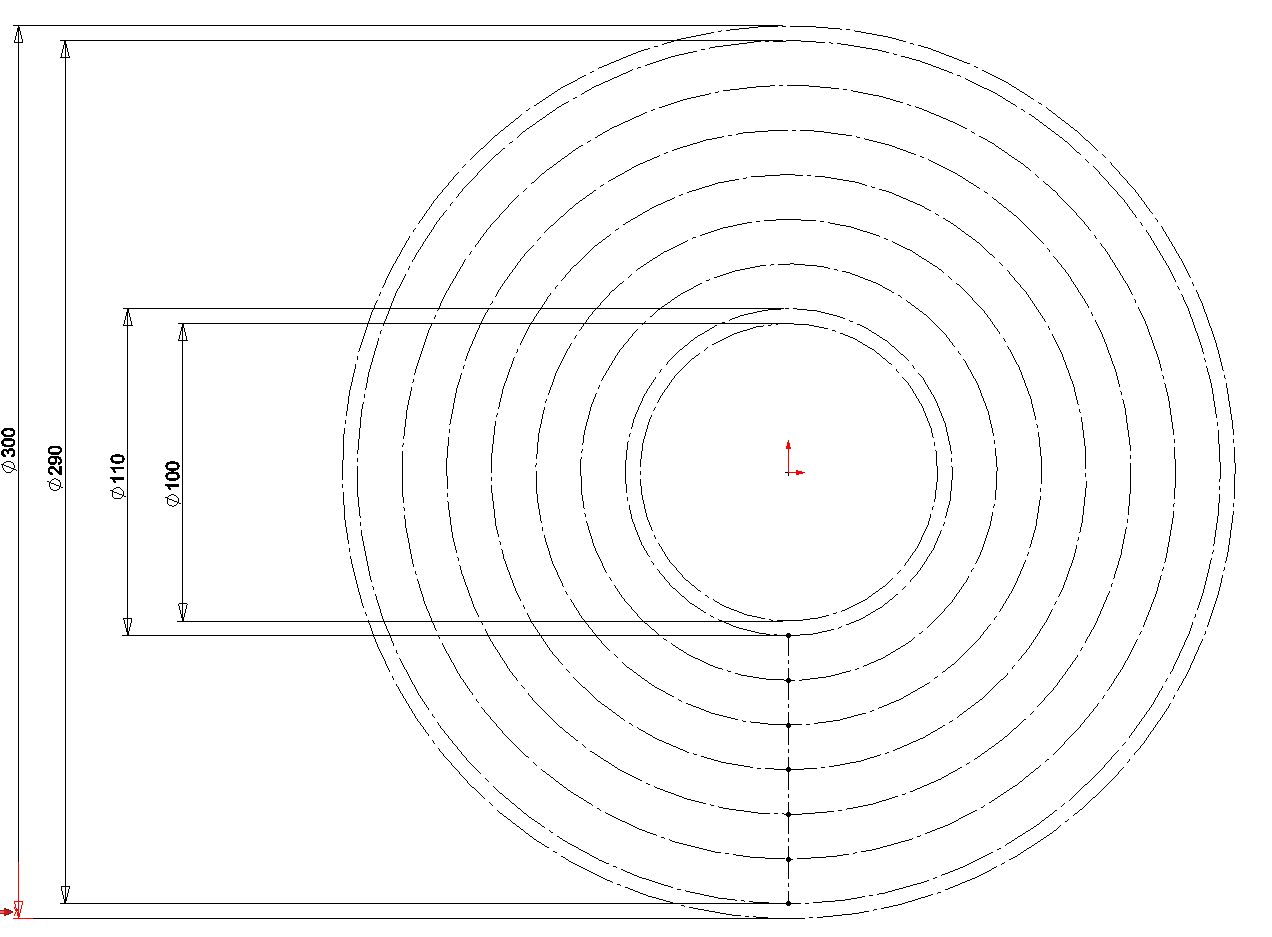

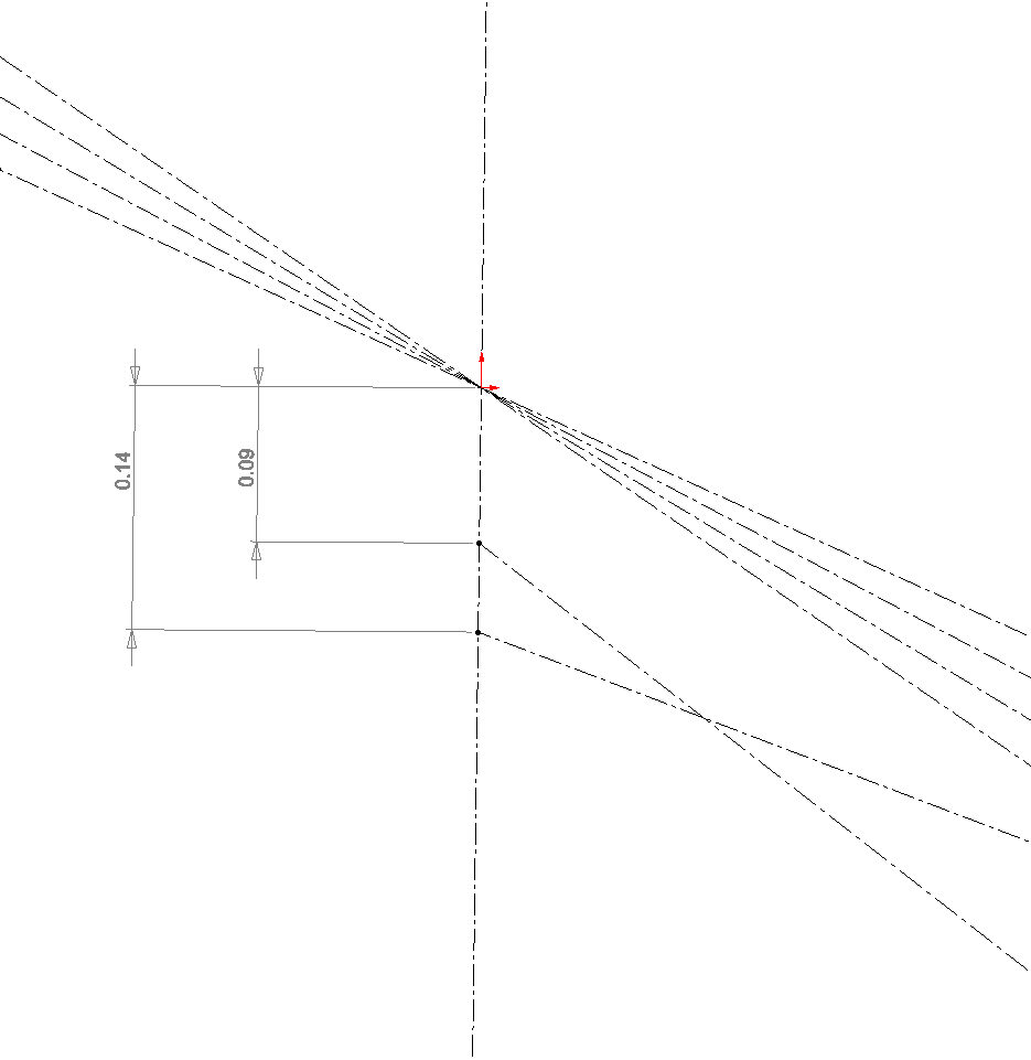

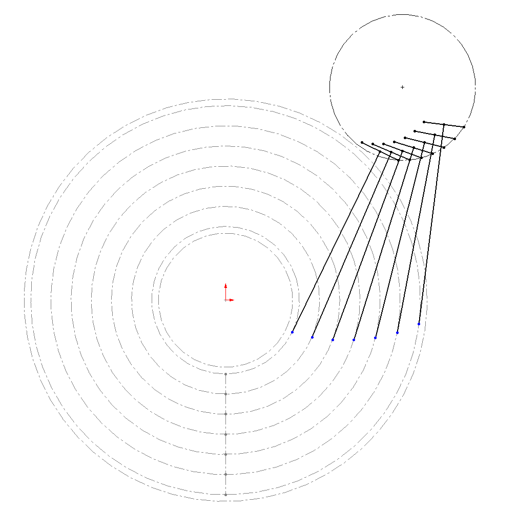

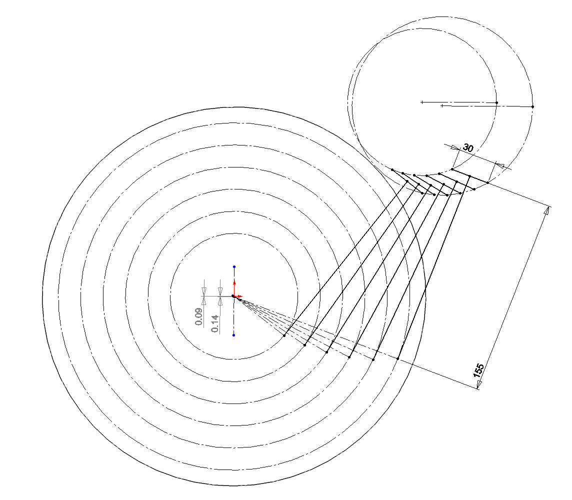

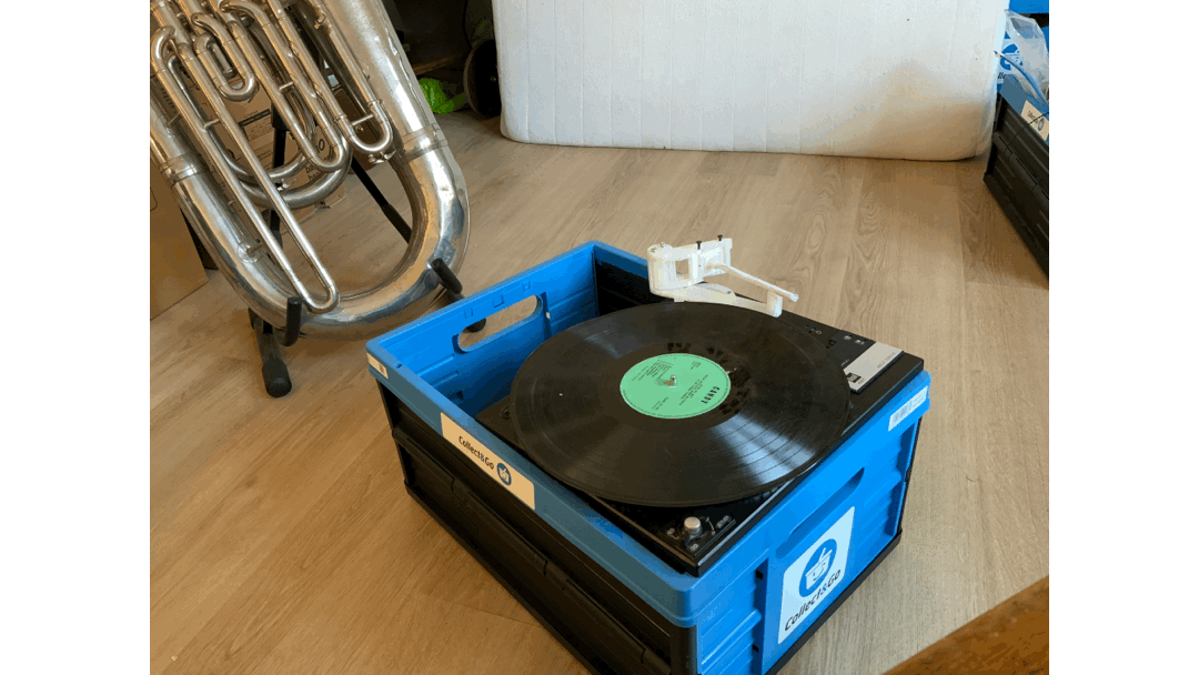

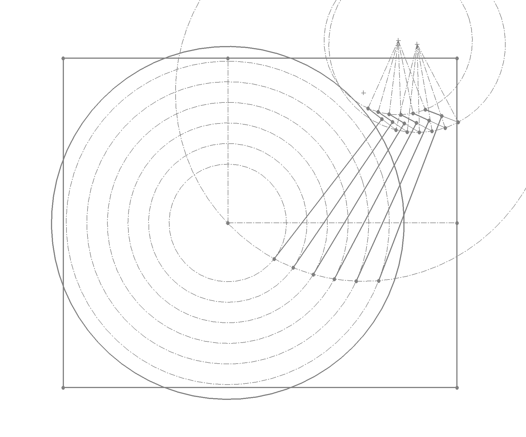

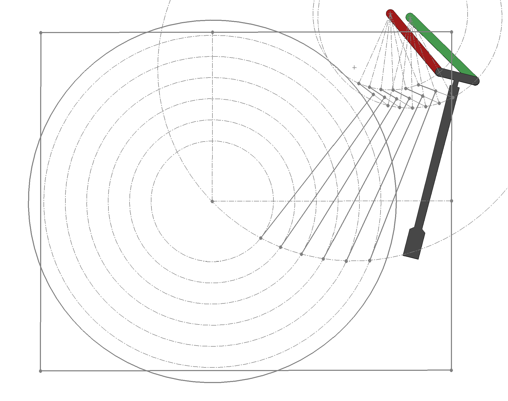

it is indeed an approximation. It has been made experimentally without understanding the math to be honest.The video angle and resolution does not allow any reasonable assessment of the tangential alignment. Furthermore, the 2 diagrams explicitly illustrate the Thales circle as the basis for the tangential alignment claim.
I started out with placing circles in the playable zone of the lp.
Then I draw the tonearm with the two Pivots on both sides.
copied that one and made them tangent to the circles.
took the sides of the pivots and laid them together on a circle.
then I put a Circle on the other pivot. But a circle won’t fit on all pivots. here is the point where the limacon’s would fit (thank you Bon, I learned a whole lot from your explanation)
after that i did a check. The last three pictures are a drawing of how a build system would be .
there you can see that the between second and fourth circle the approximation is accurate enough for my cad system to not notice it. The inner and outer circle are not tangential. I think that those errors are smaller than any tolerances that I can achieve with my building skills 🙂.
Suswashier,
Congratulations for turning geometry into an actual tonearm. There are a couple of technical questions about it, but I think it could work. There are similar vintage arms and Jim (super10018) also has a recent design. Have you added cartridge and listened to it?

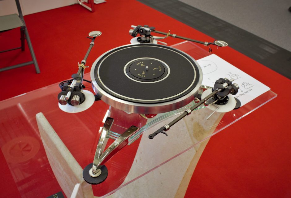

The FX3 doesn't look like it has anything special going on from the outside. The magic with this arm is due to the armtube that has an internal cross-brace (F.X) . Although it goes against my personal philosophy of keeping the armtube short this arm has come closest to matching my diy linear arm in sound quality. Close but not quite. A friend of mine owns one and it has comfortable outperformed everything we've compared it to, Graham, Townshend, Helius, SME, Origin Live.
The Raptor will most certainly use some version of the F.X armtube.
Tangential tracking is achieved using a pulley positioned above the stylus and a second at the rear of the arm, the two connected with a thread. I have no idea what type of geometry has been used.

For a tangential tracking arm, the pulleys, the moving headshell, and the thread to drive the headshell, all make me feel uneasy.
Niffy, thank you for alerting us to the new design in this thread!
Let's be fair and put it in context here. The Funk Firm designer introduced a tangential tonearm prototype called AK1 in 2017 at an exorbitant price of $24,000. But it never materialized into an actual product. For those with good memory, it was covered in a post in this thread at the time and there's even a video of the designer explanation his creation. So it makes sense to assume the new arm is a follow up on that design. Maybe the new one is a more mature and affordable design that the designer is comfortable enough to introduce it to the public. The rotating headshell with thread genre has been covered extensively in this forum before, negative and positive. I do like it that it is out there as an option of tangential tracking.
The criticism of such design is warranted especially in having a rotating headshell right above the stylus. The concern of having the most sensitive vibration detector, the stylus, so close to a bearing is legitimate. But the irony is that one school of thought is to make the shortest arm possible that wouldn't it be possible to make the headshell the actual arm? Maybe. Here's a thought: it would be a mechanical marvel to have a rotating headshell that also allows straight VERTICAL or pistonic movement. Again, I'm just spitballing here!
I would add some concern for those two long strings; notoriously the strings like to vibrate (a string quartet...) by direct stimulation or by resonance.
