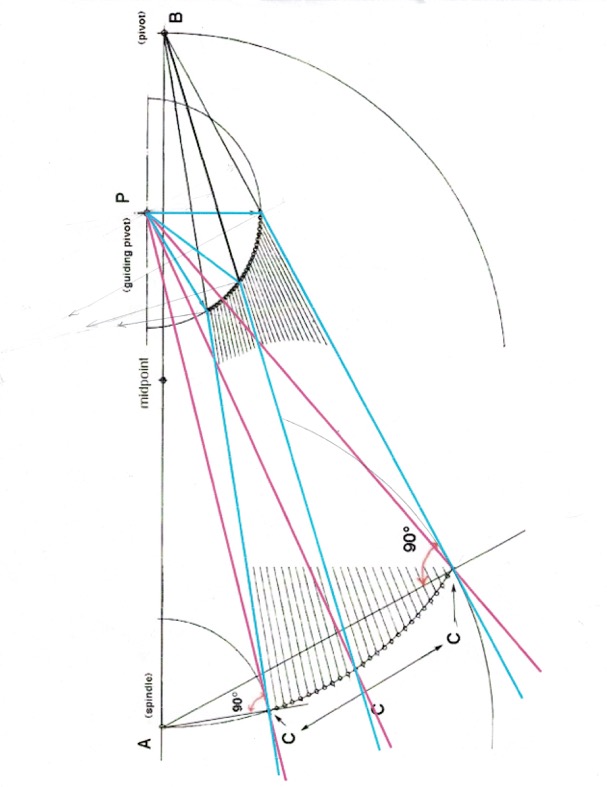

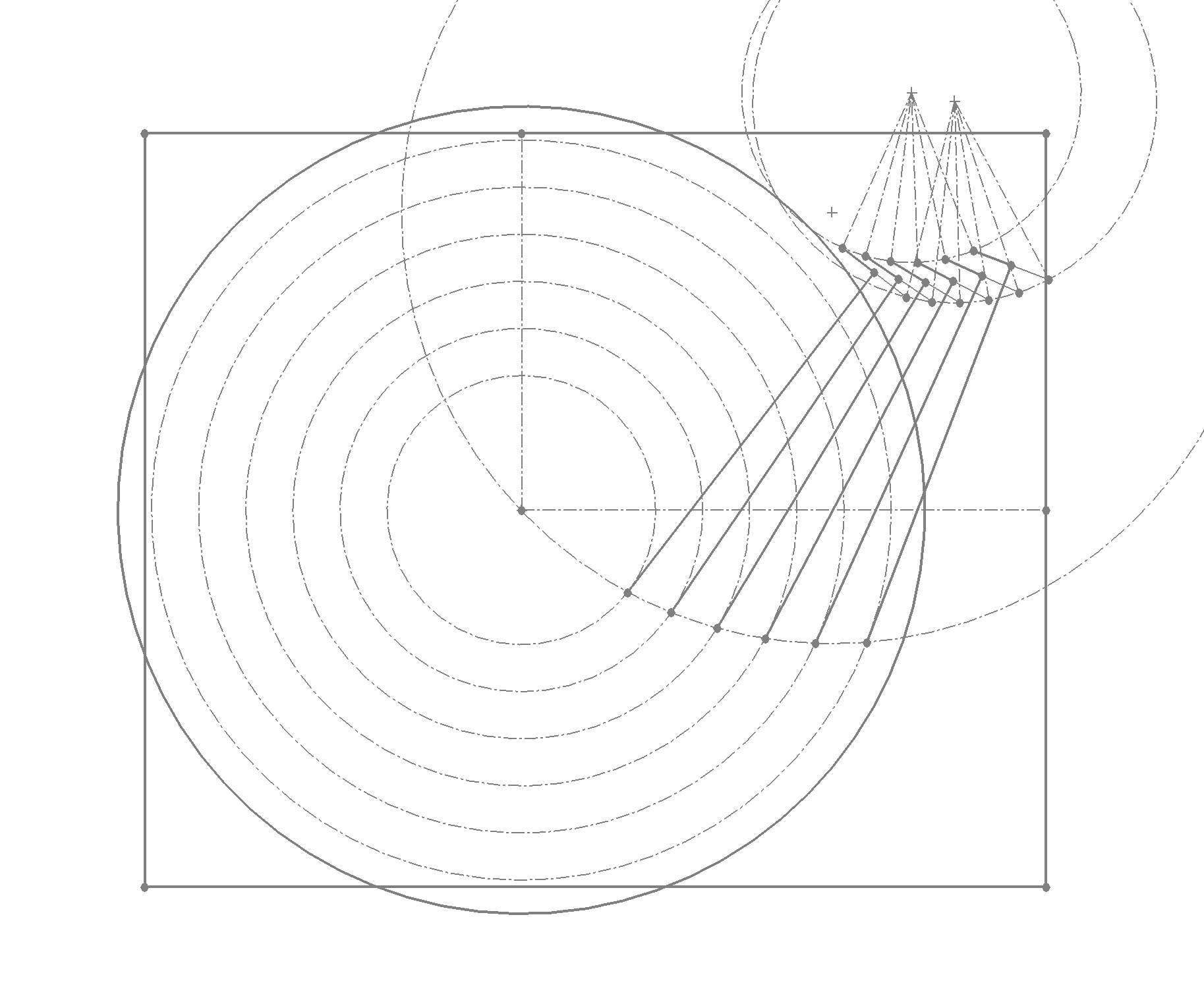

While waiting for 2wice to get his remarkable arm mounted on a TT, I messed around with a couple of drawings.

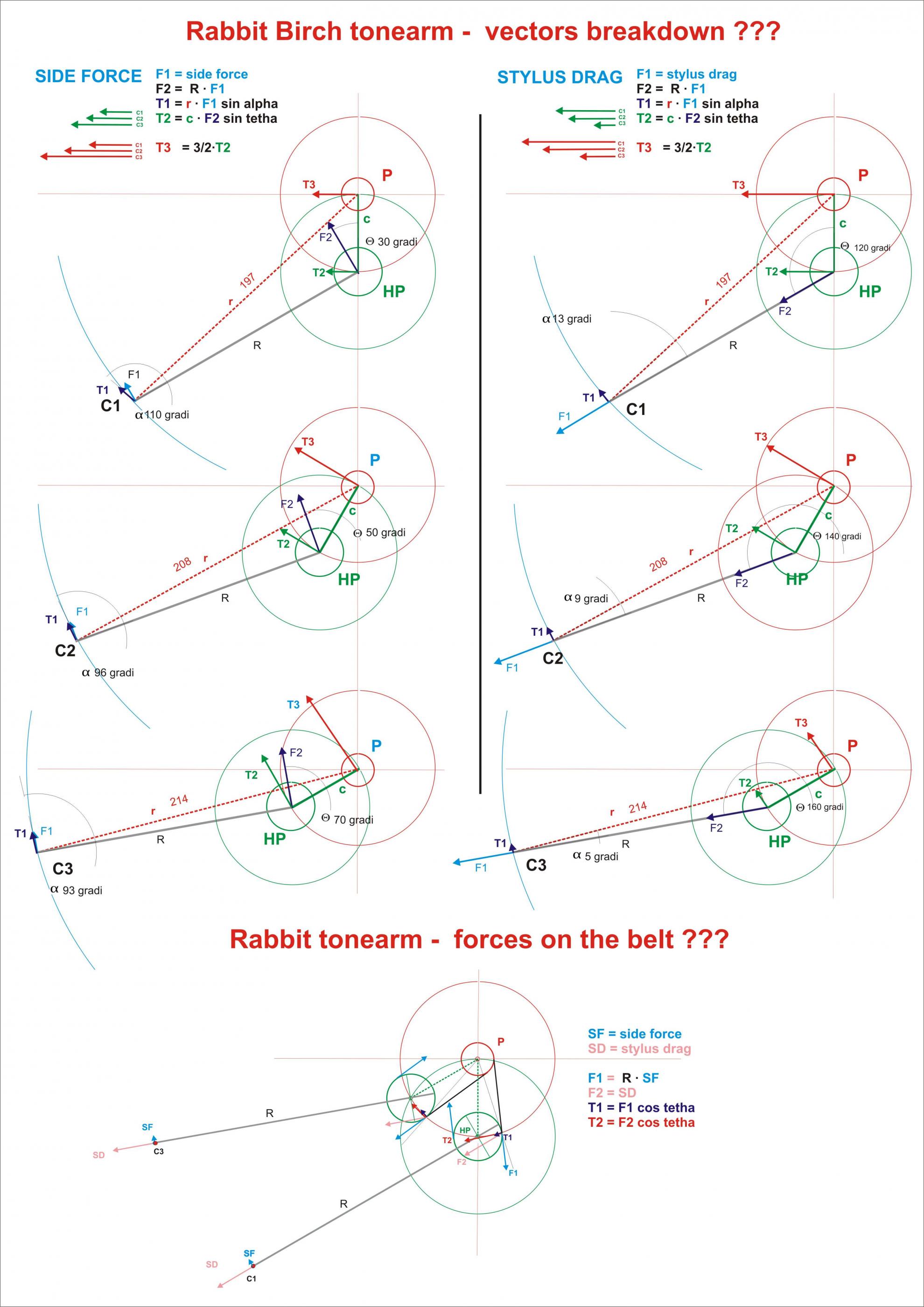

The one based on the Birch/Thales patent is an attempt to picture one of the forces which might cause skating. The blue lines represent an inverse conventional pivot "J" arm with the "J" at the pivot end instead of the normal headshell end. Sort of like Frank's "Alto," I think. The resulting offset at the outer groove is only about 12 degrees - about 2/3 of a 12" Baerwald alignment arm - and it gets smaller from there. In other words, if this is accurate, a small and shrinking force. I believe the straight line from point B through the stylus mitigates the skating forces, but have no idea how to represent that or how to calculate it, but Carlo did with a vector analysis of his Rabbit twin arm.
I noticed something peculiar about the Thiele arm, again. In the drawing, all the movements seemed smaller than I'm used to seeing so I tried measuring them. The angles the Thiele pivot and control arm swing through - 39 and 42 degrees respectively - are much smaller than the equivalent angles in my original drawing - 60 and 50 degrees respectively - and the stylus moves a shorter distance relative to the spindle - 48 and 68 mm respectively. I think there's a possibility the extra arm on the Thiele allows for a more compressed movement and that this design has added a possibly valuable wrinkle to PLT design, but at the cost of higher mass, more complexity, and more bearings.
The skating force on a regular pivot arm decreases at the beginning of the groove and increases towards the end of the groove. The rate of decrease and increase is not linear. For my 6B PT arm, I believe that the skating force decreases from the beginning of the groove. Its rate is linear since the arm is constantly tangent to the groove. And, the skating force should be much lower than a regular pivot arm.
For a double Birch arm, if the links are more than two, it is not necessary, in my opinion, unless there is a particular reason to do that. I don't see any reasons to add extra links for Thiele arm so far. Further study may be needed. Compressed movements may not be good since they will increase tracking errors.

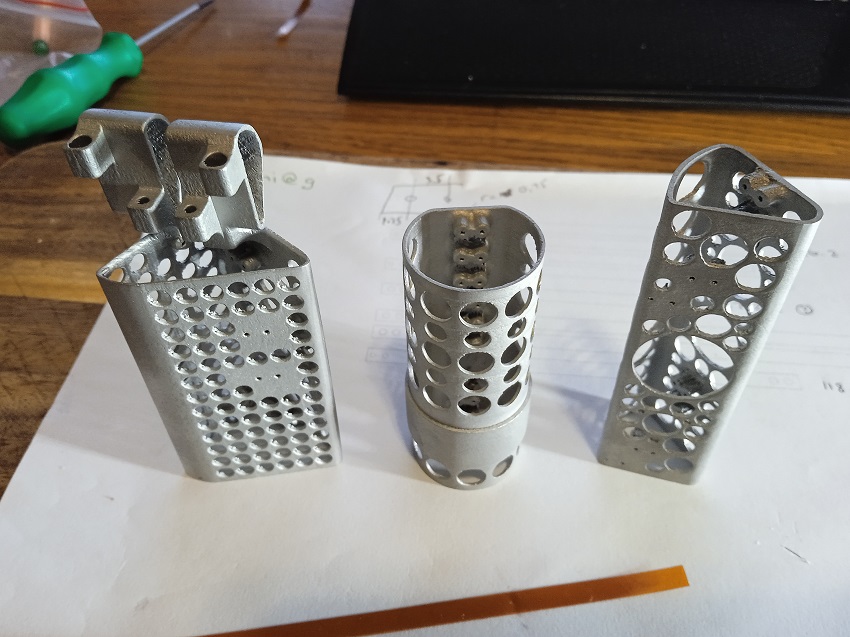

At least the all metal build is starting to come together. Needs some clean-up.

They were very reasonable, $120 for the 3 parts.
Eish is can be many emotions, but mostly resignation, or giving up.
It seems a really fair price for that parts, and the possibility of having complex parts in sintered aluminum or other materials is very attractive for us builders.

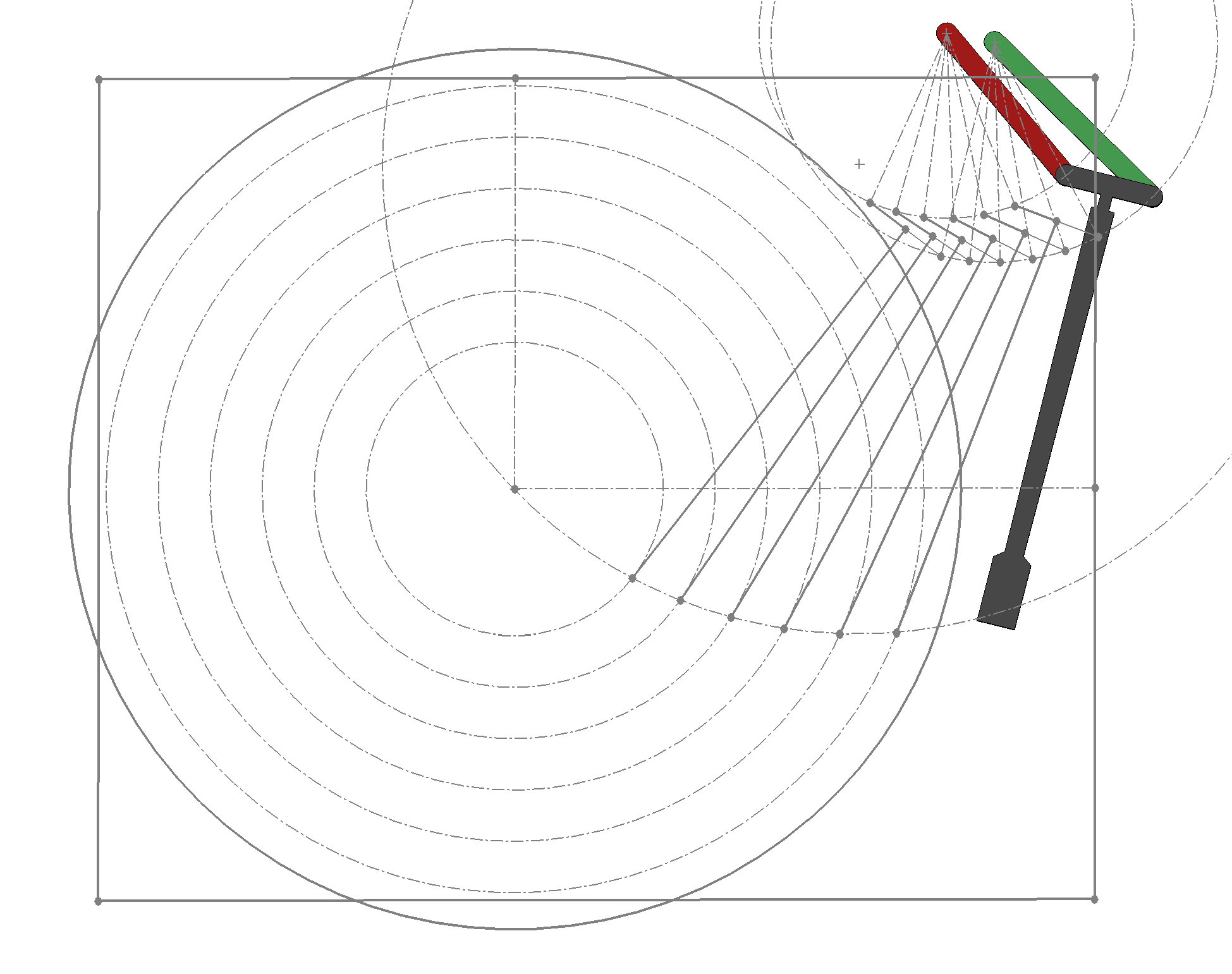

I hope there are yet signs of life in this splendid thread.
I played around with the Linkage simulation software, of which Carlo is a master.
First a Klaudio-like quasi linear tonearm. If we only had good linear bearings...
Video
But we don't. So I replaced it with a pivoted arm, with slightly less precision.
Video
Video
Video
I am probably missing the point here.
But what is wrong with the approach I suggest here.
(I don’t see what’s wrong, but it is so simple there must be something wrong with it.
There is a movie with some lines :
and some drawings:View attachment 1031781View attachment 1031780
This one is the same as one of the two options I didn't use. I will update yet another version of my PT arm later.
https://www.diyaudio.com/community/...king-pivot-tonearm.373984/page-3#post-6762099
