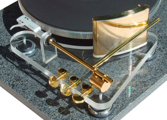

I still can't wrap my head around those horizontal bearings or constraint bands. Since all the horizontal movements are on cams, it doesn't really pivot anymore. Even the vertical movement uses no pivot bearings! It's a form of constrained movement, not linear movement nor pivot movement, and yet almost frictionless!
What is the mounting distance from the center point of the fixed column to spindle?
What is the mounting distance from the center point of the fixed column to the stylus extended to the last groove?
Wouldn't that have to be longer than 110mm (95mm+15mm), right?
I don't see any visible anti-skating mechanism. It reminds me of Frank's ALTO tonearm mentioned in post #71 below. Is it the same concept?
The only precedence I can think of such invention is the Schuch string guided tonearm below and from video 001 and video 002 that uses no linear bearings nor pivot bearings. Sui generis! Obviously, Trenton's design is more stable as every contacting parts have the constraint layers going both directions to avoid any azimuth skewing.

Is it to orient the direction in certain amount of the coiled constraint bands to generate an opposing torque or anti-skating force (or pointing the uncoiling side away from the spindle) and leave it to chance and hope for the best? 😀

Mounting distance is 170 mm for this version, I'm aware there would be some unsuitable geometries, but there are unlimited solutions to this topology and the maths can spit out another solution for whatever reasonable input values.
Effective length @1st groove = 149.93 mm
Effective length @last groove = 164.61 mm
😀 the dice was the closest thing at hand for scale.
That is one of the constraint bands before being stalled, it serves a dual purpose, a very tough constraint band and constant force spring to supply the counter torque.

The Schröder ALTO tonearm is simply what bambo alluded to early that "perhaps a small deviation from strictly vertical so that the arm is lifted (or tilted) a wee bit when moving inward (resulting in a small outward-directed force)?"
Now that you revealed you were using the coiled force to generate counter torque, the ALTO arm does NOT use the same anti-skating method as your design. Both are clever ideas.

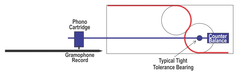

If condition of tangential pivot can be removed, I guess a working simple linear tonearm (With few compromises) can be made on Rolamite Mechanism, mentioned here #1637.
Basically a simple tonearm as shown in picture (Pretty basic drawing) where a rolling cylinder have axial hole to fit in a typical, high quality tight tolerance, almost frictionless bearing which will hold a tonearm wand. With cartridge and Counterbalance on either side.
I know the bearing would make noise but probably this design gets rid of skating force. And I think linear moving friction would be almost nil. The square box holding rolamite cylinders can be inclined slightly +/- if need arises.
I don't have means to make this tonearm. a different video : Rolamite 1 - YouTube

I've had no success applying compliant methods to linear TAs without traditional bearings.
Fixed pivot TAs have been easier. This is a possible solution.
Operation has not been confirmed yet.

Congratulation 2wice. you did it. A long run from the start, I remember well
It seems - and it is - something completely new: in conception, geometry, movement transmission, and even materials are completely new for these applications.
And also the aesthetics are remarkable: seems more "Alien" than a Tone arm, and this is part of its charm; new concepts cannot resemble old ones.

Each of the cams have a pivot point, the coordinates of those, the mounting distance and the wand length are the input values for the maths to generate the curves of the working surfaces.

From the videos posted by 2wice, they look very convincing that the mechanism has very low friction. But it will be nice to see some kind of test to indicate its friction and to compare its friction to the friction of traditional pivot arms.
I've booked the VMC for Thursday to machine the last cam.
One of the things I enjoyed the most building this arm was being taught how to program and operated a milling machine.
One of the things I hate the most about building this arm is all the expensive tooling I've broken on the VMC making rookie mistakes.
This is a previous prototype with spring tensioners and probably the point I realised I've got a thing going, and I went from fully 3D printed parts to 3D printed cores and machined cams. I also cut the weight by 50%
The finish on the cams were ok, but I was using cheap import tooling.
The surface finish with the new tooling is like glass.
I've been very lucky to have a very talented machinist mentor.
Monday I will complete a Niffy pendulum with a micrometer to drive the rod, so I can get some numbers.
I still get a kick watching peoples faces when they have this in hand.
It is best described as, WTF! As it is impossible to bring to a standstill.
I have a build process in mind to cut the weight and up the stiffness even more.
