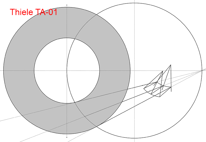

Thiele TA01
More pictures and test of the very interesting tangential tracker from the German website HifiStatement net-magazine.
Along with Thales Simplicity, Schröder LT, & Reed 5A, the Thiele TA-01 provides another option as a ready made commercial product in the genre of passive pivoting tangential tonearms. And the Big Four all exceed the $10,000USD price tag!
Early prototype.
Early prototype.
super10018,
Thanks for the Thiele arm geometry drawing. Thiele's own drawing was difficult for me to understand.

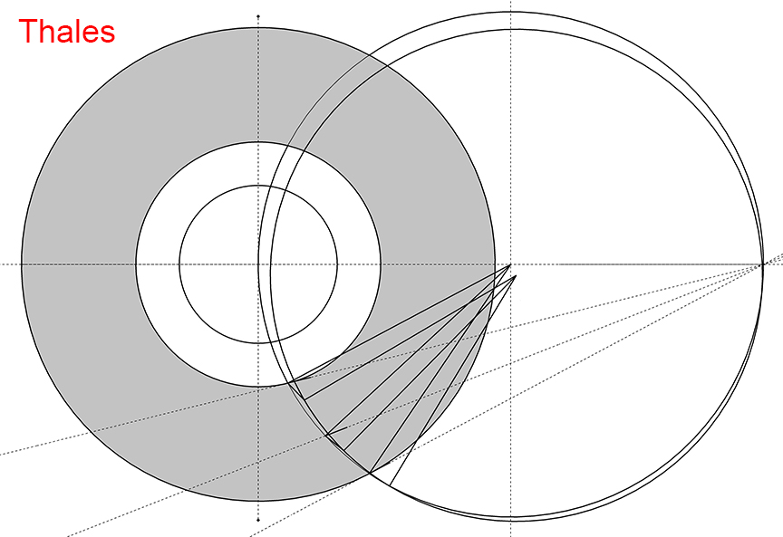

DD - or anyone else - was there ever a commercial tonearm based directly on the Birch/Thales geometry?

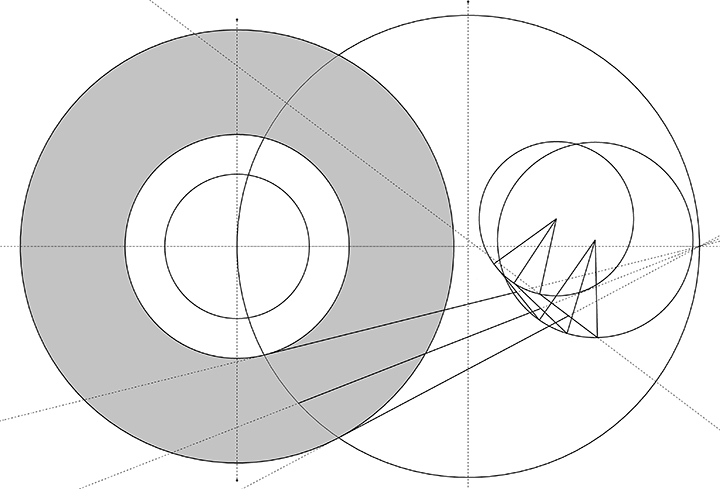

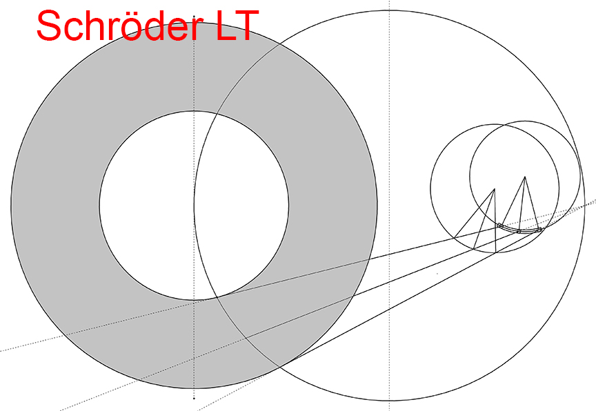

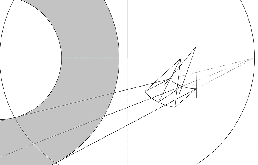

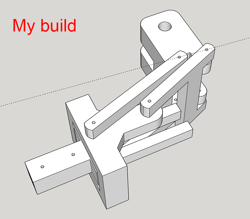

Here are some geometries of commercial tangential pivot arms. You may see that all tonearms use double Birch and Thales theorem except Thales tonearm since I am not sure if I can say that they use double Birch geometry. I also include a drawing of my ongoing build. The reason I tried to find an alternative other than Reed 5A was because I thought Reed 5A has room to improve. Although I found the geometry for my build independently, I have to admit that Frank did it before I did. My idea collides with his LT design. This is why I reveal it here. But I don’t intend to use a guiding slot as Frank did. In my opinion, a jewel bearing may be better than a guiding slot. I also thought of using a magnet as a guiding mechanism, but I gave it up since I think it introduces unnecessarily complex. I think my build will skate but it may not be as significant as regular pivot arms. I do not intend to add any anti-skating device but a pre-loaded bearing may work nicely. However, my build is not intended to play records so I am not going to add any pre-loaded bearing though I do have a couple of ideas for pre-loaded bearing. This build is purely for fun.
I also included an idea I published here before. Both geometries, in my opinion, are very interesting, simple, and practical. This is why I published it here. I found many alternatives. Some of them are nice, too. However, I don't think I need to publish them here. Again, I do think both my ideas are better than Reed 5A structurally. My ideas are simpler and they integrate the main bearing with the construction of the tonearms beautifully.
Hello gentlemen,
Thanks for putting those drawings side by side, as the show that Reed, Thiele, some of the DIY efforts are principally the same. Just as one can built an LT following that schematic.
The difference is the lack of need to adhere to a strict radius/circle segment, due to the magnet following any(straight, ellipse-segment, circle segment, parabolic...) guide rail.
If one is to substitute the guide magnet with a marker/pencil, then follow the path of the stylus tangentially, the marking/line by the pencil left will describe the required curve segment, - and it obviously will not automatically be a circle segment.
Due to the changing angle of the attracting force (magnet- rail), the proximity changes under load(friction: stylus - record groove)from beginning to end an so, needs to be compensated for. That may appear difficult to achieve/execute, but the absence of all the linkages, additional bearings and indifference regarding structural integrity/resonance behaviour comes to what I see as less complex.
All the best,
Frank
All the best,
Frank
Frank,
Thanks for correcting my drawing!
I used a circle segment for the rear guiding mechanism just because it is easy to deal with a circle segment. In reality, there is no huge difference for different guiding rails at all. Tracking errors are almost inevitable for different types of guide rails. I adjusted the parameters of the arm so the tracking errors were minimized. According to LP standard, the minimum center ungrooved area is 4.75" in diameter. My build has zero tracking errors in about 2/3 grooved areas. In the rest of 1/3 areas, the maximum tracking error is less than 0.1 degrees. Even for these tracking errors, I purposely constructed the arm so that all the tracking errors are on the most outer groove only. In my build, I am going to use magnetic counter weight. This is another reason why I tried to avoid magnetic guide.
Jim
Jim
