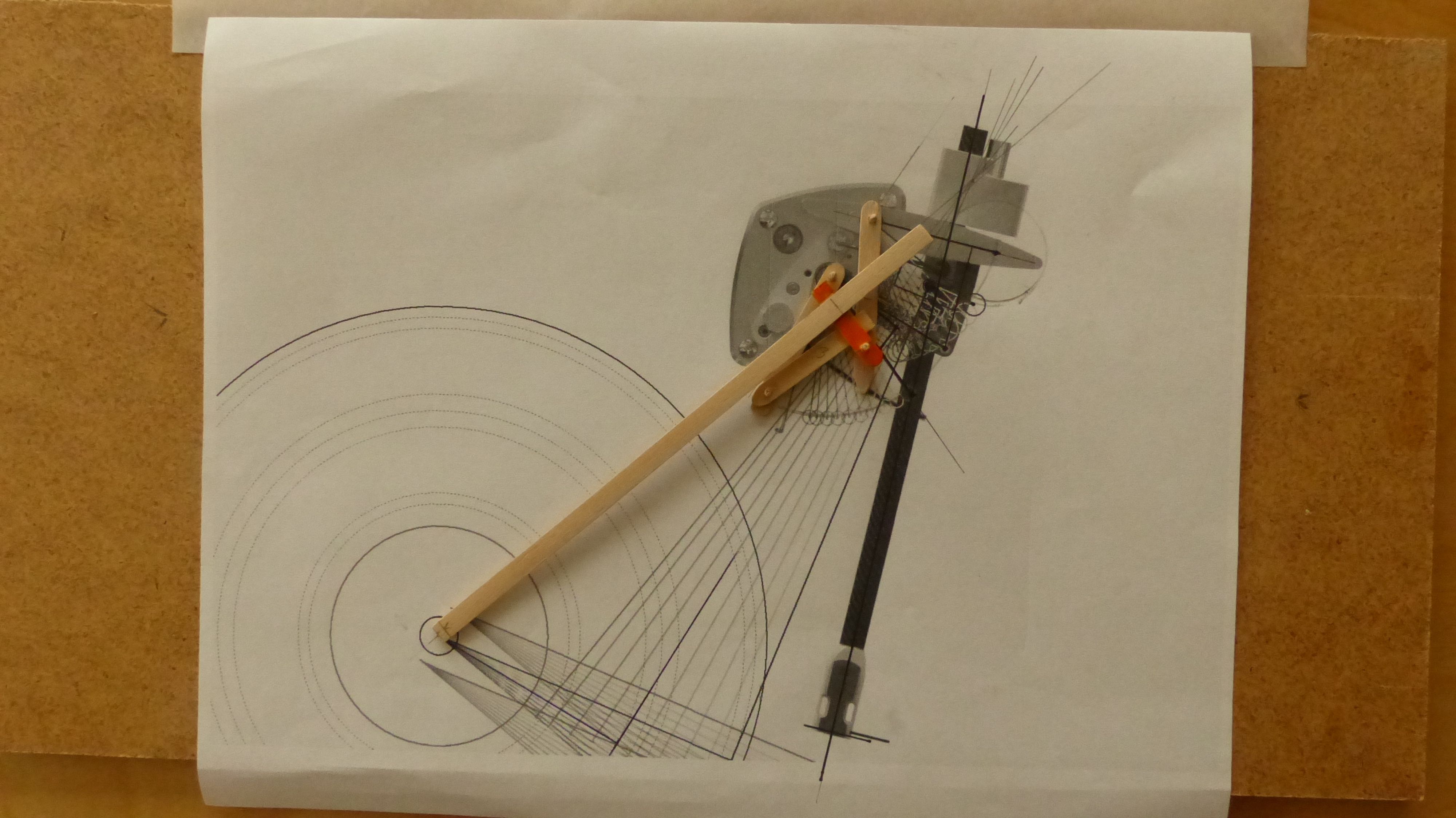

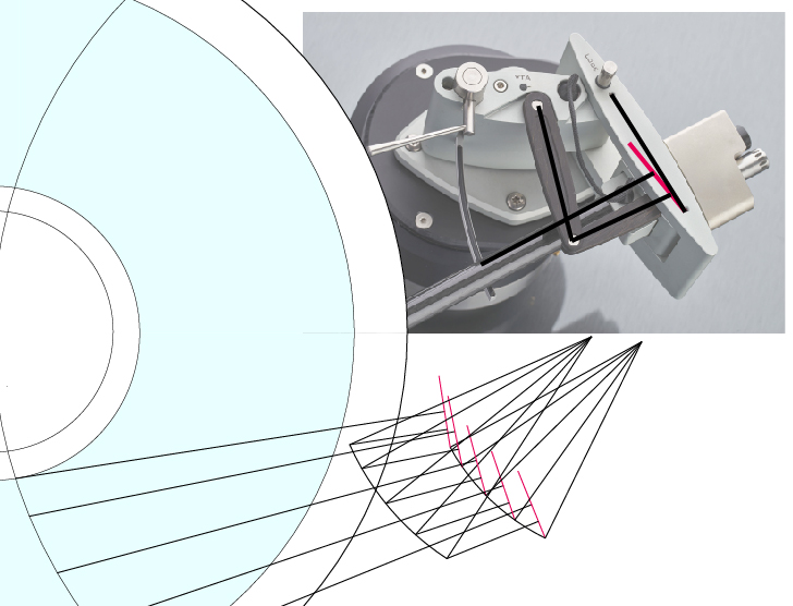

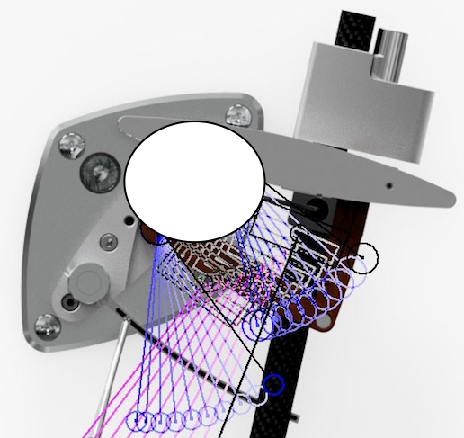

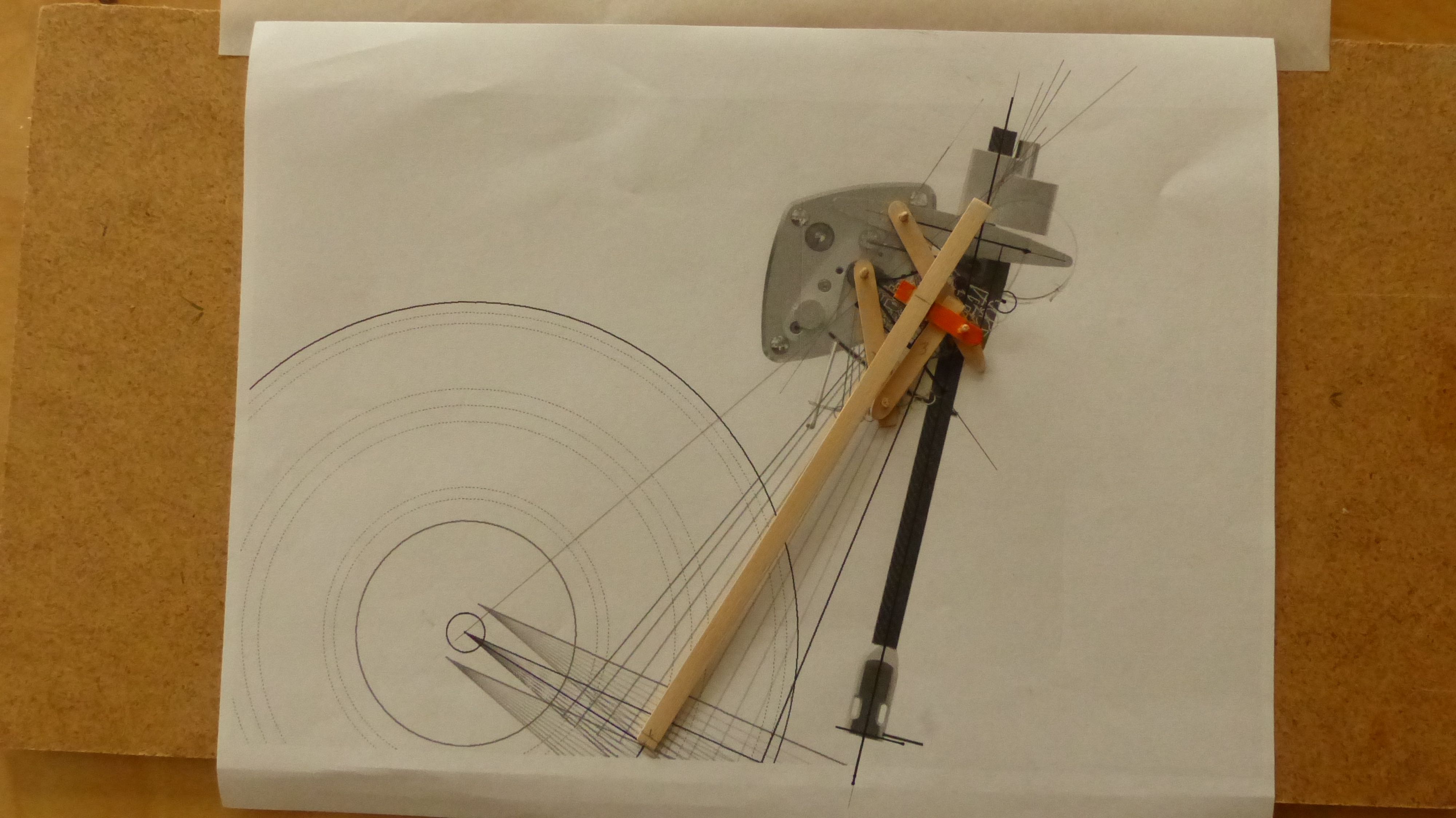

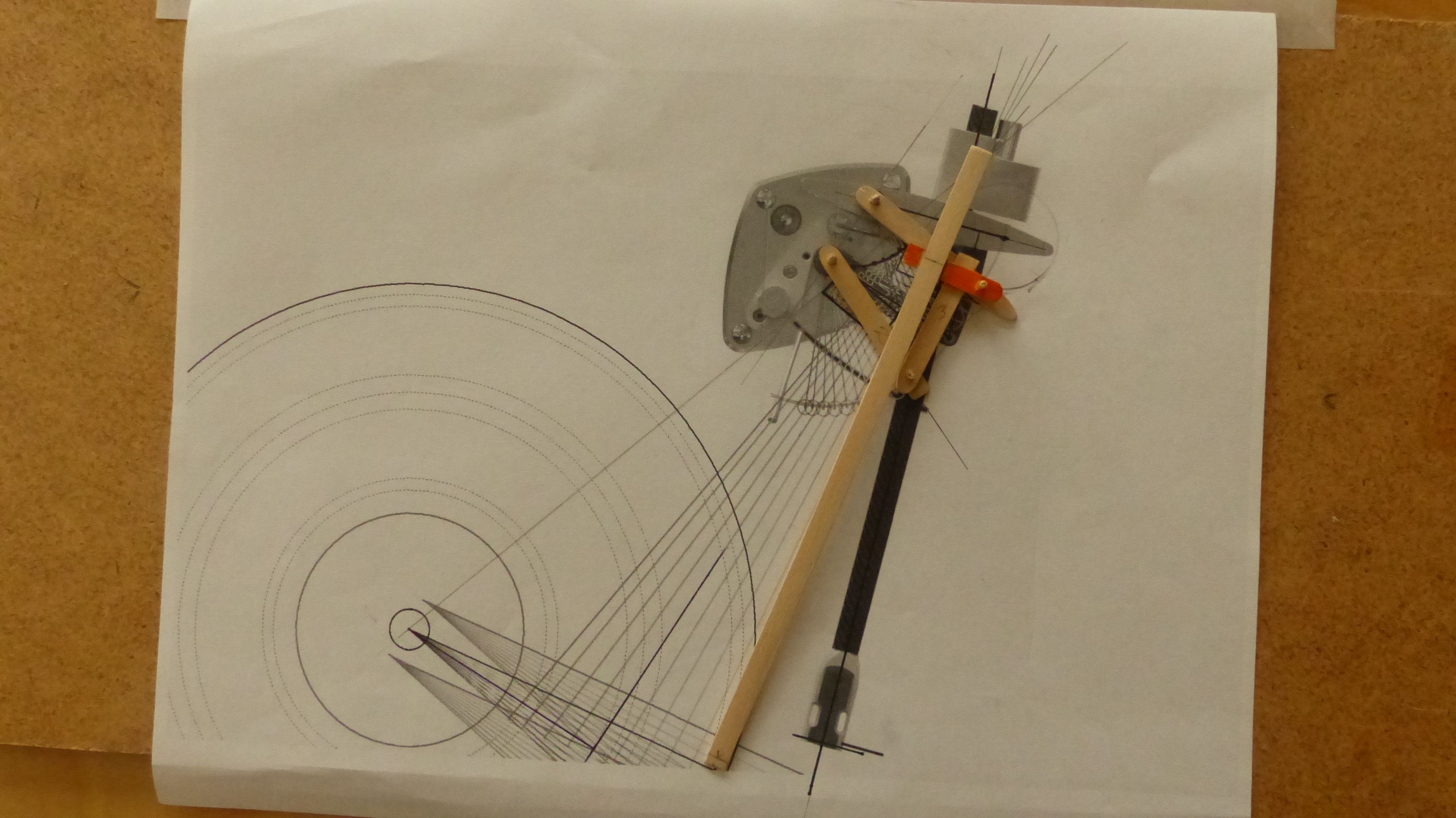

There was something about the Thiele TA01 that caught my attention - an extra part compared to other twin arm PLTs - so I built a model based on Thiele's drawing of the geometry and movement of the arm.
The extra part is the small orange arm, which actually carries the vertical bearings and the wand. Kind of a lot to ask of a small part. In effect, the TA01 seems to have two control arms making it a three-arm PLT and the third arm is probably the critical factor. If so, it's an interesting contribution to Birch-based design.
The drawing is cluttered and not particularly accurate, possibly deliberately, but I think I got the important parts and the model followed tangency quite well.
One part of the drawing seemed to reveal something worth checking out. Thiele is claiming zero tracking error, which usually indicates an ellipse segment somewhere. The track of one corner of the vertical bearing/wand carrier was fairly clear and looked like it might show that ellipse so I parked an oval there. I'm not entirely convinced, but the fit looks pretty good to me.
Hi Doug,
You are right. I modified my original drawing slightly to better reflect TA01 mechanism. In fact, the fundamental principle is still the same, but the implementation is slightly different. Please see my new drawing. The red lines represent your extra link in red. In my opinion, such an extra link is not necessary. I don't think TA01 is following an ellipse at all. I also don't understand why they use two pieces of wood in the link. Isn't aluminum better?
I don't think an ellipse is necessarily more accurate than a circle. There are many parameters that have an effect on tracking errors. The shape of the guide is one of them.
I personally prefer the geometry of Schröder LT tonearm although I found it independently, too. It is simple and elegant without extra links.
Jim
