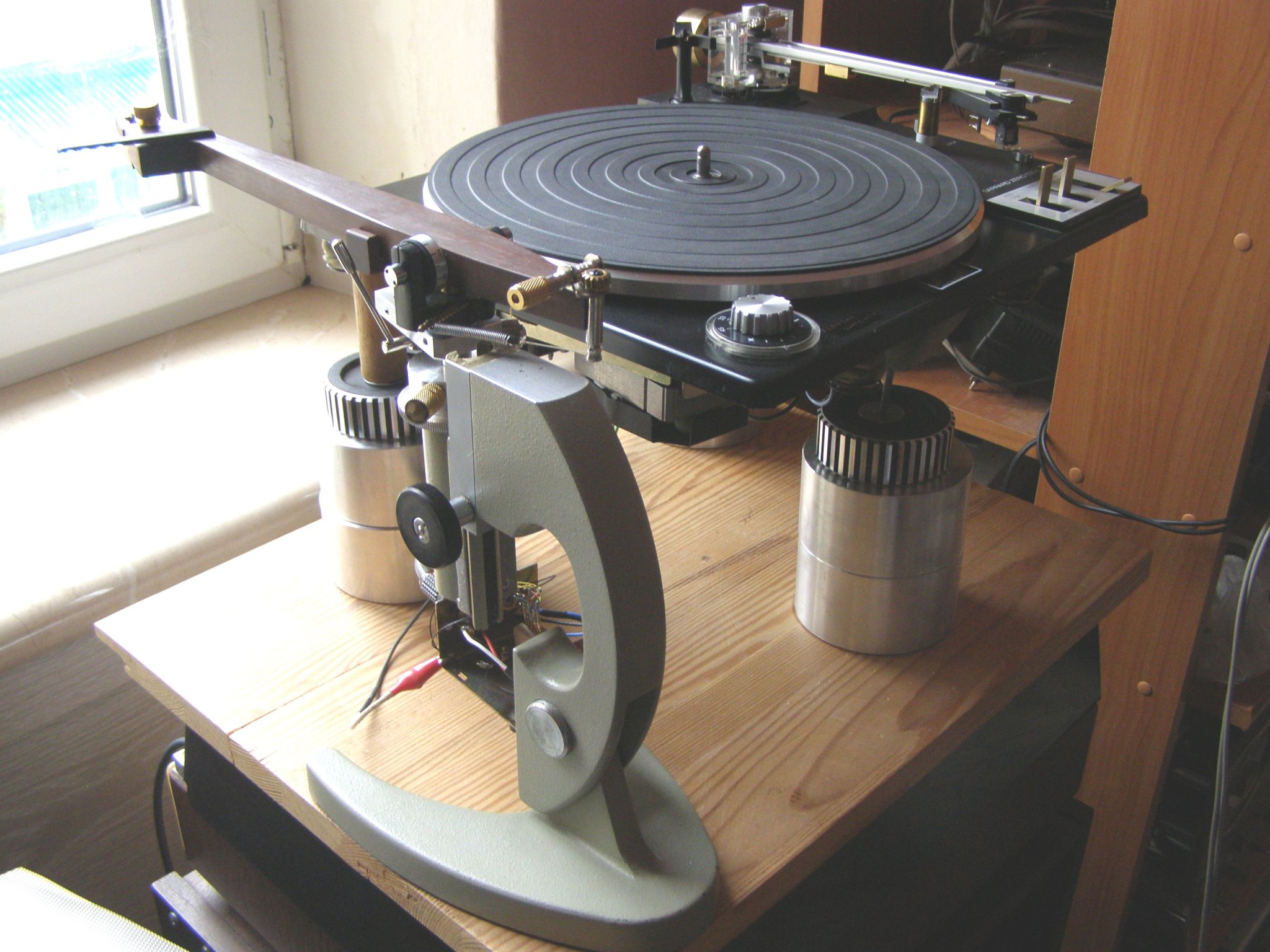

I recently built a new version of the twin arm PLT. Because it‘s string suspended, I started a new thread called Tightly Stung.

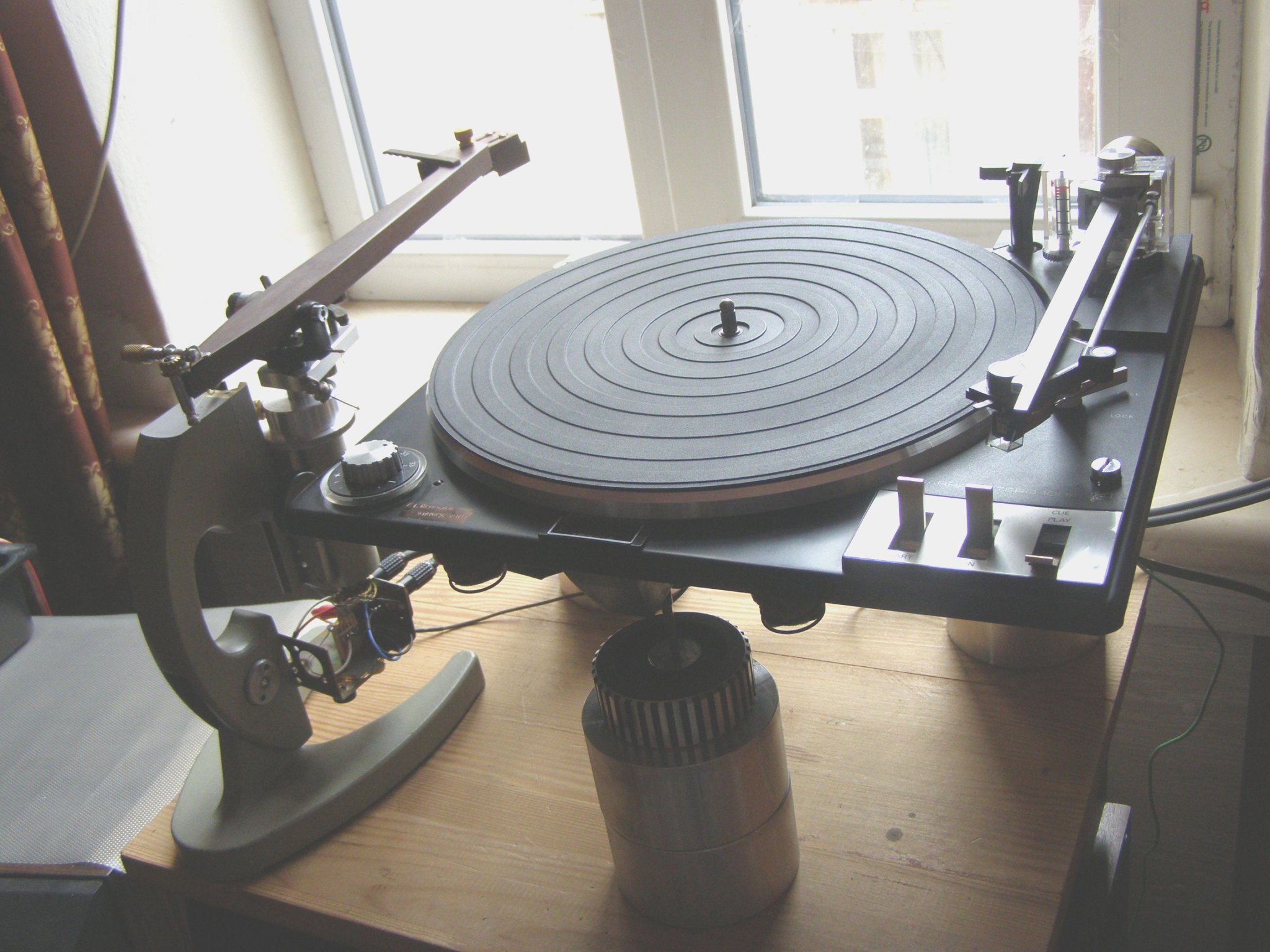

More than 2 years passed since our last chat, I failed to have a fly wheel well working as was supposed to be so as I mentioned I had started the work for the LT clone for my use. But after the ordered bearing where not delivered to me ( confiscated in Amsterdam for unknown reason ) I also stopped that project and made another different TA clone that I am using at the present.
Howver recently being in winter I decided to restart the LT project re checking the geometry, ordered new bearings ( hoping this time they delivery them ).
However even use the following dimensione I cannot get the cart make a straight line across the LP, no matter what I change there is a kind of curve.
Is it normal that there is a kind of curve or I just did not get yet the right geometry:
From vertical TA want to cart tip I use 250mm
From spindle center to bracket first pivoting center 275mm ; but I have also tried 280mm and other shorter and longer dimension. The 2 swing point of the bracket is 35mm, but I tried 38mm, 30mm and some other dimension.
I am in a loop without a solution to get a really straight line with the cart.
Therefore I cannot post any practical result so far.

Hi Adelmo,I am in a loop without a solution to get a really straight line with the cart.
A happy new year to you too!
I really know what you're going through. Been there already 😉
Luckily, math, Excel and 300 lines of VBA code can do the trick.
I developed this file that can help anyone build their Schroeder LT clone.
What you need to get out of your "loop" is the red curve that my application generates.
Good luck and ping me if you need more details 🙂

Great! For security reasons all macro enabled Excel files are protected by default. You must first enable it.Finally I manage to open the file. Figuring out how it works.
How it works: In the sheet Drawing there are four cells highlighted in green. Those are the input parameters you can choose.
After that, clicking the button PLOT will draw the red curve representing the magnet guide path and the whole tonearm in several key positions, according to the selected input parameters.
Sometimes you can get a message box asking you to change some parameters. That's because the values chosen at that time yield a physically impossible structure (for example a sine or cosine >1).
Good luck!

Hi Adelmo,
Yes, in the beginning the name "linear tracking" is a little bit counterintuitive or misleading for this design.
You were probably expecting the stylus to have a straight line trajectory, the same as for the linear trackers using air bearings.
But here it's not the case. What matters is that, at any moment, the tonearm is tangent to the groove, so between the tonearm and the record spindle there are always 90 degrees (the green dotted lines in my drawing are showing this). The fact that the stylus is describing a curve along its path over the record has nothing to do with its "LINEAR TRACKING" ability. In this context, "linear" means "at all times tangent to the groove".
I hope my explanation makes it clear to you 🙂
