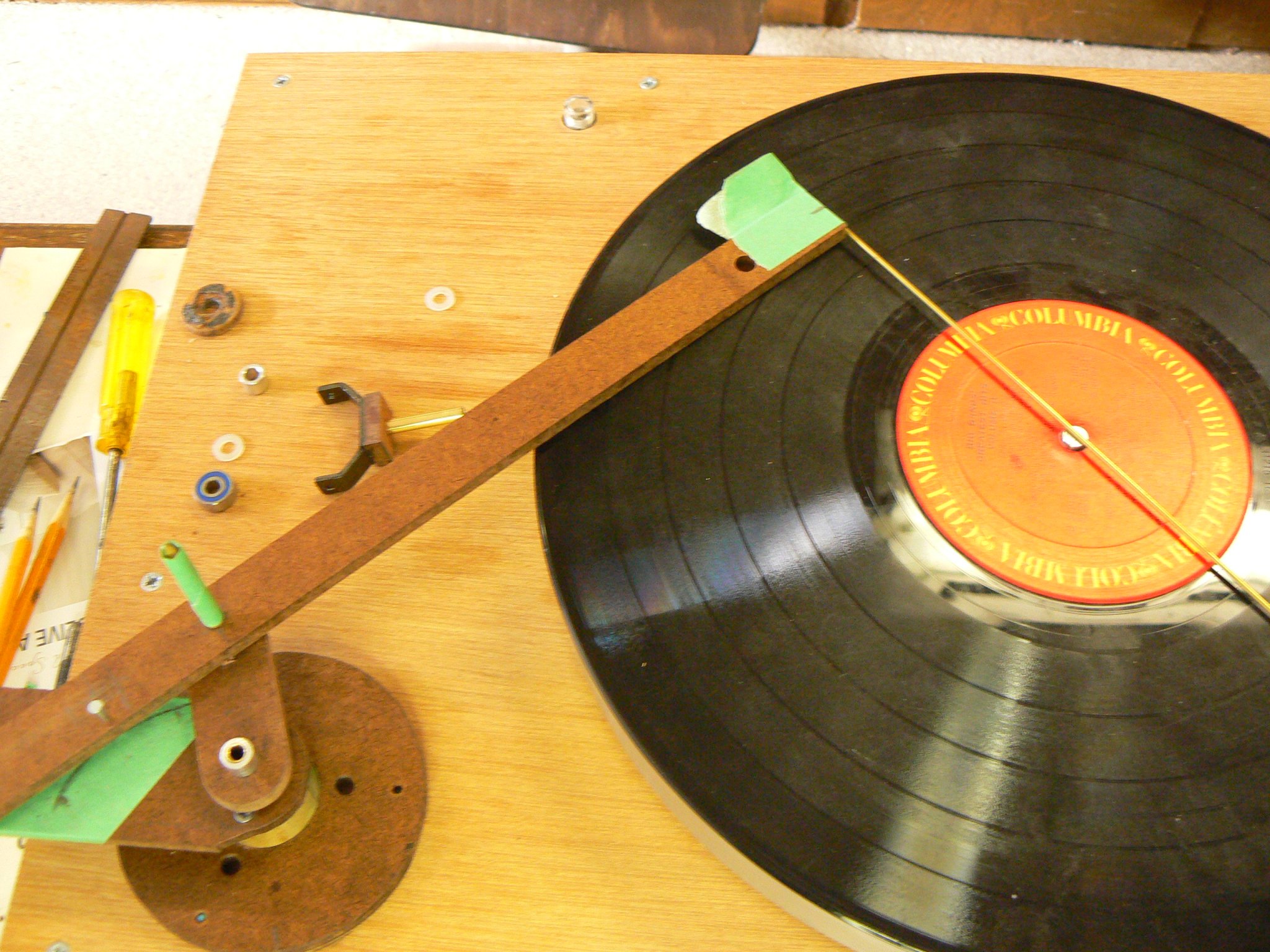

Adelmo, I posted a mechanical way to get the curve back at #842 on page 43. The idea about how to do that was generously offered by Frank Schroeder. I tried to move the photo here, but that didn't work. Maybe someone else knows how.
I built a successful clone of Frank's PLT, but didn't post it because of possible IP problems at that time. It wasn't very sophisticated, but it did track accurately and allowed the cartridge to produce very decent music.
Found it. A pencil lead will work, but a trail of points made a something sharp like a small nail works better.

Hi Doug,
Yes, I fully agree with you about the chart calculation posted from Consty, it is a kind of genial of him too and deserved more attention.
Regarding the mechanical way you have posted for which I thank you, was a similar way I was following up, but I did not understand before that the cart was still making a kind of curve. Consty told me that with this system I could not achieve it as this TA it is not exactly like the real linear type with linear track guides.
Now I understand a bit more on how this TA is working and as I am resuming the project. Also I am taking out from the garage the old Lenco not used ( modify the standard plinth for this TA ) as I think this genius TA it is better fitted on a non floating TT.
By the way for the vertical motion of the TA I was thinking something similar to the Supratrack TA ( like an Unipivot but with 2 pivot working in the horizontal plane and not in vertical )

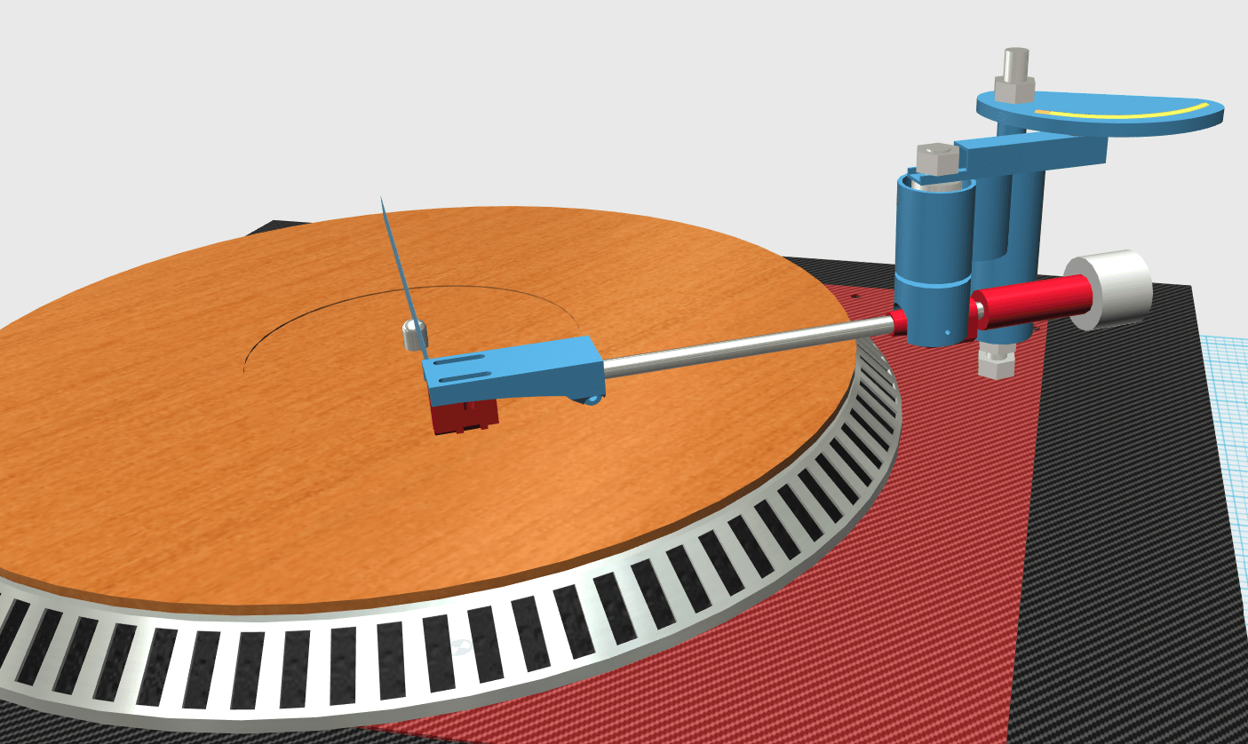

Hi Consty,
The rendering looks very good, but to me seems that the vertical dimension it is a bit big and could generate a negative momentum. However, considering the limited space you have in the bottom of the TT, good idea to expand the TA in the upper line.

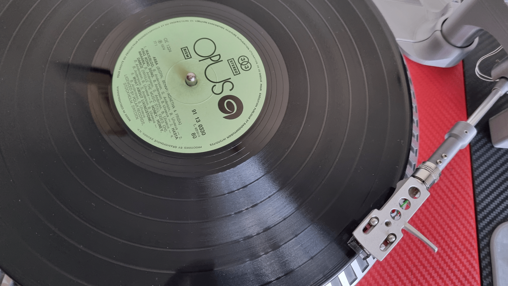

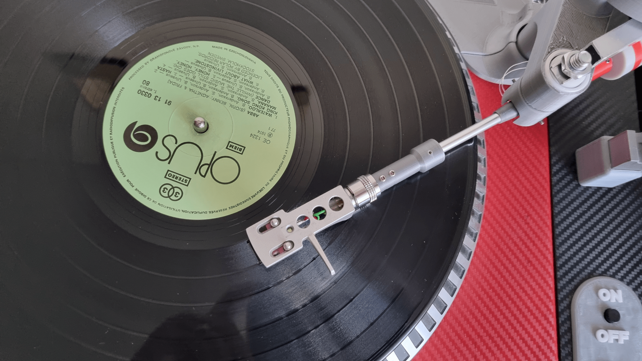

Yes, indeed. I would have liked to keep it as flat as possible but, as you noticed too, since there wasn't enough room in the lower side, I had to be creative and go upwards 😉. I hope this wouldn't negatively impact the TA performance. Anyway, one of the main drawbacks of this type of design is that it requires absolute spot on vertical alignment of the pivot. The slightest "Pisa tower" leaning would result in a pseudo skating force much stronger than the real skating associated to the conventional pivoted arms.the vertical dimension it is a bit big
I didn't check diyaudio for long time. It is so true. The arm itself doesn't generate skating force at all.Anyway, one of the main drawbacks of this type of design is that it requires absolute spot on vertical alignment of the pivot. The slightest "Pisa tower" leaning would result in a pseudo skating force much stronger than the real skating associated to the conventional pivoted arms.

Consty,
My suggestion is to reduce the height of the tower as much as you can. So, the skating force caused by the unbalanced tower won't be amplified. I actually did another version of my PT arm. I tried to reduce the height of the tower as much as the design allows.
Looking at your design, I am not sure how the rear guiding mechanism works. Please note that on Frank's arm, the slot isn't a part of the guiding mechanism. It is only a protecting mechanism.

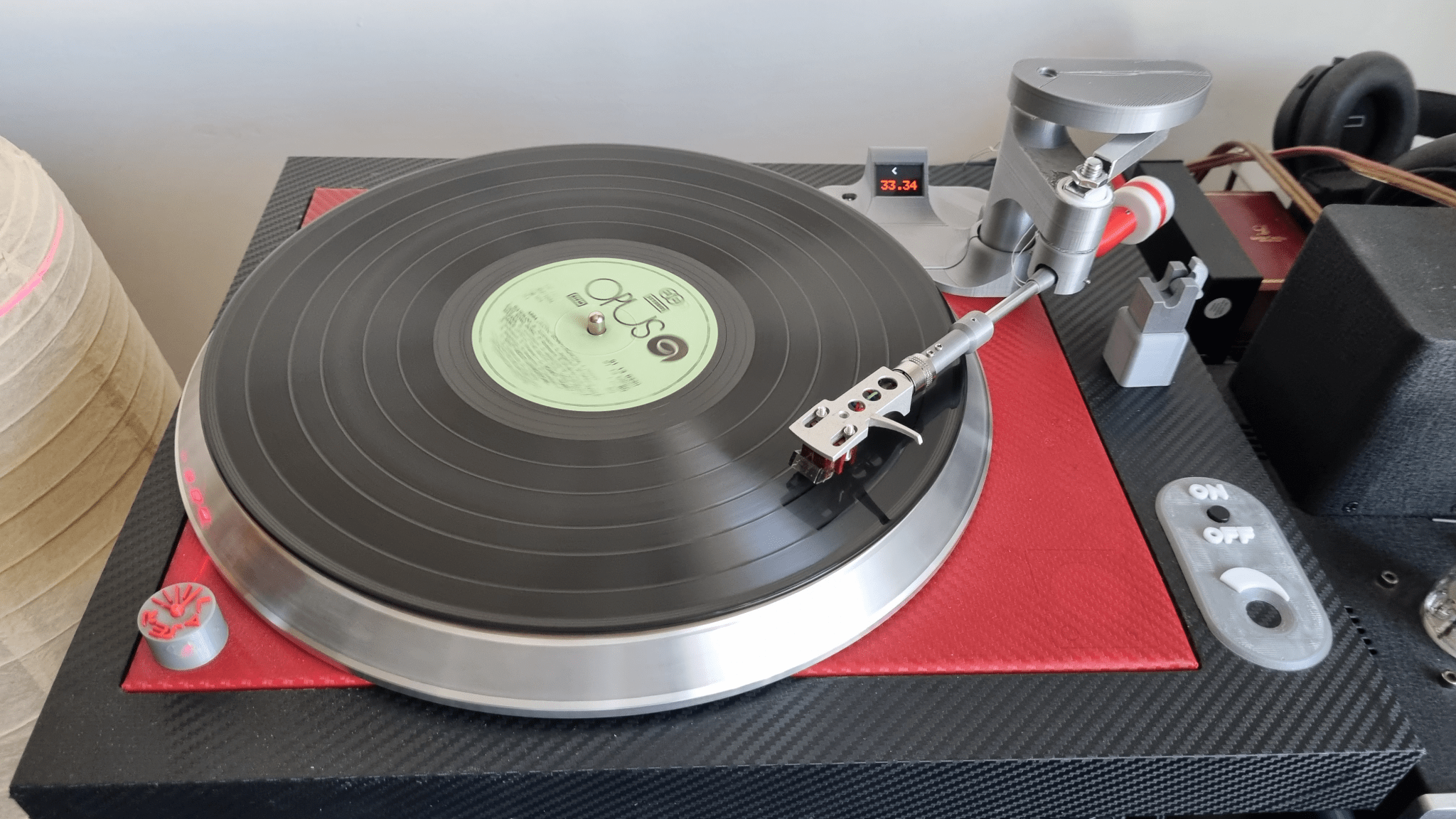

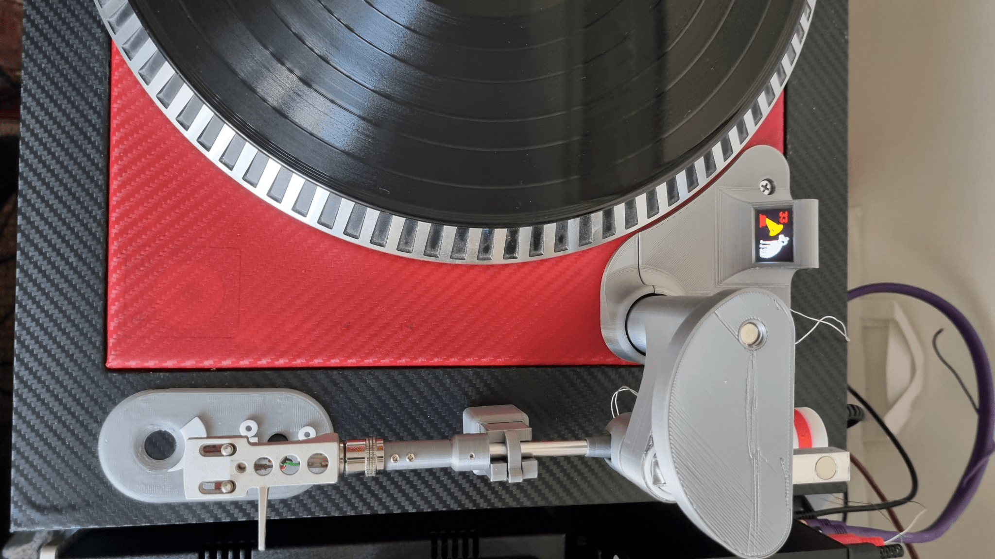

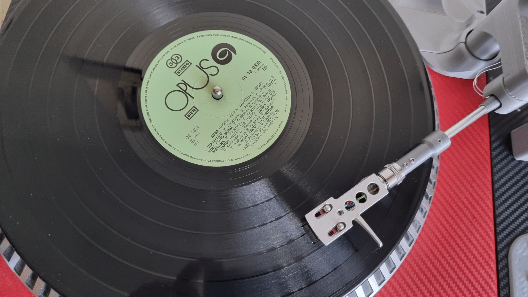

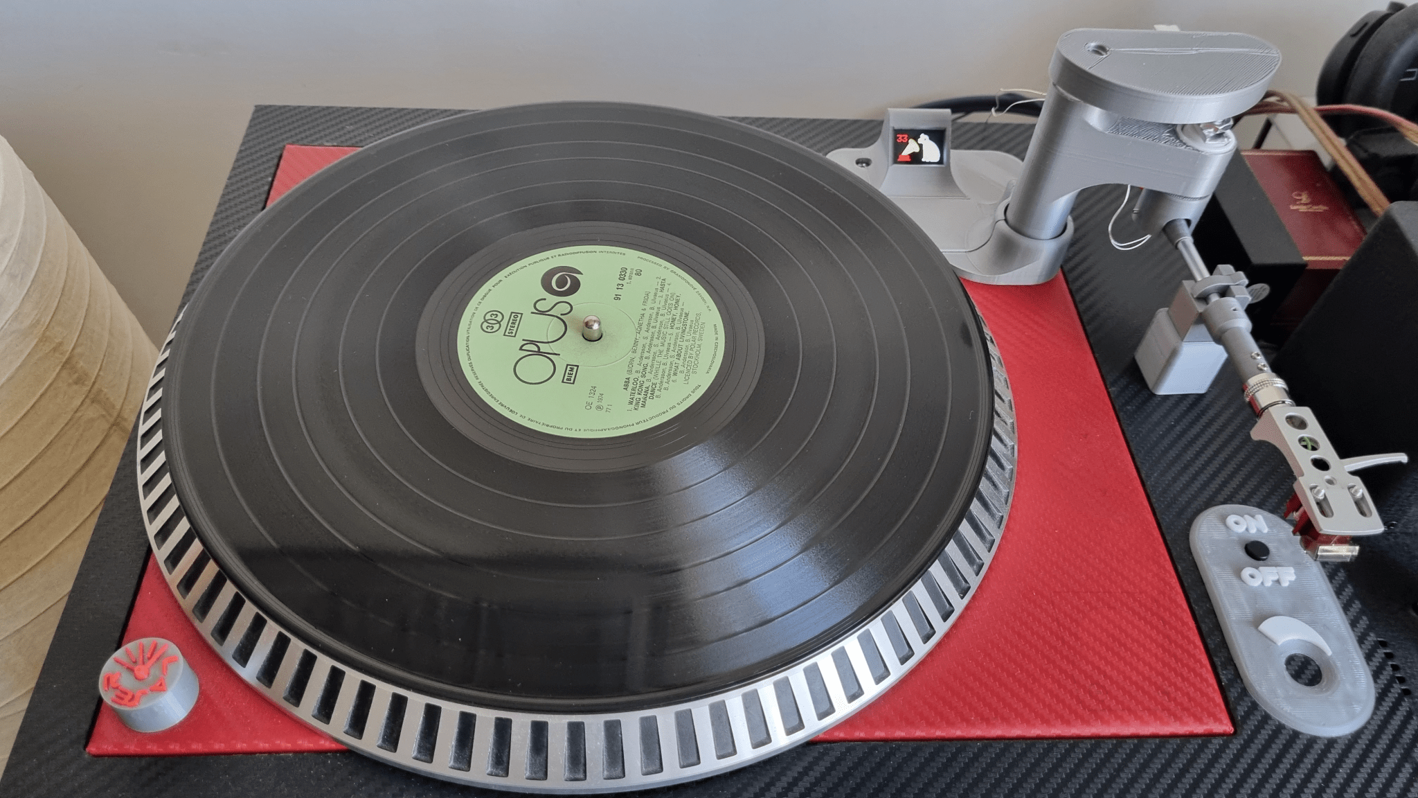

I finally did it! It took me some time but I must confess I'm very pleased with the final result. It tracks perfectly tangential, no skating, no worries.
Once again kudos to Mr. Schroeder for his genius idea!

Sounds as good as my previous air bearing linear tracking TA I built some years ago, with the bonus that now I'm not worried about record skipping each time the tiniest grain of dust got in the way of the moving part of the air bearing 🙂And sounds like?
Looks fine execution too! - always nice to see execution much better than mine!
