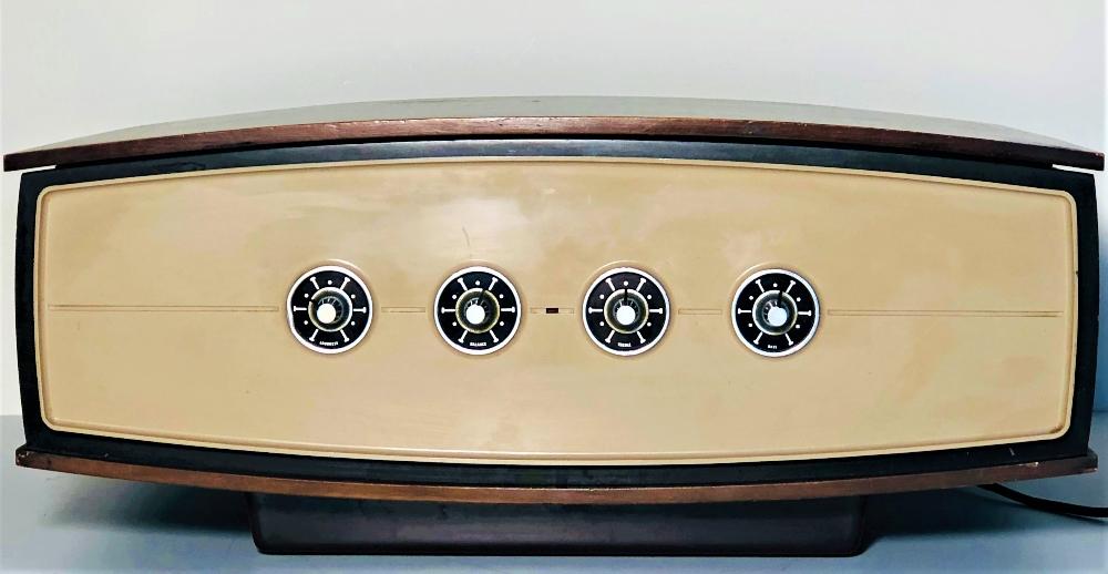

Nice copy of The Cats and a beautiful Pyle 1005 all in one. No idea if it works as there was no plug but it’s just so pretty!

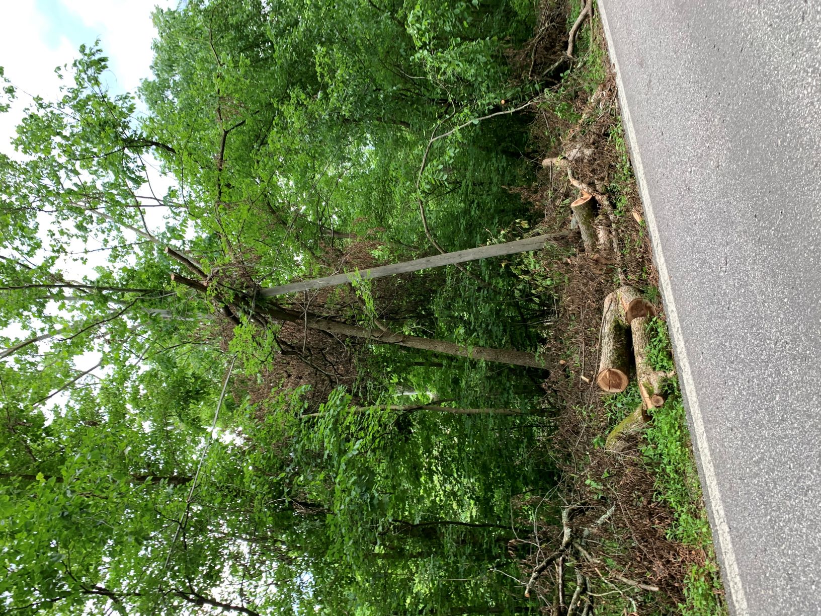

We are about 2 miles outside a small town in rural West Virginia. Our Comcast connection varies from uber-fast to not working at all at any given time. The usual trend is for maximum speed on a Sunday morning and worst case on a Friday night right about now, due too many people streaming video down the same cable.
One of the poles holding up the cable rotted in two at the ground line back in June. Comcast simply cut a notch in a nearby tree and hung the pole and it's cable in the tree. Five months later it's still the same. Another pole came down last year, they just took it out and left the cable and the distribution amp hanging. SO, when the wind blows and the cable sways, the intermittent connections cause momentary dropouts that cause pixelation on the TV and confuse the DVR, but cause the cable modem to reset, then go through its two to five minute reboot process. We have no internet or phone service during this time.

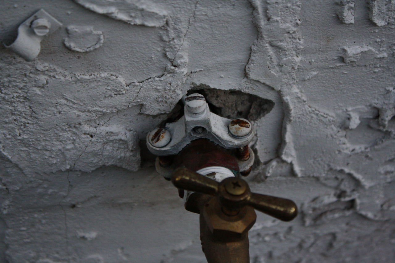

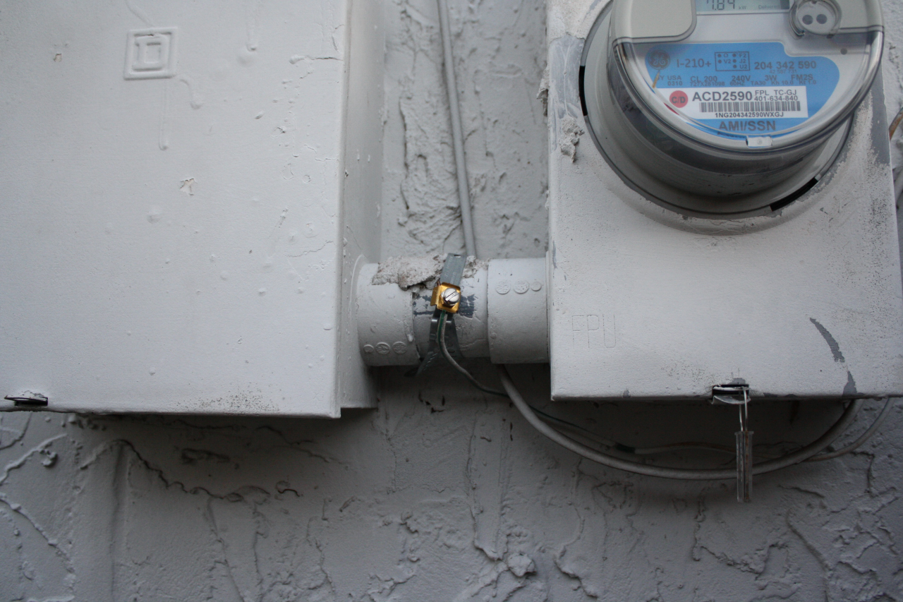

As I was leaving for work one morning a Comcast contractor shows up in my yard to "inspect the ground bonding" on my 20 year old cable installation which was actually working good at the time. I had to go to work, so I left.
I got home from work after dark that night, but found that my TV had a buzz in the sound and visible hum bars in the picture. When I disconnected the TV from the cable I got a minor electrical shock. The TV worked fine with a simple wire antenna. My AT&T wireline home phone also had a minor hum that it never had.
I got up the next morning to investigate and found some stupid and illegal electrical work, so I called Comcast.
I explained that their contractor had screwed up the system, creating a dangerous situation causing me to get shocked, and making my TV unwatchable. They said that they could get someone out there in a couple DAYS! I then explained that I was leaving for work in about 45 minutes, and if someone was not there before I left, my next call would be to the local city's building inspection department to report a National Electric Code violation causing me, the homeowner to get shocked. A worker and a "suit" were on site in about 20 minutes.....
The AT&T wireline phone system was installed when the house was built in 1977. It was grounded to the copper water pipe via a #14 wire run under the stucco on the outside wall. There is a clamp with a hole and setscrew visible in the first picture. In the mid 90's the cable TV system was put in. Here they just stuck another wire in the clamp and ran it on the outside of the stucco attaching it to the wall with small clamps. One is visible in the upper left of the picture. This worked fine and neither the cable, the TV's or the phone system were fried when lightning hit the pole. It was now 2013. The Comcast ground wire had been removed in this picture, but the screw was left loose removing the ground from the wireline phone system, causing the minor hum.
The second picture shows how the "expert technician" rerouted the ground wire to a pipe on the home's electrical system. The tech had scraped 20 years of paint and dirt from the pipe and installed a clamp to which he connected the ground wire.
Although it's not too obvious in the third picture, taken before sunrise in the early morning, it was plain to see, and confirm with a cheap pocket meter, the pipe he used for the "ground" was plastic. The scrapings made it pretty obvious that it wasn't metal.
The second tech, and the suit both figured this out pretty quickly. I said that I had to leave for work, but I would return home at lunch time and it all had better be fixed or I would make my call to the city.
When I returned, there were several trucks in the neighborhood "fixing" the previous installer's work. ALL of the homes in this area had plastic piping for the electrical service drop.
