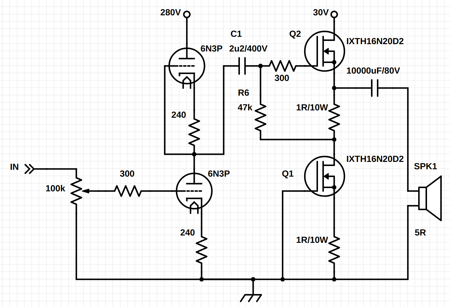

That's the thing. I thought of a push-pull transformer instantly, but you're only at 200 VDC maximum peak. Design maximum system.

Ya so now we get to use tube topologies...
SRPP? Circlotron? (Yes, Circlotron!) Single ended with an active load? It'll be my first attempt at a transistorized output. As long as they don't explode and maybe make sound, I'll be encouraged.
I'm thinking to start, using 24V across two devices, one as a load, the other as the active device and I'll go from there... Capacitor coupled to start because I have zero knowledge of DC servos even though I know about split supplies... Maybe I'll get 5W out of the first amp. How do you sum the output without a transformer? I don't think push pull is possible without it. Am I wrong?
EDIT: What about using a transformer with dual secondaries? amp in on one side, speakers on the other. primary disconnected? I have two coils I might get to work... I'll report back 🙂

Yes, you can sum the output without a transformer. The outputs are placed in push pull with the top device used for positive waveform excursions, the bottom device for negative excursions. Using two N-channel devices means that the drain of the top one goes to the + supply, the source to the drain of the bottom device and the source of the bottom device going to the - supply. Driver stages differ, but the most common and easiest would be a complimentary pair of BJT transistors. It gets very complicated after this, you should look at diagrams of some commercial amplifiers for the rest. Creek (early) used this design.

Thanks for the info, Chris. That sounds like SRPP or something similar. I plan to make it a hybrid driven by an aikido-esque circuit. As long as it makes sound I'll be happy and I can tweak from there...

Then look at a Counterpoint SA-100 (the SA-220 is more complicated with a lot of extra, unused circuitry).
What I would change is the horrible output stage - you have to using those depletion Mosfets anyway. Drive the gates with another stage to get the low impedance required to charge and discharge the gate charge. It will work with a high impedance driver, but not very well considering distortion. Grounding the gates isn't what you want to do either, but using a DPDT replay to provide heavier negative gate bias during start up would kill start-up and shut-down noise. If you elect to leave the output normally biased during up and down transitions, you might want to short the signal path to the output stage drivers.
