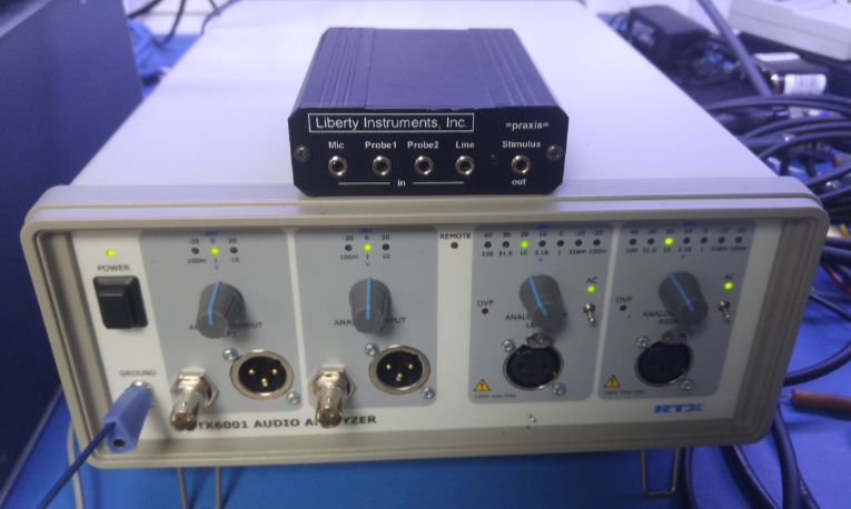

Praxis is great but has several limitations which explain why Bill orphaned it. Biggest one is the the dev environment (Borland) was "retired" as in no longer supported. That plus working with newer windows. I have it working OK in Win 10 but you need to check the Windows sound settings and the driver settings or Windows will crush it all with sample rate conversions.
The other limitation is the Audpod. The Audpod handles level settings and input selections for the different test sources and has an internal calibration function to correct for soundcard failings that works really well. However its scaled for more modest sound interfaces. You can see the size in the attached photo sitting on top of an RTX6001. I'll be making cables to interface them but the cables will dwarf the Audpod.
I would be really grateful if there is a path to the future for Praxis but I have not seen it yet.

Wow thats quite a scale difference .

The Audpod is a software key that enables a lot of capabilities. Plus the optimizations for measuring speakers require signal routing etc that the Audpod manages. The RTX doesn't have the input switching or the software controlled input gains that the Audpod provides. I can make it work without for FFT's but not for speaker measurements.
I truth a $25 USB audio stick is adequate for most speaker testing.
