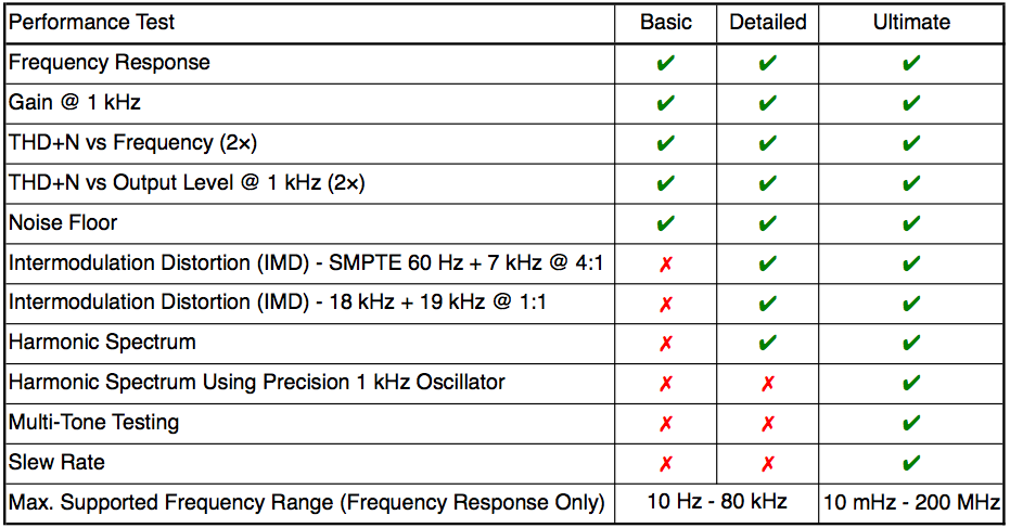

Here is a battery of tests that member Tom offers on his website.
Hope he doesnt mind me presenting it here with due credit.
(image from https://www.neurochrome.com/performance-measurements/)
Few questions:
Does AP software provide features which are not available in the software packages listed earlier?
Does AP equipments have special hardware features that allows additional tests/software features to be implemented?
What are these features compared to JensH's RTX analyzer?
One i can think off is notch filters to remove fundamentals?

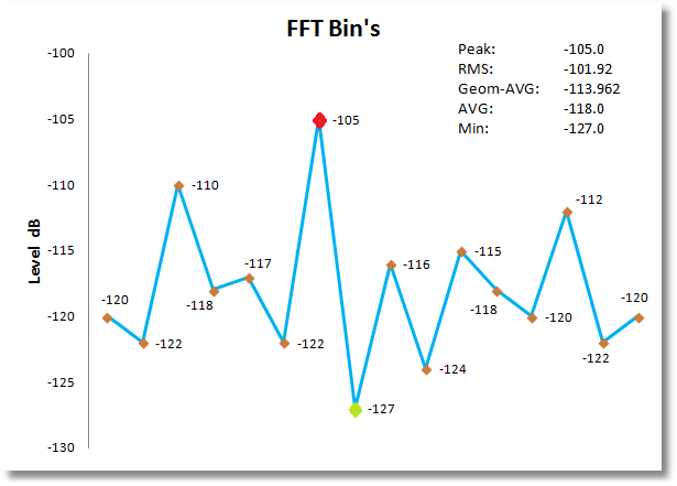

Another question I had is related to noise floor measurements.
I confess i dont understand all details, but i'm happy to learn. I hear FFT based packages can be misleading for obtaining noise floor measurements.
What is the optimal way to use RTX analyzer and any of the software tools to make noise floor measurements?
The question is the FFT algorithm itself, its how a large or very large FFT RMS array is presented on the x-axis of your screen. This means, ordinary SW uses only the peak reading (as the peak Detector mode) what is required to show the harmonic's.
In case of noise, no FFT Window have to be applied and the Detector mode has to be Average (Do not mix up spectrum average and Detector Average).
For clarification see picture below.

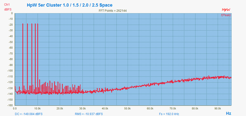

I havent seen many tools offer a good muilti-tone test..
Or simple build your own IM's, while for bass speakers different frequencies are required. Here my Five IM Cluster. See picture below using my Multi-Sine using upcoming DSD Generator and PCM acquisition on RME ADI-2 Pro.

The multi-tone clusters are very useful for finding some issues, usually in transducers. Most decent electronics rarely show issues that don't show elsewhere. In transducers you can see all manner of mechanical stuff crawling out of the noise. Best done with coherent averaging if you can. I'm attaching a spreadsheet of selections for spectral contamination testing that was crafted to ensure that neither harmonics nor IM products would overlap with fundamental tones.
