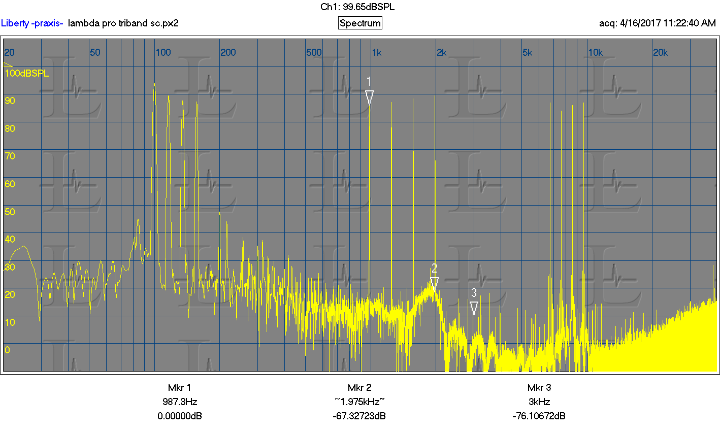

This is a triband spectral contamination plot of a Stax Lambda Pro at 100 dBSPL (loud if it were on your ears) Microphone is a B&K 4145, preamp is an HP 15109. I have no way right now to crosscheck the distortions (such as they are). I used coherent averaging and 50 averages to get the noise down. The Stax are open ear so ambient noise is not attenuated. I used Praxis for this. I'll be happy to attempt it with ARTA or any other package if its reasonably possible.
I tried with the B&K preamp but I could not get the noise down in a useful way. The 2609 measuring amp was not setup to access the mike preamp directly.

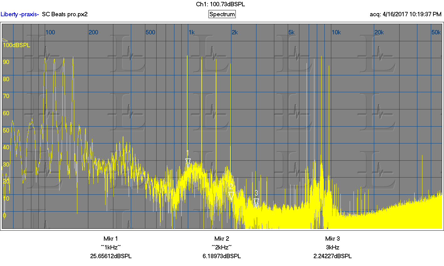

For context here is a Beats pro dynamic headphone on the same measurement at the same level (100 dB SPL). You can see the IM products around the high band tones. The noise floor also reflects differences.

Really insightful posts. Thanks a lot for posting these.
Is there a single tone test or ambient measurement plot to show comparison with this?
I plan to try out this test on my 4-way active speaker based on the spreadsheet, next time i get a chance.
It makes a lot of sense. speaker drivers being mechanical devices, i have often wondered how they behave when playing signals making up multiple frequencies in their pass band. What the effect of this frequency mix changing rapidly is.
A sweep of sine waves perhaps doesn't bring out all the gremlins.
Some speakers sound very good with slow, clean music (perhaps why some audiophiles prefer such music), but completely fall apart with complex music exciting the entire spectrum and such spectrum changing rapidly
Btw, wonder how these multi-tone signals are generated for stimulus. I will have to check if REW or ARTA allow this.

You also want to understand the bending modes of the diaphragm etc to fully understand what is going on...
