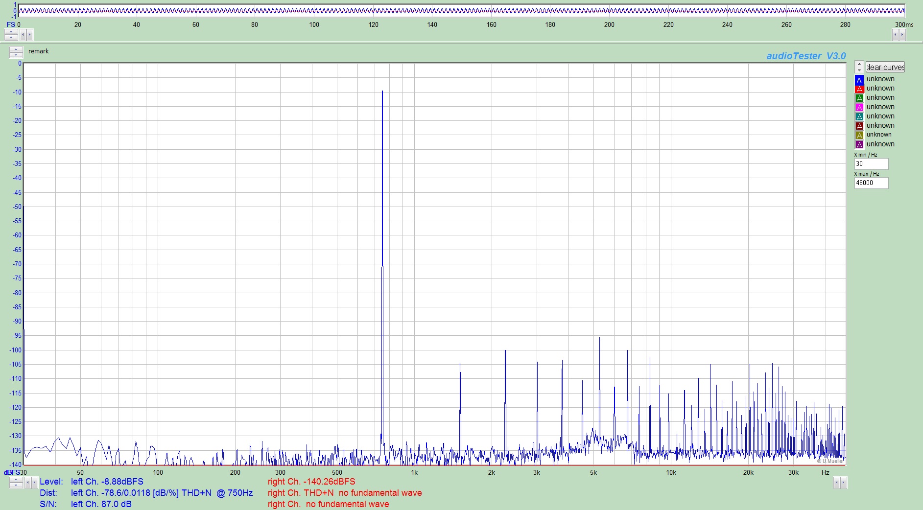

I know lol - and I doubt it....
Even Focusrite quote -106dB (A Weighted) for the line input on the Scarlett 2i2.
I've often wondered how the software determines it's ~-140dB
I do run the input gain very, very low though, to maximise the SNR.
Sure you do not mix up FFT-noise-floor with absolute noise level over audio bandwidth? With ARTA I see similar low noise floor, at the same time the weighted noise level is about -106dB.
The software does not show the real noise.
It shows the noise in one frequency bin.
You can verify this by changing the FFT size.

I don't know much about Audio Tester. I wonder your attached file is not Dist but Mod Dist which means Modulation Distortion ?
Attached is my measurement and pretty correct.

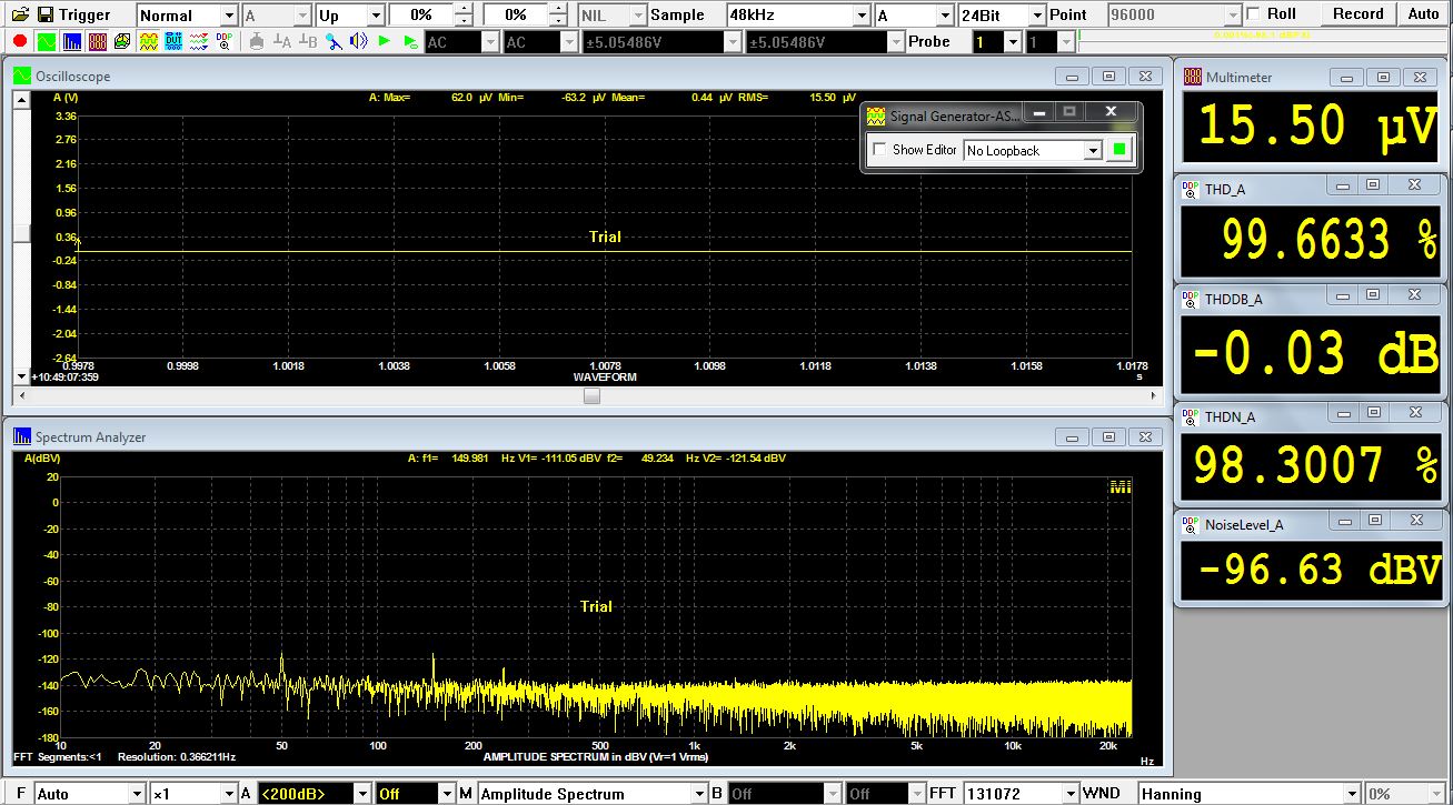

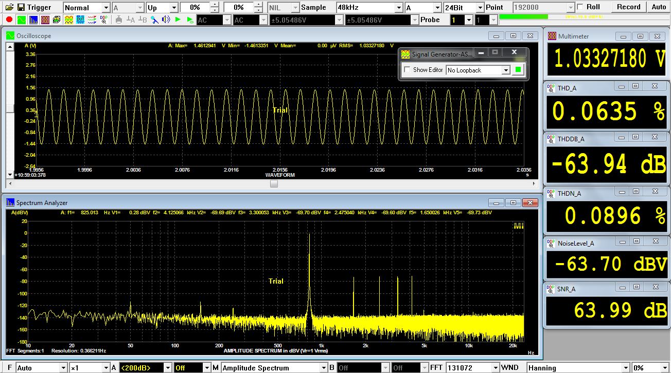

1) done. Compared Levels with the Keithley DMM.
2a) fireface ucx, fs=48kHz, 24bit, 131072points, 4sec, measurement-BW is 20Hz~24kHz

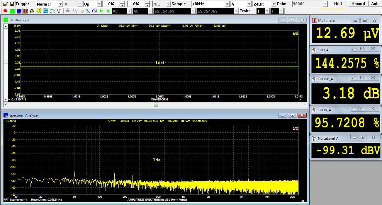

2b) fireface ucx in loopback AOUT1->AIN5, same parameters, Output Level = 0

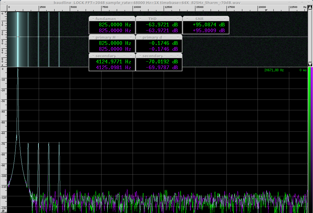

3) looping this .wav file test signal with mathematical THD = 0.070711% / -63.010dB
Baudline wav-file analysis:

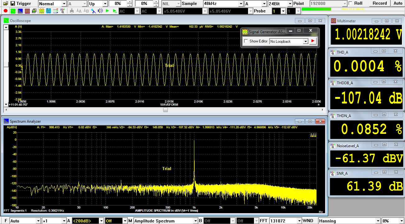

Virtins measurement with Fireface in the loop, approx 1m Cordial CMN220:

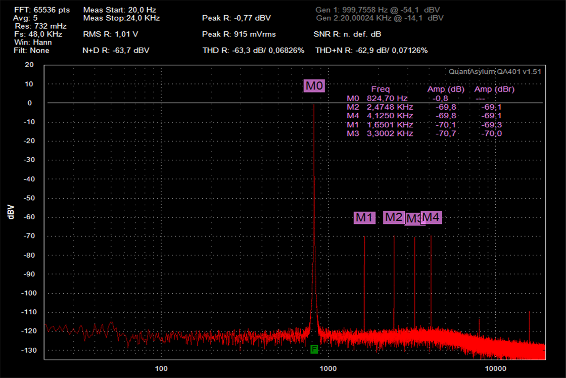

Same testsignal Fireface AOUT1 -> QA041:

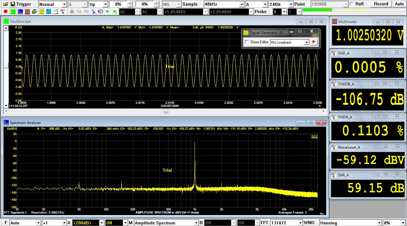

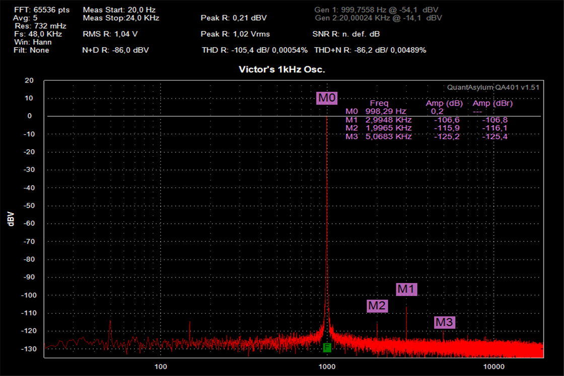

4) Victor's 1kHz Oszillator lastest rev., E3631A supply, FFT parameters as before
without averaging:
with 5 averages:
The Victor Osc. dierctly fed into the QA401 with a RCA->BNC adaptor:
We are getting somewhere... but i still doubt the software THD+N figures. Feeback welcome 🙂
20170708_ffucx-ain5_noisefloor-ain5-aout1-loopback-0V_virtins_hann_48k_01.JPG214.6 KB · Views: 699
20170708_ffucx-ain5_noisefloor-ain5-shorted_virtins_hann_48k_01.JPG198.6 KB · Views: 641
20170708_ffucx-ain5_825HzTestSignalat1Vrms_virtins_hann_48k_01.JPG252.6 KB · Views: 664
20170708_825HzTestSignal_ffucx-aout1_qa401_hann_48k_5avg_01.png227.1 KB · Views: 631
Yes, I believe that AudioTester* was measuring modulation distortion in my screen dumps - however you'll note that the distortion was 0.0000% which is probably incorrect.
I seem to have quite a few issues with AudioTester and the Asio* driver in particular on my PC - I have no idea why this is, as the other software I use (with the exception of RMAA) all work fine with the Asio* driver.
*this is the Focusrite supplied Asio driver.
*Although I like AudioTester, I find it rather confusing (and frustrating) to use at times - the scales and settings change each time you switch to a different measurement screen, so I find myself constantly resetting the max. / min. scales and various other parameters, as it doesn't 'remember' these settings between screens.

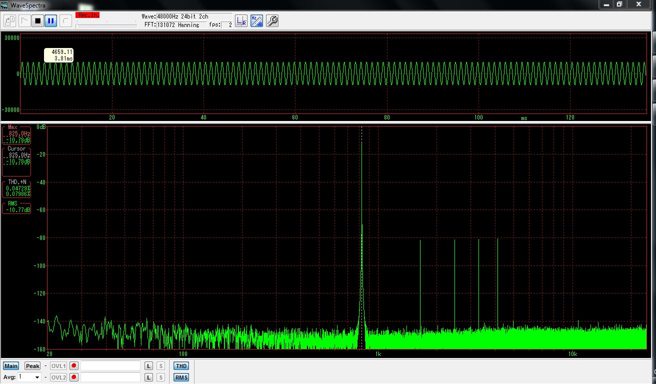

Same test setup: 825Hz test signal loopbacked through the FireFace UCX.
This time recorded with WaveSpectra at 48k/24bit/hanning/131072pts:
Cursoring out the 5 peaks retreives:
f0 = 0
f1 = -70,06
f2 = -69,88
f3 = -69,98
f4 = -69,97
A rough calculation with my oldschool casio results in approx 0.0638% THD.
WaveSpectra computes 0.0473% THD. WTF? In this case THD should be obvious!

The modulation distortion will indeed be very low, if you only have one tone present.Yes, I believe that AudioTester* was measuring modulation distortion in my screen dumps - however you'll note that the distortion was 0.0000% which is probably incorrect.
Yes realised that. I plan to re-test now that I have the software working correctly again. (solution - delete AudT30d.ini)
I just made a quick test with audioTester on the RTX6001. With a 1 kHz tone at -2.26dB in, I measured -120.8 dB (0.0001%) THD, and -151.5 dB Mod. Dist. The latter gets truncated to 0.0000% (would be 0.0000027%).
0.0000027% still seems incredibly low? (this is a question not an argument!)

The QA401 THD+N numbers are suspect. I brought that up to Matt and he is looking into it.
It seems the software packages are able to get accurate readings on known distortion levels. Thats a start. Untangling internal distortion limits is a separate issue. A few data points- the Victor oscillators distortions are in the -140 dB or better range. They are really below what can be measured using a traditional analyzer and well below anything an ADC can measure. Any harmonics seen with one are from the ADC side. With that knowledge it possible to separate the DAC distortions from the ADC distortions. Until recently the better ADC chips were all better than the DAC chips. Next point- All these ADC/DAC devices have their optimum distortion between -10 and -20 dB. But that compromises the SNR/DR so its important to understand what you are looking at. A high resolution FFT (I use 1 million points for this stuff when I need to find those lower harmonics. ) but below -110 dB they may not be accurate levels. Many error contributors and you should validate any measurements that low. Validation of those low measurement accuracies is not easy.
The noise in an individual bin relates to its bandwidth and comparing the noise floor plot to a measured noise floor is not useful The software does an RMS sum of all the bins adjusted by the weighting factor. Matching that to standards also requires understanding the standards, weightings and bandwidth. The traditional analyzer would have a 400 Hz HP filter and 30 KHz and 80 KHz LP filters. A 20 KHz LP filter to deal with digital aliasing has become more common lately.
As a reference point SOTA THD+N performance is in the -117 dB range and mostly limited by the noise of the input circuitry of the analyzer. And that is at a level of around 2-3V. Higher or lower ether the input attenuator or the noise of the amplifier degrades the number.
I'll try to duplicate these measurements with my hardware this week. It could be formidable with all the permutations but deciding which software to use is important. There are lots and they all have limitations and learning curves.

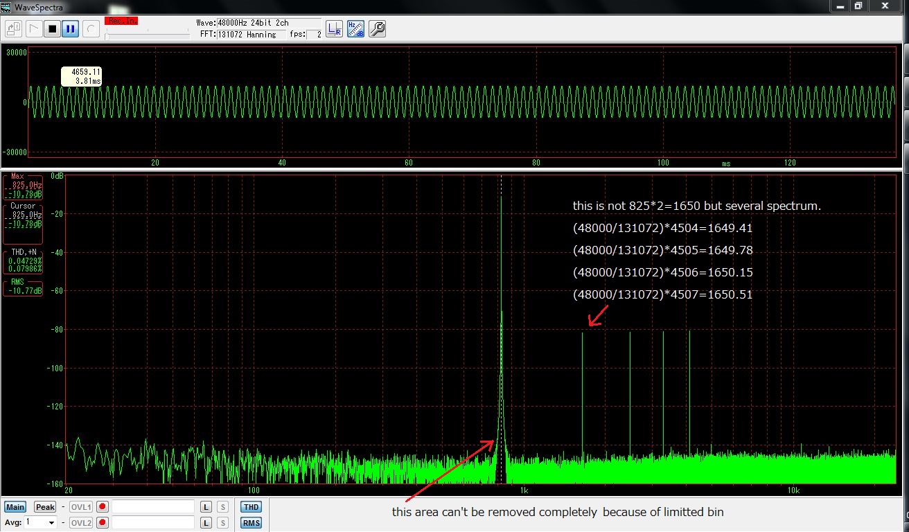

This time recorded with Wave Spectra at 48k/24bit/hanning/131072pts:
f0 = 0
f1 = -70,06
f2 = -69,88
f3 = -69,98
f4 = -69,97
Please don't get me wrong. I do not try to achieve the lowest THD possible, I am trying to achieve a reliable THD(+N) measurement results in the first step.
Yes, you are correct. This is not accurate result.
From HP of Wave Spectra, there is inevitable reason for this.Software calculates THD with the most close spectrum of harmonics.Unless you use coherent sampling, harmonics and multiple of bin by integer doesn't coincide.So, software uses the most close one, which makes error. That's why THD is less than real value.
On the contrary, noise power usually becomes more than real one because removal of fundamental skirt is not adequate.Please see attached.I roughly estimate THD is -64dBFS(0.063%) and THD+N is also -64dBFS.Noise power of this case is almost -100dBFS.It matters nothing to THD+N.

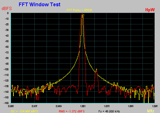

IMHO, the calc's has to be as given within the RBW (resolution bandwidth) picture...
Finally there are two or more problems regarding the RBW 😀:
1. LDO needs some larger RBW for the first harmonic
2. On digital world, a spurious signal could be some bin's apart and would be masked
3. For DSD a bandwidth range is required, otherwise noise above 20kHz made the calculation 😱

Thank you very much for all the valuable explanation. The "odd" test fundamental of 825Hz was chosen by me to investigate all those irregularities. My signal processing/analysis lectures were quite a long time ago this freshens a lot of stuff up for me 😉
Now, we identified the fundamental problems in FFT analysis and know how to overcome these issues: What can be done to achieve accurate noise and THD+N readings?
