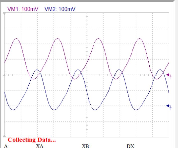

Pass one of these music (YouTube ok) and hear if you get it distorted.
Happy together, Turtles.
Sing sing sing, B Goodman.
Requiem of Verdi about 10mn from the start.
If it doesn't sound right, pull up the large decoupling capacitors and put them back with grounding leads tide on air grounded by a resistor about 1 ohm.

Read #406, this is nothing but an imaginary experiment by an ignorant of the basics of electricity or just to convince a stupid. The impedance of the supply by 10,000uF reservoir linking the chip with 0.1-0.2 ohm wire is the dominant. The 470uF to be as low, it needs over 2.5khz for rectified currents and it will decrease the 0.2 ohms to 0.14ohm. Who is that stupid to convince.
Actually, I performed the experiment in Post #406 by accident once. That's where I have my experience from. In that specific experiment I had inadvertently reduced the 10 uF decoupling capacitor to 2 uF. I drove the amp to clipping with a 4 Ω load and watched it oscillate near the peak output power.
I suggest you measure the impedance of that 10000 uF capacitor. I did that in college many years ago. I found (and you will too, if you bother to measure) that its self-resonant frequency is on the order of a few MHz at the most. That means the supply capacitor behaves inductively at frequencies where the LM3886 still has gain. That results in instability. As noted in the part of the data sheet that you quoted, you need to have a local bypass capacitor of 10 uF (min) with 0.1 uF (min) in parallel right by the IC in addition to the (min) 470 uF of bulk capacitance.
Some of us on this forum have real-world experience. I'm happy to share my experience, which is what I'm doing here. But, of course, I can't force anyone to listen.
My proposition was just to add a resistor grounding the 470uF capacitors to create reverse current in the supply wires and transform the rectified currents into ac.
That statement makes no sense.

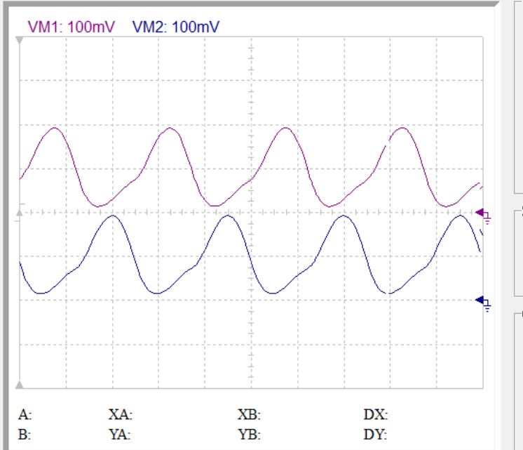

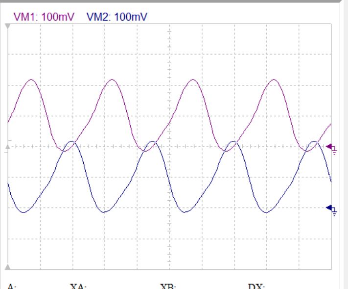

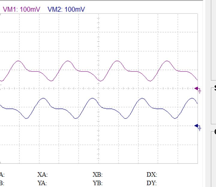

These are the currents of the rails with 0.1 ohm wires and a resistor linking the ground the 2 470uF, from 0 ohm to 1k at 4khz.
Look how the distorted current infecting by radiation the signal, transforms into sine wave.
Those "sine waves" are still heavily distorted. I agree that you changed the harmonic structure of the rail currents. But so what? Did it change the output of the LM3886 any?

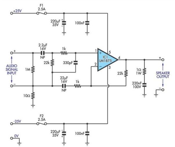

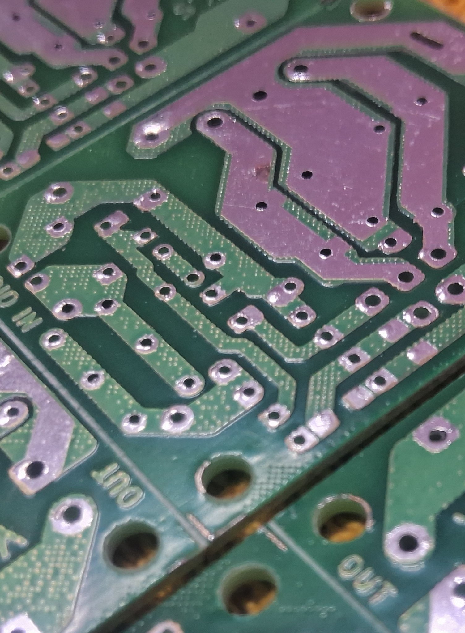

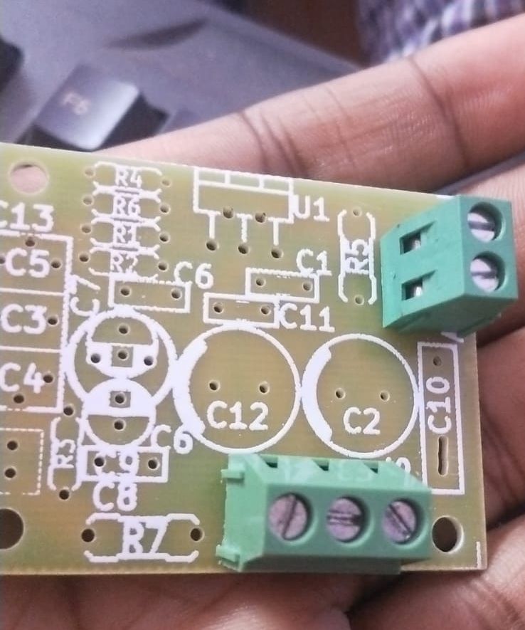

Back to topic, this is my pcb on LM1875 monoblocks. It has multiple options for components. Even SMD on the back side. I never forget to thank my friend who helped me to get these PCBs based on that article.
