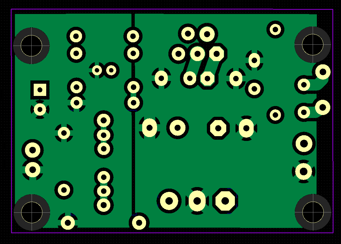

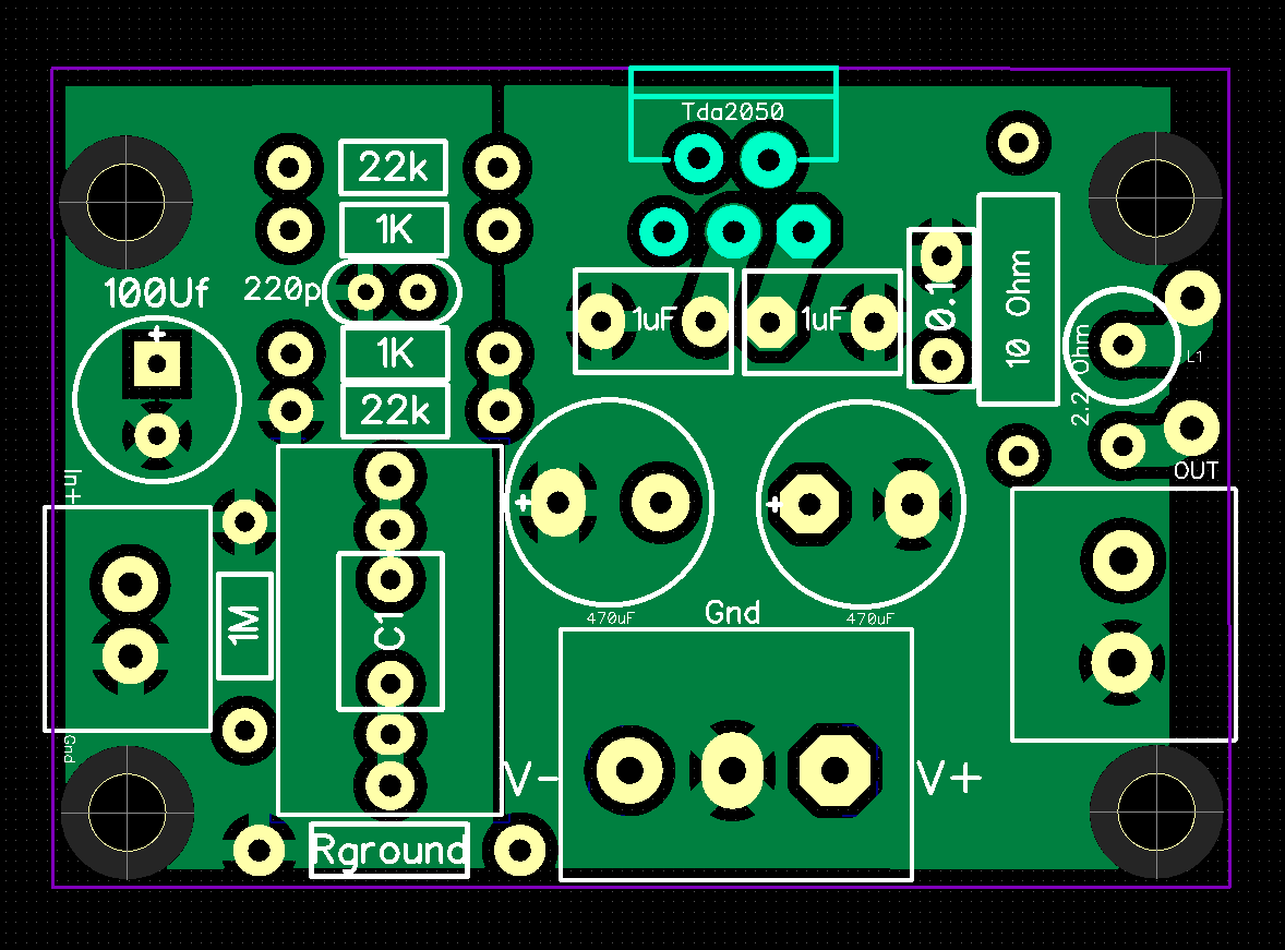

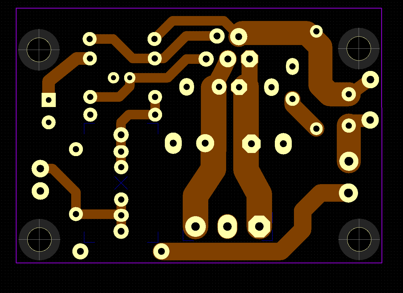

Hi
I have recently finished building this amp. I really enjoyed it, thanks to all the folks involved in the design of the PCB. I really like the fact that Tom had worked on that design, I’m aware that these IC can be fussy with PCB layout.
Is there a similar thread, meaning an open source layout but this time for the LM1875 ?
I know it’s an old chip but I’ve got a bunch which are at least 20 years old…
Eric
Eric,
This is from many years ago when I was playing with Diptrace, but never got to build this tda2050 little amp, plz take a look.
