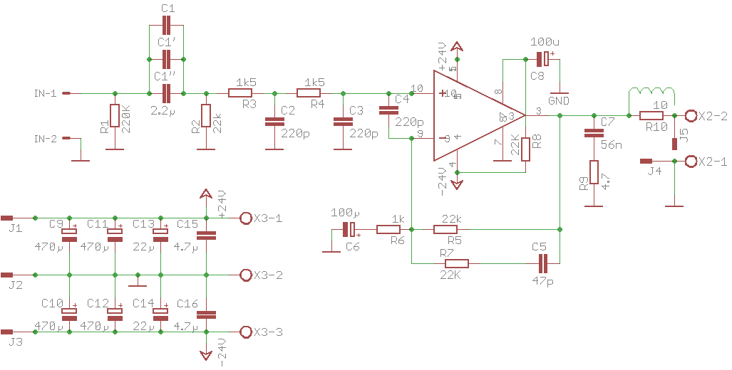

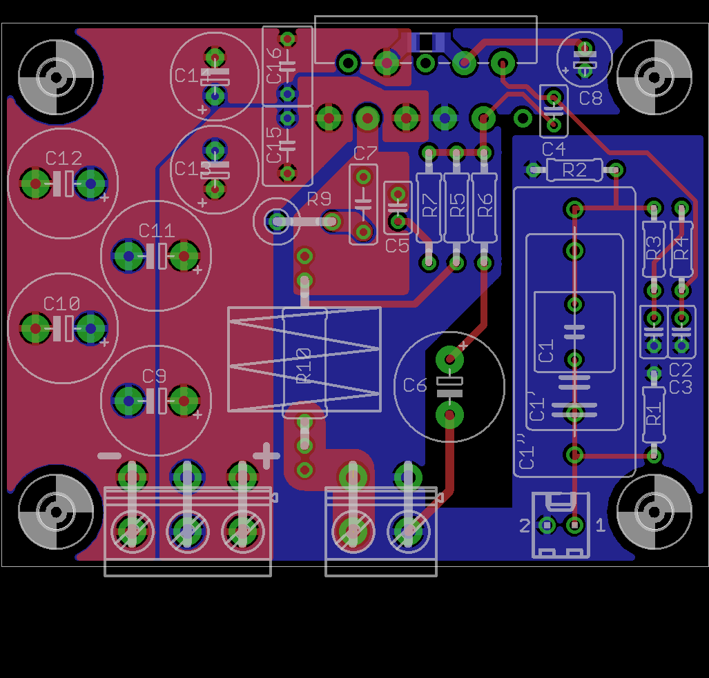

Here's a first suggestion up for criticisms/improvements. It's based on a smaller smd design which works quite well in practice but for a simple board I moved everything back to through hole (except for the muting resistor).
Nothing extravagant. A few options are provided for the input cap and the output/PS connectors can either be screw terminals or faston. The board is 65*50mm. All electrolytic caps are sized for 50Vdc caps. The resistors at the input are 125mW, the ones in the feedback network 500mW.

Just going off the schematic, I'd throw 100-330uF electrolytic in parallel with a tight-to-pin 10uf/100v x7r for psu bypass (on each rail). If the layout keeps the inductance low, then the 3886 will enjoy low impedance all the way out to its ugbw.
Edit: looks like c15,c16 accomplish that.
Yes, I'd rather keep it simple at first. Non-inverting has the advantage of a highish input impedance, so the input cap can be kept small and a buffer isn't really required to drive it. A 10k log pot (providing a 2.5K output impedance at worst) would be fine in most uses. I'd also rather like to test only one version if possible.
Still, I'm open to suggestions to options that make life easier (such as the different footprints for the input caps or the like).
@DPH: yes, C15-C16 are X7R 4.7uF/100V (a compromise in between physical size and value). C13-C14 can be polymer up to 39uF/50V (biggest I've found in 8mm wide caps). C9 to C12 can be up to 470uF/50V electrolytics, twice over the minimum value suggested by the datasheet.
Good deal, Ben. I was looking at the top part of the circuit and didn't realize you called out the bypass on the PSU side, my apologies. That all looks good.
Couple things of note (read: ramblings of someone whos not actually that good at layout): any reason not to have the entire ground plane flooded? Are you worried about the high current bounce on the input filter? And then just drop C6 wherever it lands? It's not a high current path, and may lower the overall plane impedance.
R5, R6, R7 could be turned 90 degrees and then you might be able to shorten the critical path of R5 (it should go first as it has the greatest effect on HF stability, even over the compensation network). Any reason to *not* flood the -input pin?
I would use one footprint size of the input cap.
4.7uF is one dollar on mosuer.
I used that footprint on my layout.

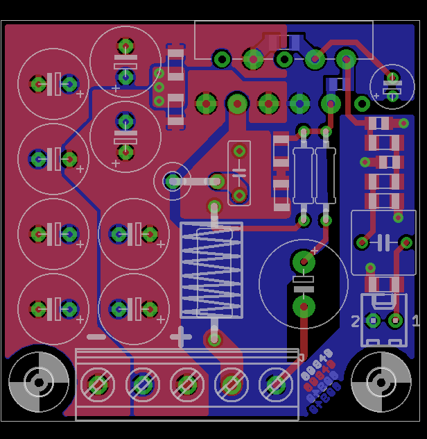

Board istself is similar(75x38mm), uses more SMD components.
There is a one detail people tend to overlook, and that is a access to LM3886 screw hole, I would spread out L and C6 for easier mounting.
Here is my board. Top layer is GND.
Thx for the comments. 🙂
@DPH:
- feedback resistors: Tom explained once why he suggests to take the feedback point from that point and why it matters more than the absolute shortest feedback track provided you have a Thiele network in place.
- on the split groundplane: yes on the bounce, less for the filter than the input resistor. But I could take a hint from bozoc's layout and use a top groundplane from low level signal and flood the bottom. I'd rather give C6 its own track to the output terminal too.
@bozoc:
- I like smd too. I've got a working board which is just under 5*5cm. See here under. But smd seems to scare many. I just slipped one smd part in, hoping it goes unnoticed.
- The multiple footprints don't cost anything. They allow to use either mkt or mkp. Decent MKT is good enough in many cases if you ask me.
- good call on accessing the screw. In my experience with the smd pcb, it hasn't been a big problem, if the feedback cap is sufficiently away from the IC.

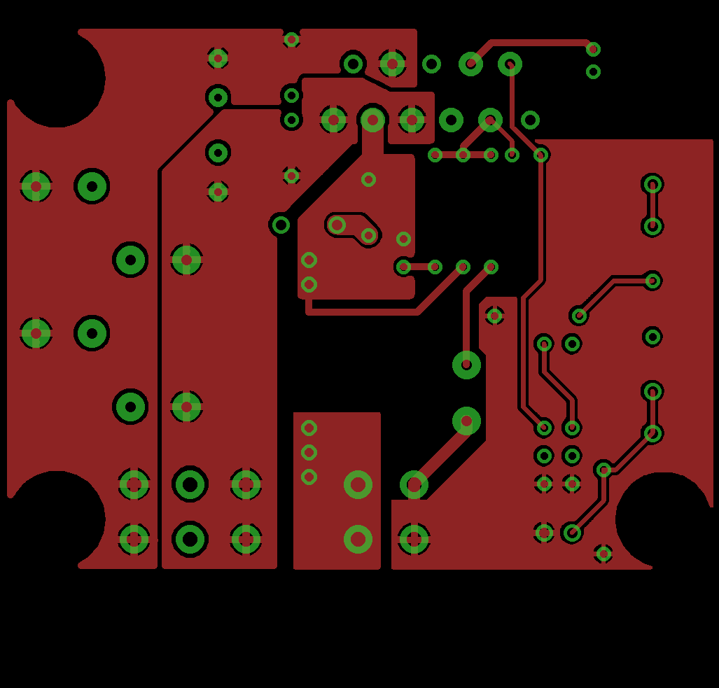

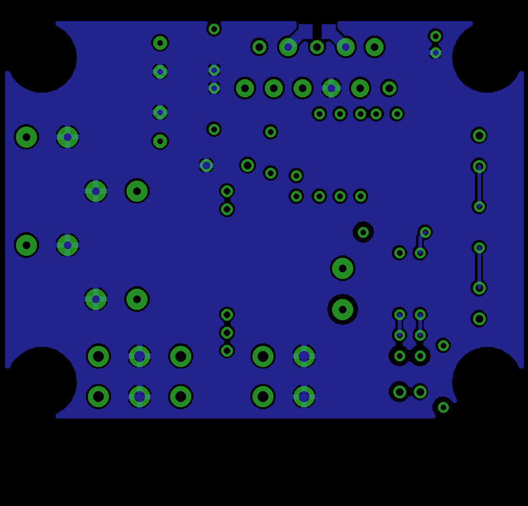

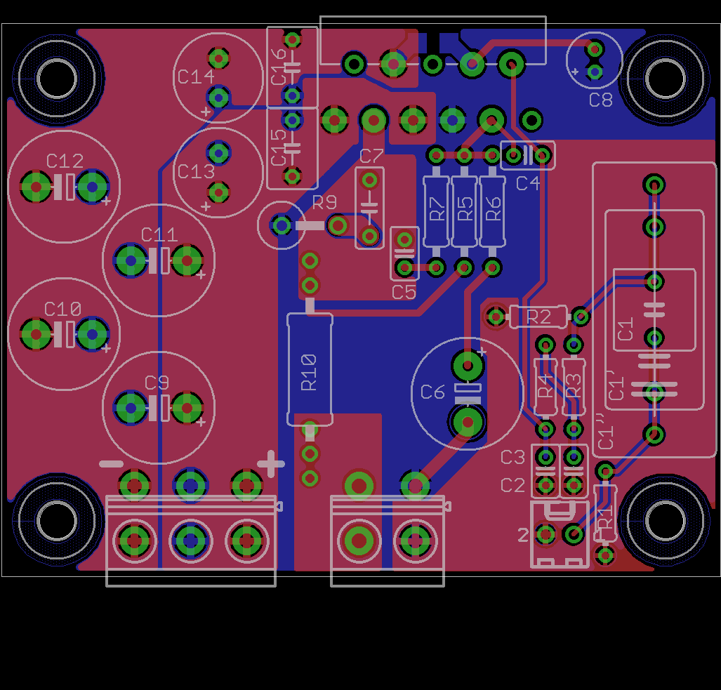

Ok, first revision. :scratch2:
Now with a signal groundplane on top and a complete power groundplane on bottom. The input filter is also closer to the input gnd.

Remove the PGND plane from under the input and feedback traces/parts. The AGND plane goes under the input and feedback circuits only.
Add the option of a Hum Breaking Resistor between the output GND and AGND. This will
help when you use multiple boards connected to a single transformer.
The LM3886 inputs are high impedance, keeping these traces short will prevent hum.
- shorter input tracks are possible if I move the RF filter before the input cap. I'll have a try.
- a ground breaker resistor... I can add that.
- removing the power ground plane around the inverting pin could help. If I'm removing it all around the input, we're pretty much back to the first layout and we're wasting some copper.
