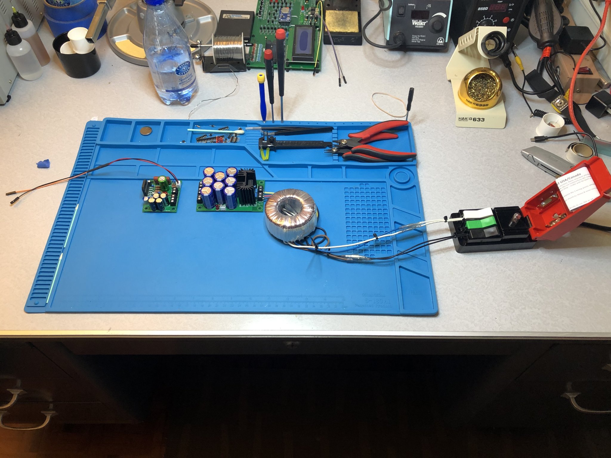

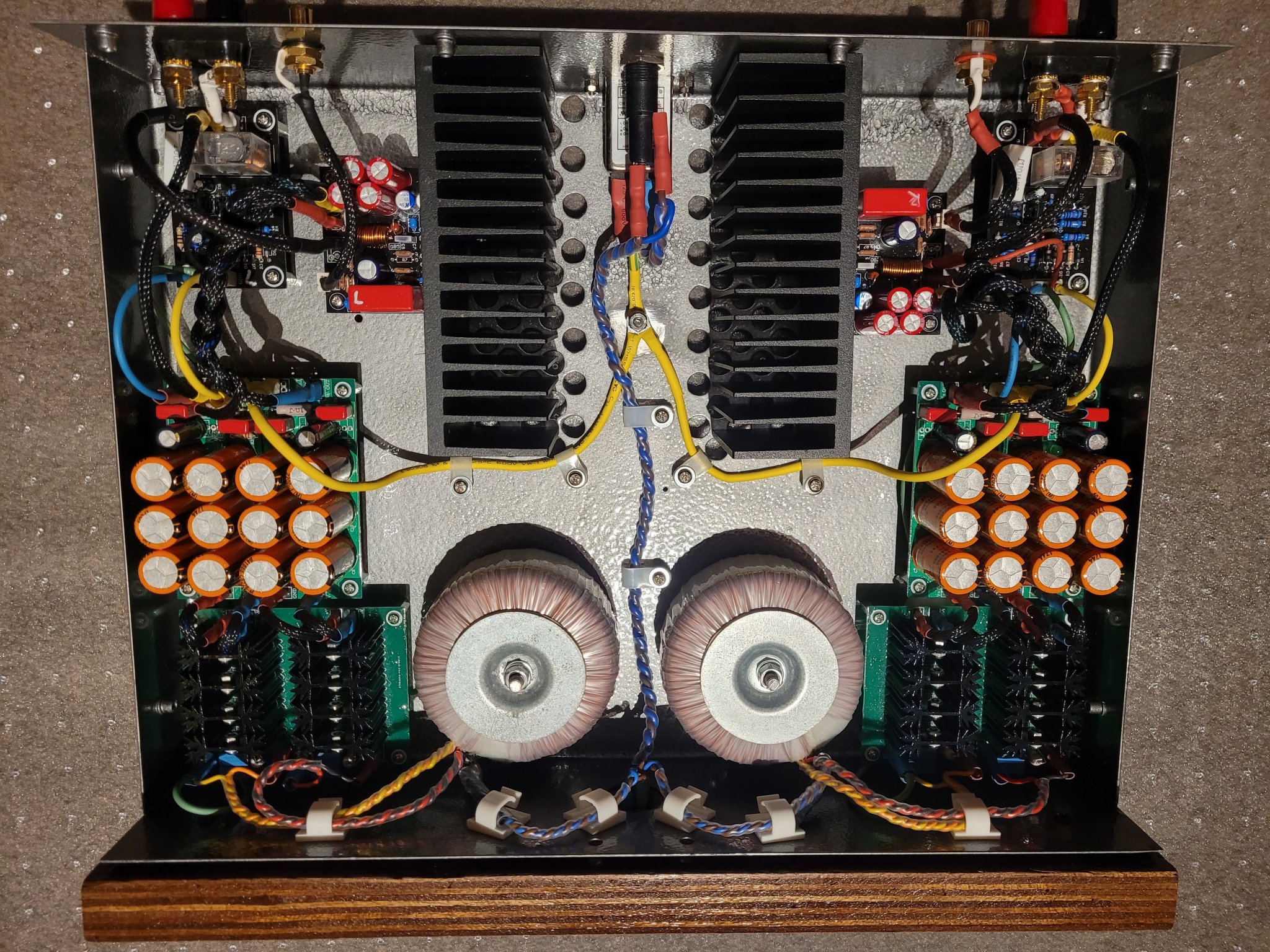

Over the weekend I managed to build out the amp and power supply with no issues other than having to learn about what a snubber is. I am new to the audio world so this has actually been fun. Am attaching pics of my build.

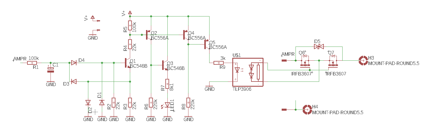

Anyway, here are two auxiliary pcb. One is the PS (60*100mm), one is a simple DC protect (60*40mm). Eagle files in the zip. There's a small error to correct on the ps, the top molex connector should of course be labeled v- and not v+.

Question on the Protection board's D5 (TVS diode) - schematic indicates its bi-directional and I am stuck between these two (4A and 11.1A TVS) TVS Diode P6KE110CA Littlefuse and TVS Diode 1.3KE100CA Littlefuse both at Mouser. Hoping someone could confirm if one is a better option, or are they both adequate for this position on the board.
Also, is there a maximum supply voltage, power rating for this protection? Since it's in a LM3886 thread, is it still adequate for a 150-200w amplifier build?
Question on C1, on the schematic it is a polarized capacitor, however through this thread there is mention that C1 needs to be bi-polar? Hoping someone could explain and confirm which is correct.
Can you elaborate as to the "why" - since it shunts to ground? I thought bi-polar was only if it was in the direct signal path? Just trying to understand better the schematic and help me apply to amplifiers in general.Bipolar, like the signal.
A bipolar capacitor by definition can have either polarity of voltage across it,
and still function properly.
A capacitor connected to ground could still have either polarity of signal across it,
depending on the circuit used, such as this one. Shunt parts are definitely in the signal path
as much as series parts are. Think of a voltage divider, for example.
Some believe that a polarized capacitor can be used for AC signals if the reverse voltage is small.
This is not a good idea.
