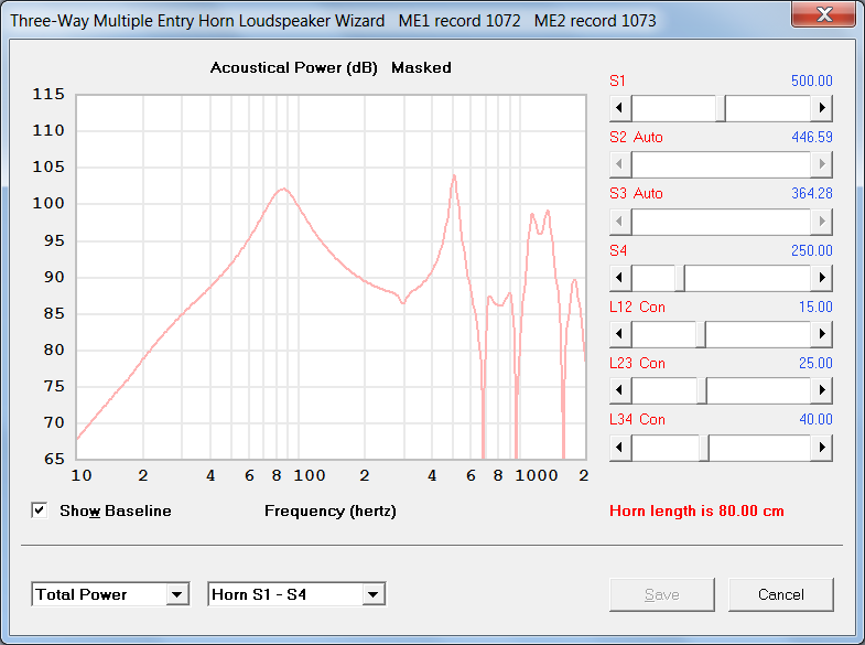

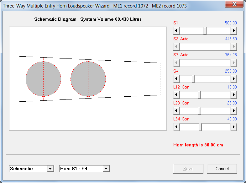

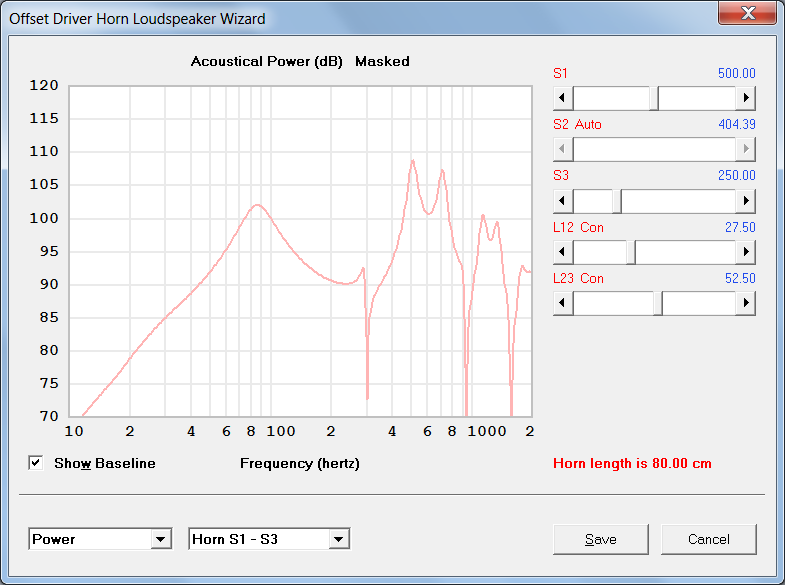

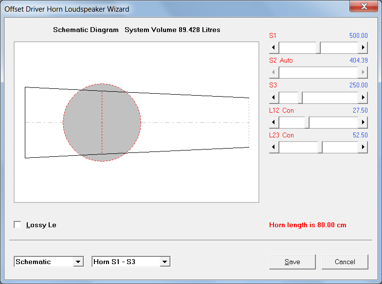

I think probably the best approach would be to find the optimum position for the composite driver, and then locate the two actual drivers equal distances either side of that optimum position.
In an attempt to do a rough validity check of the above approach, I experimented using the Hornresp multiple entry horn model to specify a design having two separate drivers, and then compared the results against those for a composite driver positioned halfway between them.
As you can see from Attachments 2 and 4, the results are reasonably close up to about 200 Hz.

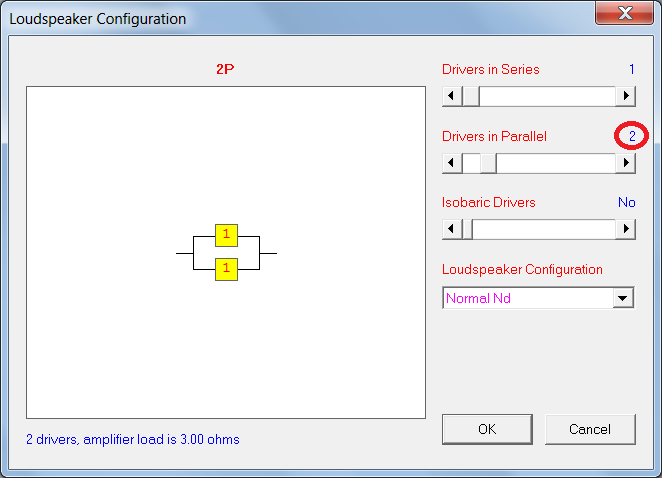

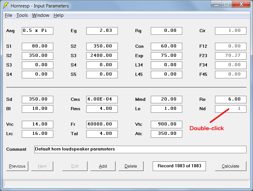

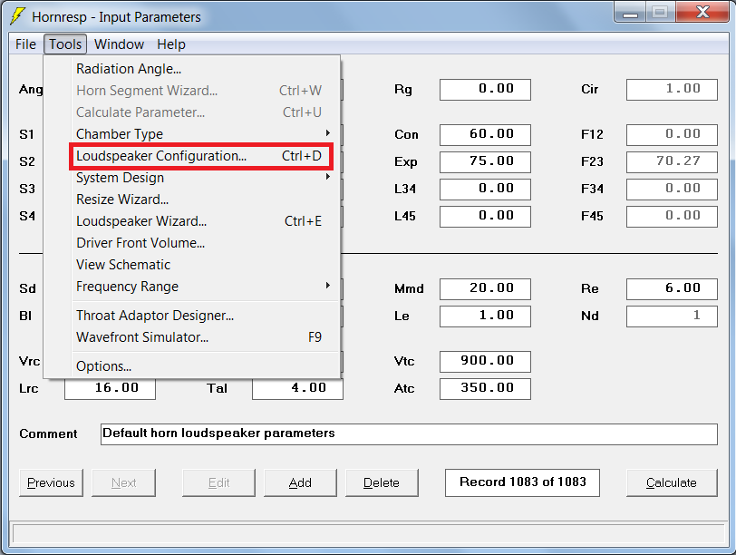

Apologies David, one further Q, I tried looking for the Multiple Driver wizard in tools (as listed in the HR Help file) but can't seem to find it in any of the menus... any advice appreciated, cheers!
I tried looking for the Multiple Driver wizard in tools but can't seem to find it in any of the menus
Hi JVN01,
To specify multiple drivers in edit mode, either:
Option 1 - Select the Tools > Loudspeaker Configuration menu.
Option 2 - Press Ctrl+D.
Option 3 - Double-click on the disabled input box showing the driver configuration.
(I find Option 3 to be the quickest and easiest).
Kind regards,
David

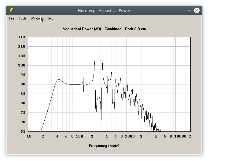

Neil. I wonder if you still participating in this forum.
I have studied your design and I try to reproduce your calculations. And I fail.
When I enter all driver parameters and line dimensions the result below 200Hz is similar. But between 220Hz and 300Hz I have a huge dip.
The only difference in the exported Hornresp files is a path length. In my model it is 0. In your model it is 75cm. The path length of 0.0 is displayed in the Acoustical Power window. Your screenshot shows a path lenght of 75 cm.
When I change the path length in the export file and re-import it, the response it similar to yours, no dip anymore between 220 and 300Hz.
I have looked through all Hornresp settings until I am blue in the face. I cannot find anywhere how to set the Path length. Can you help?

It is "buried" - it is in the Loudspeaker Wizard (Control-E), and then select Power on the bottom left pulldown menu, then on the pulldown just to its right select Chamber. Then you will see Path at the bottom of the parameters on the right side.
You have to have the actual dimensions of the cabinet you are designing, in order to get the path length - on the outside of the cabinet, from the center of the woofer to the center of the terminus opening.
And yes, it smooths out the response in a big way, because of the phase on the inside vs the phase on the outside.

Thanks! It is there all right. I was in that window and that menu and still must have overlooked it. It must be the font size on my screen, or my age.
And yes, it totally smooths the response.

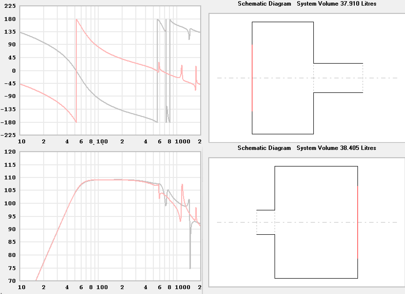

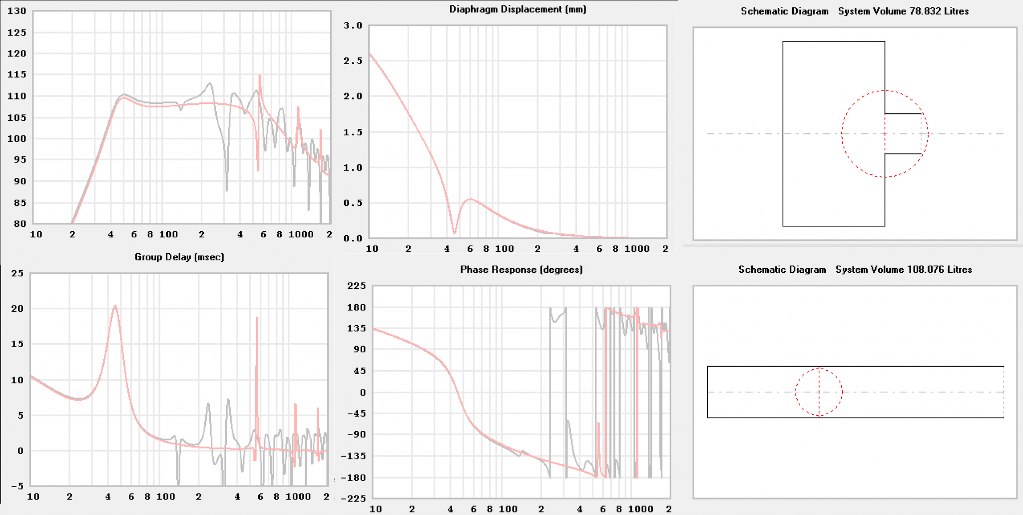

I cant see any real difference between ported and TL If the response (fundamental) is made to be roughly the same in Hornresp. Should this not show up in the sim?
It's very likely im messing something up.
I dont see a major difference but ratio of group delay to efficiency appears to be slightly better for TL, scaling in Hornresp does also make it easy to miss things.
here is an example - The driver is ROSSO-12MW300, grey is TL, red is ported box attempting to match it (ignore impossible driver placement for ported, it doesn't impact the response)
