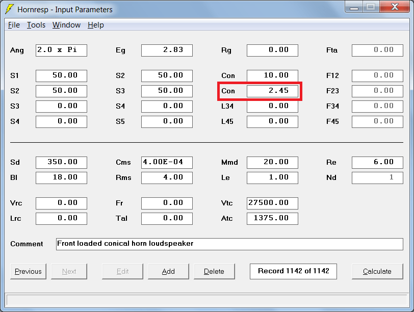

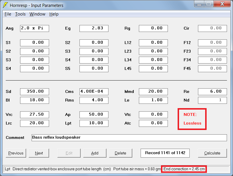

Simulating the BR how it was intended, like yours, gets the same expected phase response, don't know why you can not get the result using the horn segment to make a roughly physically equivalent BR.
1. Set QL to Lossless in the bass reflex design as shown in Attachment 1.
2. Add internal end correction to the front loaded horn design by either increasing L12 or adding a second segment as shown in Attachment 2.
The results for both designs will now be identical.

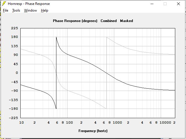

did you test it? QL has little effect, horn lengths could be doubled or halved but also has little effect on the phase response.
Yes. Did you test it? 🙂 With the described modifications, the results are identical, but the phase shows a 180 degree phase shift between the two cases. The reason is simple; the bass reflex case takes the direct radiation off the front of the diaphragm, the horn version off the rear. You can see it in the schematic. See attachment.
Changing QL and horn lengths will mainly change the response (and hence the phase) around the port resonance frequency. There's a noticeable (several dB) difference between lossless and QL=7 at the port resonance for my example, and doubling the length of the 10cm horn segment changes the port frequency by 12Hz or so.
Basically, Hornresp doesn't take the inner length correction into account when using horn segments, but does so when using the vented rear chamber option. So the length correction must be added manually when using horn segments. But only the inner one, as the outer one comes from the radiation impedance which is always included.
