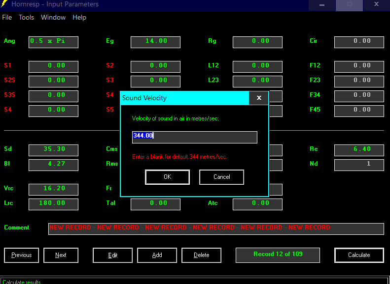

Most of my archive from that time is currently in storage, although since I need to head over there when I'm back on my feet I'll have a dig through. Monk (I think) did a 3-part piece. Bullock did some work & even a DOS model, but it only worked for untapered, undamped lines & I don't think was written up in SB, although my memory is hazy on that & I could be wrong. Rick Schultz did some work, although the latter part was mostly alignment tables derived from Augspurger. There were a couple of others but nothing significant on the math / physics front beyond those that I can remember. If there was, I'll have to seek it out as it would be good to have for the records.

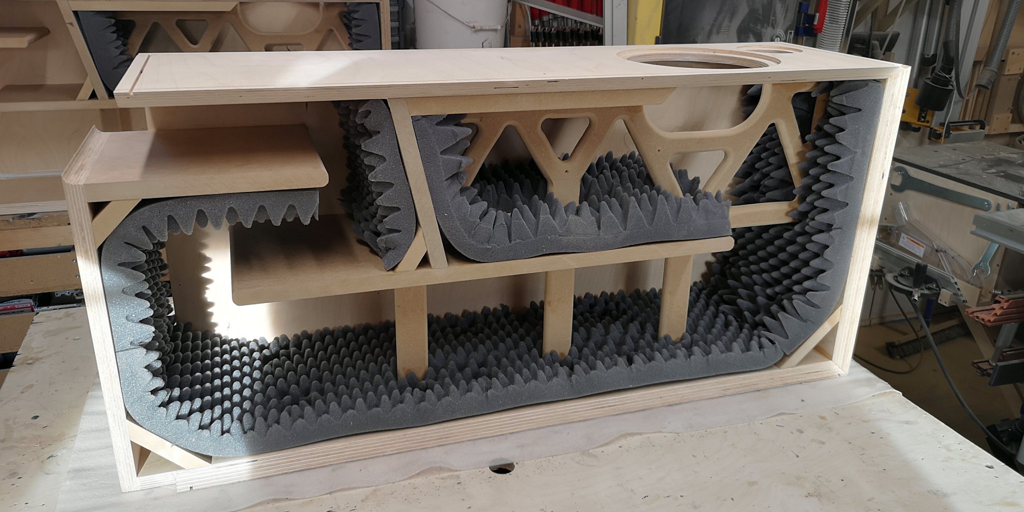

I don't know what the Hornresp model calls for in this design - in the designs I did and built, I put polyfil in the closed end and in the top down to the top edge of the vertical baffle. And the on the design that had the terminus on the front (very similar to this design) I did need egg crate to limit the higher frequencies coming out of the terminus opening.
I just noticed a smart thing on this build - the outer panels are Baltic birch, and the inside pieces are MDF. Makes a lotta' sense!
