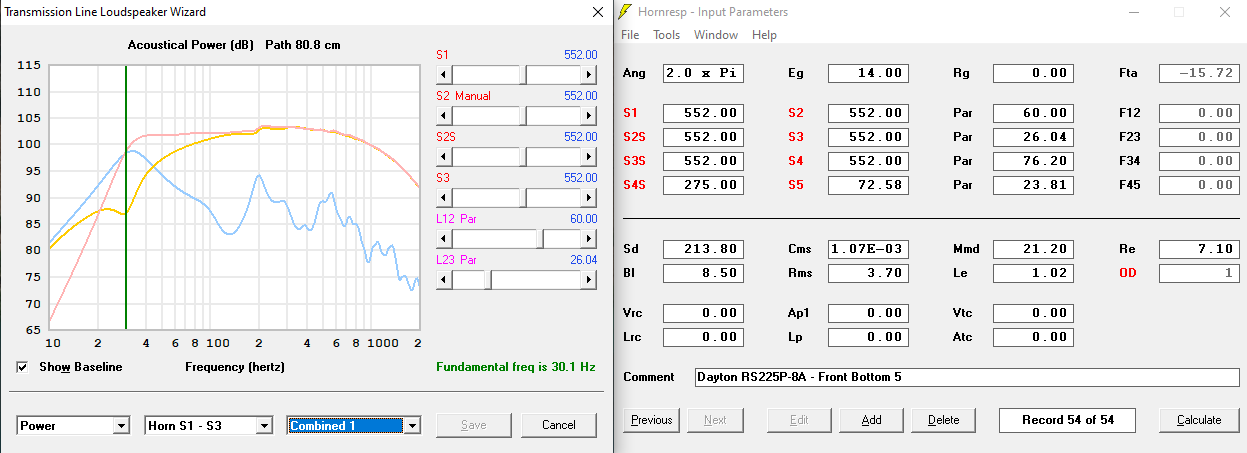

These are the Hornresp files for the two designs I posted above; with the Dayton Audio RS225P-8A woofer.
Neil,
The stuffing in zones 1 and 3 is much denser in your ported design that in your previous designs. That (and the changes in dimensions) are the reason for the differences you are seeing between the designs. Stuff your old design like that, reduce its volume and cut the final section area to 42 instead of 90 and it'll start looking a lot like your ported MLTL design.
Eric
Right - that makes sense to me. It certainly does seem like the F3 (which I was calling the "knee") as low as possible - and to have the flattest response possible down to that point. I will continue to develop the MLTL version, as you have found - it has more potential.
I did additional work on both designs, but the terminus opening is the better design. The fundamental frequency is now about 30Hz - which is amazing. The cabinets I built were about 36Hz, and they have better and deeper bass, than anything I have heard in my life.
It is now a bit taller and a bit deeper front to back, than before. And I added a 4" radius at the beginning of the last segment, as this improves the extension and response. I am allowing for 2" thick eggcrate foam (which is a minimum 1" thick, and the dimples extend up to 2") to damp out more of the higher frequencies from emitting from the terminus opening.

Neil,
The simmed response looks good, but here are a few questions, comments:
1. How are you making that 4 inch radius? It's not clear to me from the drawing.
2. The model assumes a linearly varying area in the tapered sections. But I don't think your final segment is tapers that way. So I wonder if the sim will be less accurate due to that.
3. How are you figuring how much volume the egg crate foam takes up? It's open cell right? It seems like you are assuming that the area "blocked" by the foam is not part of the port area. I have not used egg crate foam and don't know how open it is, but I'm wondering if your effective port opening might actually be closer to 2-13/16" tall vs. 1-1/4" tall.
4. Why did you decide to add the egg crate foam? It seems to me the the stuffing already there should damp the high frequencies. Why add the uncertainties and modelling ambiguities that adding the egg crate foam creates?
This is not meant to be criticism. For all I know it will work out just like you sim. But for me it's not as clear that your design in this case is as correctly represented in the Hornsrep sim as for your previous designs and corresponding sims.
Eric

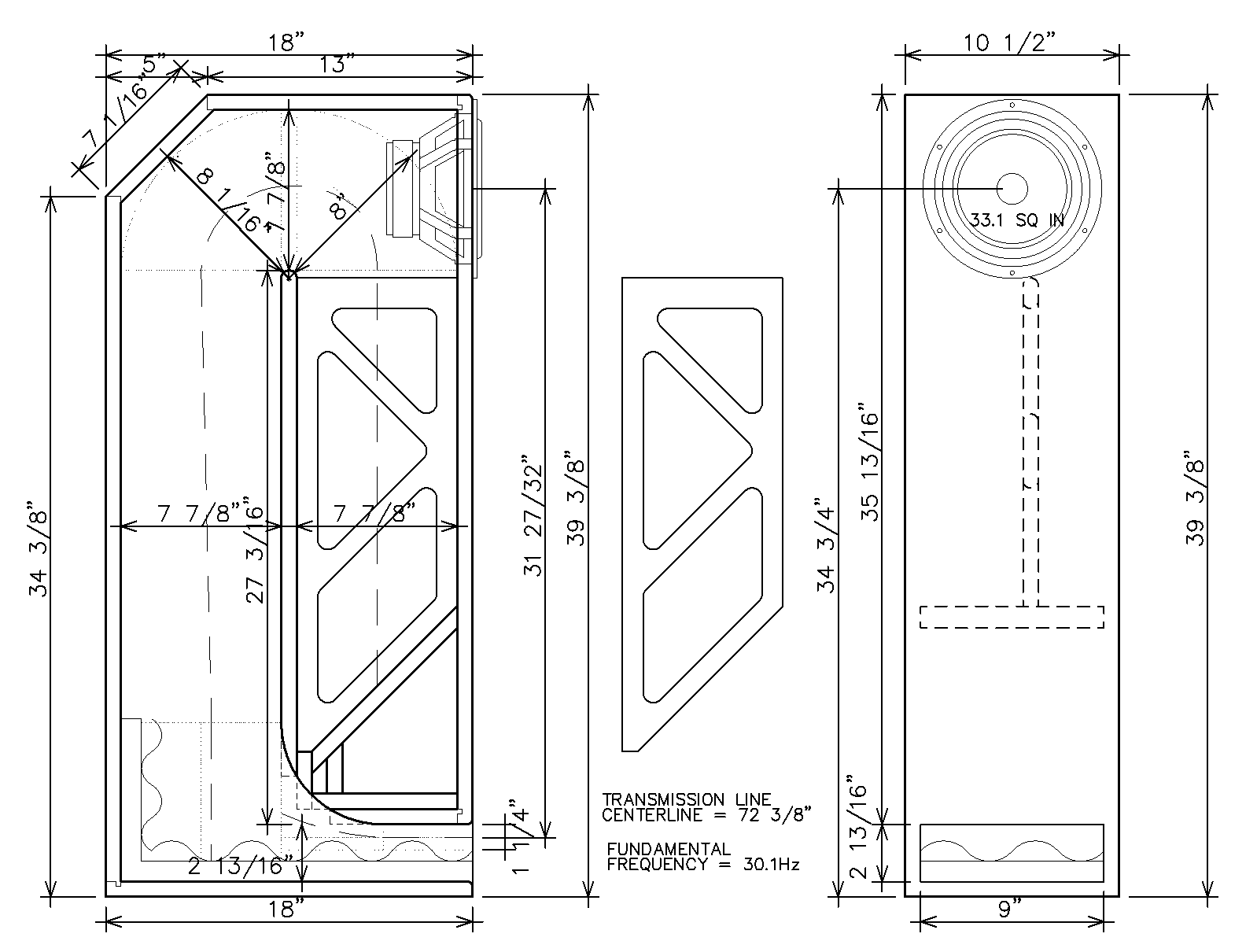

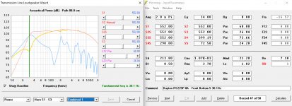

Hi Eric,
The pieces that make up the radius area would be cut square, making a stair-stepped form; which I would then smooth out into the radius with a belt sander, and an 80 grit belt. I actually made a little more tweaking to this, and ended up with a 5" radius. I have drawn these in with lighter dashed lines.
My understanding is that the air behaves relatively close to the same, whether the taper is linear or not. Partly because the taper is happening at a bend in the cabinet - which is not part of the model, either. The model is of a round space, and the cabinet is various rectangles - and the model is straight, but the cabinet is folded; but the model still applies. The model has some stepping and some tapering, and based on what I have seen, Hornresp does far better than seems possible.
On the eggcrate foam, I assumed that the "solid" 1" base is shortening the L34 segment. For the area of S4S and S5, I am counting to the midpoint of the bumps - so 1 1/2" from the bottom - because the top half of the bumps are close to equal to the dimples.
On the speakers that I built, I weighed the polyfill for the first an second sections, so it is pretty accurate based on the Hornresp model. When I measured the output of the terminus opening, it had a lot of output all the way up to 700-900Hz. Remember I am crossing the woofer with a 4th order Linkwitz Riley slope starting at 440Hz; which is considerably lower than what most 2-way woofers have. The higher frequencies were 15-20dB down from the woofer directly, but after I added (1 1/2") eggcrate foam, it audibly changed the higher frequency output from the opening.
On the speakers I have built, the terminus is 3 1/2" high, and I saw from these later models, that having a narrower opening extends the lowest bass, so constricting that earlier design is a helpful thing. For this update, since I want it to have the 1 1/4" high opening, I need to account for the foam to be in there. I am now using 2" to get as much high frequency attenuation as possible.
And since the eggcrate foam will turn up the back about 6", I am counting this as the taper in the later model, that I will include in this post. The bottom response is a touch flatter, and it keeps the 30.1Hz fundamental frequency.

Neil,
Ok, I see what you are doing with the radius. Your drawing showing the stepped pieces (before sanding) makes that much clearer. But I do wonder if you are not making unnecessary work for yourself. I tried a straight opening of 150 and got virtually identical results.
Mostly, I wonder if your assumption that the foam will act like it takes up 1-1/2" worth of space is a good one or not. I understand that the bumps and the dimples "average out". But it seems to me that your assumption is that the foam will act (in terms of cross sectional area) as if it is a solid, non-porous material. As I said before, I don't know for sure what your egg crate foam is really like, but isn't it substantially open? If so, then I'm thinking your S4S and S5 might be as much as 1.5 x 9 inches larger than you are modelling them as now. I tried it with the larger dimensions and the fundamental shifted up to about 34 Hz from 30Hz. Probably, the true "effective" area is somewhere between those extremes.
Concerning your brace. A very, very minor point, but I think it would be a bit stiffer if you made the struts to be the mirror image of their current arrangement. That is, so they meet on the left edge of the brace instead of the right side.
Eric
Eric, thanks again for your thoughts and comments. The effects of the radius; effectively tapering the 3rd and the 4th segments into each other, is somewhat subtle, but it lifts the response down to the F3 knee, to be a bit flatter, which is a good thing. I am hoping to wring out the most performance possible - this design is larger than the one I built, and as long as I am putting in the effort, it is worth chasing the last few hertz and decibels.
If anything, I think the foam will not act as a "stop" to the length of L34, and actually allow the resonances to be a touch better than the model shows. And as the air flows by the foam (after it has turned in to the last segment), since the foam is far higher resistance to air flow (vs the open channel), it will act like the segment is narrower there.
I can always try it without the eggcrate foam, or with 1 1/2" thick, or with the 2". This is reversible. I know that I need to damp down the high frequencies coming out of the opening, from the pair I built. So, I would rather have the greater area built into the plywood, and be able to add the foam if needed - which I am quite sure is better.
If the 'V' of the struts were mirrored, they would be bracing the upper and lower corners of the front rib, leaving a long span for the rib in the middle. It would be bracing 2 points of the front baffle, rather than 3 points. And the angled baffle is also already bracing the lower point, so having the strut there is not as useful.
Of course, I still have to see if I can cut all the pieces from a sheet 5'x5' Baltic birch plywood. If they are too big, then I will have to shrink it in one direction or another, to keep as much performance as possible. The plywood is not expensive (about $75 each with tax) but I'd like to not have to buy a third sheet just to get all the pieces I need.

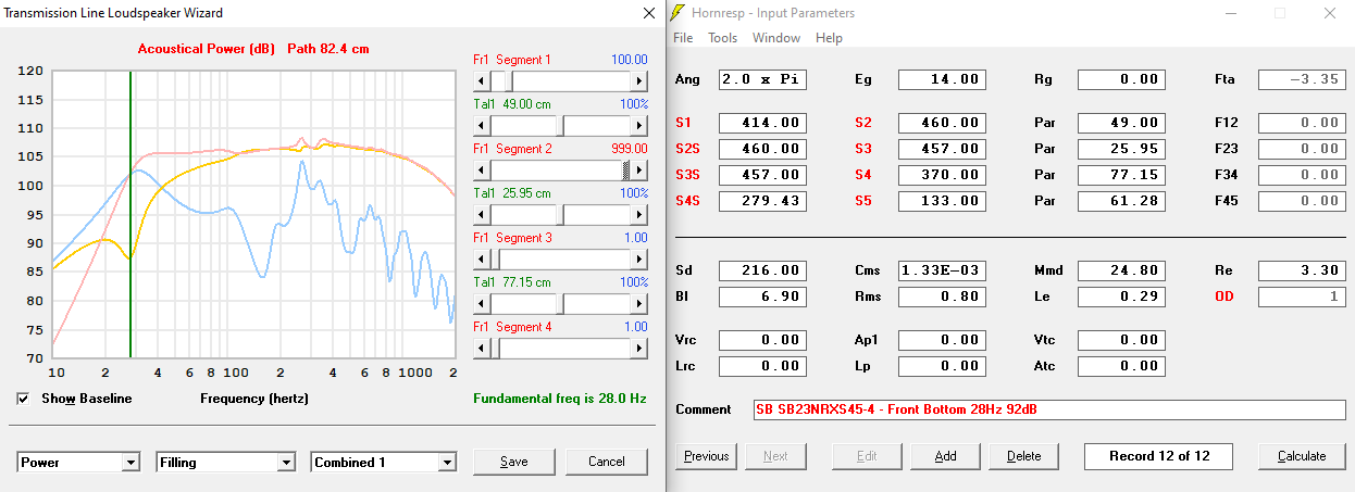

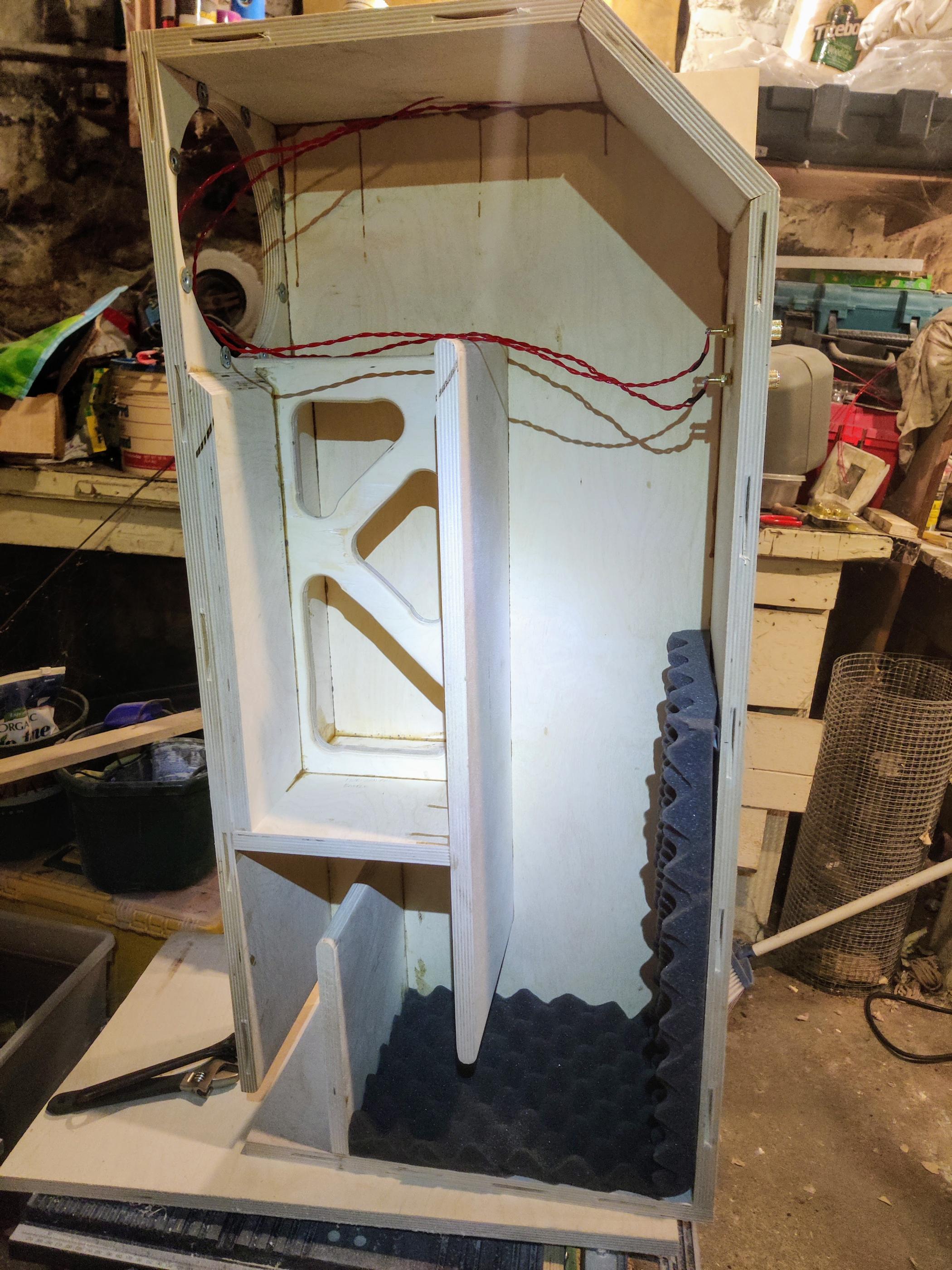

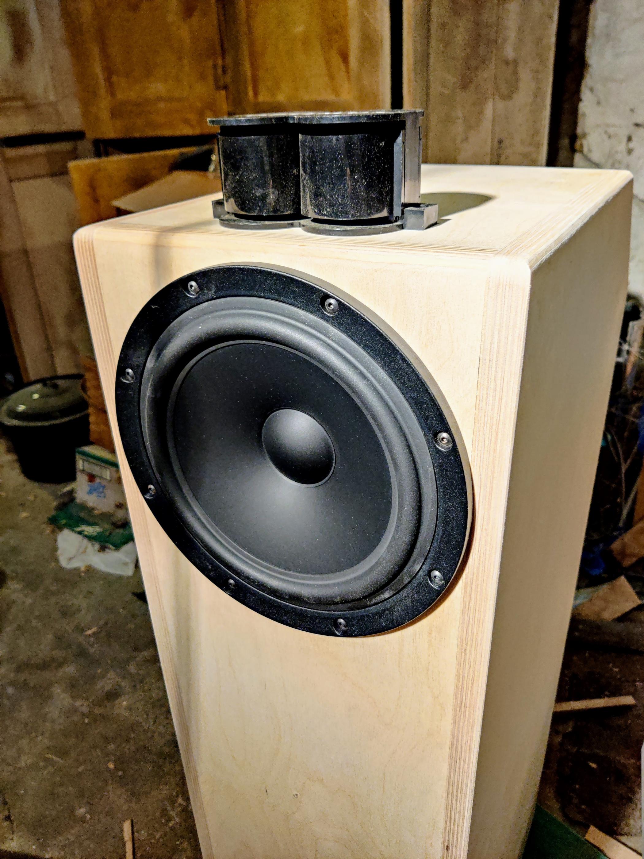

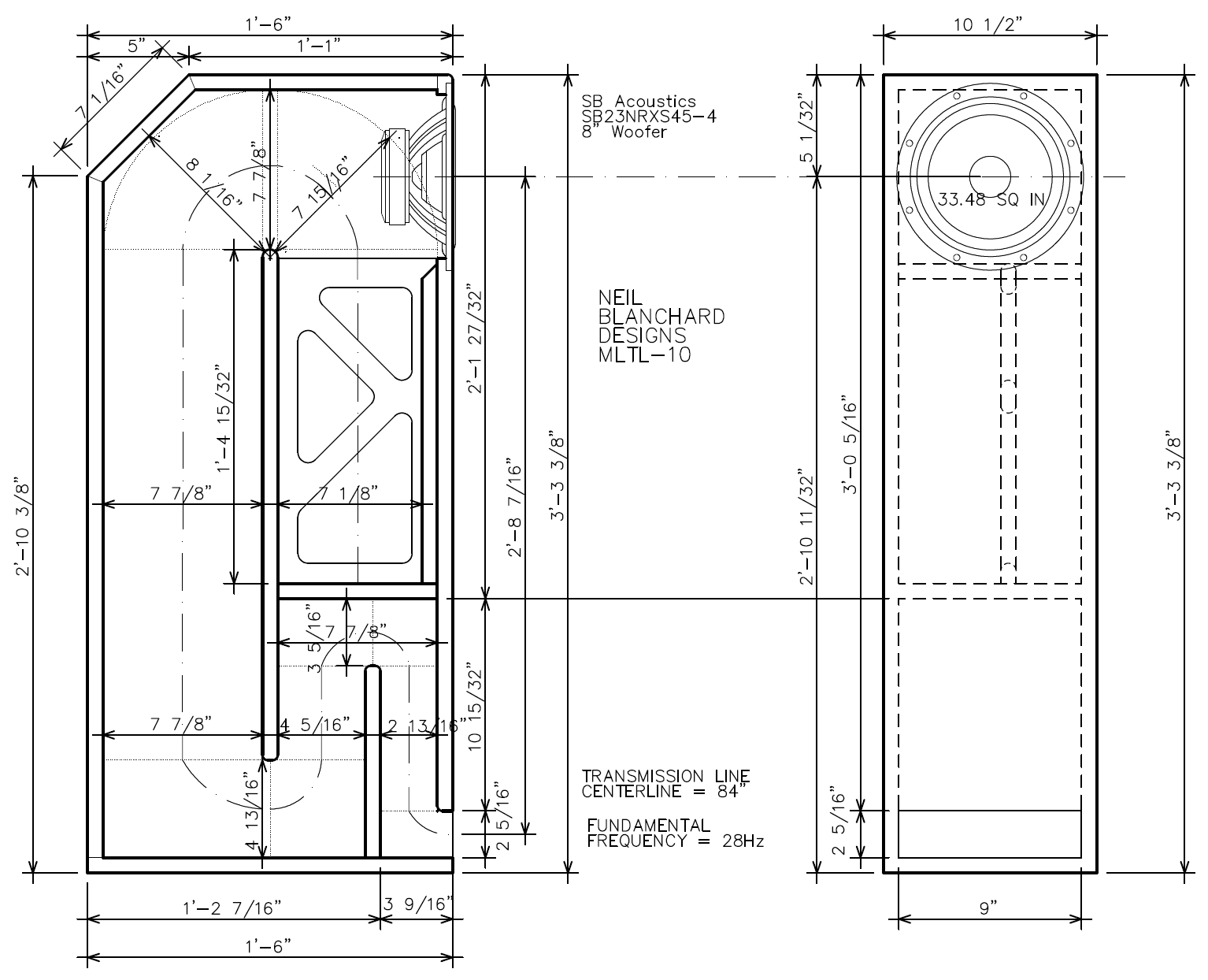

I have built a second pair of MLTL speakers, using the SB Acoustics SB23NRXS45-4 8" woofer. They use a Linaeum ET-8 (I will be building more with the ET-6A) dipole tweeter, made by Radio Shack. They sound fantastic, if I say so myself!
In the first photo, the second design is on the left, and the first one I did is on the right.

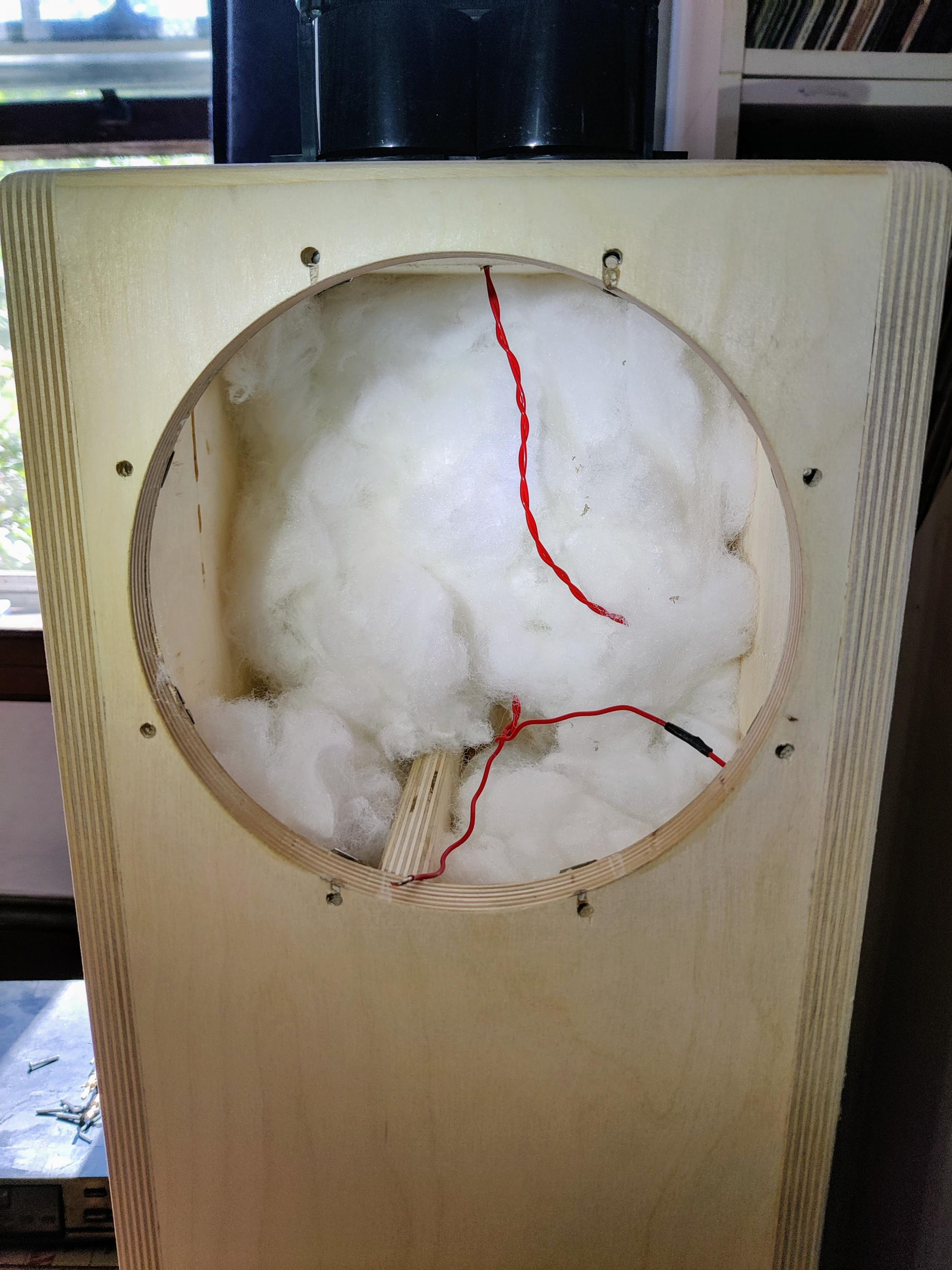

I am actually going to be experimenting with more poly-fil, and then maybe with low density foam. So far, I put the ~1oz (modeled in Hornresp) into the closed end - and it just sits on the bottom; no matter how much it is fluffed up. The 2nd segment right behind the woofer has ~9oz, and I have routed the wires so they support this fairly well.
I just modeled bumping the total up to ~21oz, evenly distributed, so 14oz goes in the 1st segment (closed end) and 7oz behind the woofer. I think that this is feasible with the poly-fil I have - I can push it through the web openings in the brace for some support.

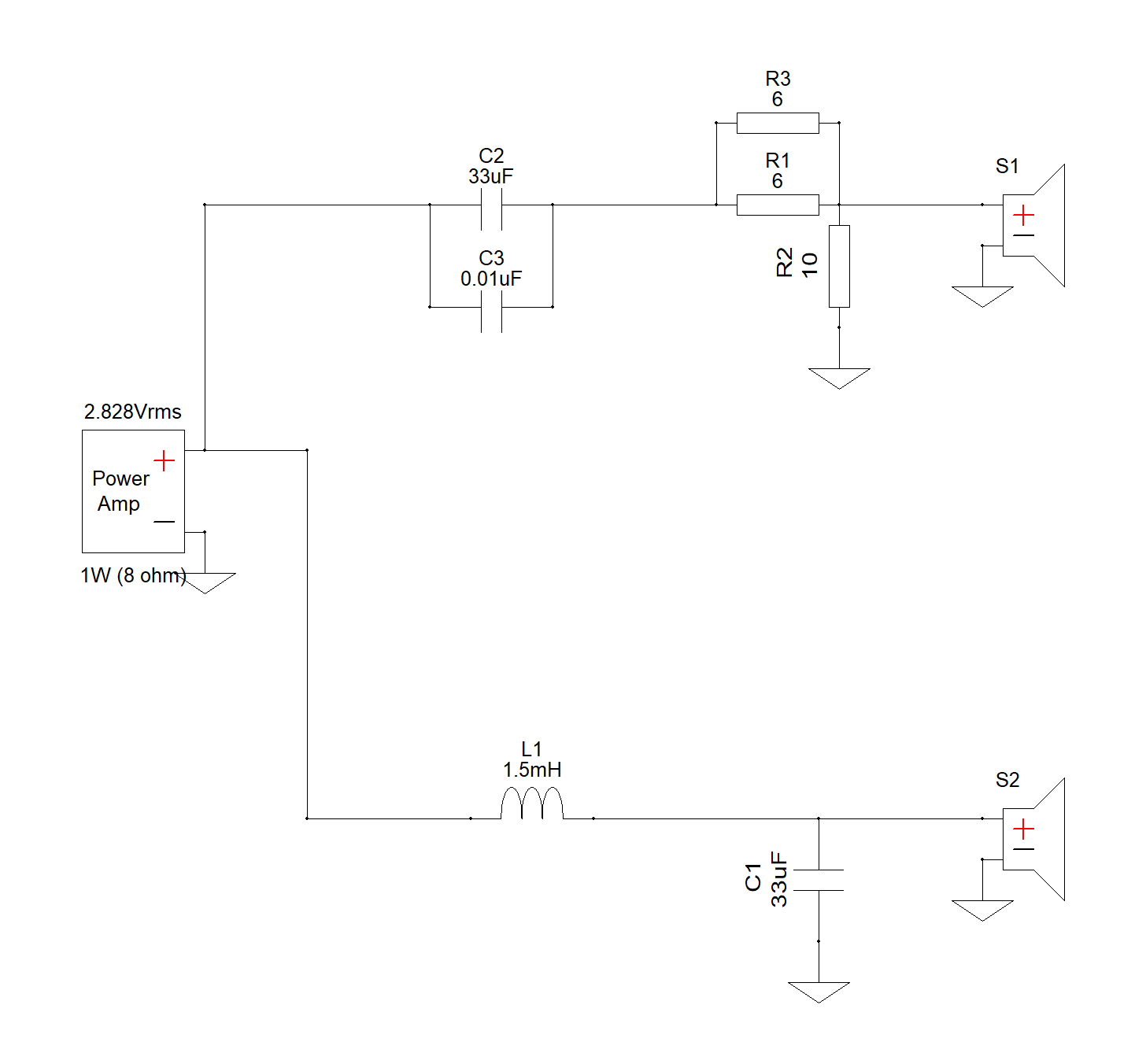

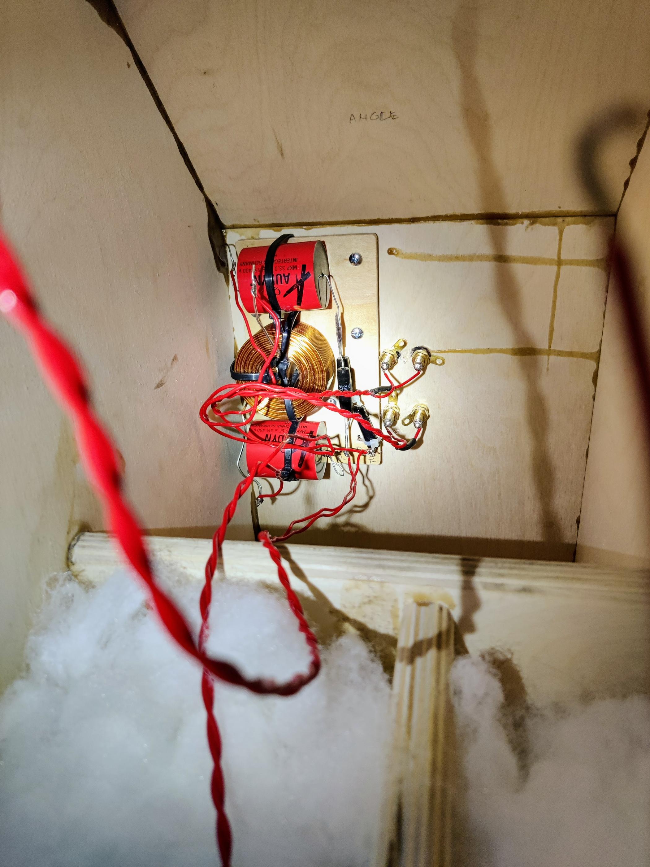

I will be doing more measurements, now that I have the analog crossovers (nearly) done. I think that the higher frequencies are damped more than the Hornresp model shows, because of the eggcrate foam, and because the S curve is going to exclude these frequencies. The Hornresp model is straight, remember.
Personally, I like the look of the terminus opening on the front, but if it works better on the back, then great! I am also planning on angling the bottom of the closed end 15-22.5 degrees; keeping the centerline length - this should broaden the resonance and reduce any standing waves. This could work with either the front, or rear location of the opening.
On the poly-fil - I started with what I had in the Hornresp model - ~1oz in the 1st (closed end) segment, and ~9oz right behind the woofer. I then modeled it with a total of ~21oz in total in those 2 segments. This lowered the F3 to 26.8Hz (from 28Hz) and sloped the shelf below ~90-100Hz down a bit more, which is fine, because the room lift at 30-45Hz is fairly significant - maybe 4-5dB, so a 1-2dB drop is actually a good thing.
But I used up what poly-fil I have by adding ~5.5oz to the 1st segment. I will probably get more poly-fil, and bump it up to the 21oz, when I add the bypass caps on the tweeter.
Here's the mod on the built design, with the 15 degree angle on the bottom of the closed chamber.
I will draw the suggested rear location of the terminus opening, soon and model it. And I'll let you know how it works there.
