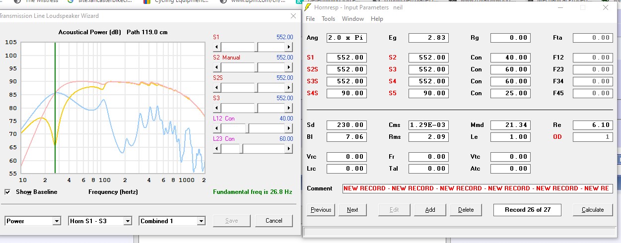

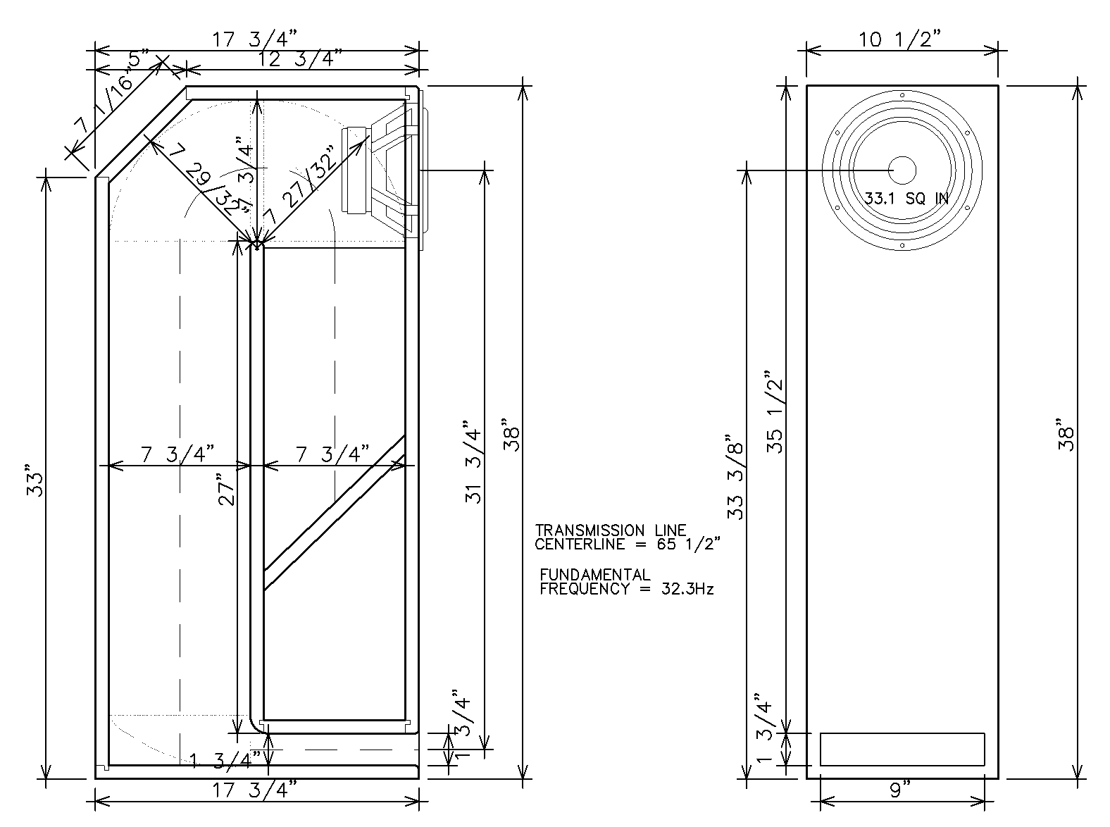

Here's the CAD drawing - the closed end is significantly shorter than before. The angled stop panel should prevent some standing waves.
Neil,
Hmm. What exactly is it that shortening the closed end does for you? It looks to me like you are wasting a lot of good volume, and you could get similar response in a smaller cabinet if you eliminate the angled member in the closed end. I think the way to deal with standing waves is with stuffing, and what you have in there already would probably be plenty, it seems to me.
Eric
By shortening the closed end, the response gets considerably better - the bumps above 200Hz that I thought were permanent - flatten out by shortening it. The angle at the end just is there to break up standing waves, without changing the tuning.
You're right that the void is a unused volume, but adding it back in means the response gets thrown off. I am considering trying to lengthen the L45 with that void, and see what that does.
But these three models / designs are the flattest and smoothest responses, with far lower fundamental frequencies, I have seen, so I am not going to sweat a bit of "wasted space".

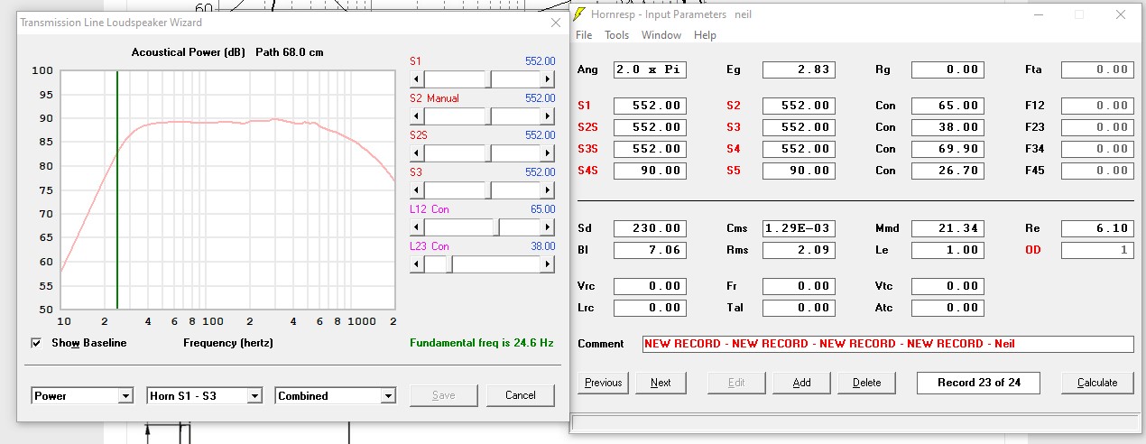

Neil,
I see what you mean about the bumps above 200 Hz. I was not seeing those as big enough to worry about, but if you want flatten them entirely then shortening the first section does work.
The other option would be to lower the driver (without creating the void). Then I get something like below, which is virtually as flat as the design with the void, but with the fundamental lowered to 24.6. This would put the driver between 29 and 30 from the floor (unless you put it on legs). maybe you prefer it higher?
Eric

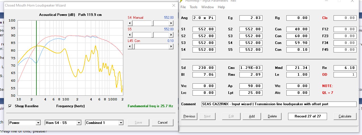

Hi Eric, thanks for pursuing this - I am looking for lower fundamental frequency, as well as smooth response. And I do want the woofer up as high in the cabinet as possible, to be close to the tweeter as possible. So, I will see what gets the best balance.
I have been working with a different style cabinet for someone else, here on the forum, and it also has a surprisingly low fundamental and it is very compact, too. It has a port on the back.
Can you attach the Hornresp file of this, please?
Mass Loaded Transmission Line w/ Port

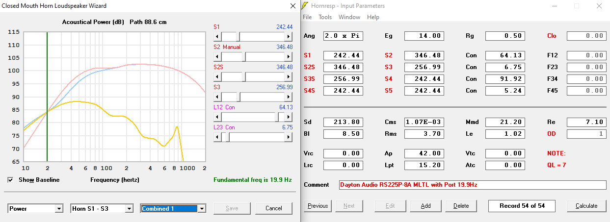

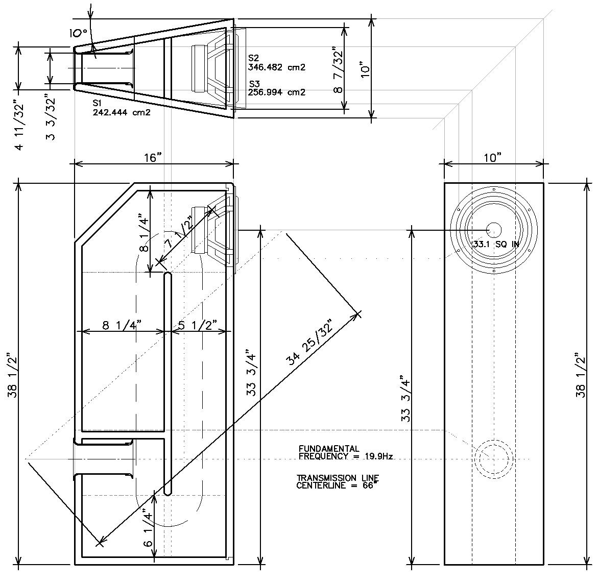

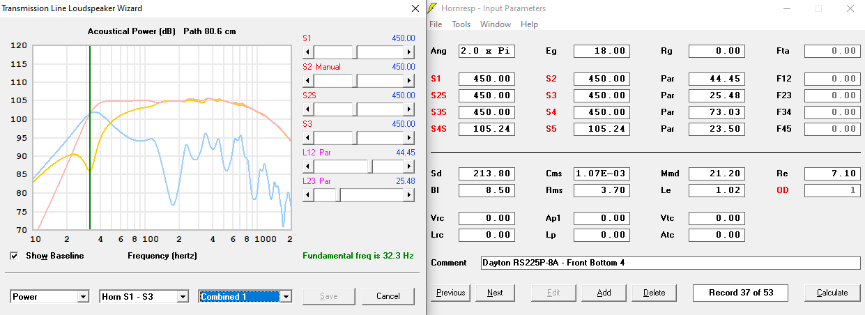

I have been working in Hornresp with a new (to me) schematic design - a mass loaded transmission line with a port. The response curve looks significantly different than the previous designs, that use a terminus opening - the terminus opening designs have very flat response above the knee, and that knee is very close to the fundamental frequency, and a they slope off relatively steeply.
But the ported versions response curve is smooth but less flat, and the knee is well above the fundamental frequency, and roll off less steeply. The two other major differences: the ported design is MUCH smaller volume, and the fundamental frequency is MUCH lower.
Case in point - look at these two designs, that use the same Dayton Audio RS225P-8A woofer.
Terminus opening: 66.8 Liters / 32.3Hz
Ported: 45.67 Liters / 19.9Hz
Other differences - the terminus opening has a lot of higher frequencies coming out through it, and I would have to increase the height of the slot, and then put in a piece of eggcrate foam. The port would have to be sourced - probably a 3D printed piece.

Neil,
The official name for the “port” is restricted terminus.
It acts as another LP filter allowing for less damping. Often just lined. Coupled with a Zd that kills the 1st unwanted harmonic one can yield closer to the minimum attenuation of the desired fundenmental.
The Zv can also be moved to tune things as well. Yours is at the R of your tube.
The tuning of the vent allows for a shorter physical line.
So an ML-TL is often done as a simple straight pipe.

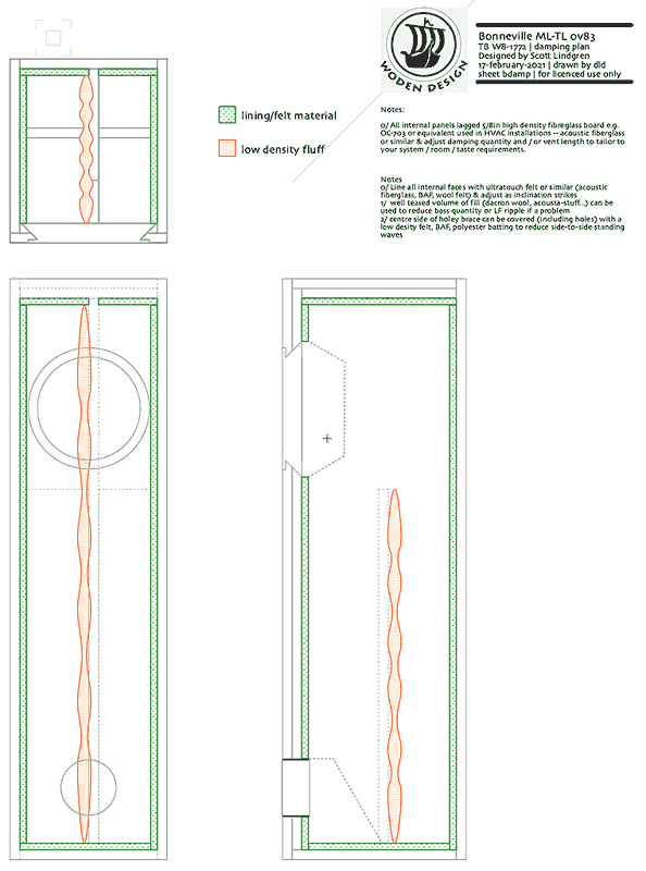

Here a quick snapshot of a planset i am working on, showing the short TL, an offset driver & vent, lined walls with low density damping righ tat the box centre to maximize absorbtion of anything moving side to side.
attachment.php
dave

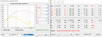

As I understand it, the only real difference between the "Horn" schematic that you've been working with until now, and the "MLTL with offset port" is that the latter version offers one more degree of freedom: It permits the port to be positioned somewhere that is not the end of the line. But otherwise they are effectively identical, and if you use "equivalent" inputs should provide the same results.
In other words, your "terminus opening" is simply a "port" that happens to be located at the end of the line.
And in your "ported" design, the port is virtually at the end of the line, so you could actually model that design reasonably well using the "horn" schematic and get virtually the same as you did with "port" schematic, as long as the inputs are equivalent.
For example, attached are two equivalent designs, based on the horn and TL schematics that yield virtually identical results.
And are you saying you are pleased with the new MLTL design? Sure, the reported fundamental is low, but if you look at the response, F3 is way higher for the new, smaller, ported design than for your original design.
Eric
