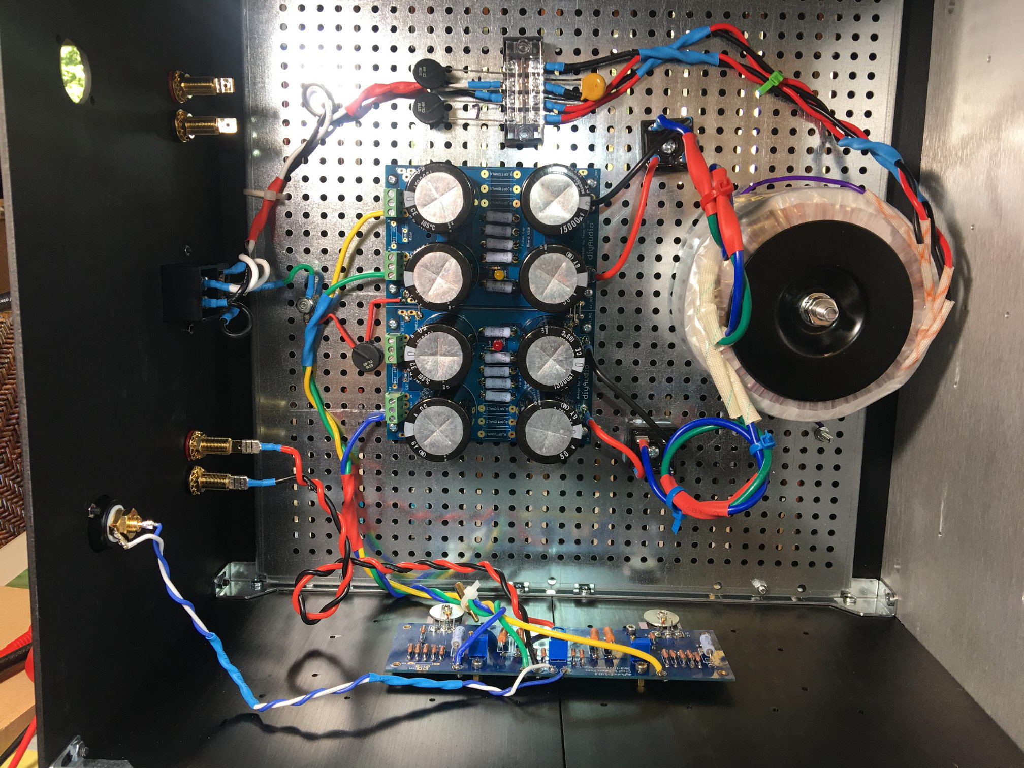

Ok that's great to hear ... I watched the youtube vid and can't say I hear anything immediately horrible but do hear a bit of transformer hum. I noticed you don't have the transformer bolted down, is it fastened some way?

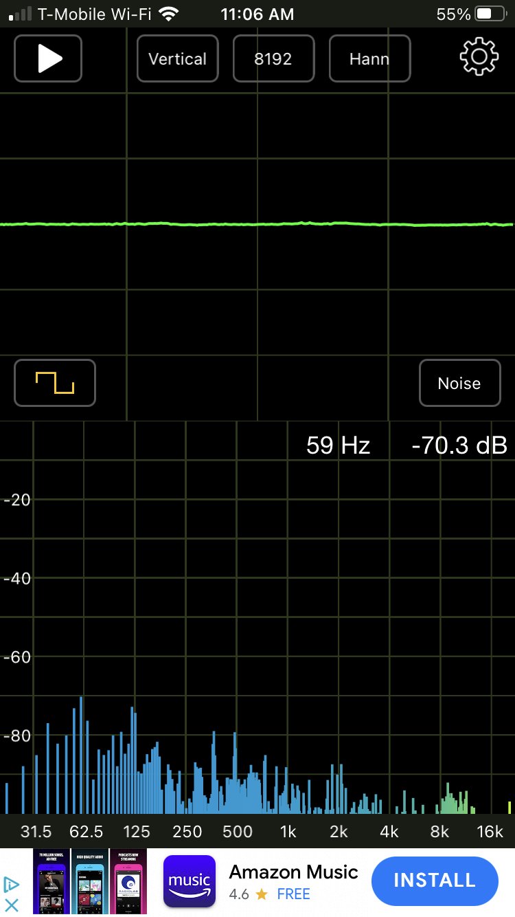

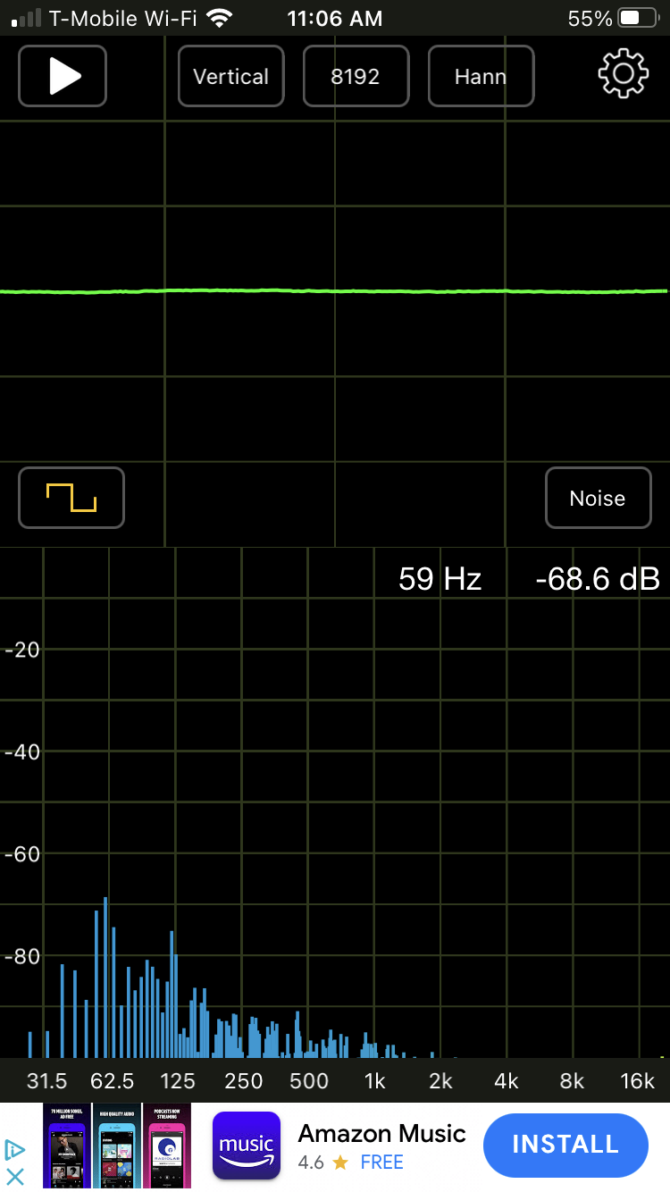

Download the app 'Spectroid' to you phone and see what frequency the noise is predominantly at (60Hz, 120Hz, etc).

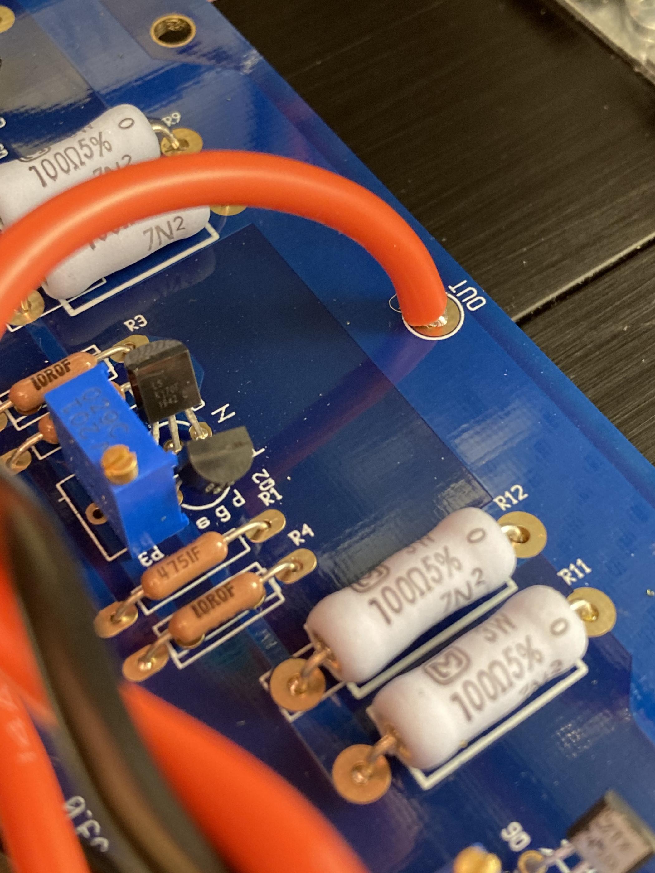

Hi Paul,
The potential issue with setting P1 and P2 to zero before soldering
is that depending on the orientation of the pot, the circuit will see it as either 0 ohm
(which is what you want) or 5k (which is not what you want). Direct measurement
at R5 and R6 gets around this problem.
It was resting on top of rubber pencil erasers. I just bolted it tightly to the chassis until the crush washer compressed and it's still humming!
I don't have android, but I found an app and it's showing a peak around 60Hz with harmonics, but its barely above the noise level in the room. I attached 2 screenshots--1st one is with amp on and 2nd is with amp powered off. There is about a 2dB difference.

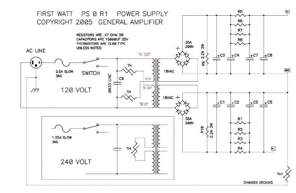

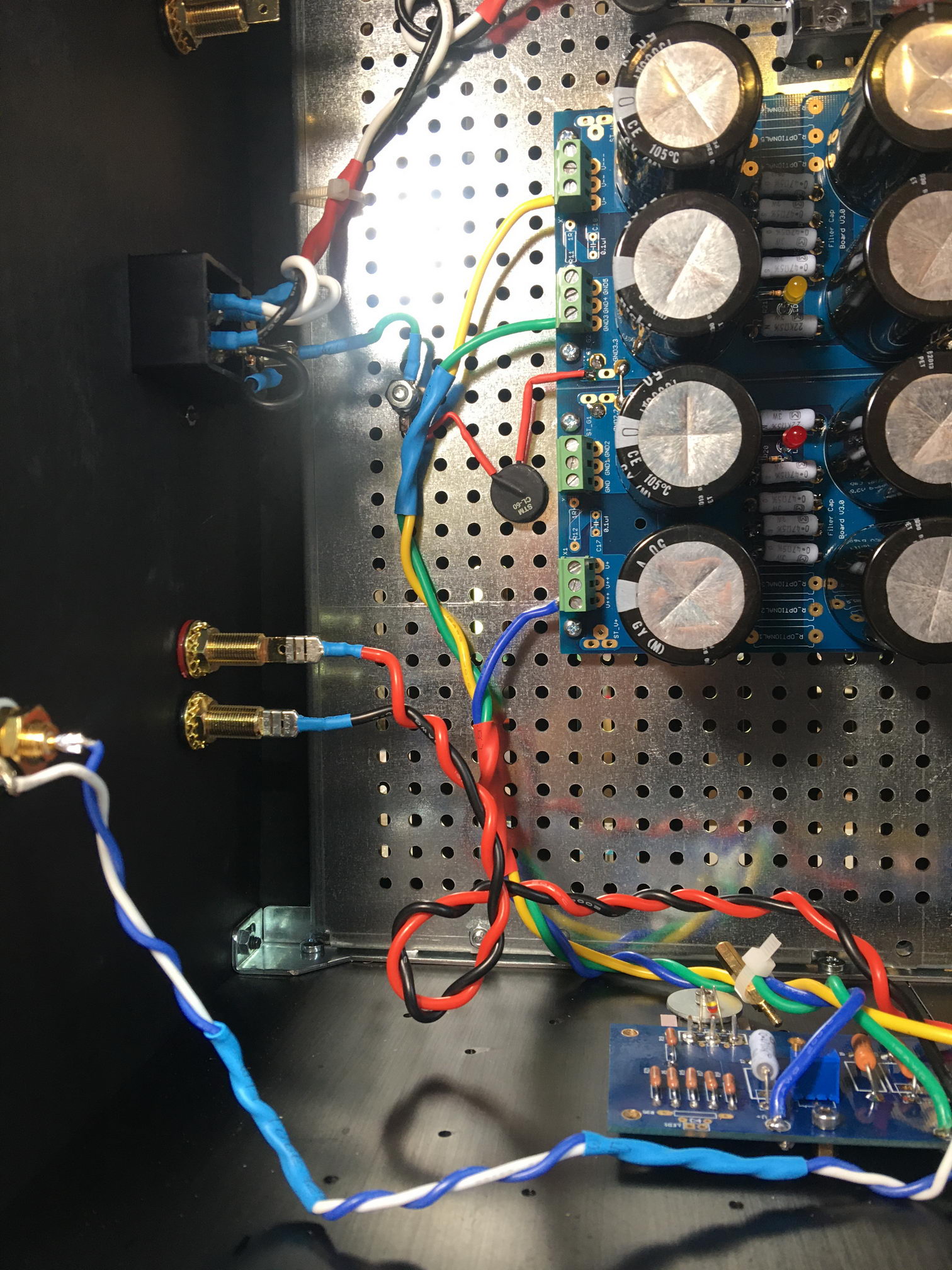

My main question is how should the PSU ground be wired? Should the ground from each rail only connect at one point at the final capacitor on each side like is shown in the F5 PSU schematic--although its ambiguous. Or should there be a ground bus with the ground side of all 10 capacitors in the PSU connected to it? And should the ground of each bridge rectifier be connected together as well?

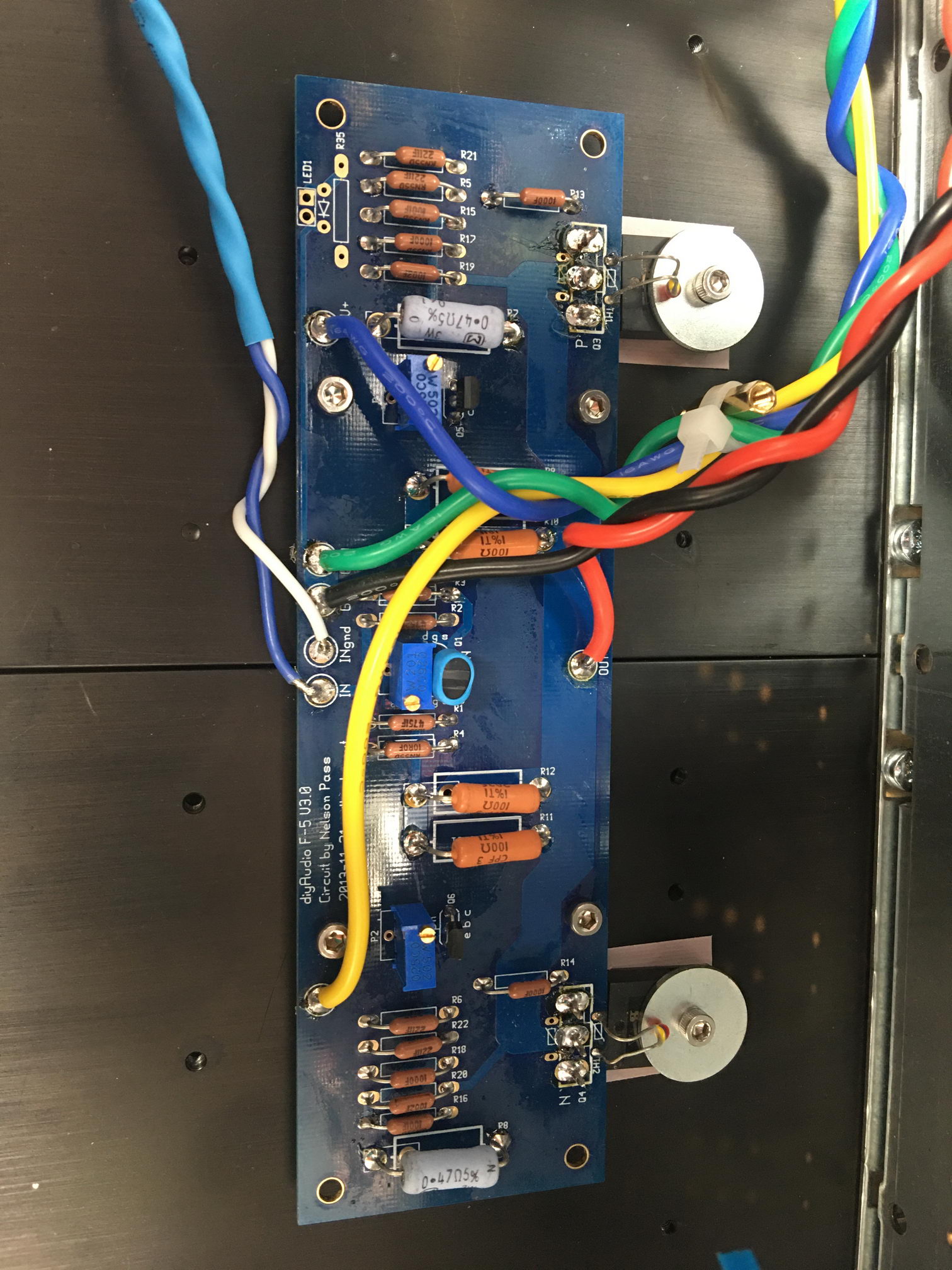

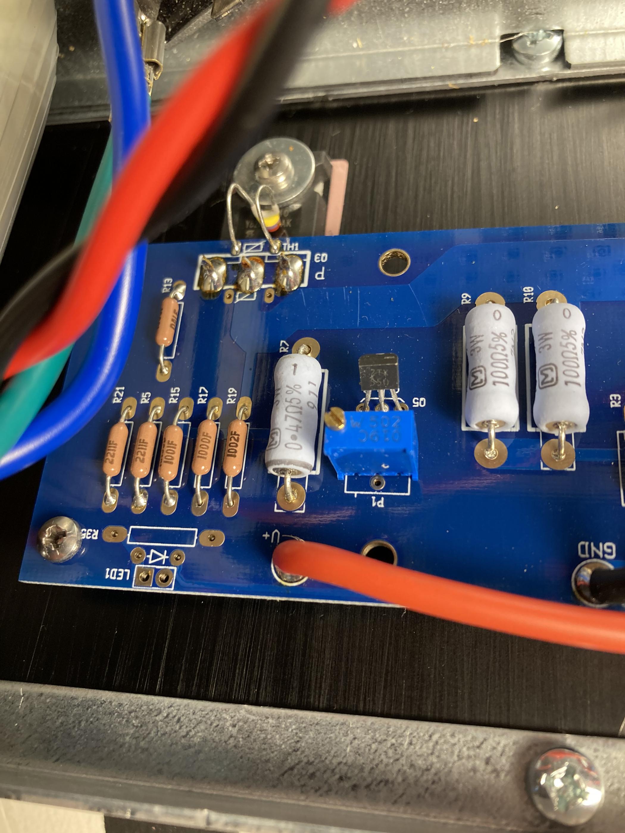

Hi Dennis. I attached the P1 and P2 according to the orientation shown in the V3 Build guide and I measured 0 ohms between lead 1 and 2 as marked on the potentiometer and 5000 ohms between lead 3 and either 1 or 2.
I'm not quite sure what you meant by direct measurement at R5 and R6. If I am measuring across the resistors then after a long period of rising readings both R5 and R6 stabilize at 1.06 Kohms. On the board that isn't installed and doesn't have mosfets attached those readings are 1.1K.

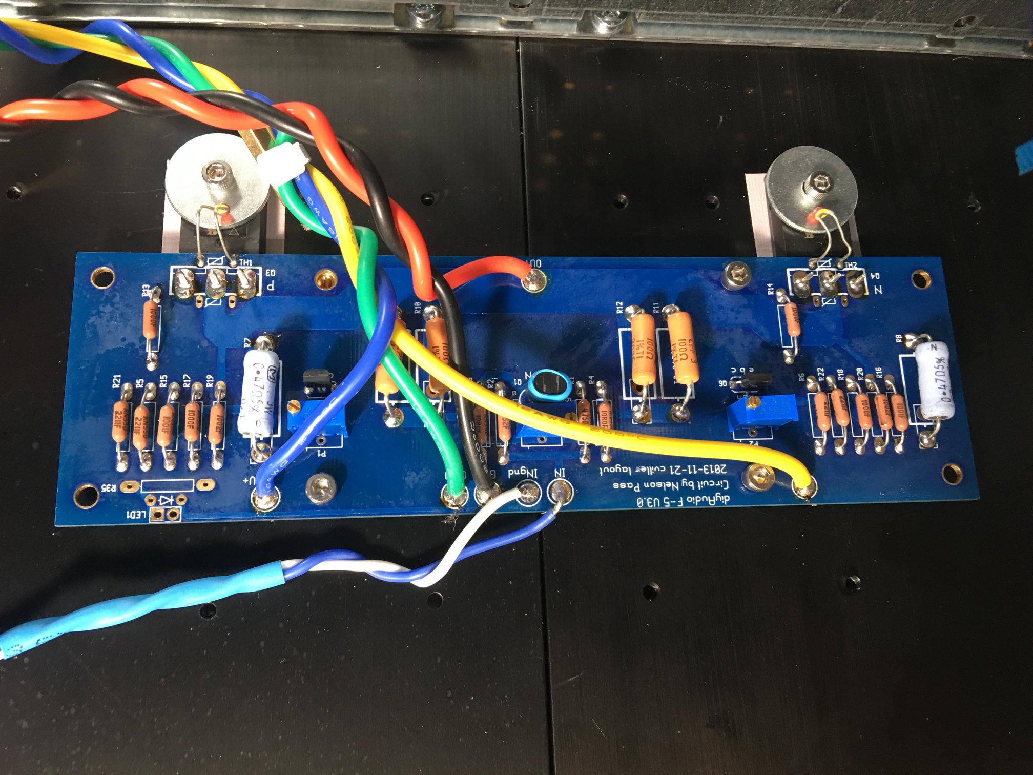

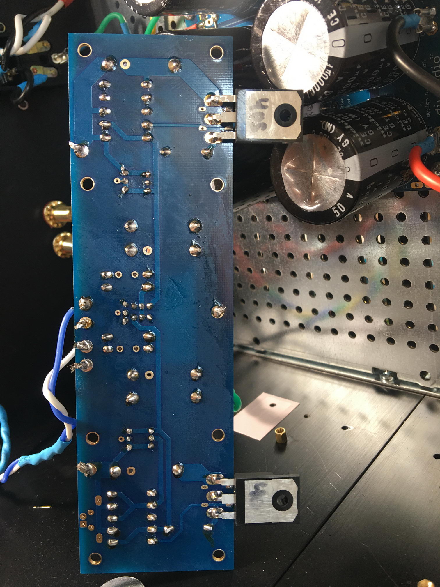

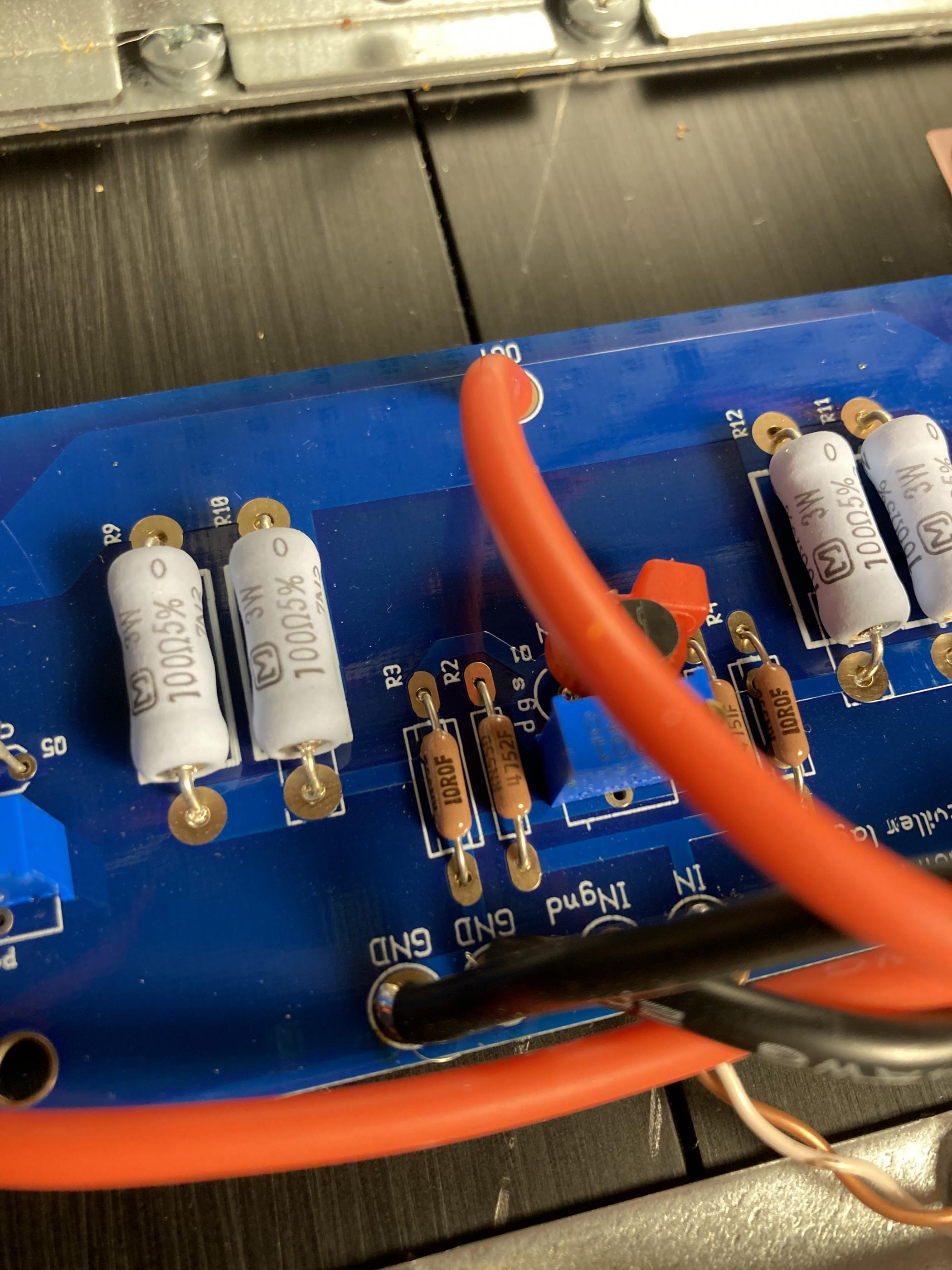

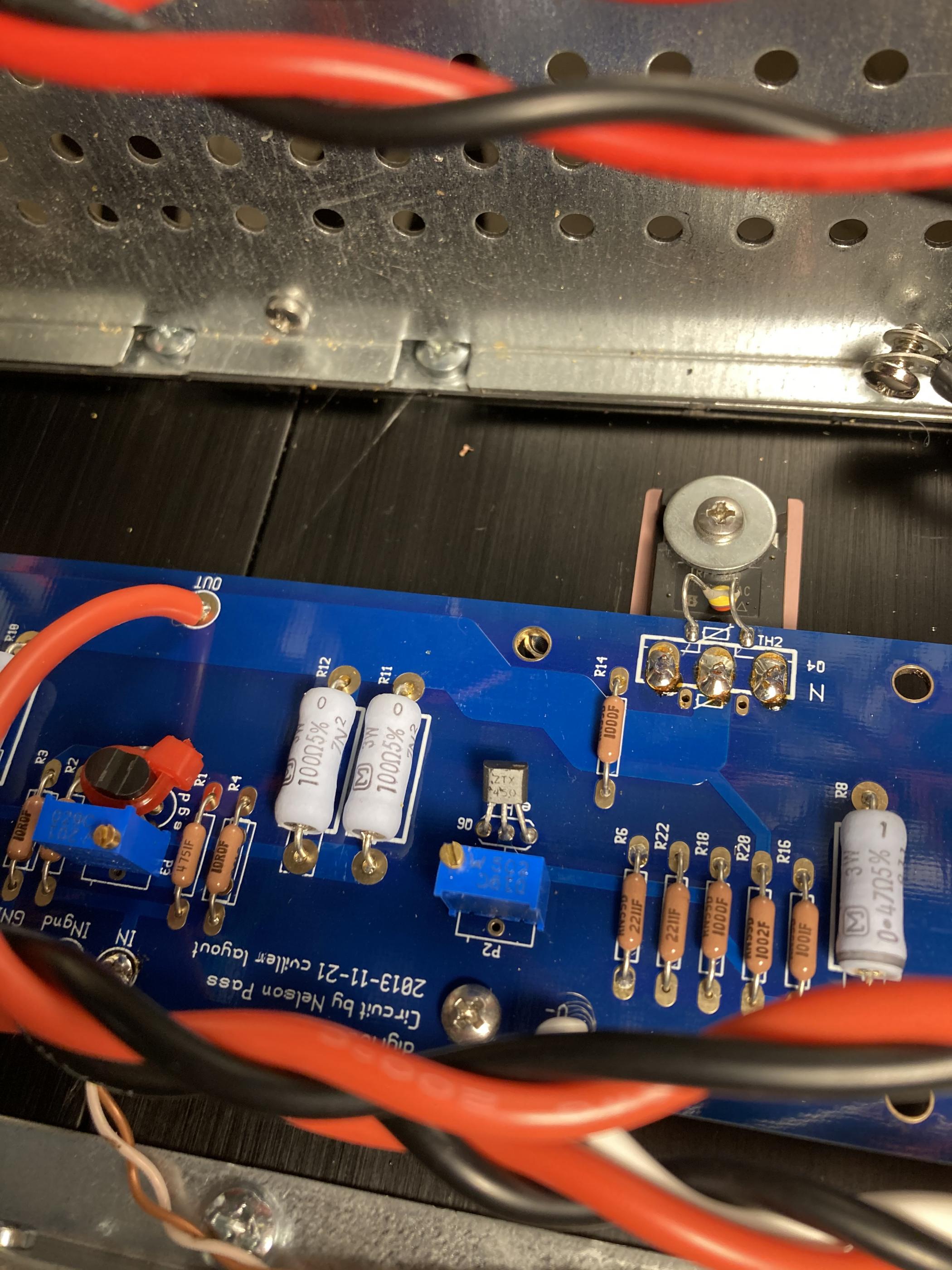

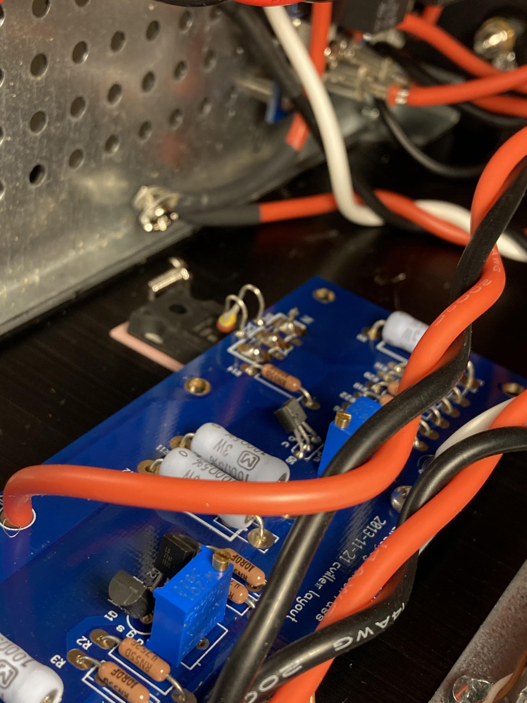

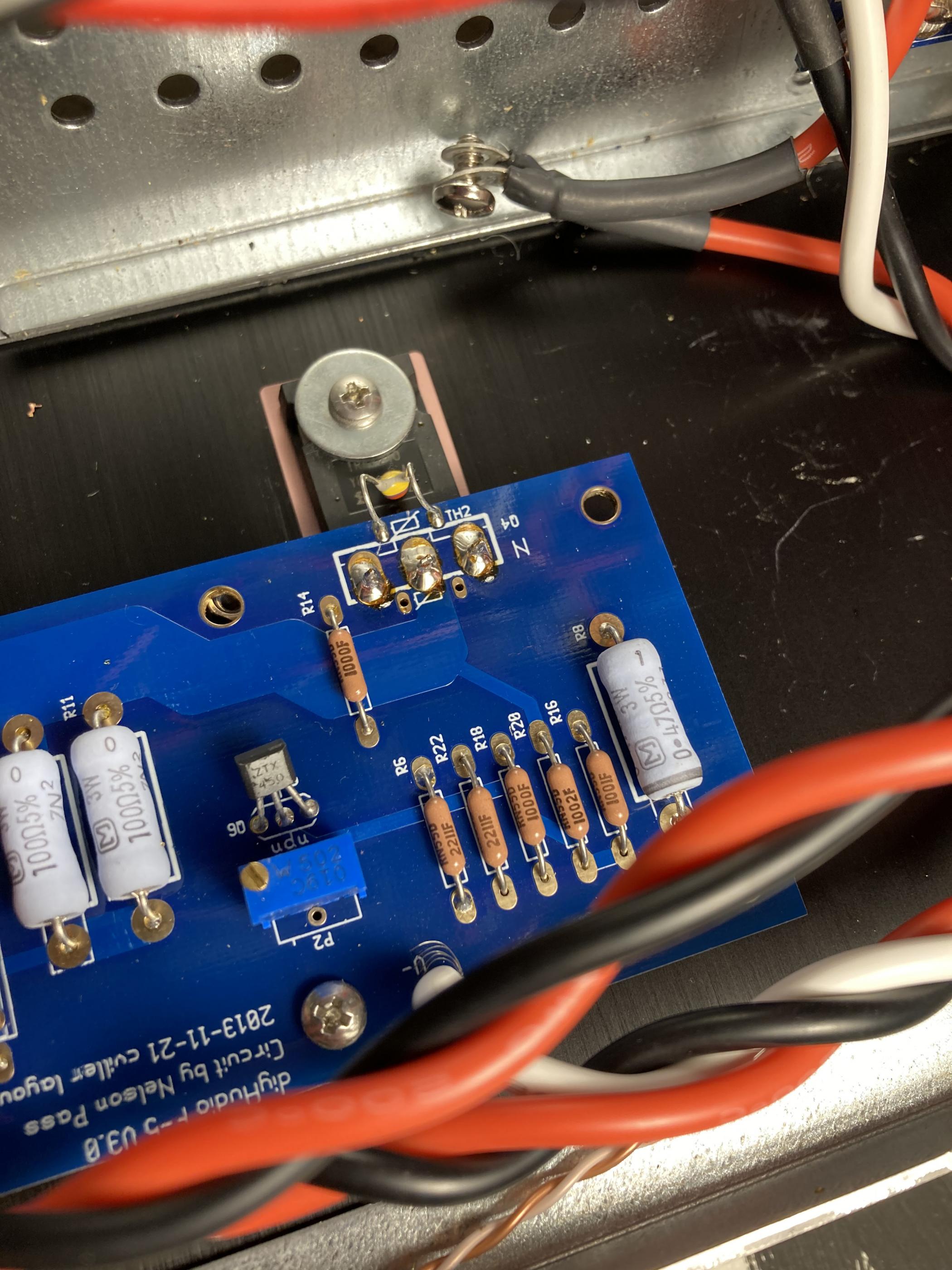

I am hopefully attaching pictures of my build.

Backing up a bit to answer one piece for clarity, what Dennis means is to set your DMM to resistance. Place the leads at either side aka "across" R5 and turn P1 until it reads the lowest resistance.
Then do the same for R6 / P2.
In addition, even though they may not be touching the heatsinks, those leads on the bottom of your board look long. While you have it up, I'd trim them off.

OK. Thanks to you and Dennis. Measuring across R5 and R6 which initially measured 1.06 kOhms I adjusted the P1 and P2 potentiometers so that that resistance is now 0.2 ohms. So I guess that means I had the pots set all the way in the wrong direction despite my best efforts to have measured correctly preinstallation?
I haven't tried turning the amp on after resetting the P1 and P2. I thought I should ask first if there is anything else I should be concerned about.
