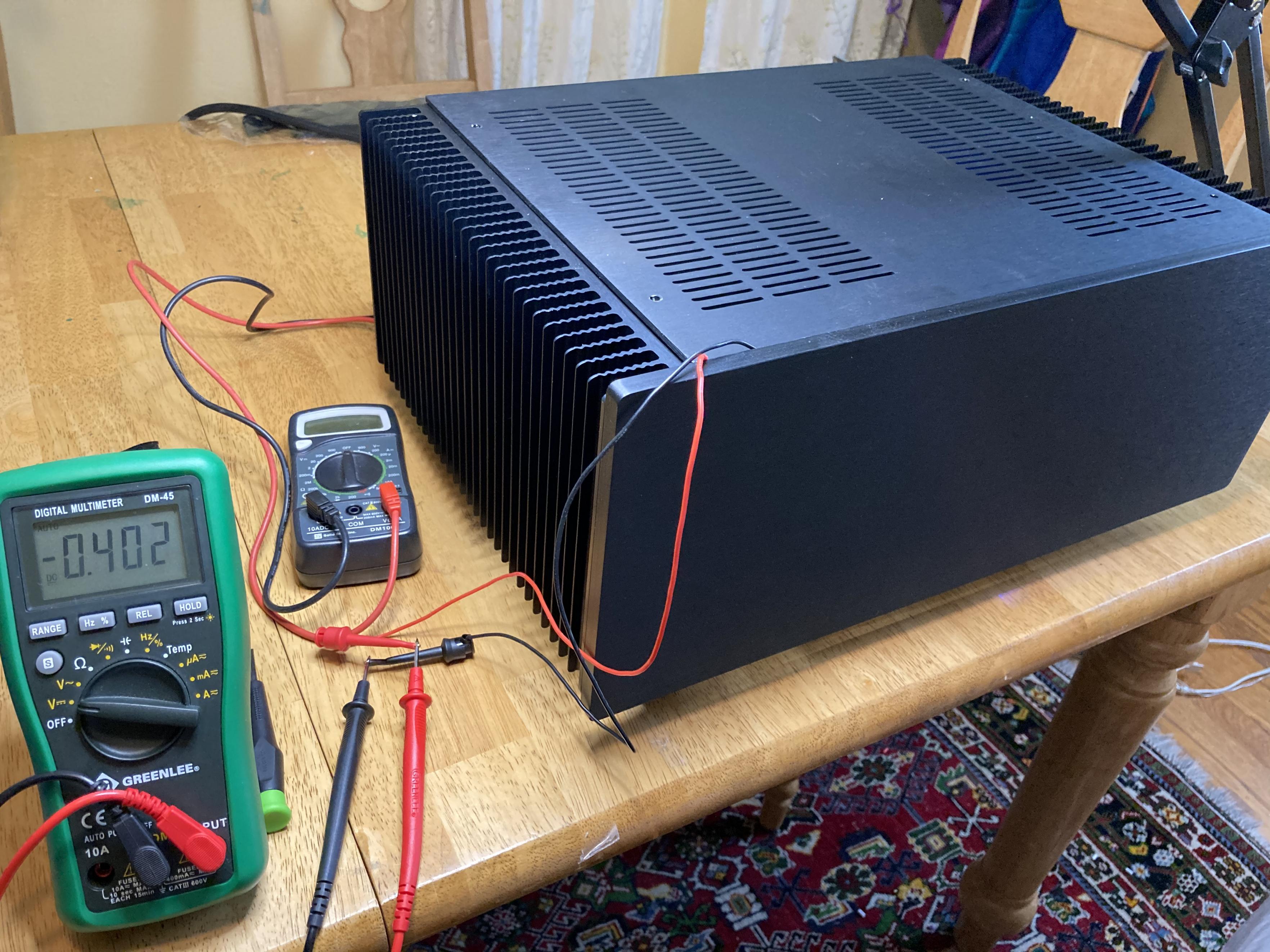

Setting and checking DC offset on output (needs to be very close to zero) is an integral part of the bias procedure with F5.
Bias and offset are interlinked, it’s all part of the whole to set the amplifier’s operating point.

Whats most important, that the offset is near zero or is it important that the 2
output transistors are the same (0.6v and 0.6v) or can one be 0.6v and the other 0,5v if offset is zero?
Transistors will only rarely be identical, as there is lots of (normal) variation in Vgs between the NPN and PNP mosfets. Get them as close as you can, with minimum (hopefully zero) offset.
I now have about zero offset,the transistors are at 0,6v and 0,495v(over the 0,47 ohm resistors)Is it okay??
It is okay. DC offset is what’s important.

I have my newly built F5 warming up with 400mV bias... Seems to be stable so far! Keeping my fingers crossed for final biasing to 600mV.
