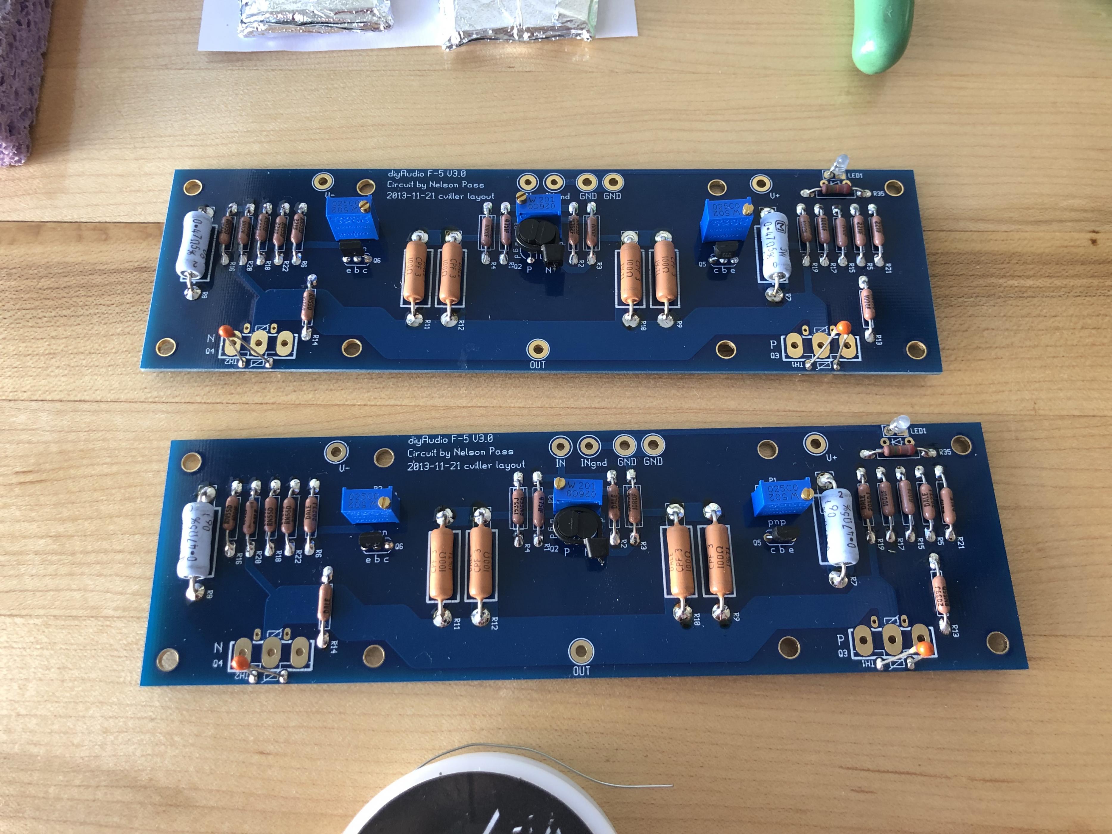

Very important to remember that turning those pots “down” is not necessarily counterclockwise.
Place ohmmeter across R5 and turn P1 until it reads minimum or 0 ohms. Label pot with a little arrow in whatever the “up” direction is. (Which will be the opposite of the direction used to get that measurement to 0.)
Repeat with R6 / P1.
Do not touch P3.
Do not touch P3.
Do not touch P3.
Advice worth a pound of gold!
Best,
Anand.
Do not touch P3.
I came here to confirm this and am pleased to see that it was just discussed! 6L6 (and plenty of others) thanks for putting in the time to keep up with all of us.
The trimpots that shipped with my F5 kit from DIYAudio measure 0 ohms when turned fully clockwise. So in my case once I'm powered up, I will be raising the bias with counter clockwise turns.
Just purchased my first variable transformer and looking forward to getting this little monster fired up over the weekend.
I’m piling on here, too. Excellent advice from 6L6. I thought I was being careful when I decided to reset the bias from scratch on my F5. Turned the pots all the wrong way at first, without measuring. After powering on, the resistors started to smoke! Powering down and measuring things correctly allowed me to start the bias procedure from a safe place.
