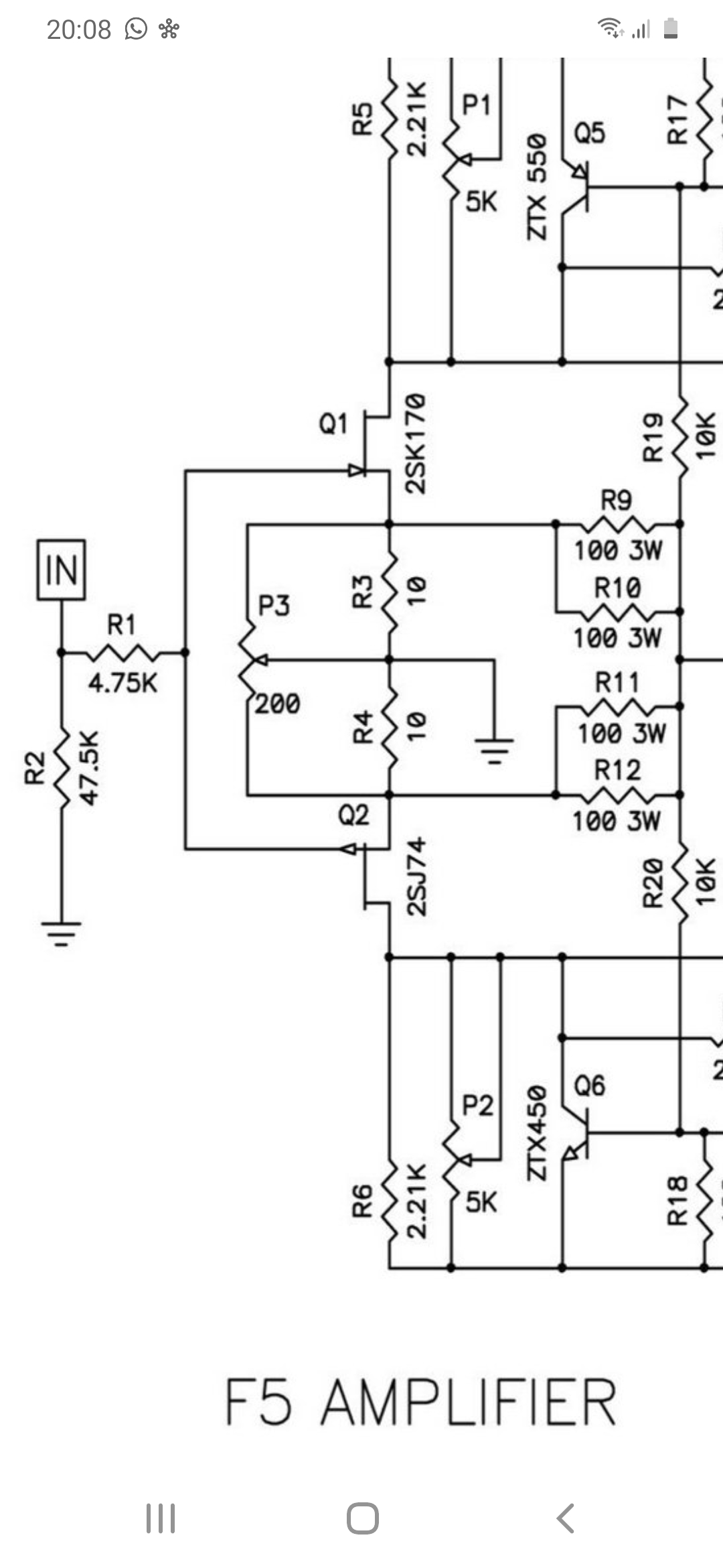

you can mount two equal resistors (P3/2) , or mount P3 and set it to measure equally across source resistors, or from mid to outer pins, before soldering in
Thanks for response all two, understod !! Cross fingers for set up the bias.... but tonight more. My wife is looking for me jajajaaj
Mount P3, set to mid point.
Sometime in the future when you have a way to measure distortion, you will be very, very pleased P3 is there.
You have all reason, I'll go to the electronic shop for bough it, because I haven't !!!
Thanks again !!
Thanks again !!

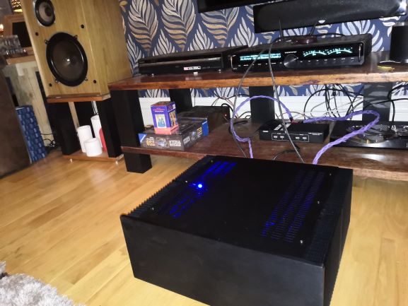

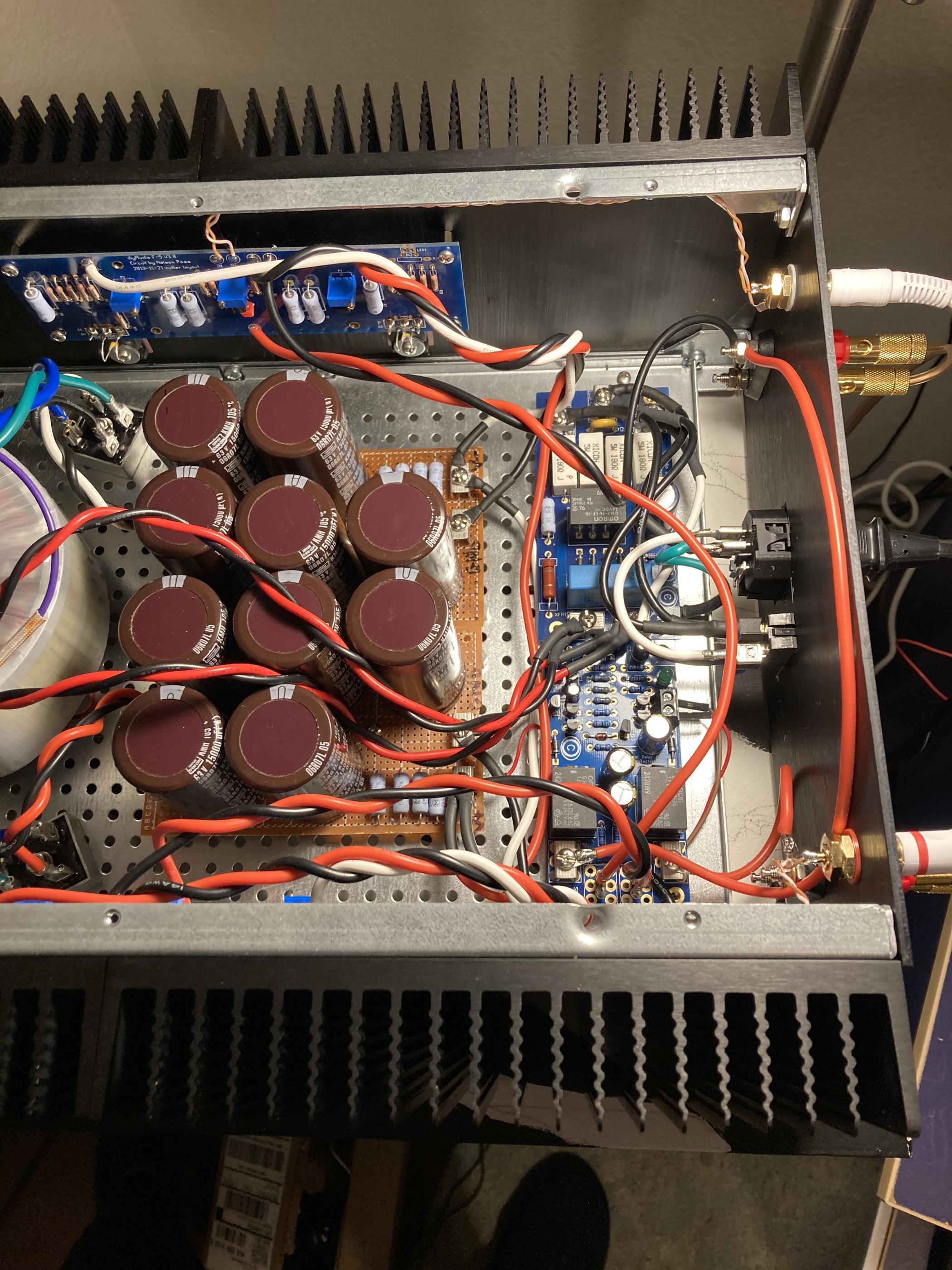

Well, after some decorating, building a new rack (both pictured) and Christmas, and getting hold of some Mosfets (with an M2X) I put everything back together without mishap this time and have had it on test - very pleased so far but there is a miniscule amount of hum I need to track down. Thanks for all your help! 😀
I've been through my connections and connectors and not found any obvious hum reduction. With nothing connected to the input there's no hum, but as soon as I connect my source (Logitech Transporter, no dedicated Pre) I get the hum. Same with CD player swapped in instead.
Most of the time it's inaudible above the music but my wife often sits with head near one speaker plyaing low volume and it's definitely noticeable there.
Any thoughts on additional hum reduction? It's a by-the-book build with only difference a Velleman Speaker protect circuit on the outputs.
...With nothing connected to the input there's no hum, but as soon as I connect my source (Logitech Transporter, no dedicated Pre) I get the hum. Same with CD player swapped in instead.
Input ground loop. Can be tricky. Photos of everything please. 🙂

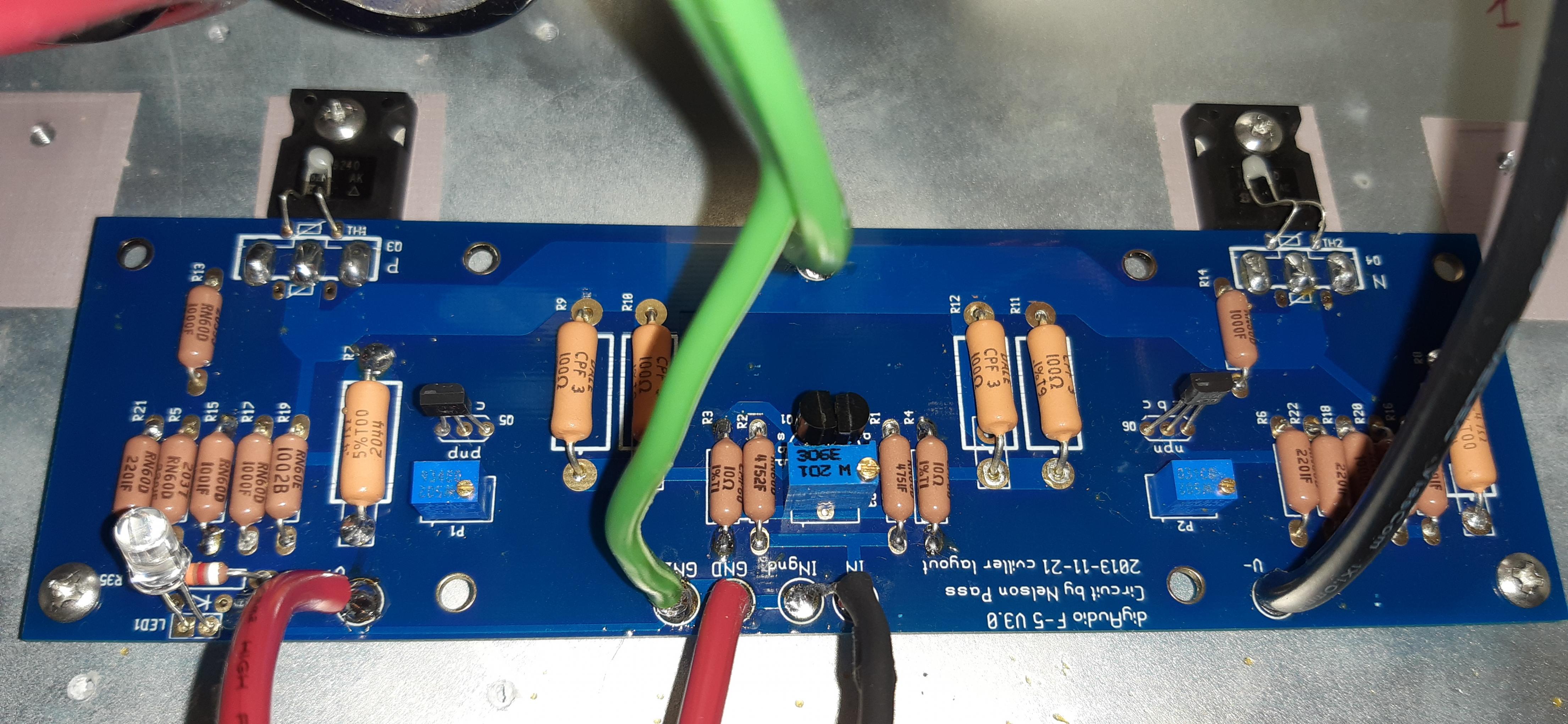

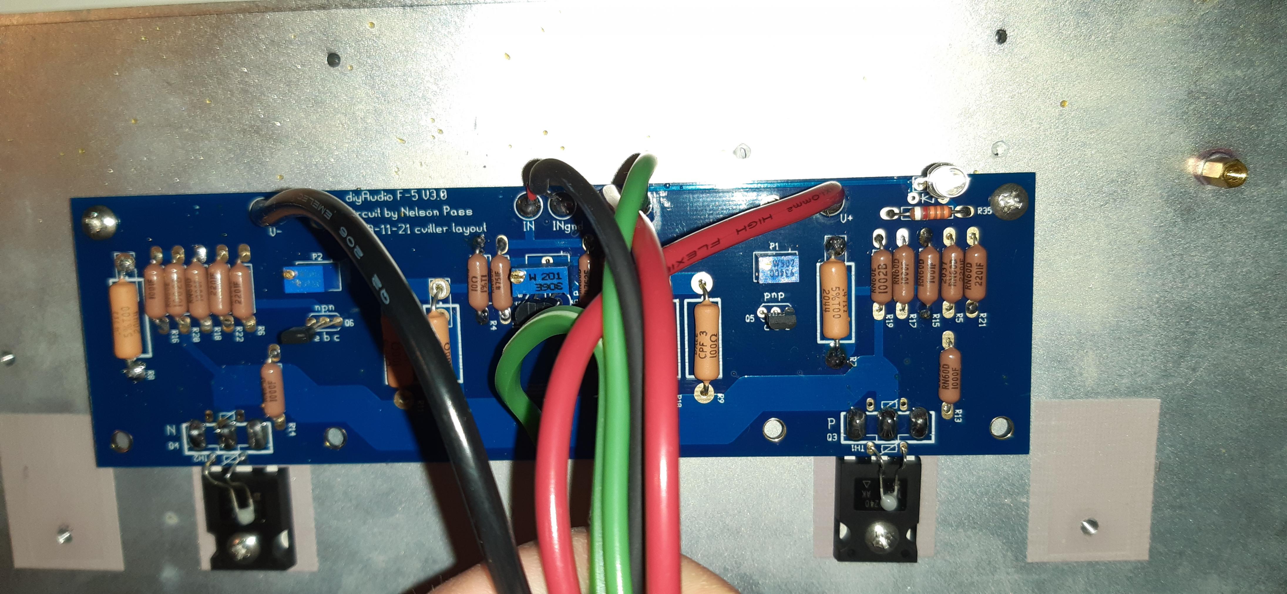

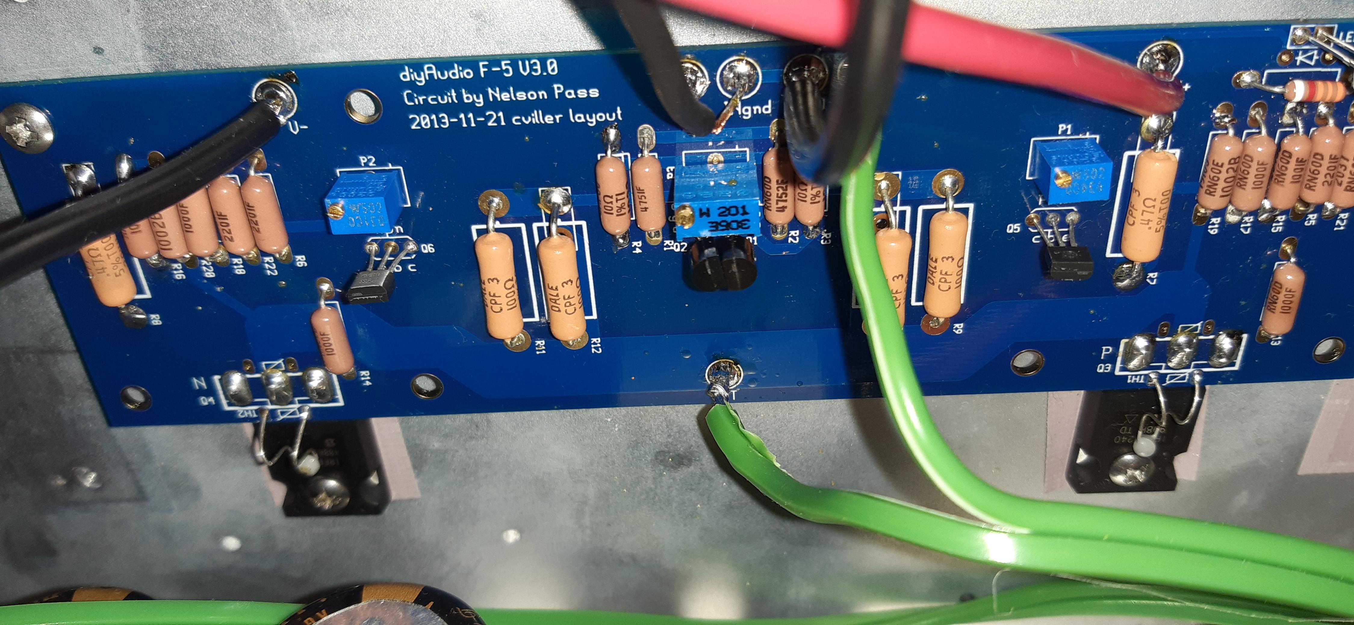

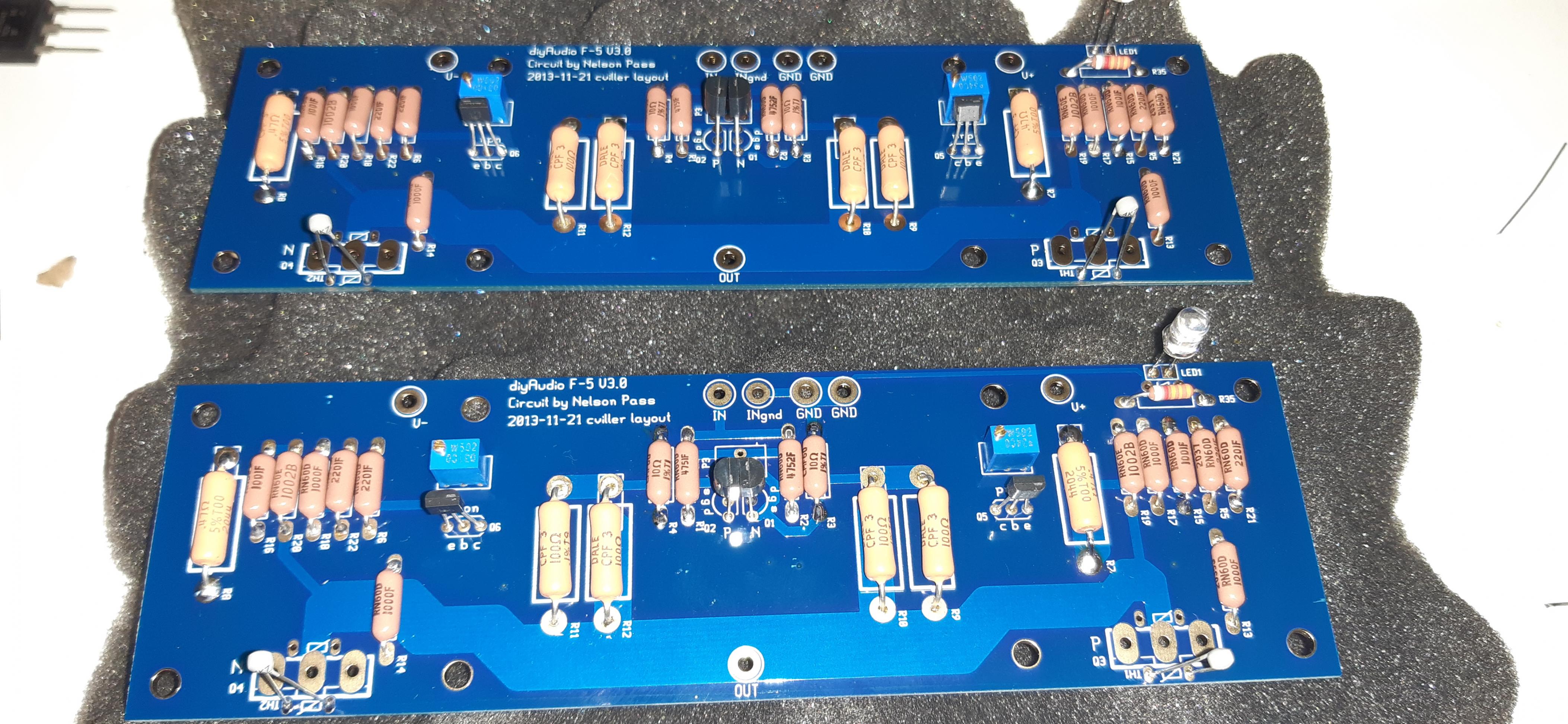

Well I dismantled again ostensibly to get pics - removed the Velleman speaker protect module as I read there was no start up thump to worry about, and hey presto - hum has gone. 🙂
morenmgu - w/o seeing where all your wires go from the boards, It's tough to fully check.
It looks like you've stuffed the boards correctly, but at least one other person should comment, and there were a few values I could not see.
Here are a few things I see.
1) Board on left, you have a solder bridge shorting your input. This shouldn't cause your issue, but you'll need to clean that up.
2) I can't tell how you have your boards mounted. Do you have stand-offs separating the board from your heatsinks? If not, you may have some of your wiring shorted to the heatsinks, particularly if you stuffed and soldered the wiring from the top after you installed the boards. This may relate to your situation. Did you check continuity for all the pins on the MOSFETs to the heatsink prior to installing your other wiring? Did you use a dim bulb tester for initial power up?
3) Eventually, you'll want some fender washers and some type of split washer or belleville washer to ensure your MOSFETs remain in good contact after a number of thermal cycles and that the pressure on the MOSFET is more evenly spread. Likely not related, but it's a thought.
I'm sure others will have some helpful thoughts.

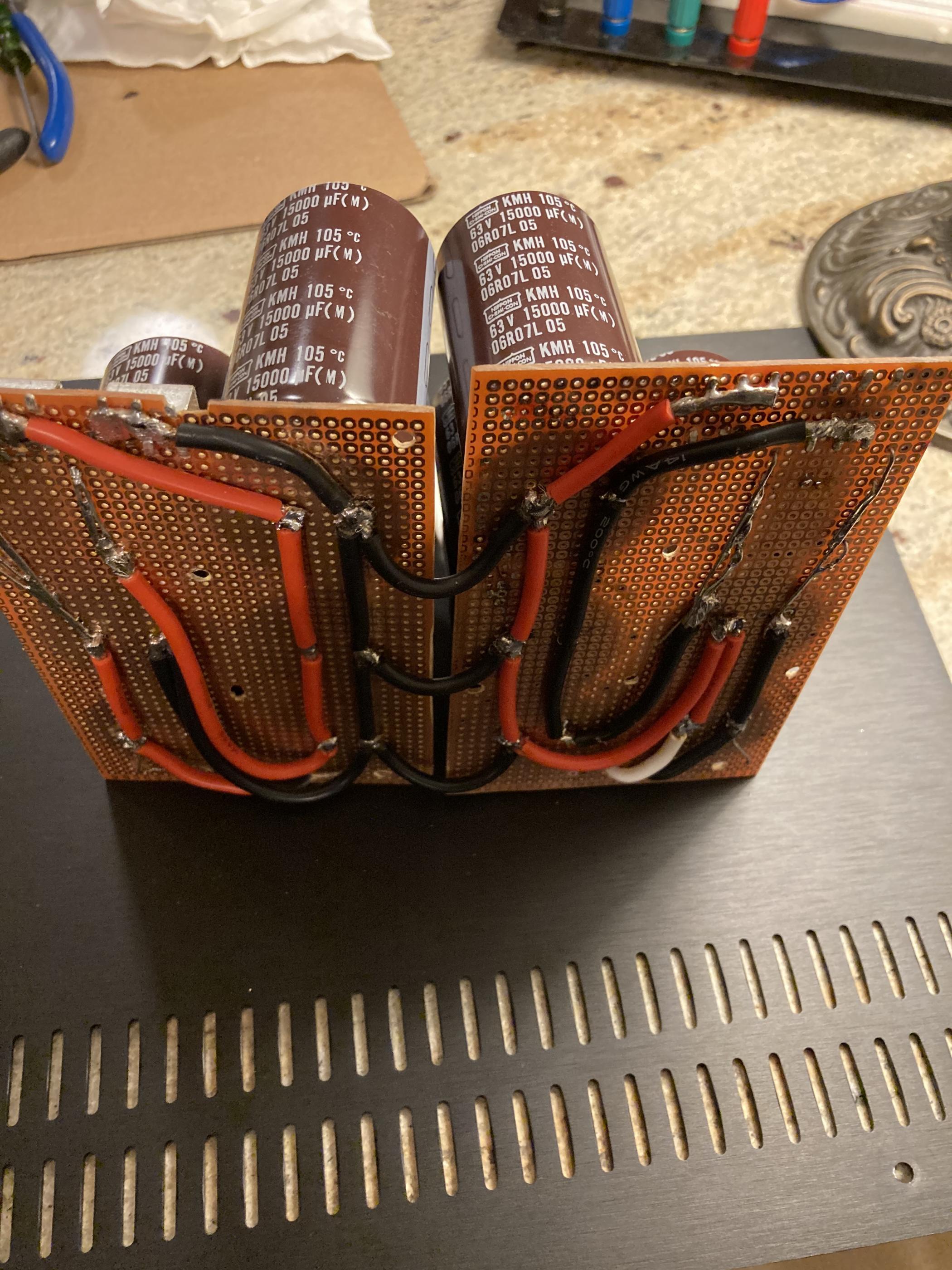

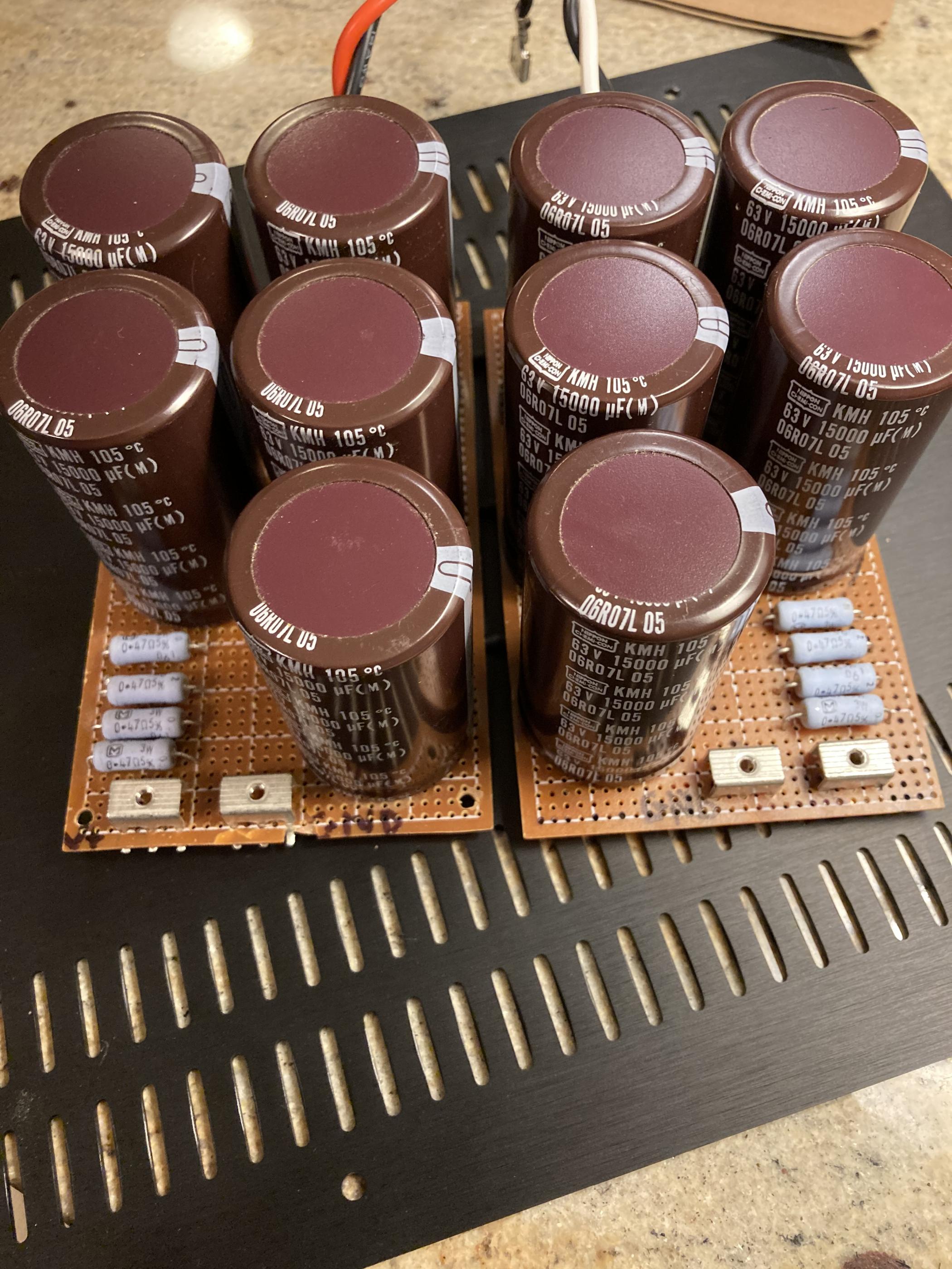

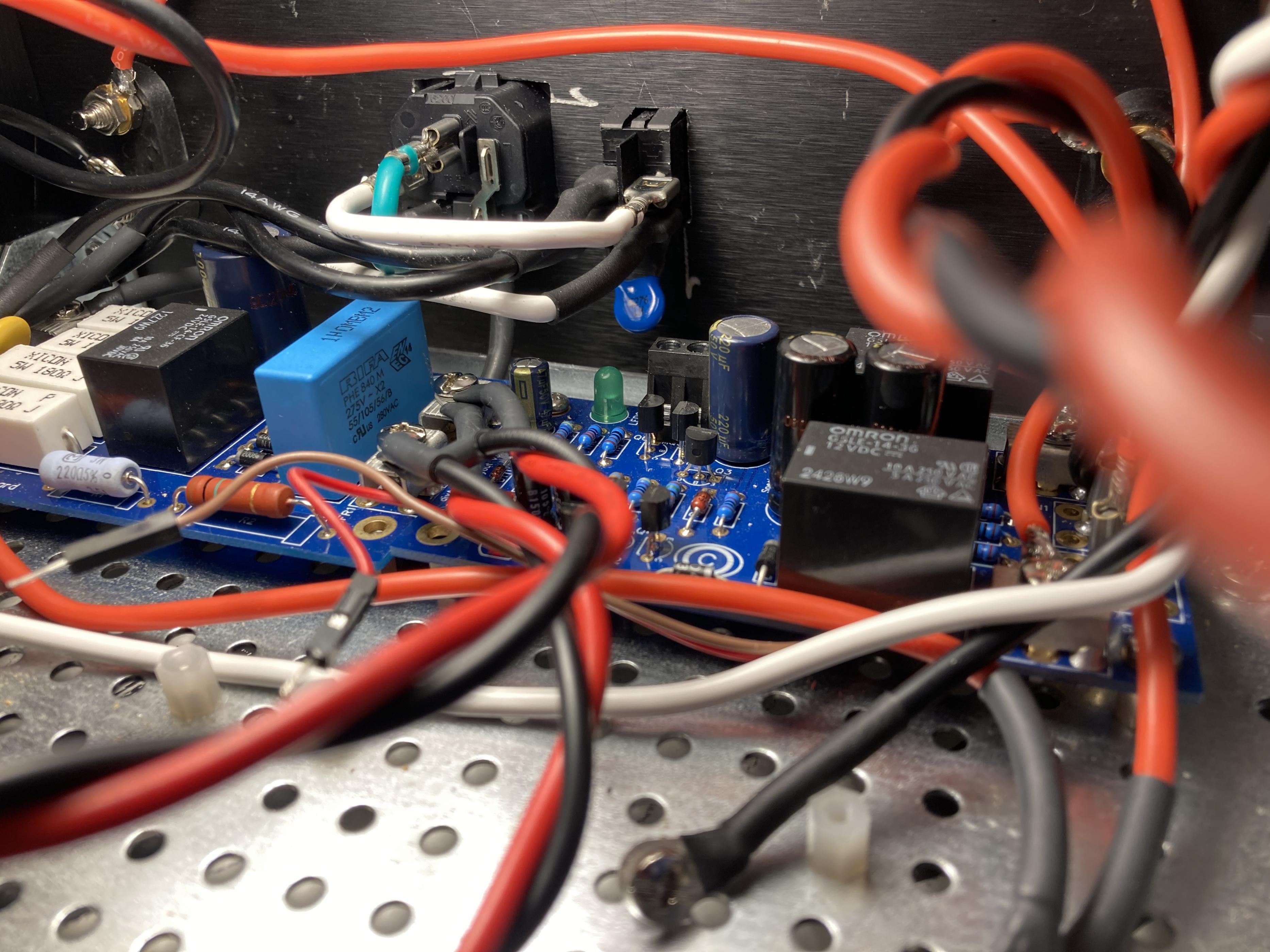

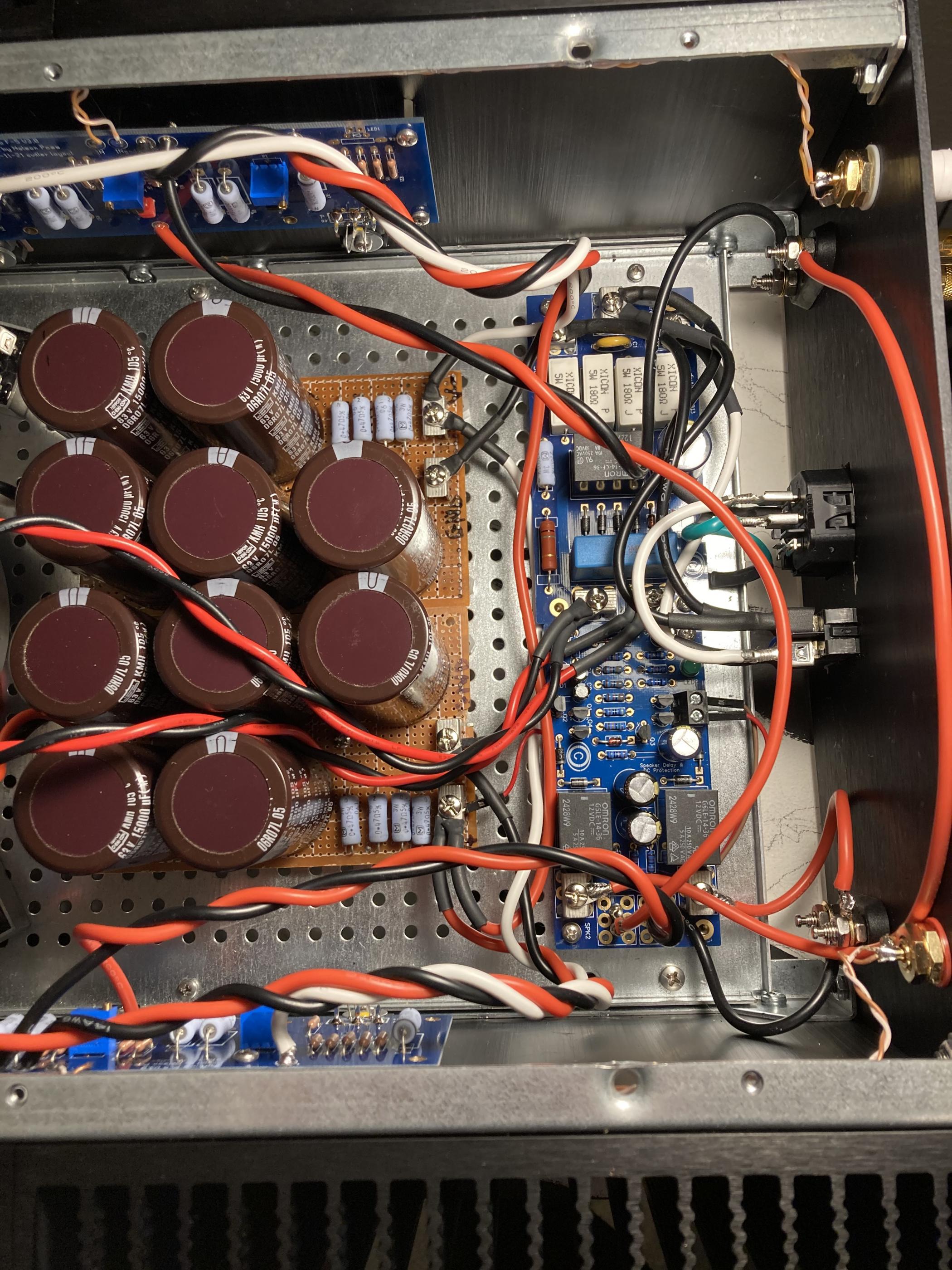

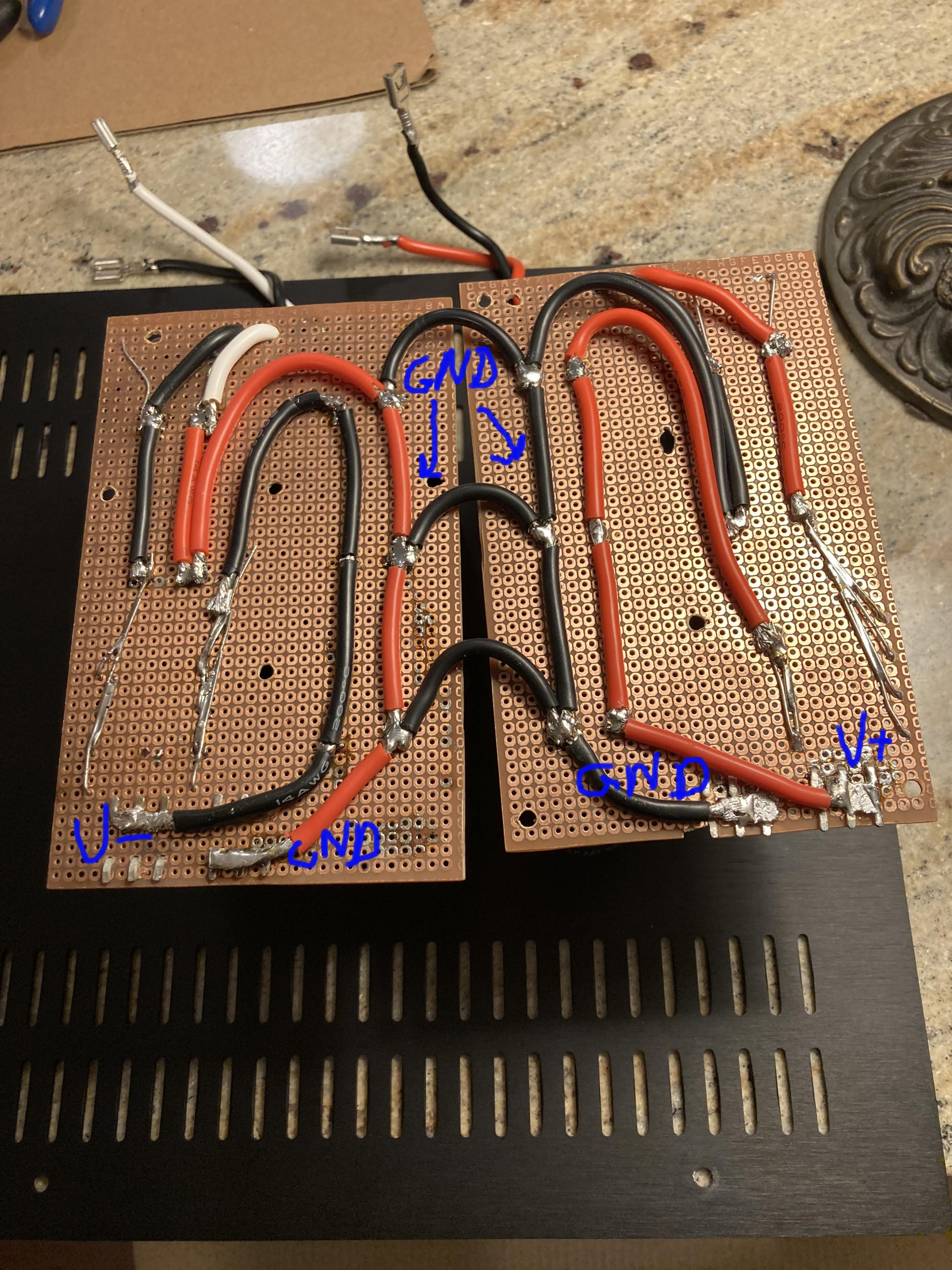

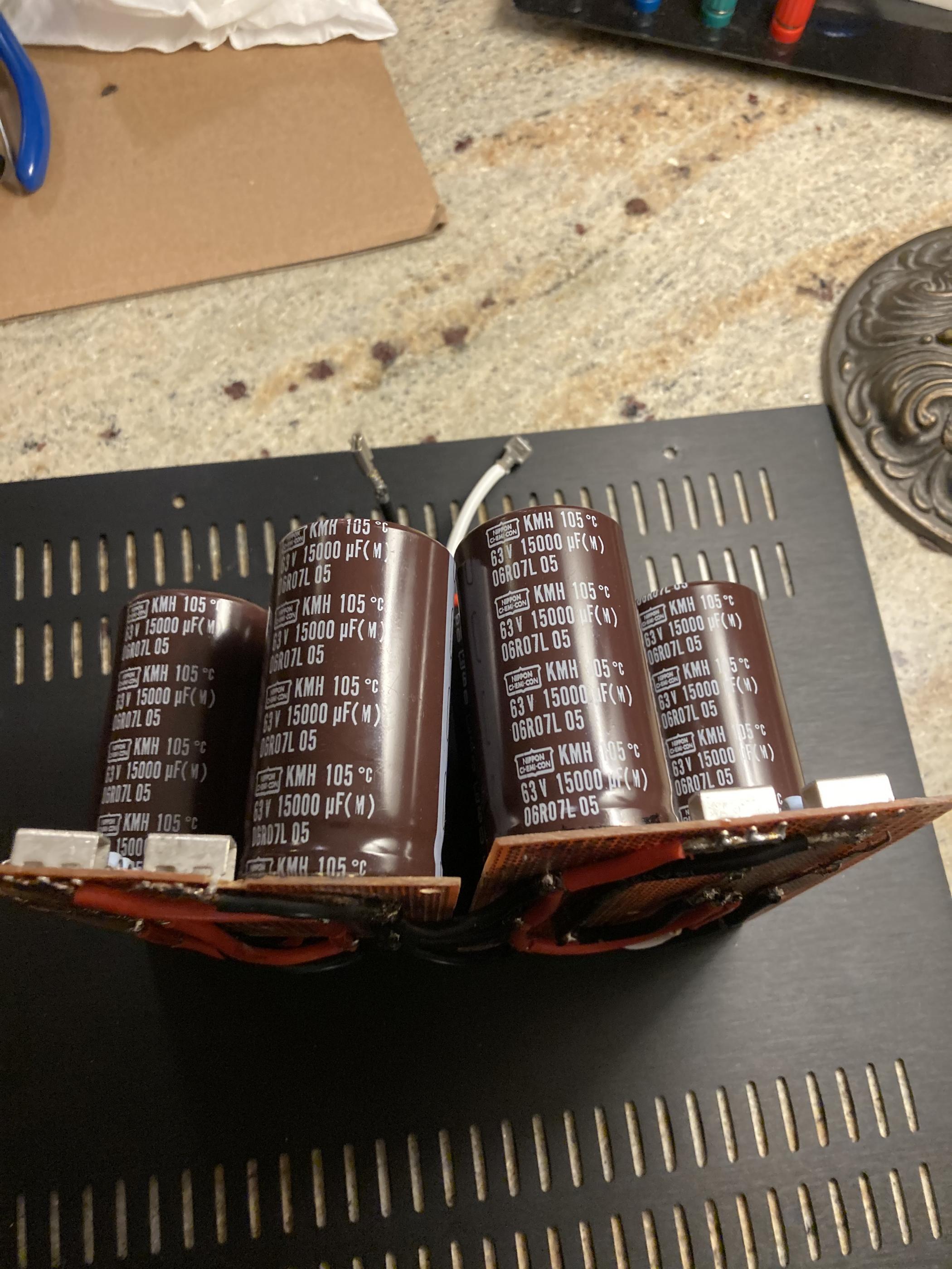

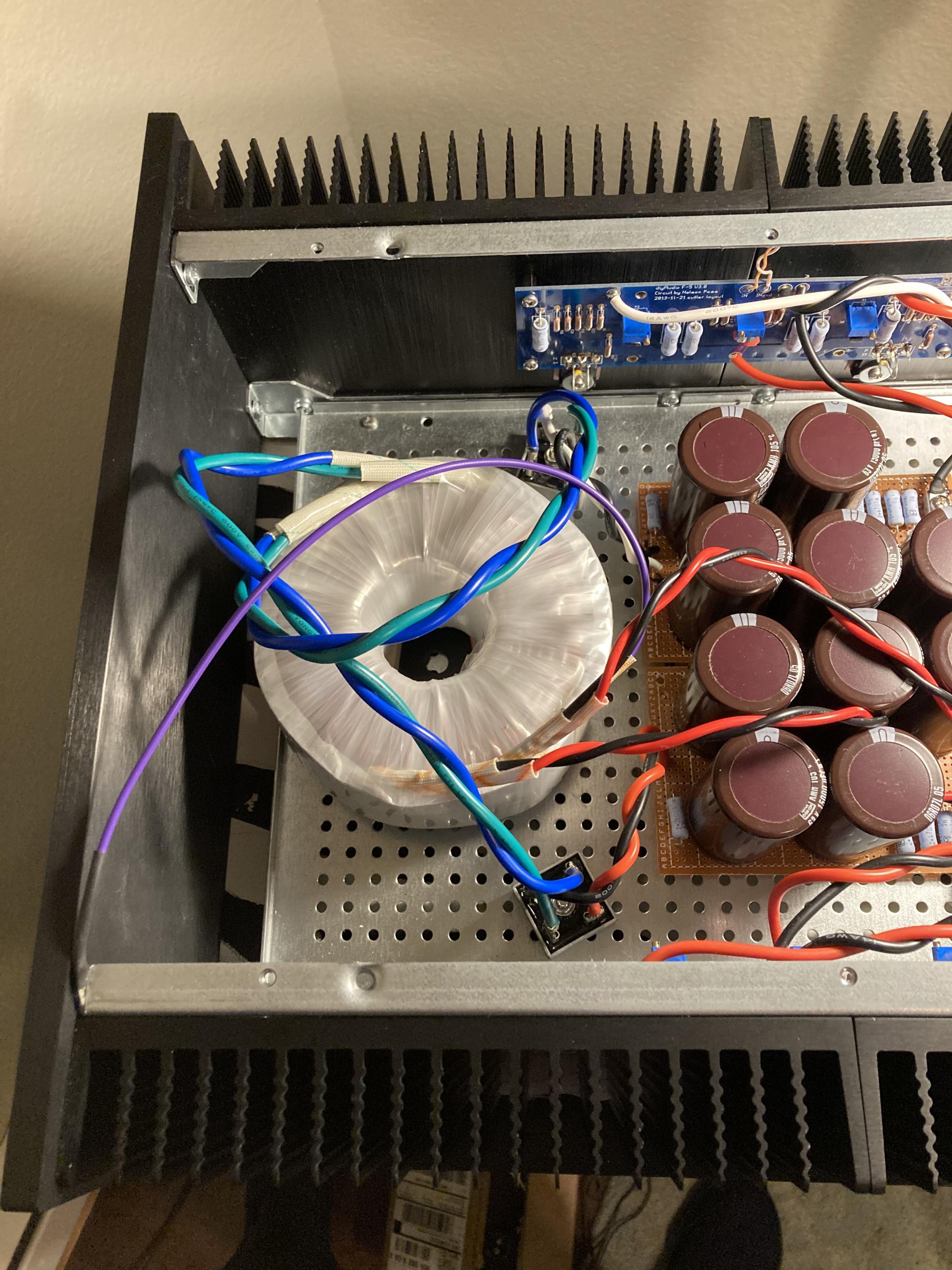

Transformer Humming F5
I finished my F5 build and it sounds great, except the transformer is humming (600VA antek). I feel like I have tried everything.
This 600VA hums when connected to mains and nothing connected to its secondaries. Thinking its a bad transfo and too large, I bought a new 300VA antek AS-3218 which doesn't hum with nothing connected to its secondaries. But when I wire it into the F5 amp, the 300VA transfo hums even louder than the previous one did. So loudly I can hear it with the lid on and it comes through the speakers woofer and tweeter from 5ft away.
Does this indicate a fault somewhere in my wiring/PSU?
PSU has 15000uF x 5 per rail arranged CCRCCC
PSU rails: +-22.7VDC
I verified mosfets are NOT shorted to chassis and RCA inputs and speaker terminals not shorted to chassis either.
Only power earth is connected to chassis. PSU ground is not connected to chassis. I tried connecting PSU ground to chassis through CL-60 but the hum is still there.
If I connected just one amp board to the PSU, the trafo hums less loudly. If I connect 2 lm1875 boards to the PSU instead of the F5 boards, there is no hum at all...
I built the mains DC blocking circuit from Rod Elliott Mains DC and Transformers but it hasn't helped.
I swapped out both bridge rectifiers, but no change.
I have attached a lot of pics of my PSU since that is probably where the issue is. The black wire on the underside of the V+ board is ground and the red wire of the V- board is ground. The grounds are joined in 3 places as shown.
You can find a video that shows the humming here:
Antek 300VA humming buzzing on F5 power amplifier - YouTube
I appreciate any help at all!
