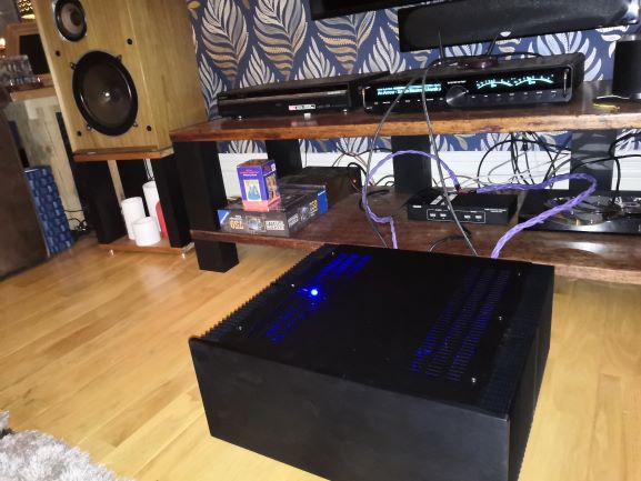

Well, after some decorating, building a new rack (both pictured) and Christmas, and getting hold of some Mosfets (with an M2X) I put everything back together without mishap this time and have had it on test - very pleased so far but there is a miniscule amount of hum I need to track down. Thanks for all your help! 😀

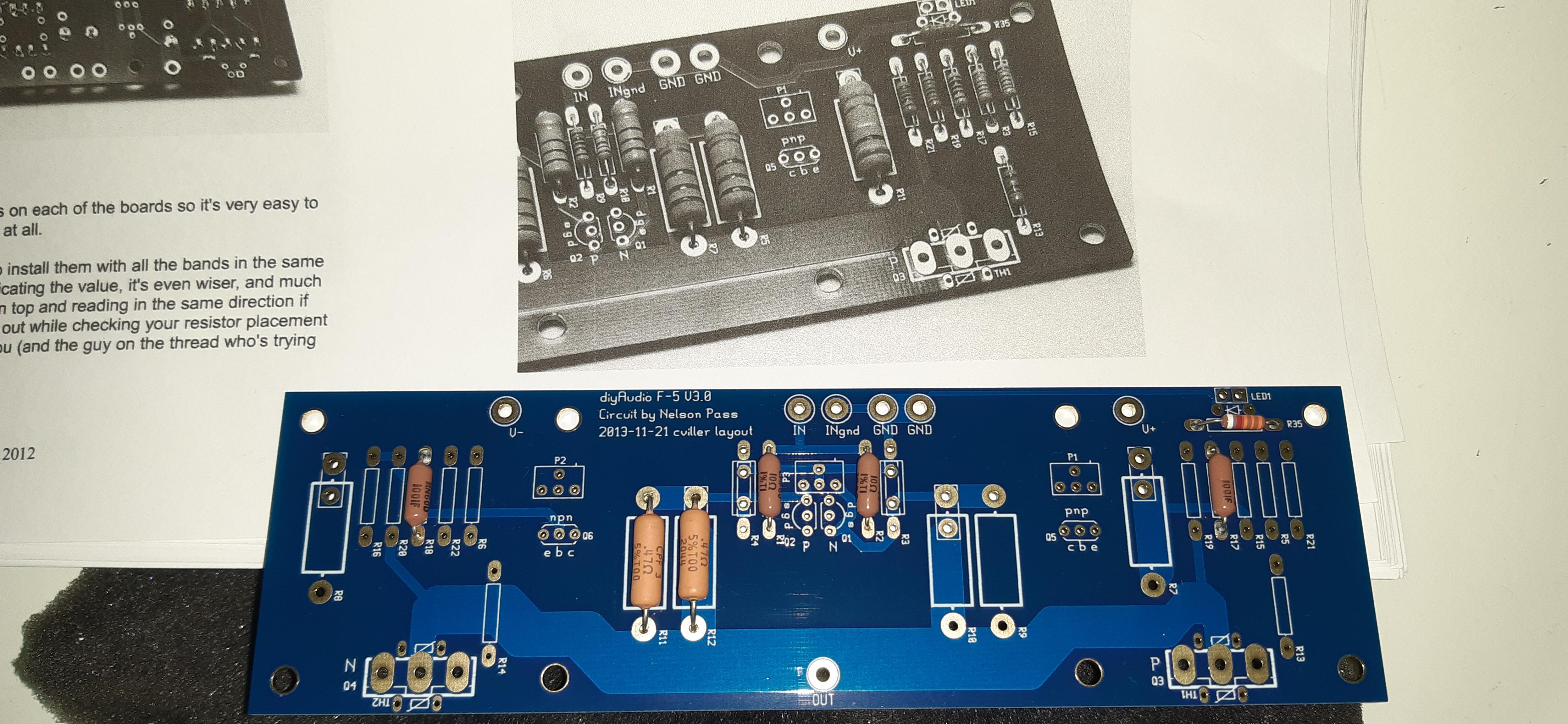

Hello all!!
After build Aleph J I can't stop... and now I'm building the F5, but I found differences between F5 V3.0 version pcb with pdf building guide. According the differences, I have to respect resistor values of the pdf though aren't same "R number" un pcb really ?? Because I see the schema are the same only added the P3....
