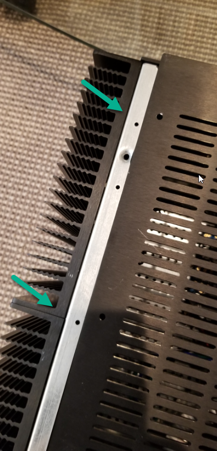

I've really been enjoying my new F5. Sounds great. I still get a thrill each time I turn it on and the blue lights glow.
I decided it was time to close up the case on the bottom and top. But I've discovered that the holes I thought I'd use are not threaded. So not sure how to proceed. It is the 5U case.
I'm working with a 4U case and the same holes are threaded, so not I'm confused. Did i just get unlucky and my rails were not done correctly?
See photo.
