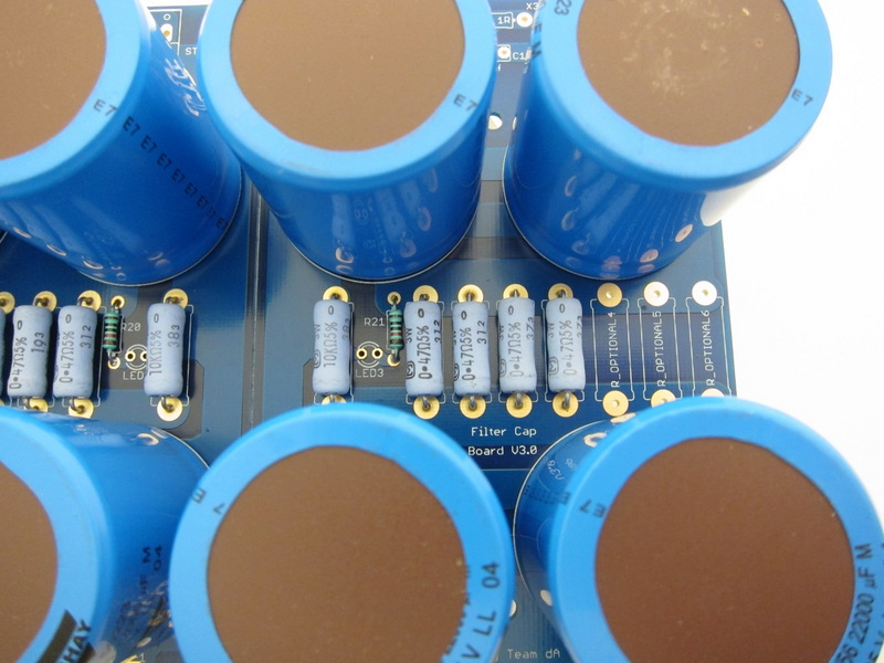

I'd like to know if the resistor I ordered for R21 is correct and the LED. It looks like I ordered a 10K 1/4w MINI (somehow a mini). The LED I got is a 2V 10ma.
Will that work?
If you can answer the bigger question - How do you figure out the optimal resistor value so it's something I can calculate on my own moving forward? I think I can use ohm's law to calculate the value if I knew the volts and amps going into the resistor.
There is a resistor and an LED on the left / right channel board that I need to populate also and would like to try to figure it out rather than ask. Now that I think of it, I might have ordered the 10k resistor for this and not the PSU.

Hi Kevin,
Your 10K resistor will work for your LED.
Resistor for LED >> Resistor Guide
The resistor is to limit the current to the LED so it's not too bright/blow up, etc.
Your LED is 2V 10mA so expect the LED voltage drop to be about 2V.
In your standard FW power supply, each rail is at say about 25V. So if you
drop 2 volts across the LED, you're left with about 23V.
How 23V across your 10K resistor means 2.3mA, so that's the current going
through your LED. The exact current isn't important so long as it's too
too high to damage the LED or too bright to annoy you. (And 2.3mA is
certainly lower than 10mA so it's safe.)
Now the resistor power rating: You have 23V across the resistor. From Ohm's
law, P=VI = 23V x 2.3 mA < 0.06W < 0.25W. So you have good
safety margin there. (You don't want to run a resistor close to its power rating.)
Hope this helps.
Dennis

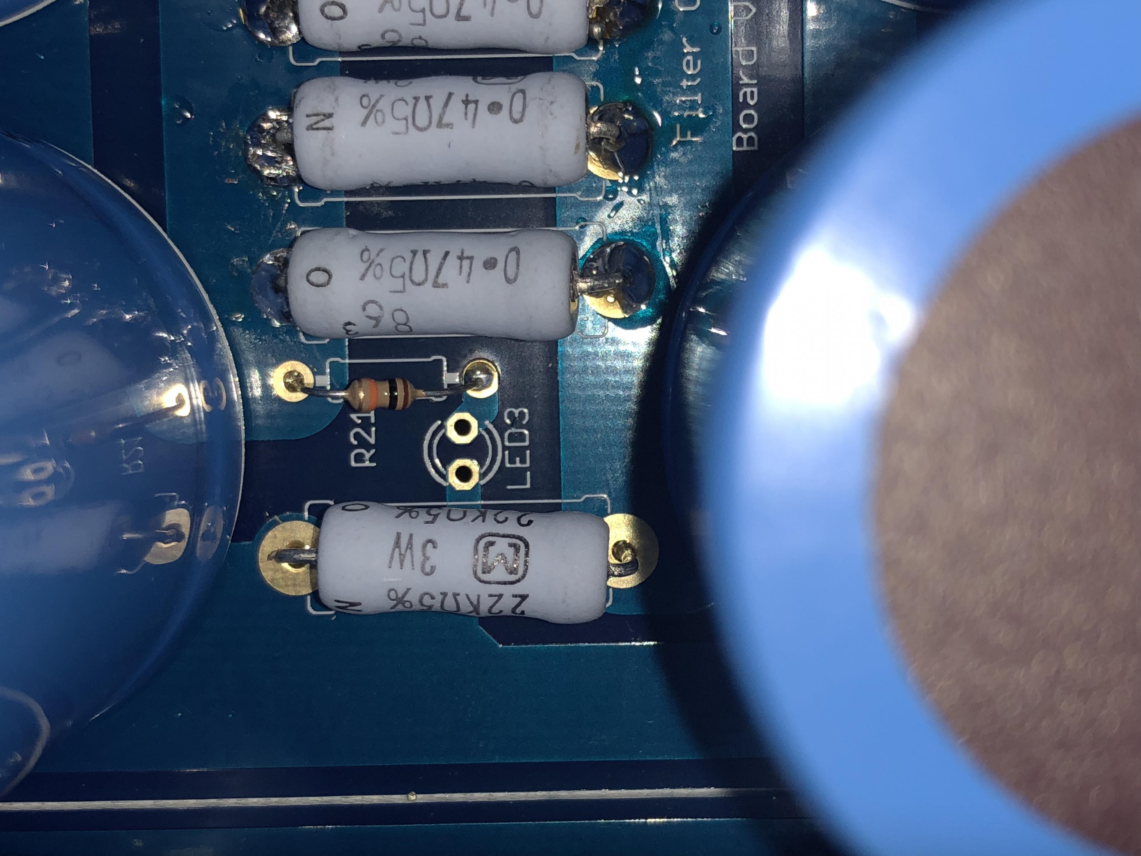

How can I tell which side is positive or negative for the LED on the PCB?
On the other few things I’ve built, I’ve seen a square or circle around each hole indicating polarity, a flat mark on the circle, or even + or - signs. This one does not seem to show anything remarkable.
Im guessing it’s just common sense that the current flow is going from one side to the other....

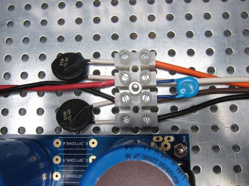

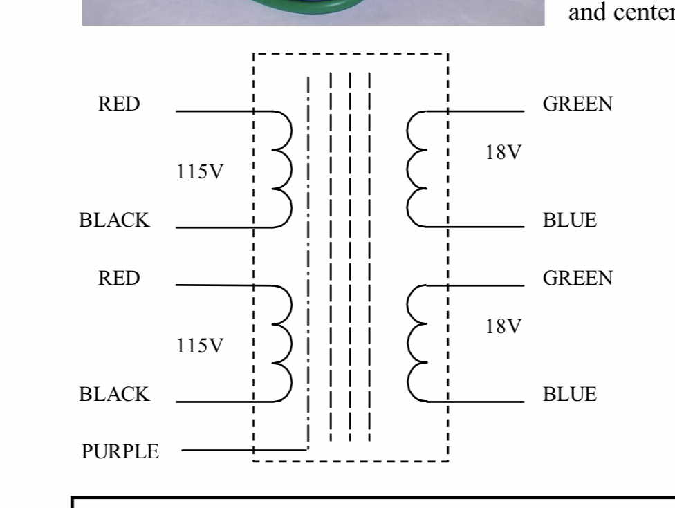

Made lots of progress building up the boards, the PSU and the case. But I have the next challenge.
Attached is the photo from the build guide. The second photo is the diagram from my transformer, the Antek 4218.
The primaries are in Red / Black pairs. I’ve tested them to verify which are the pairs. The first pair I’ll call Red 1 / Black 2 - second pair is Red 3 / Black 4.
From the build guide photo - if I knew which colors where paired with each other, I could wire mine to match, but I do not.
Is it as simple as inserting my named wires into the terminal block, from top to bottom, 1 - 2 - 3 - 4 ?
Thanks again !
