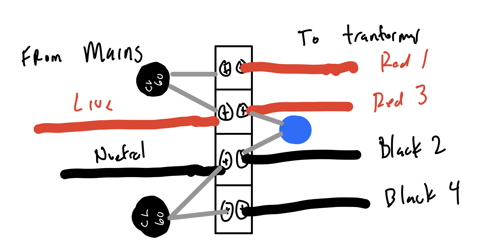

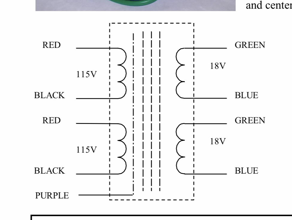

Ok I’ve spent some more time reviewing the original posts, the build guide and another website and think I understand the transformer wiring (hopefully).
I drew out this diagram for myself. Is this correct for 120v wiring?
If red1/black2 and red3/black4 are the pairs of primaries then it looks correct.
- First primary in series with cl60 through red1
-Second primary in series with cl60 through black4
- Cap across live and neutral
Looks fine to me.
Looks fine to me.
Thank you! Here is the trans diagram just in case.

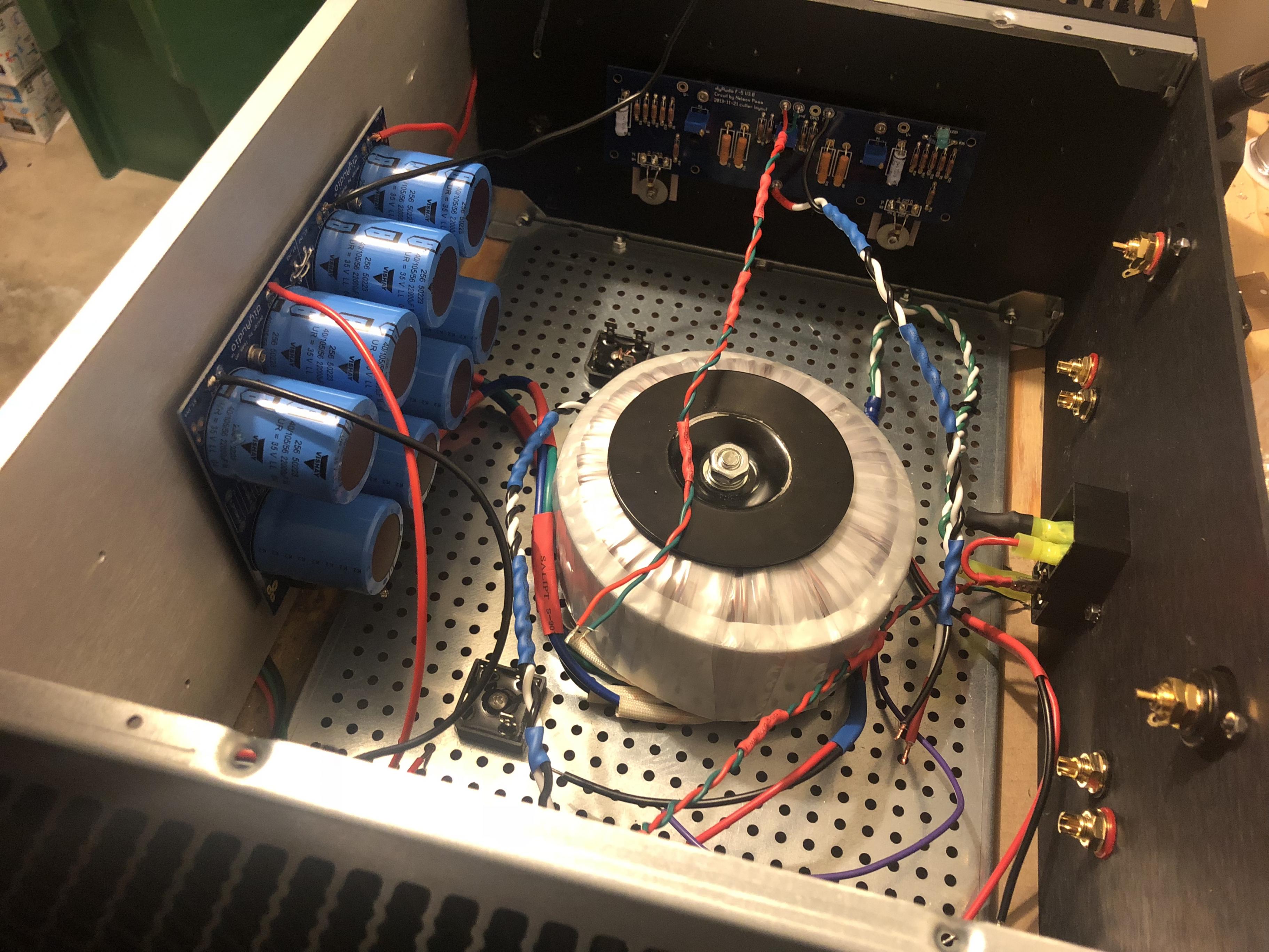

I just got the terminal block in the mail and should be able to finish soon. Here is what it’s looking like right now.
I noticed the aluminum faceplate has tapped holes perfect for the PSU board. However I don’t see other build pictures mounting the PSU like this so hopefully it’s ok. It’s pretty tight if I try putting the transformer, the PSU, terminal block and diodes all on the bottom so mounting it frees up some room.

The store pics for the deluxe chassis does show a setup with the PS board mounted
on the front. (You can see it here, but without caps)
Deluxe 4U Aluminum – diyAudio Store
It's a tight fit, so please make sure you trim the wires and leads well enough
so nothing touches the front plate. (How long are the standoffs?)
Dennis
Dennis
Yes, it works fine, I helped a friend build a BA-3 and we needed the room, so mounting the PSU on the front worked beautifully. 😀
I think you are bypassing the CL60's in your drawing.
Should look like this if you use a conventional barrier strip.

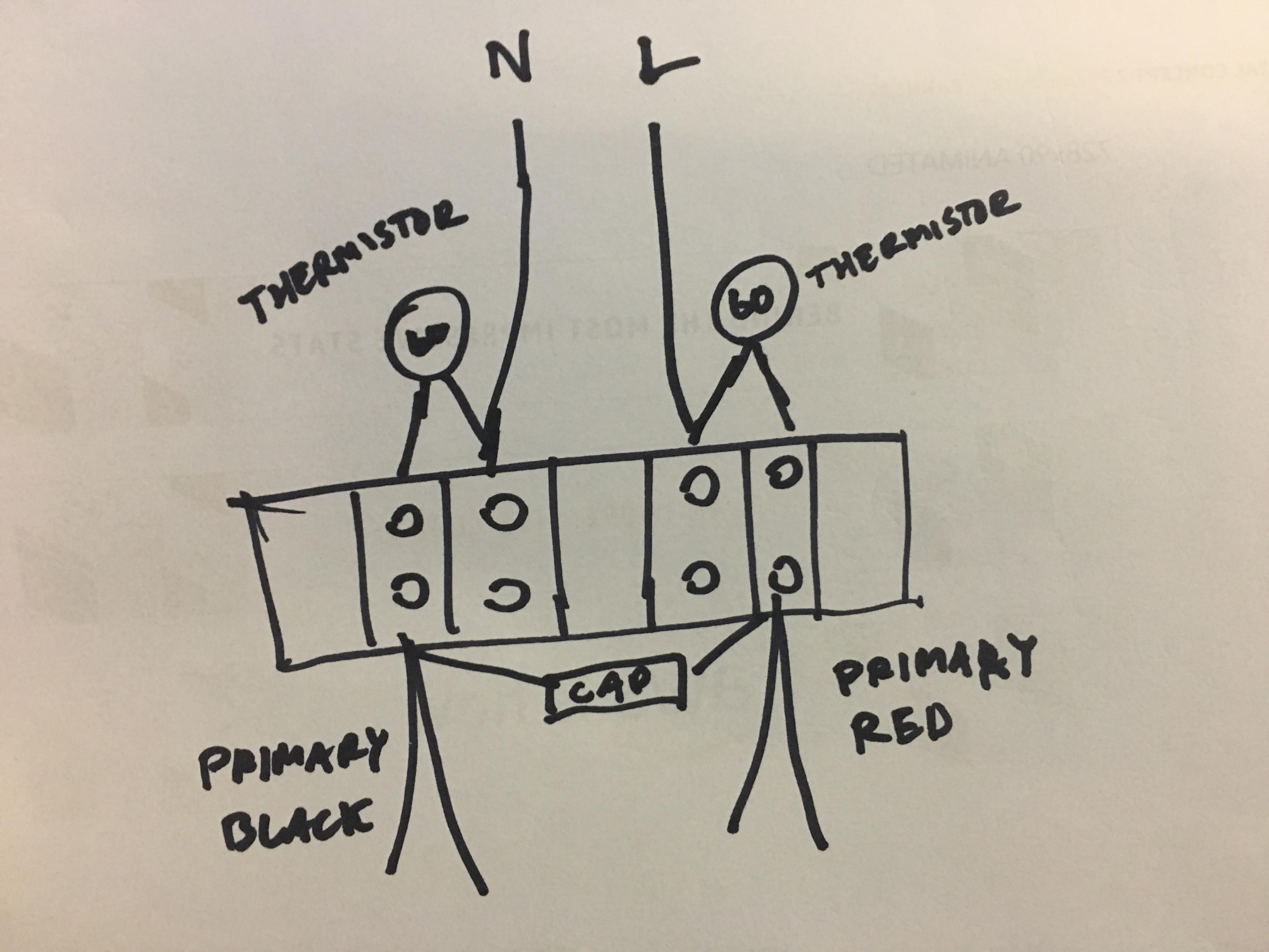

Nope.
Cap needs to be across the Live and Neutral, not downstream of the thermistors as you have shown here.
Also, as drawn, you have both thermistors in series with both primaries, not one thermistor in series per primary as it's supposed to be.
I can't begin to say how much I wish Antek used 8 different colors on their transformers, there would be no confusion...
I think it actually will work both ways, now that I look at it. I agree the cap may need to be before thermistor although Iam not sure why it would matter.
Yes, it would work. And quite likely safely. But it's not what's drawn the schematic, and when dealing with AC, I'm going to default to doing exactly as it's designed. 😀

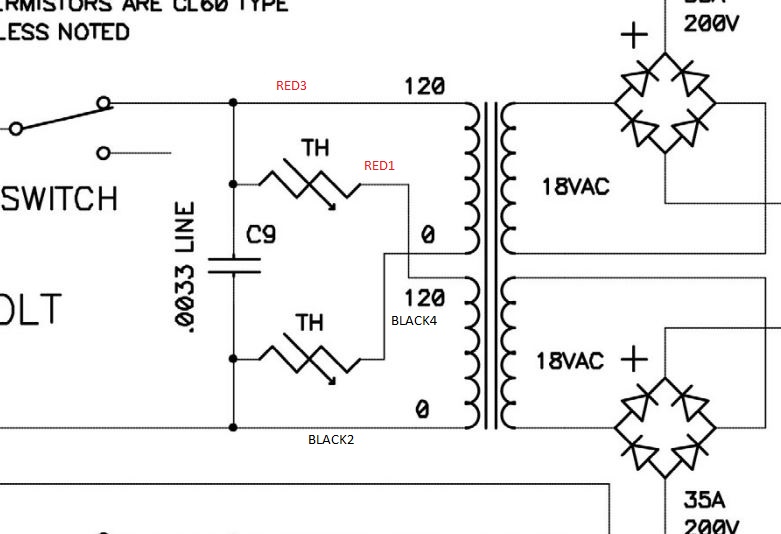

On that note, four questions:
- What's the purpose of C9 as shown on the PSU schematic?
- What's the spec for C9?
- I can make out that the capacitance is 3300 µF but why is this the right value for a 120 VAC primary (possibly answered by resolution of Q1)?
- What should the capacitance of C9 be for a 240 VAC primary?
If I refer to relevant documentation from First Watt, such as:
http://www.firstwatt.com/pdf/prod_f5_man.pdf
http://www.firstwatt.com/pdf/prod_f1_srv.pdf
... the purpose of C9 is not explained.
Rod Elliott, here offers an explanation for an equivalent (as far as I can make out) C9:
http://sound.whsites.net/power-supplies.htm#s14
... and provides this advice:
For a 240 VAC primary, Rod Elliott suggest the following additional points:EMI is not usually a problem with a linear power supply, and most will pass the regulations used in all countries without any filtering...
... The first method is to use a mains rated (Class X2) capacitor in parallel with the transformer's primary ... - it must be an X2 mains cap.
- X2 caps are specifically designed for use across the mains
- the material of concstruction is usually (but not invariably) polypropylene
- a common voltage rating (for 240 VAC service) is 275V AC
- a capacitance of around 470nF is generally suitable.
Notably, the capacitance suggested for C9 in the First Watt documentation is about 7000 times greater than Rod Elliott's recommendation. I doubt that the difference in primary voltage will account for this.
What would be useful for me is to understand the purpose of C9, the guidance for specification beyond capacitance selection and the method used to determine its capacitance.
Thoughts and useful advice appreciated... 😎
