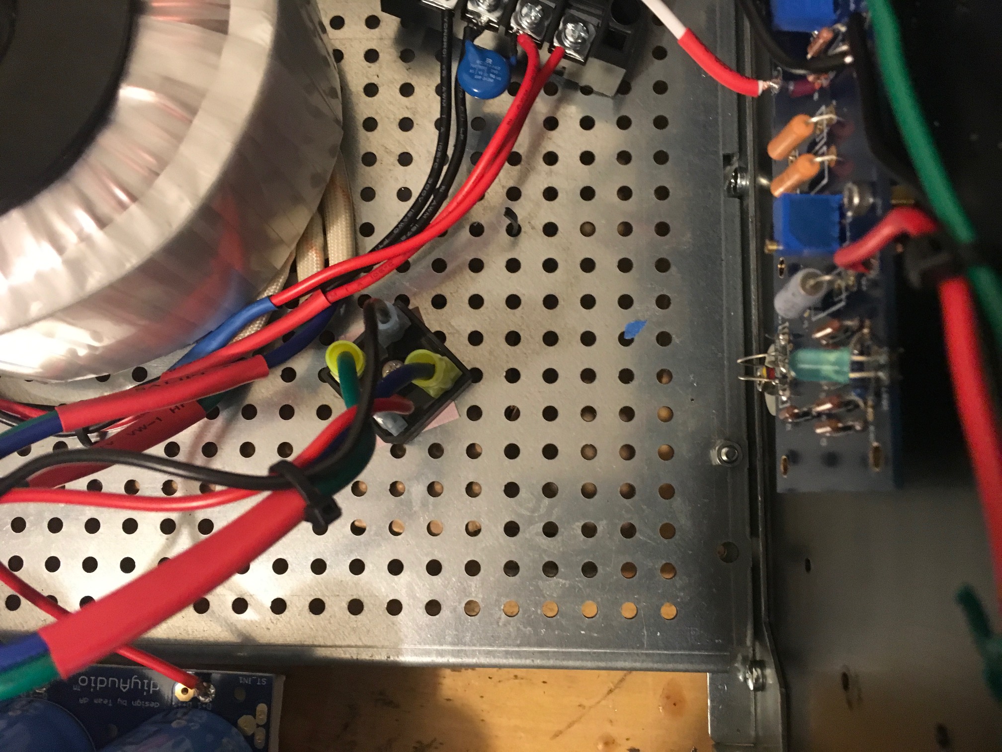

Well after finding some 3 amp 125v slow blow fuses, the PSU powers up for about a second or two before one fuse blows. When measuring the voltage out of the PSU at V+ and GND with my DMM per the manual instructions, it gets to about 5 volts out before the fuse blows. The LED lights light up but not very bright and the voltage slowly bleeds out.
I don't have either of the channels hooked up to the PSU so there is no load.

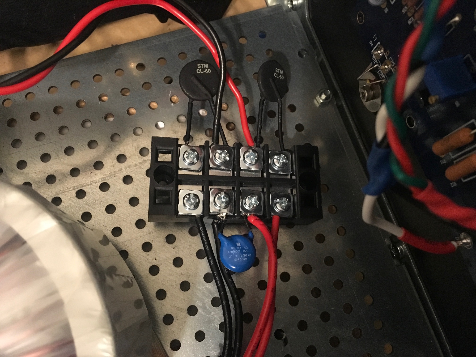

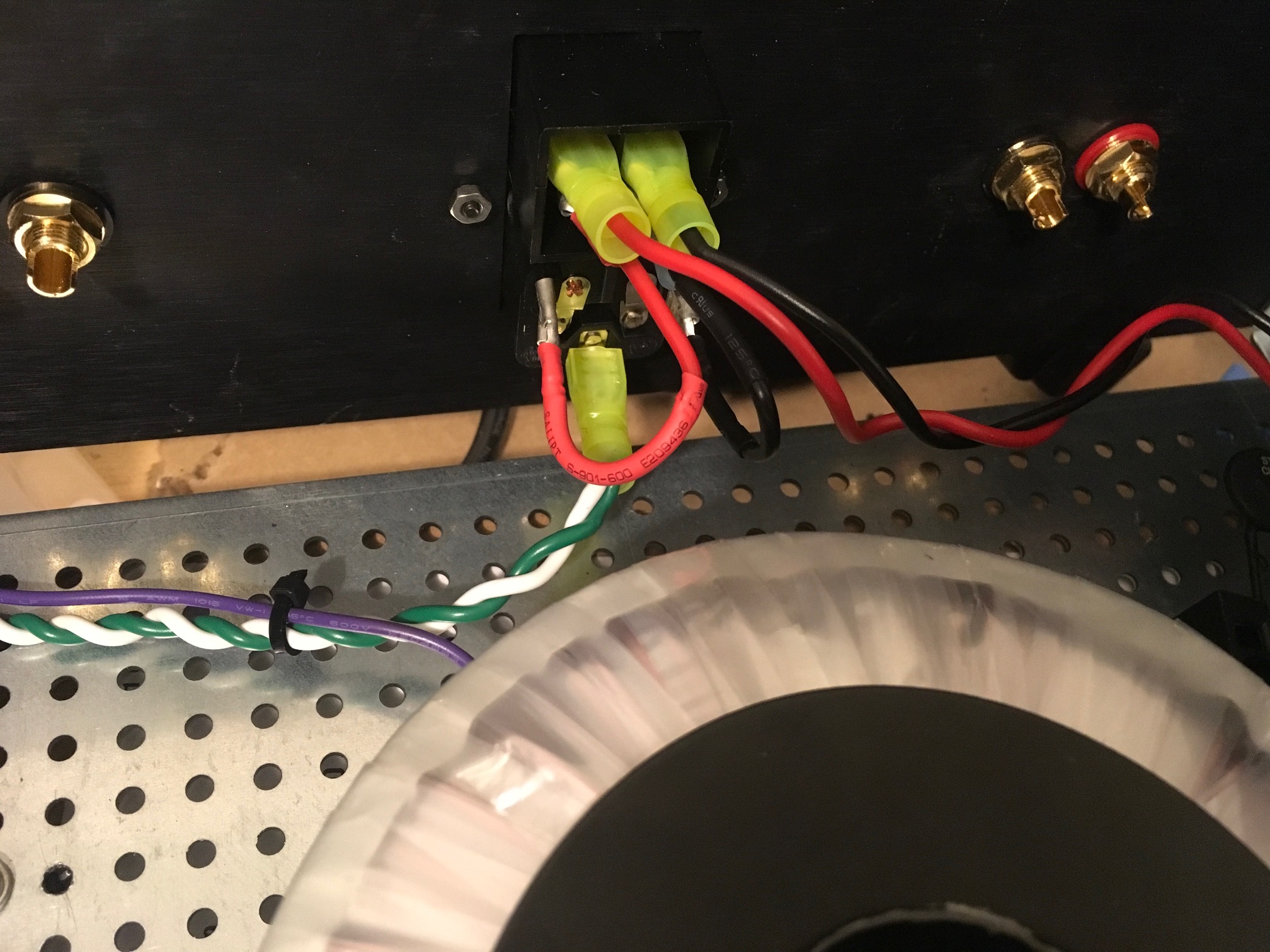

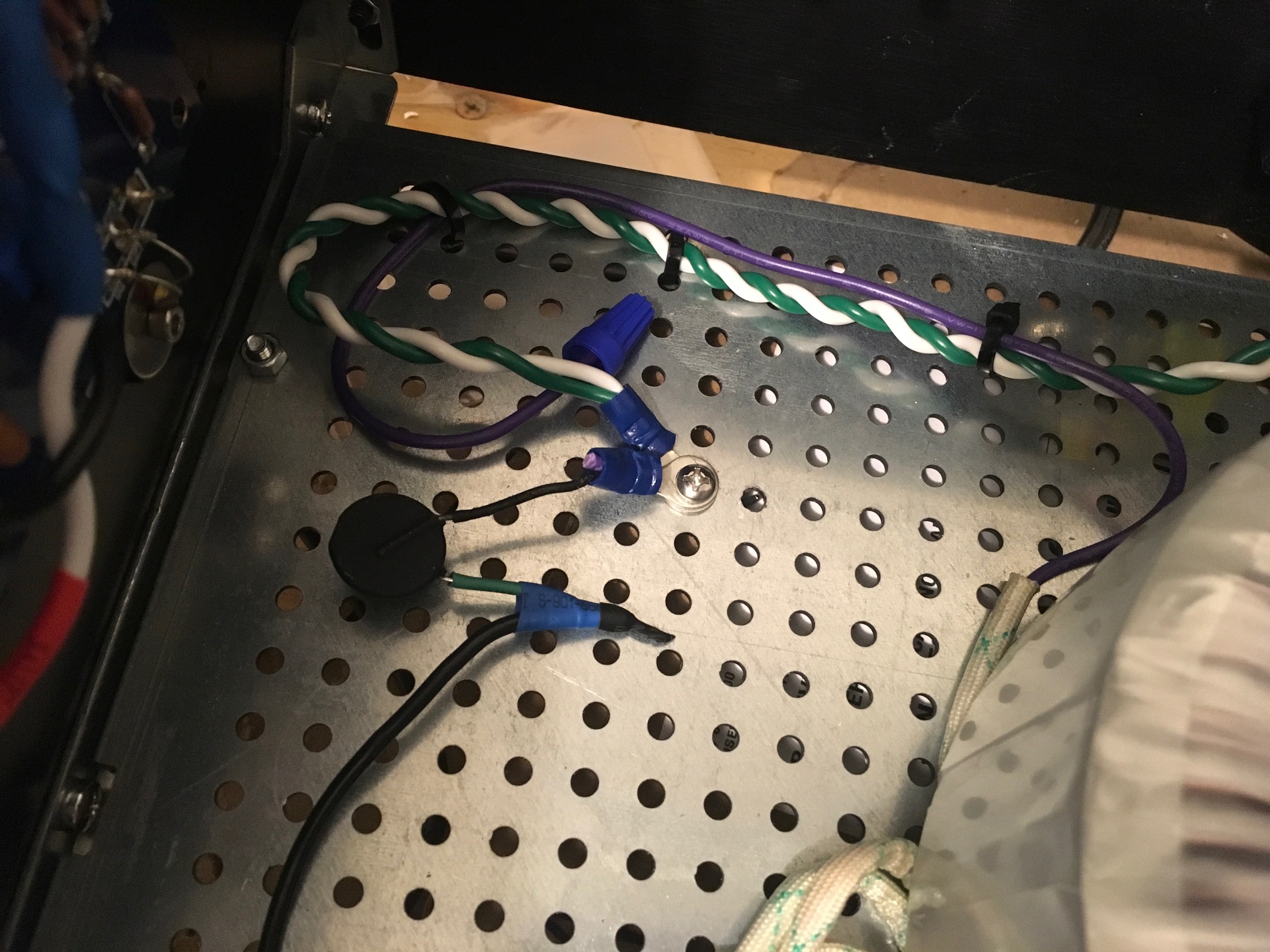

Here are some pics of everything on the way to the PSU.

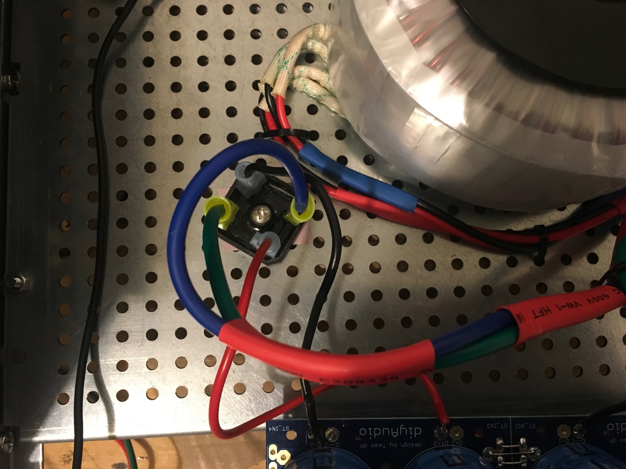

The only couple things I'm unsure about are the secondary wires into the rectifier blocks. The DC out are + and - but I wasn't totally sure if the blue / green wires were on the right ones or if it even mattered. The other was the purple wire from the transformer. The guide said to connect it to ground or cap it off. I tried both and the fuses still blew.
If this all looks good then perhaps it's something on the PSU.
I was feeling real good about powering it up today so I'm bummed it didn't work as planned.....

Your secondaries on the transformer may not be correctly wired.
There are two windings (secondaries) on the transformer. They create a "loop". You may have one secondary wire from one winding, and the other secondary wire from the other.
You can test for secondary "pairs" of wires with a meter. The green and blue wire that are a pair will have a lower resistance (not zero, but lower) than a mismatched pair. This is how you know which wires are a pair. Two wires that are not a pair will show a lot of resistance.
Rectifier blocks could be miswired as well but I can't see enough in the pics. On the blocks the corner with the little notch in it is positive. Also, you don't need the electrically isolate those rectifier blocks. They are isolated.
The purple wire is a electromagnetic shield for the transformer to prevent noise/interference. It is connected to foil shielding around the transformer. It has no effect other than that. You can hook it back up.

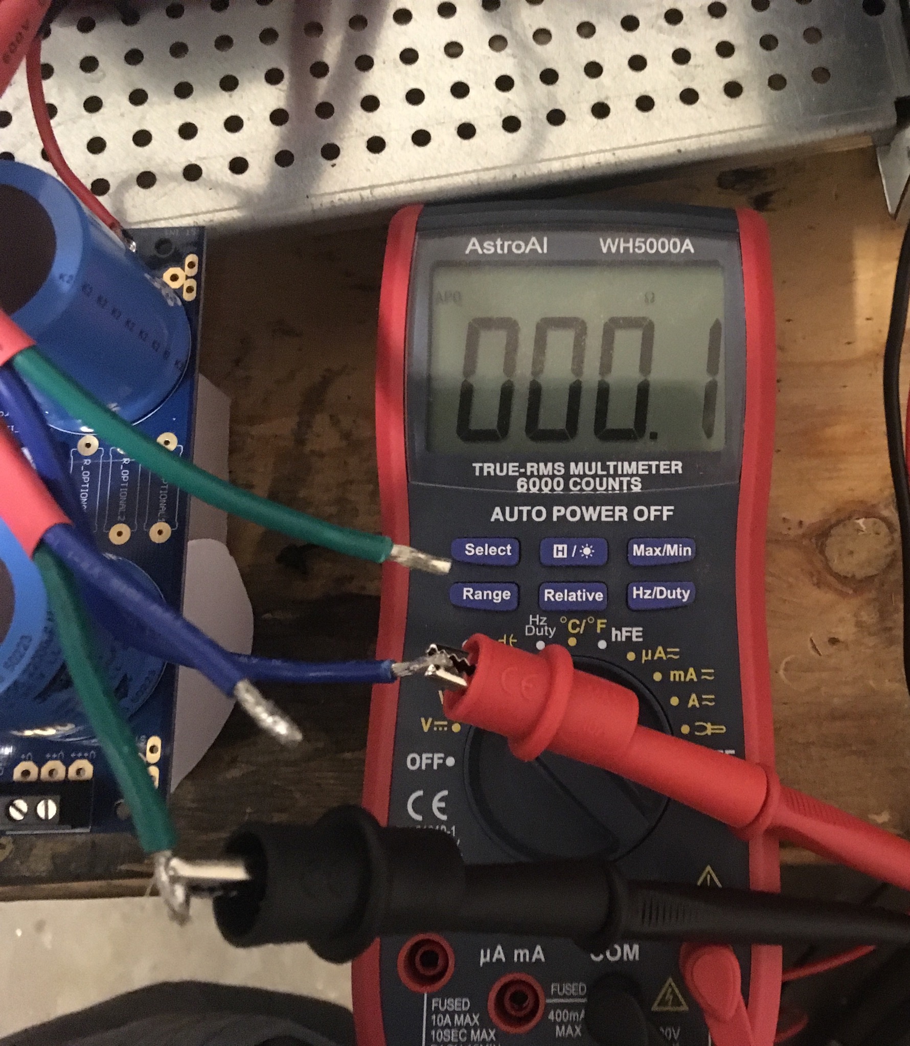

Thanks, I think this is what it might be. I retested the primaries to verify I’m using the correct pairs - they are correct. I tested the secondaries - my pairs show no resistance. When I try the wire from the other “pair” I get something barely more than zero.
So I’ll try switching them around and see if that works and report back.

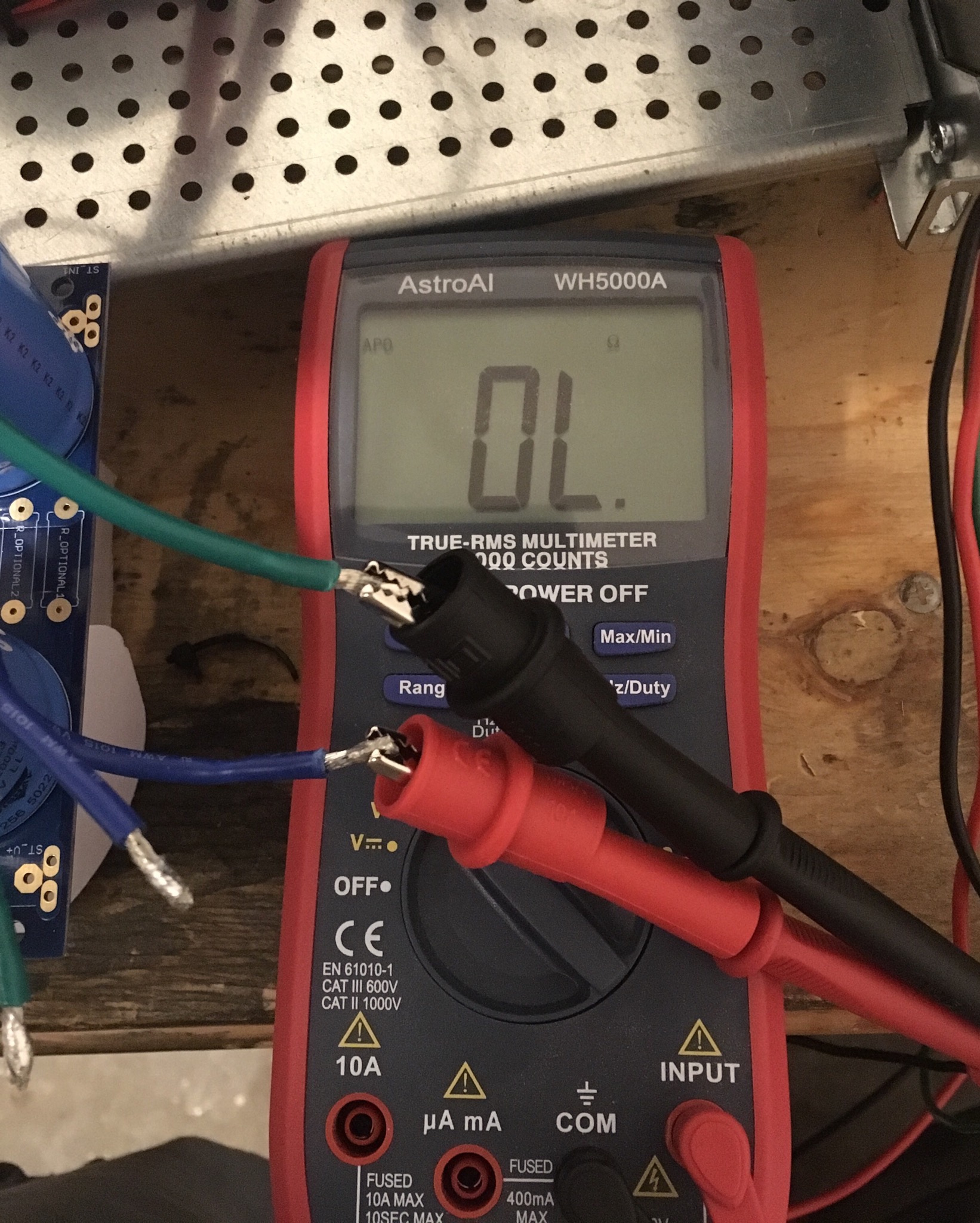

Actually none of my secondary pairs show lots of resistance. It’s either nothing or just barely more than nothing.
First pic is the original pair I put into one rectifier block.
Second pic is when I swap out the green wire.
Would the first picture be the pair or the second?

Mrshazbot - Select the "Beep" function for continuity. The secondary leads will beep if they are from the same pair.
Also PLEASE disconnect the amplifier boards from the PSU!! If the PSU isnt working, why do you want to risk your amp boards?

Thanks, the beep function says I was originally using the wrong pairs.
Thankfully, the only smart thing I might have done so far was to not connect the amps or else they would probably have been fried. I actually had a dream last night that I did fry them so my level of obsession on getting this working is probably approaching unhealthy.

IT WORKED!!!!!! The VDC out of the PSU was 24
