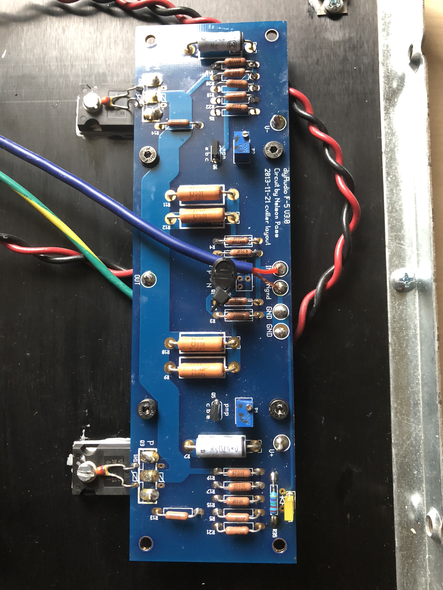

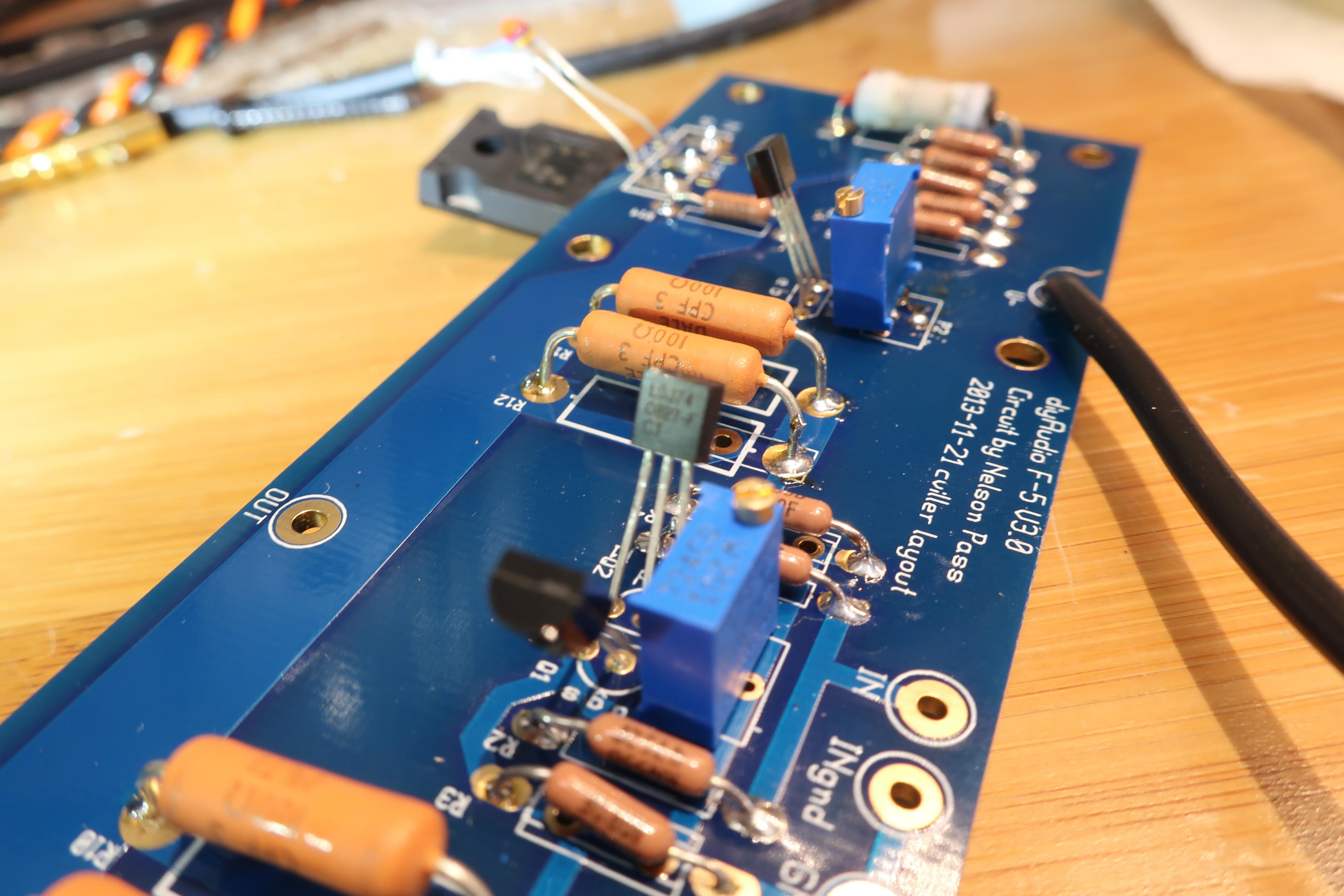

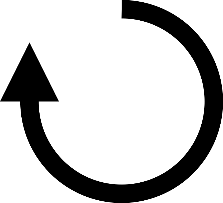

Hi still figuring out the ‘shorting problem’ in my f5build. So I replaced the MOS Fets. Isolated the rectifiers. Desoldered the output and still: when I connect my MM to the + of the output and ground there was a loud beep. Here a some pictures of my build. Sorry for the mess.
What’s the resistance in ohms between positive output and ground?
Possibly a mounting bolt on one of the pcbs shorting a trace to the chassis.
I do see a bolt head over a trace. The solder mask can be easily cut through.
Remove the bolts and recheck.

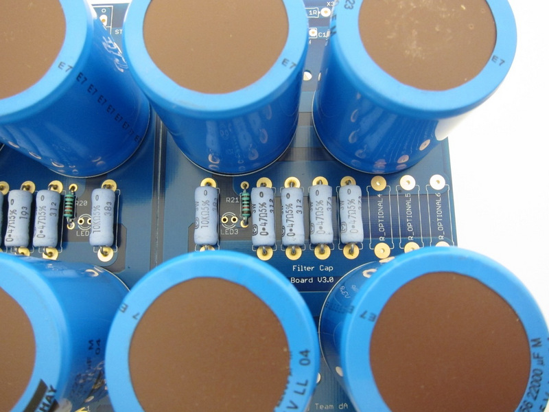

Hi. can someone please explain what is happening on the terminal block of the PSU. There are two STM CL-60 things and another blue thing in between. They're not listed on the BOM so what are they and where do I get. Also, does it matter which direction the ZTXs go, curved side yup or down? Very unclear. Thanks. I am a noob.
Take a look here for the orientation of the ztx transistors.
https://www.diyaudio.com/forums/the-diyaudio-store/227933-diyaudio-f5-build-guide-4.html#post5422076
Blue thingie is a line rated suppression cap, something like this:

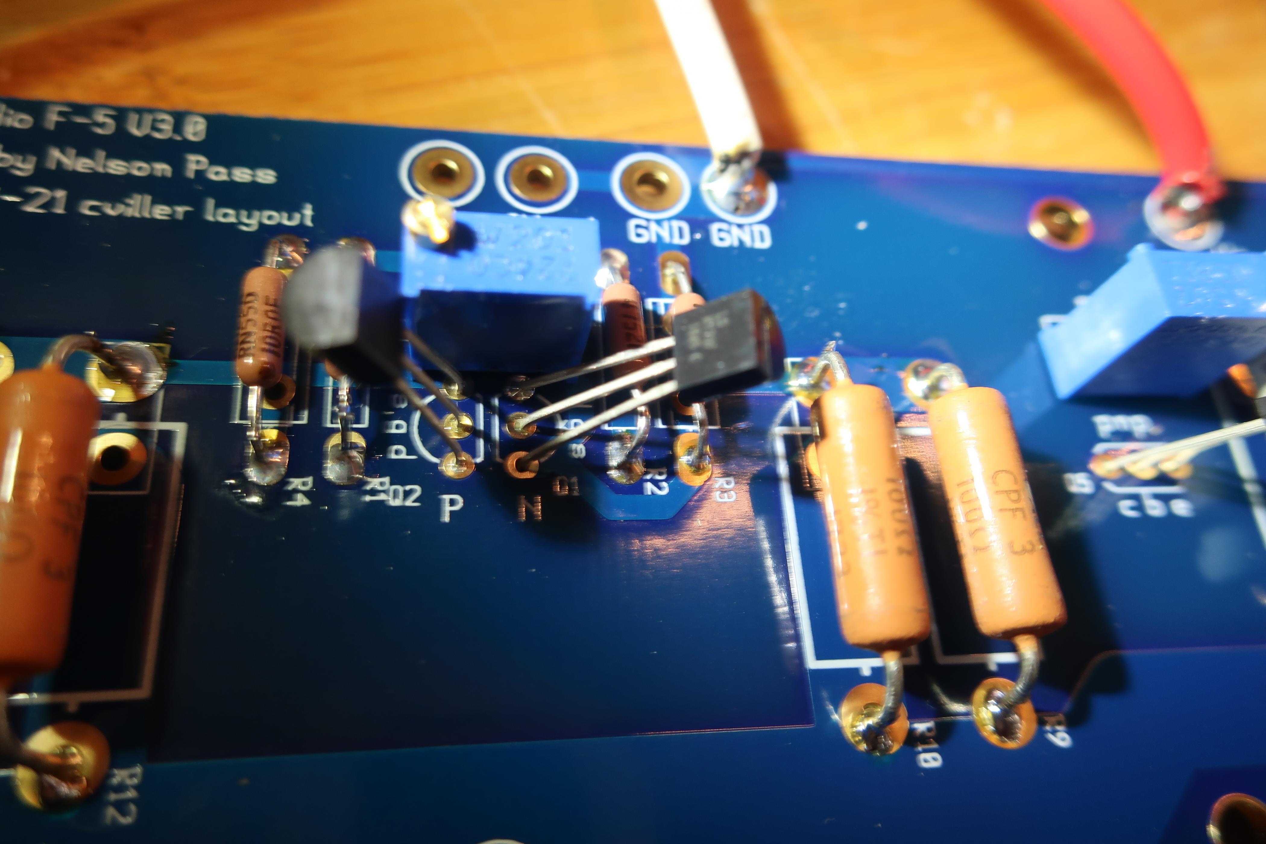

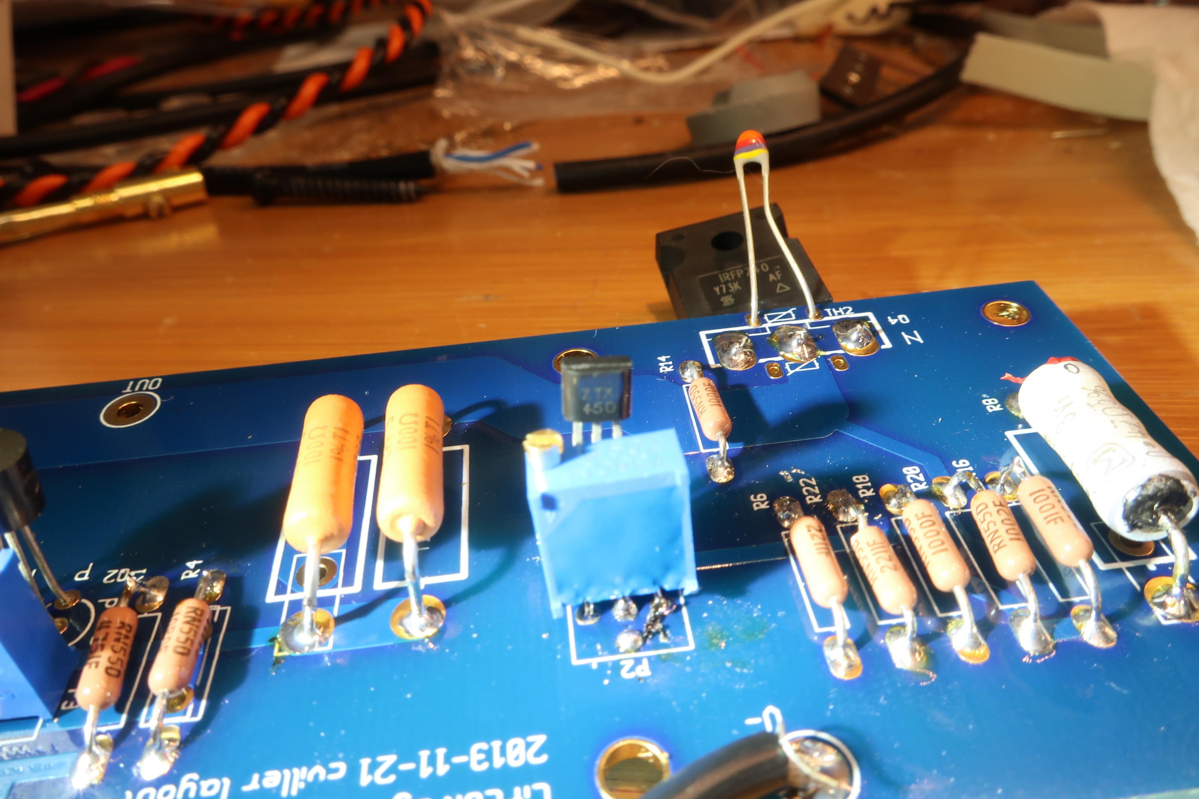

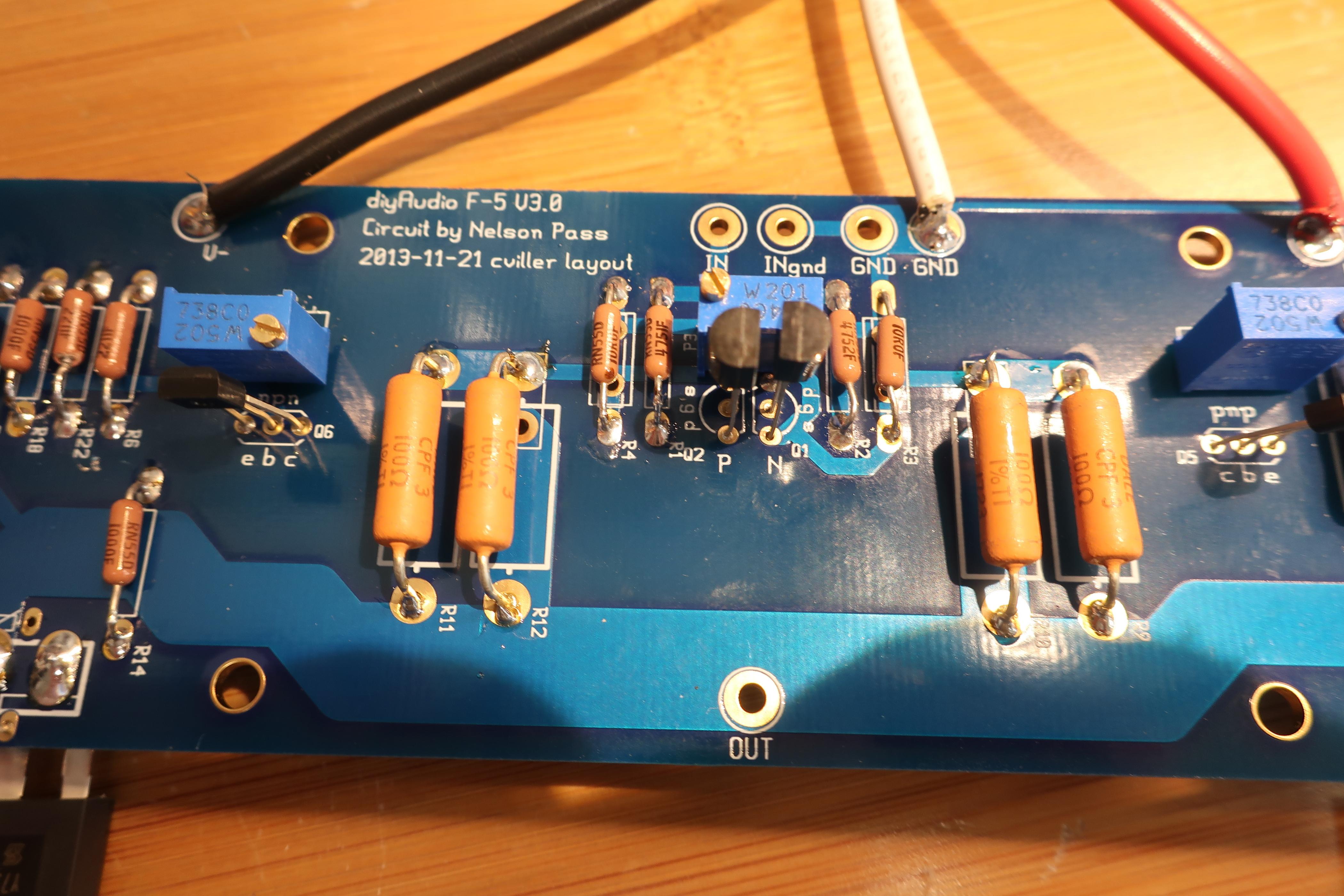

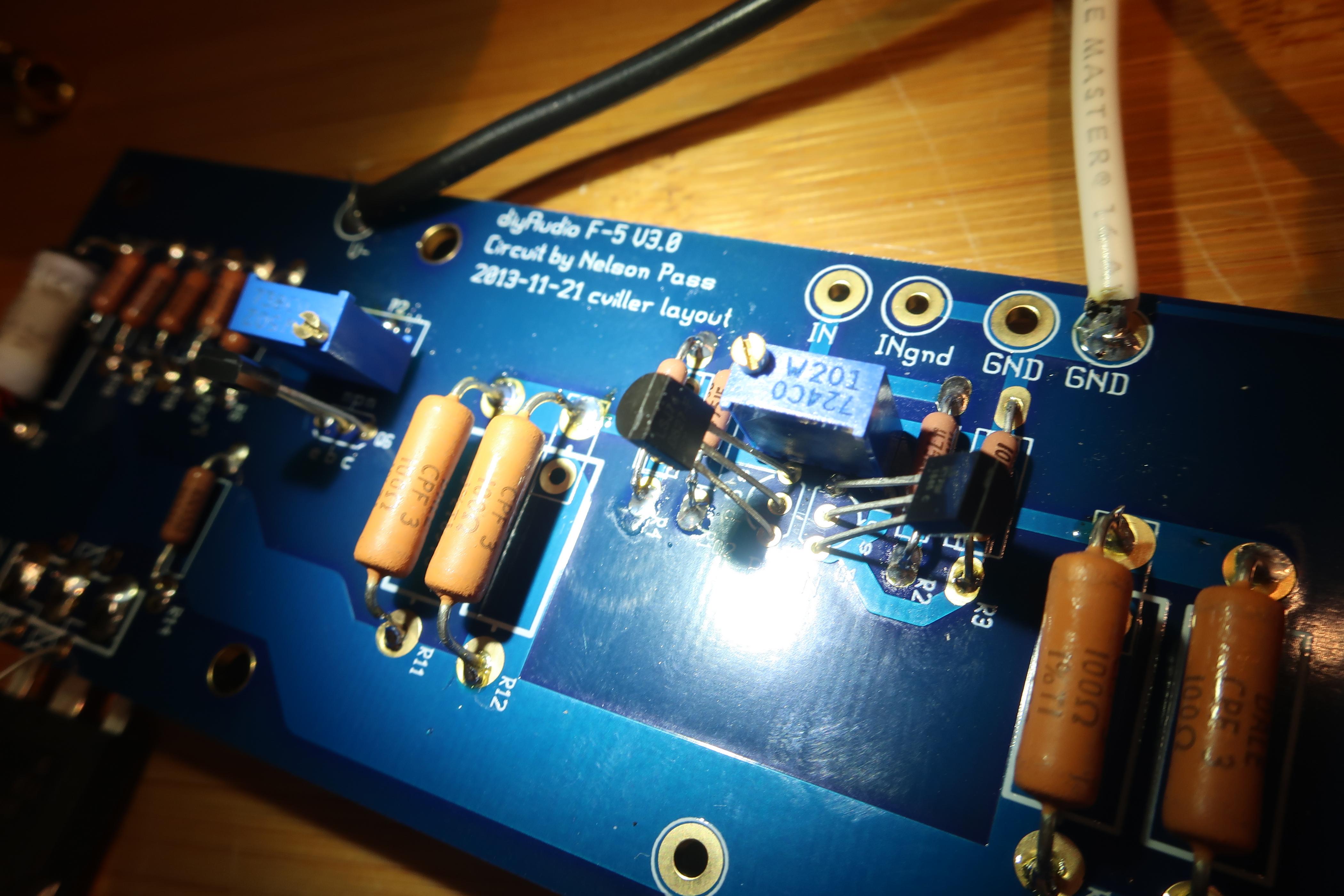

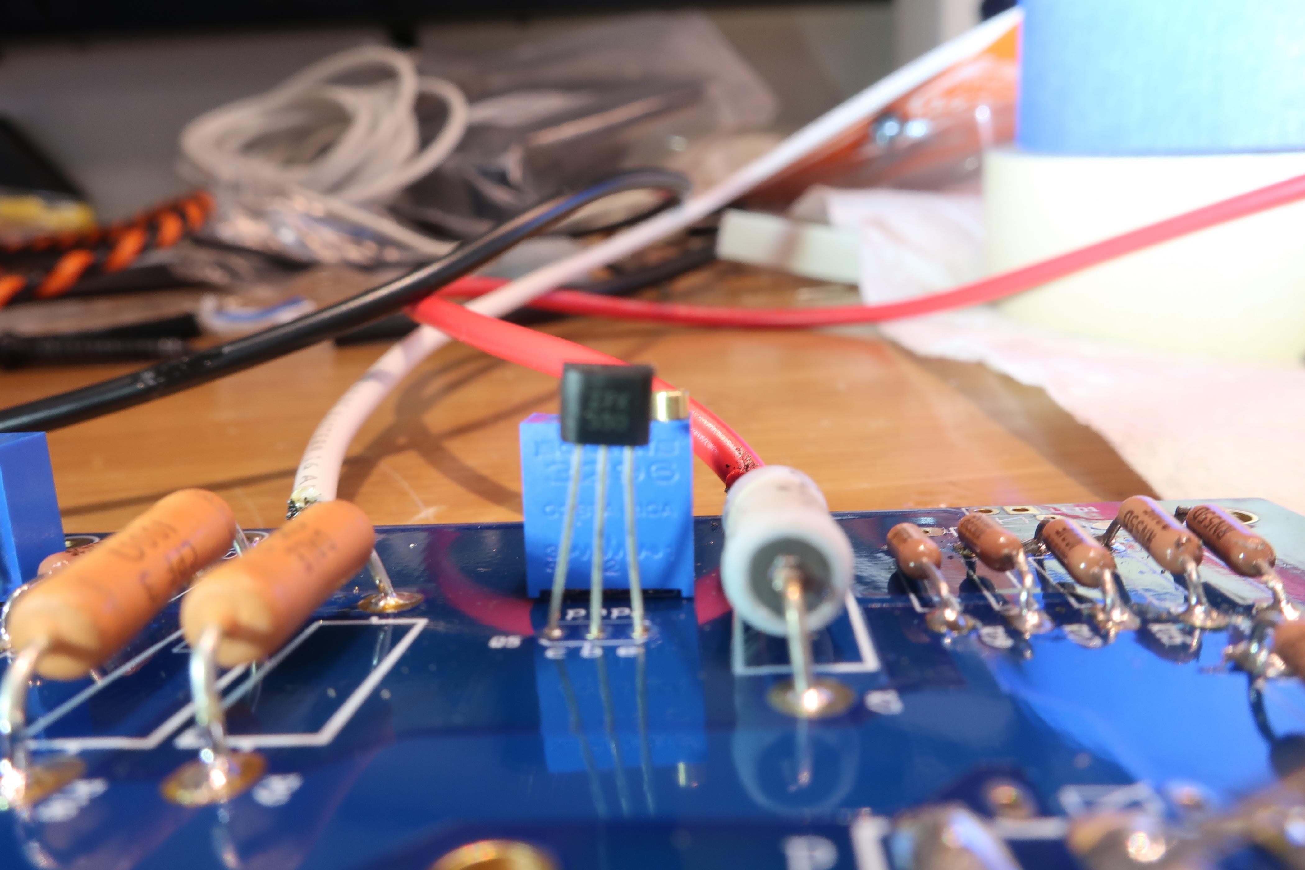

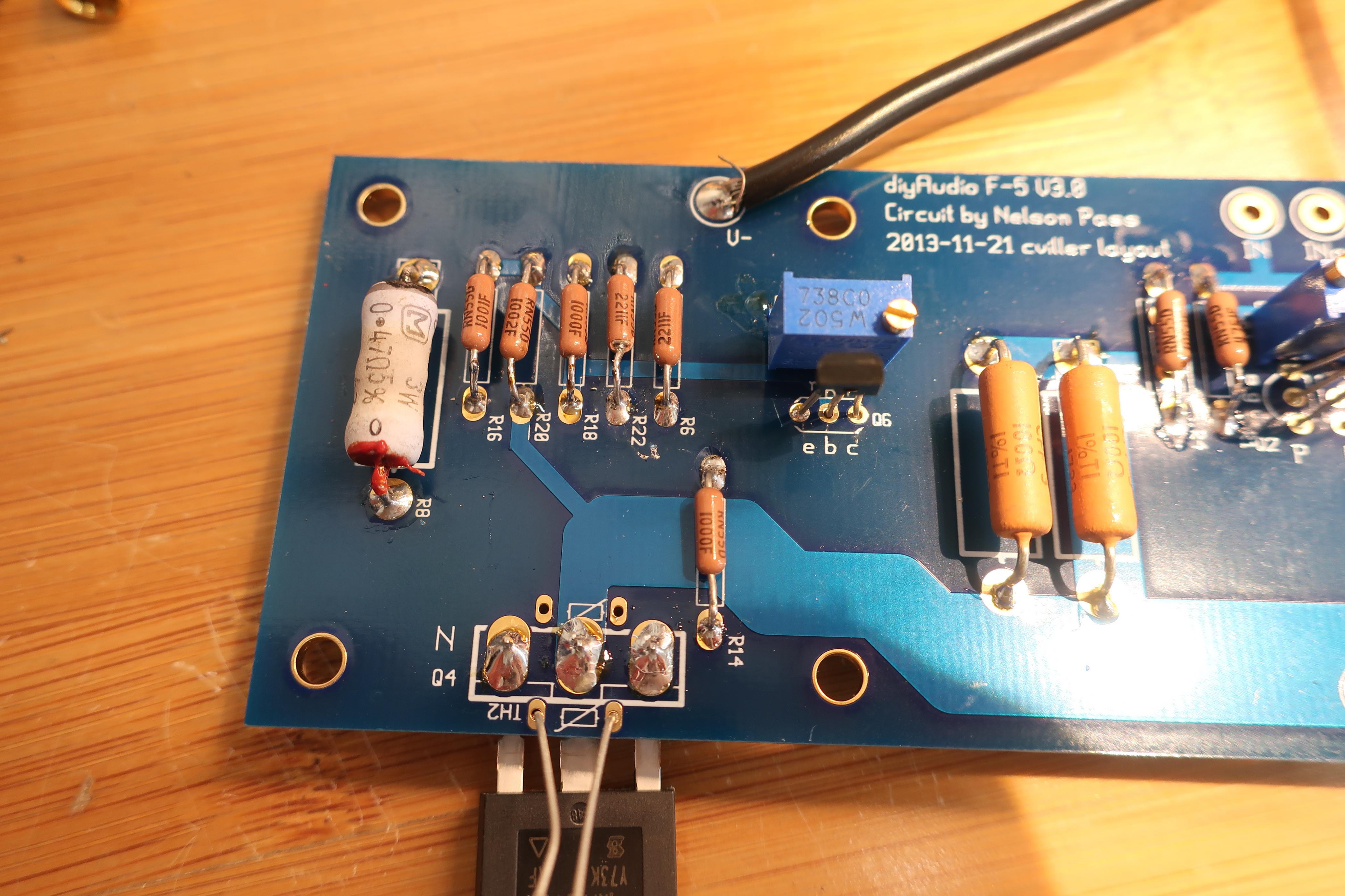

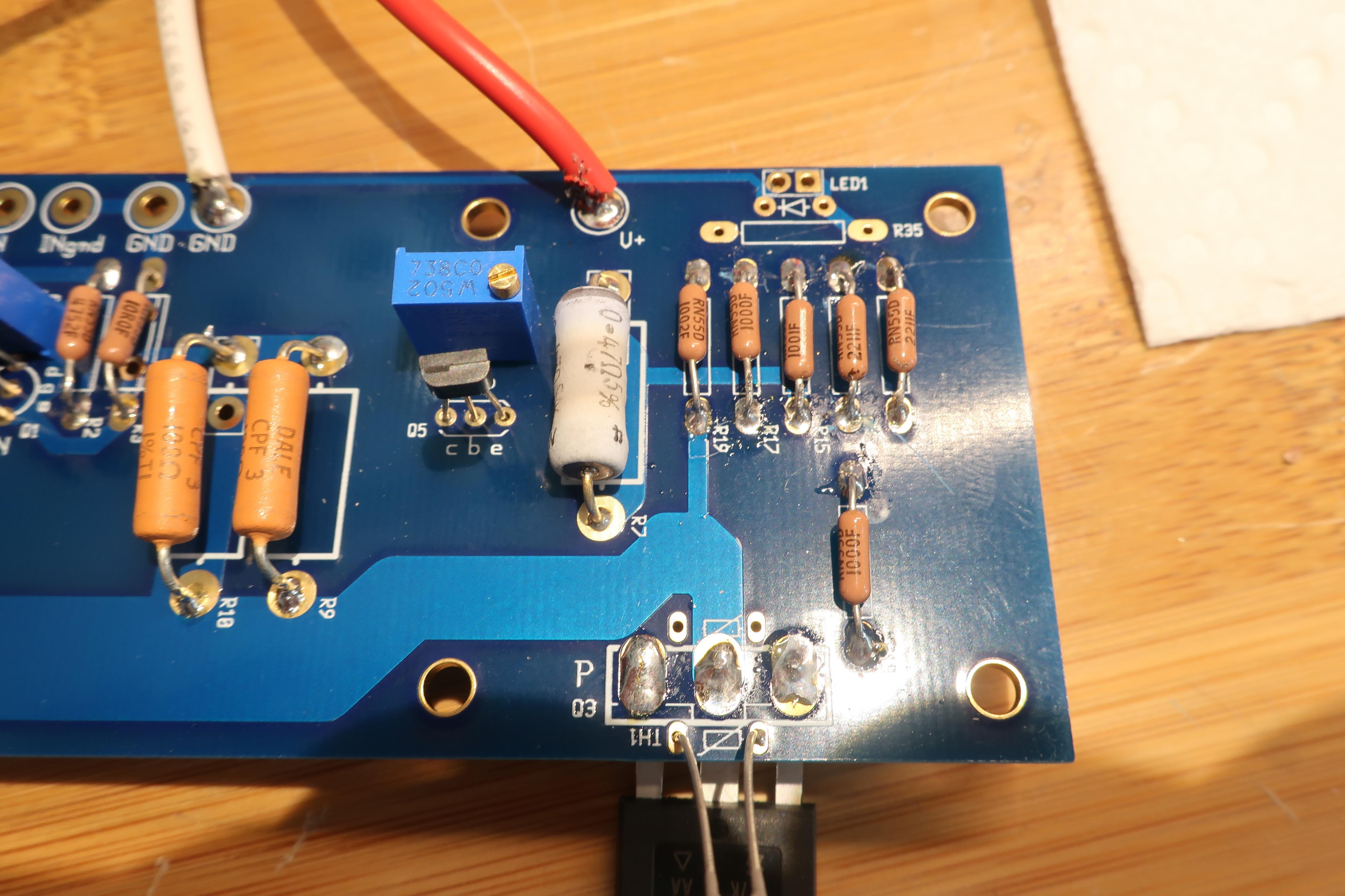

I can't figure out what I did wrong with mine. When I fire it up I'm getting 4.5v+ on one resistor and 4.5v- on the other. I shut it down instantly but I did get a bit of resistor smoke. I double checked all the part values against the schematic and the updated build guide and set the trimpots at zero.
Can anyone see what I'm missing here?

When I fire it up I'm getting 4.5v+ on one resistor and 4.5v- on the other. and set the trimpots at zero.
Maybe the trim pots are all the way up, instead of all the way down.
Try setting them to halfway instead, but check those resistors first.
didn't you , by chance , set trimpots to wrong zero?

You used heatsink when you powered it, right?I can't figure out what I did wrong with mine. When I fire it up I'm getting 4.5v+ on one resistor and 4.5v- on the other. I shut it down instantly but I did get a bit of resistor smoke. I double checked all the part values against the schematic and the updated build guide and set the trimpots at zero.

The trimpots are measuring 60 ohms with them in the board.
I did have it on a heatsink when I powered it up. I took it off and put my M2 boards back on when it didn't work.
From the build guide.
''Turn all variable resistors, P1 and P2 (total of four variable resistors for a stereo
setup) fully counter-clockwise. This can be verified by measuring the resistance
between the outer leads of the variable resistors and it must read zero Ohms. This
ensures that the bias is low, if not close to zero, once we power up the amplifiers.''
Ignore clockwise or counter clockwise. (As previously mentioned) Measure resistance across R5 and R6, and twist pots so that resistance is minimum.
clockwise did the trick with the resistance.
