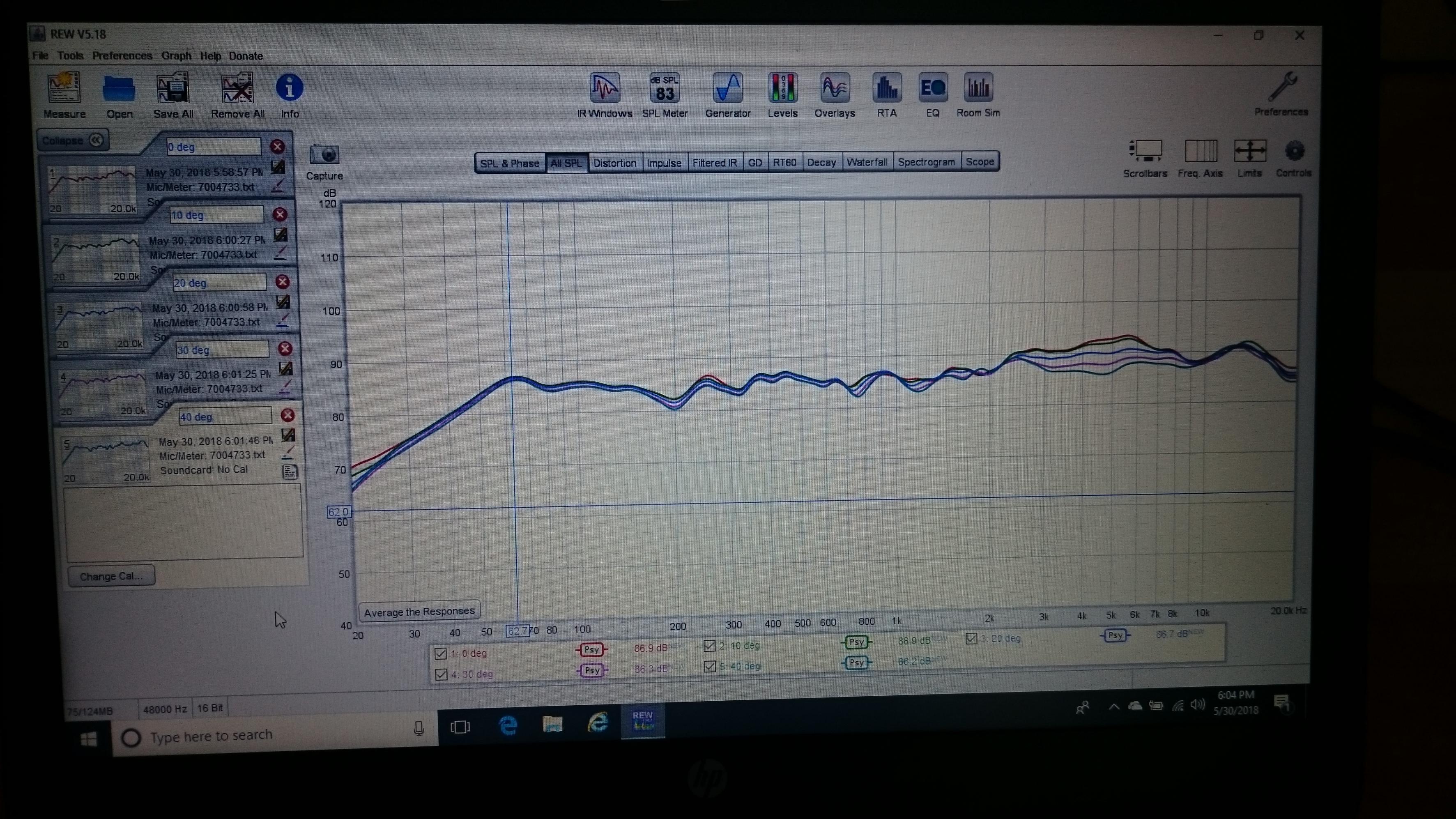

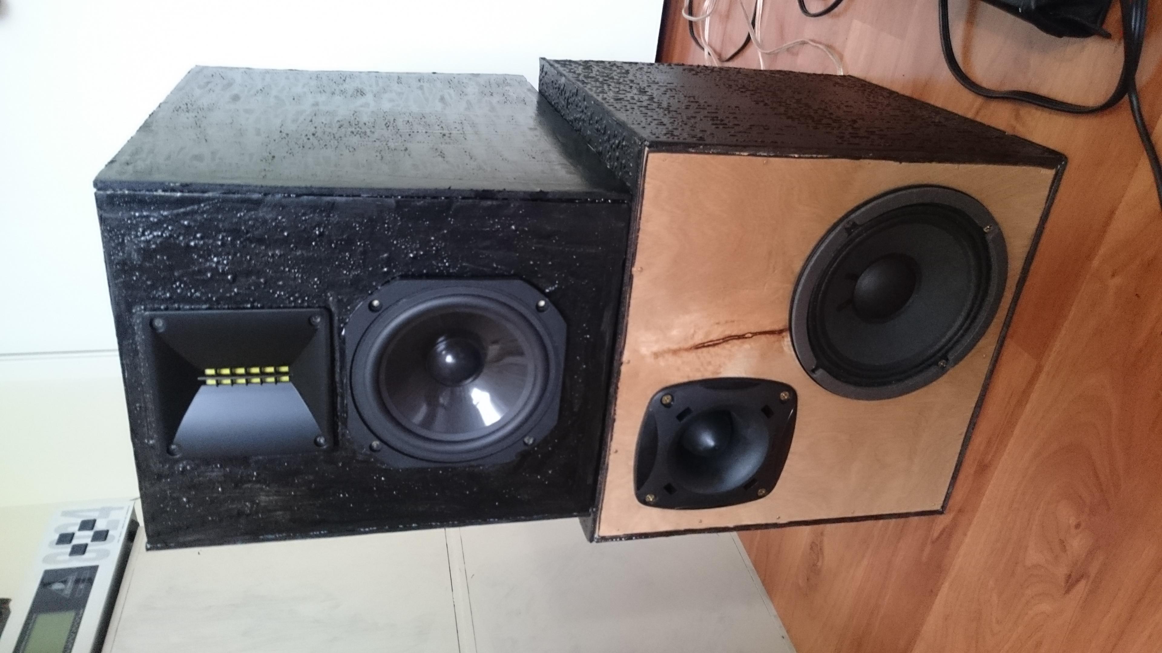

Last few days i optimized crossoved for little bookshelf, AC130 with Benton planar. I will post fr sweep, pretty amazing.
Here is little bookshelf i was having fun with, still work in progress, but already amazing.
And the fr response, on axis and each ten degree to 40...not perfect i know, just that last region, but still pretty impressive.
Sorry about sideways picture...
