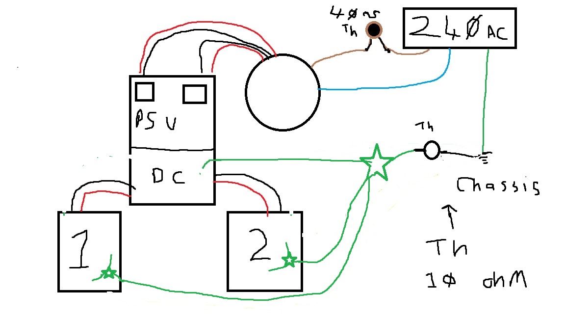

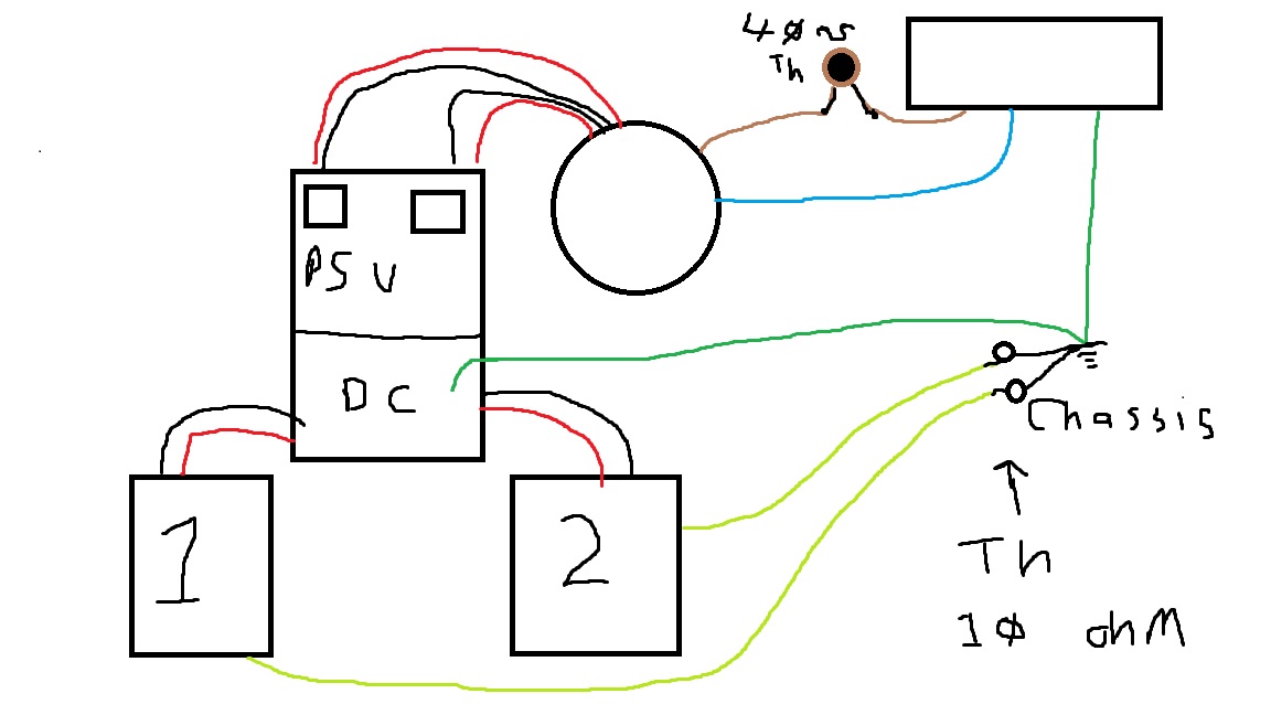

I can hear a very slight hum if i put my ear to my speaker cone. It does not get louder with volume +.
I have 2 channels in 3u chassis 625va 16.5A dual 18v.
I took it as granted i would have some hum.
what do you think. I dont want to break it (just yet). Should i saw chassis in half and make mono or basically is my wiring rubbish .
i will of course look into it.
thank you.
