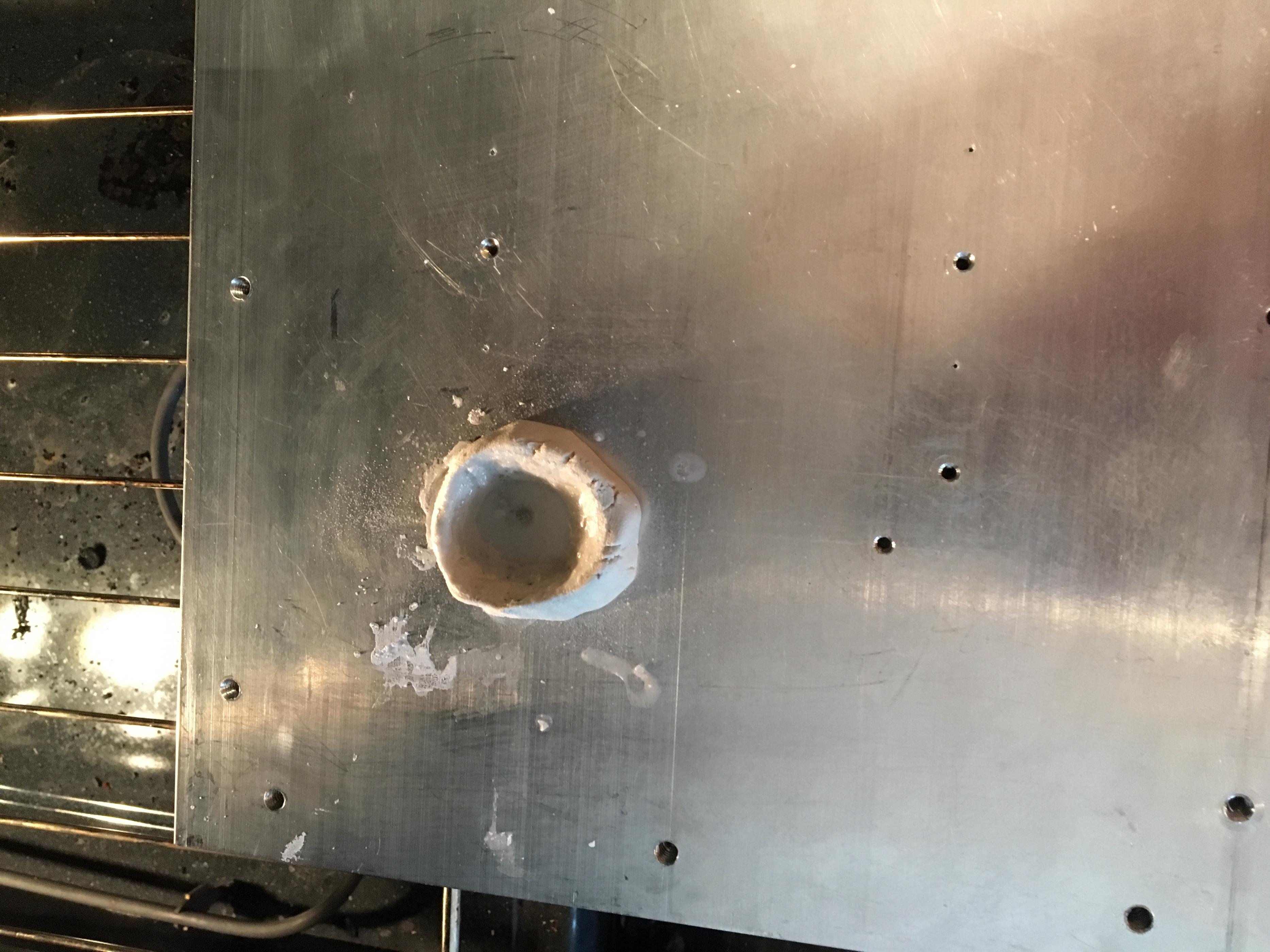

Edit: On an unrelated note, attaching a picture of what happens when you by cheap taps and try to tap heat sinks... :rolleyes:
Boiling out the broken tap with Alum solution... Sorry honey. :D
Did you use oil on the tap and back it out as soon as there was any resistance? I bet you didn't... :) :) :)
