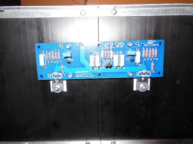

I am biasing up my BA3 FE and I am getting some measurements wrong.
I have about .75V on each mosfet.
I get no voltage reading across the 2 legs of R12.
I have an elma silmic on the C3 position but still I get DC offset on the output if I play with P1 and P2.
I don't have the electrolytic capacitors installed in the C1 and C2 positions as I have the regulator very close to the circuit, could this be the problem?
Should I jumper the capacitor pins?
Here is a pic:
Here is a pic:
Here is a pic:
Those capacitors have nothing to do with the PSU - they are part of the bias circuit.
Install the capacitors.
