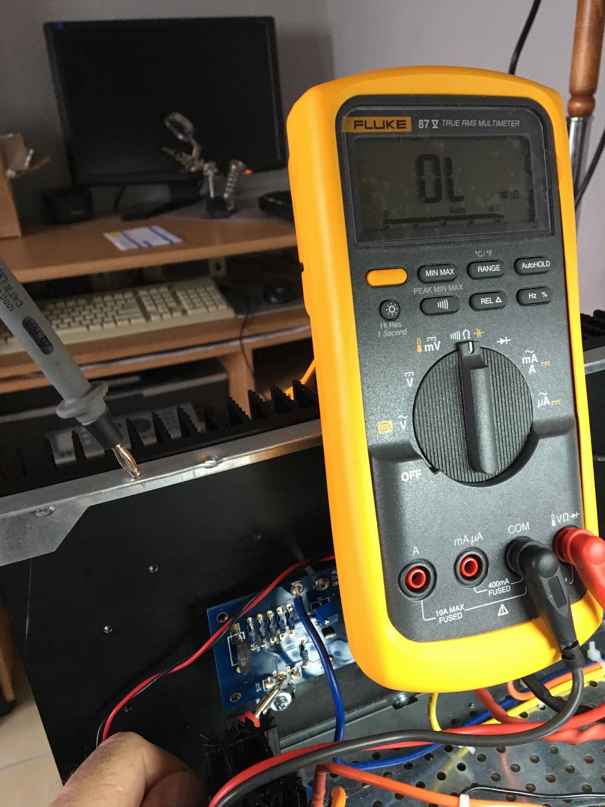

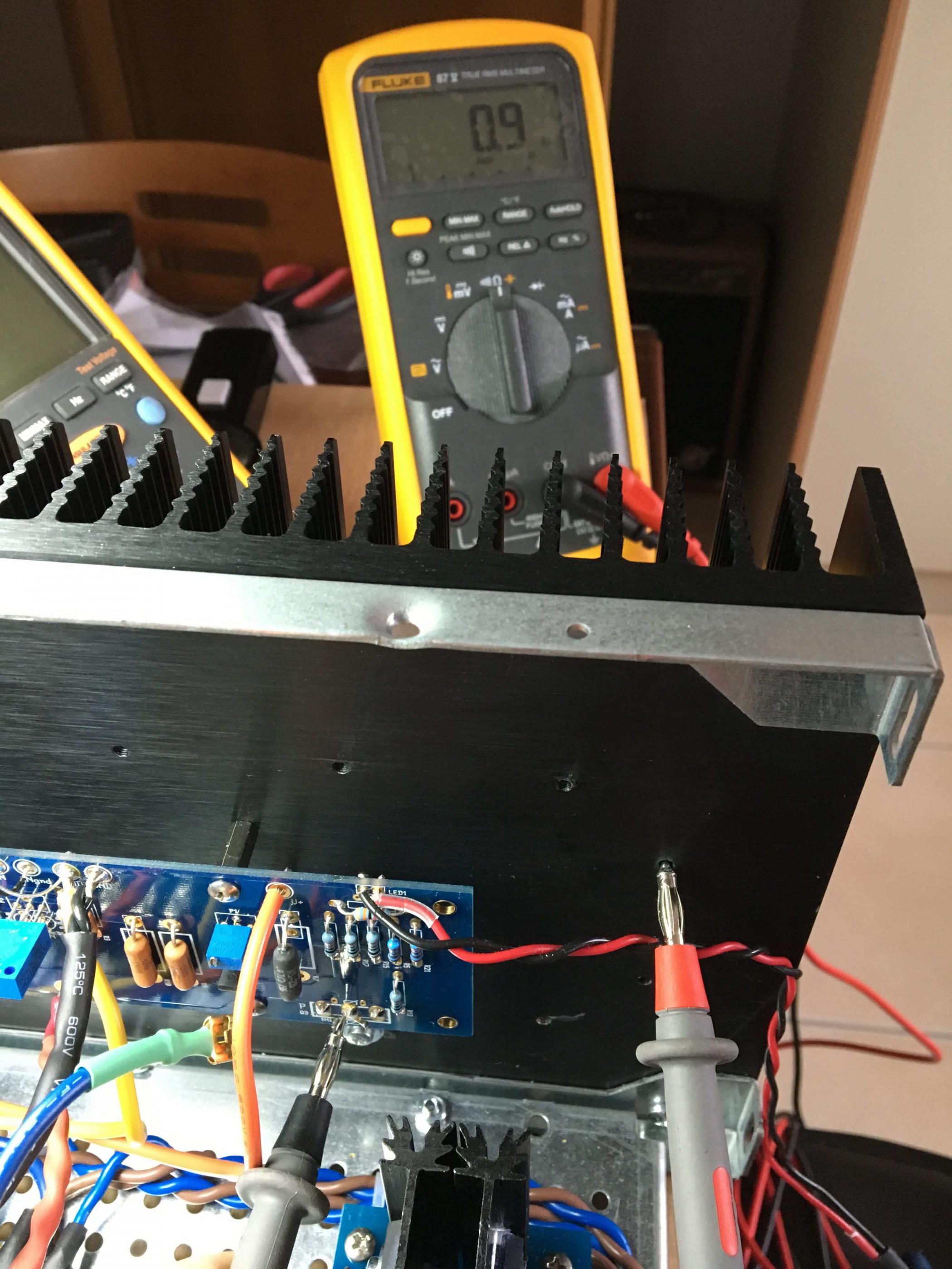

Just checked the drains (mid pin and front metal tab at lateral notches ) to case continuity and ... to my surprise left channel (-the faulty one) seems OK (i.e. infinite MΩ) while right channel is in contact (see photos).
As to the torque, I checked tightness - it seems tight enough and I don't want to overdo it. I loosened the torque and checked continuity again - nothing changed. I'll have to undo the mosfets and check mica and double layer of thermal coating underneath.
Any more suggestions?
