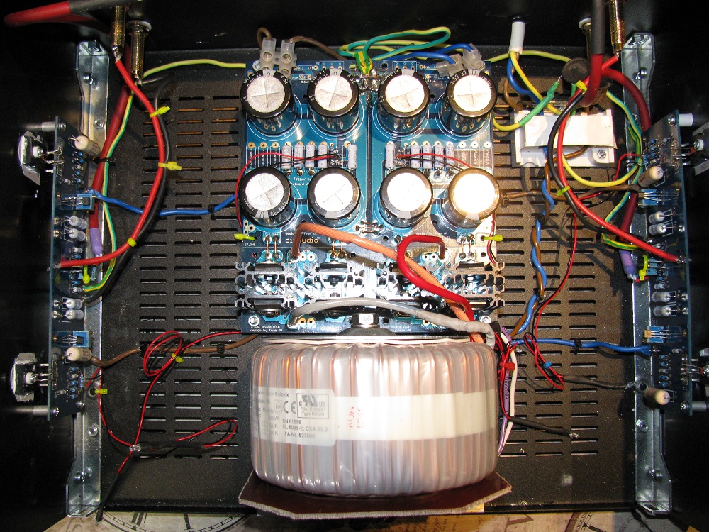

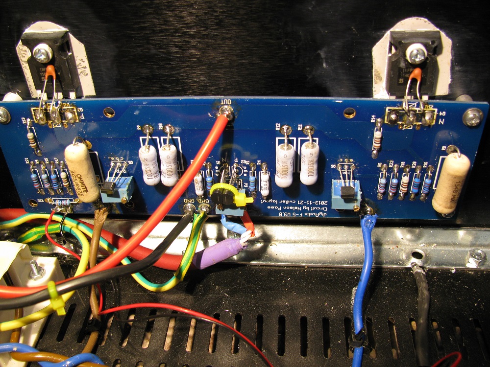

I got both sides running and biased to .6v all temps fine everything stable.
Let it soak test for several hours with the lid on all fine.
I connected interconnects to the pre-amp which had been measured and tested into my existing valve amp.
Switched on and the magic smoke escaped from one channel!
Bias voltage went high.
The 0.47 bias resistors got hot and on a quick look the mosfets at least look fried.
Back to the bench and the other channel tests fine and is still stable.
Any clues to look at when I have the board repaired?

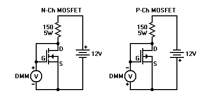

More on mounting torque
The maximum torque is determined by the device's package. You can look it up in the datasheet, as in the one linked below:
http://www.vishay.com/docs/91210/91210.pdf
In the grid labeled ABSOLUTE MAXIMUM RATINGS, look at mounting torque. I use a torque driver adjusted for 8 lbf-inch.
A while back I was asked, through private messages, about mounting torque and decided to conduct some experiments. For those who do not have a torque driver and torque analyzer, I suggest the following:
1) Mount the MOSFET and all associated hardware on the heat sink without tightening the screw
2) Looking from the side, tighten the screw until no gap is visible between the involved parts: screw, washer, MOSFET, insulator, heat sink
3) After making all parts snug, looking from the top, turn the screw an additional 1/5 of a turn

OK still a problem here.
Replaced all the semiconducters on the board with new.
No resistors looked burnt so did not lift them to check.
Powered up (with bulb) and adjusted bias as usual.
Only seeing voltage rise across one 0.47 resistor (N side mosfet)
and all 4 100r 3w resistors are getting hot.
Suggestions welcome, but looks like a complete strip next time.

Hi again
Thanks for being patient with me.
Some more testing this morning and all resistors seem ok.
Power on with bulb tester (5K pots measured and checked at zero.)
Across R15 324mv (P)
Across R16 0.0mv (N)
Offset 20v (yes 20v!)
R9,10,11,12 getting hot.
All semiconductors replaced with new yesterday.
This board was working well until I connected it to pre-amp. (not connected now.
Mosfets were from digikey.

Thanks for the comments.
I have music
I will let it settle and listen for a while.
Could you let me know what was the problem, the solution and what checks you carried out? Mine seems similar to yours (i.e. high current which blew out R7, R8 and R13 - post #864).
First problem after connecting pre-amp was blown Mosfets and jfets.
All semi-conductors replaced.
Rebuilt and got voltages posted above. (with bulb tester connected)
I lifted all the resistors and checked them, all were ok.
Semi-conductors lifted again, checked and replaced carefully checking against circuit.
P1 & P2 replaced, then zeroed across R5 & 6, not just separately.
Back on bulb tester, then without, and voltages came up fine, soak tested at full power for several hours and all fine.
Not wanting to risk the preamp again I substituted a quick and dirty passive 10K pot.
Sounds very good to me now.
In short multiple checking that semis are in the correct orientation with P & N correct and pin outs correct.
