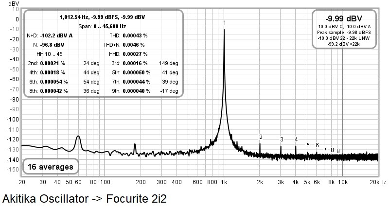

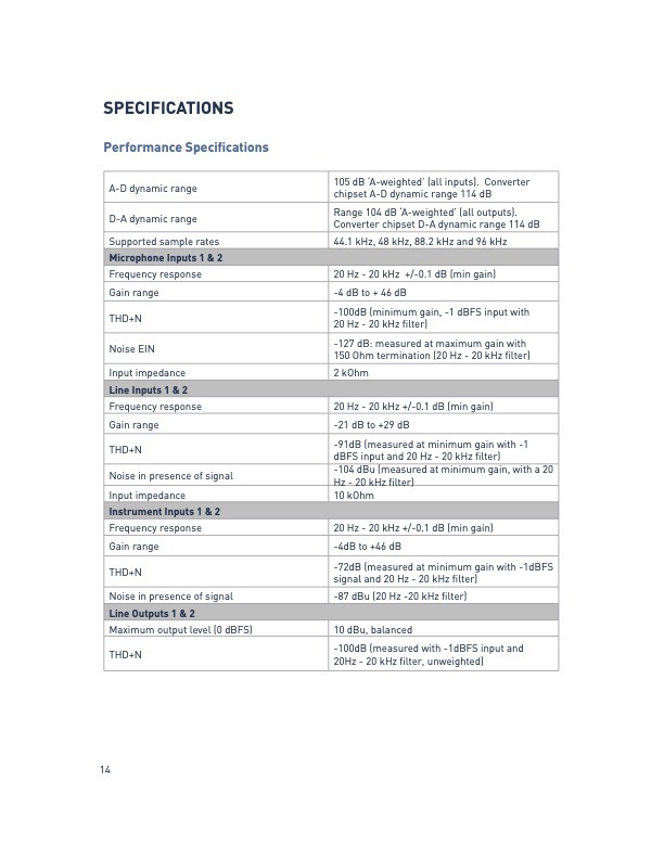

BTW, I sent my Oscillator back to Dan at Akitika for testing. Should be interesting.
Got my Oscillator back from Dan and everything tested within spec.
The loop back FFT looks good, so the Focusrite/REW setup seems good.
Turn off the REW Signal Generator and send the oscillator output to the Focusrite and see if the measurement is better today.

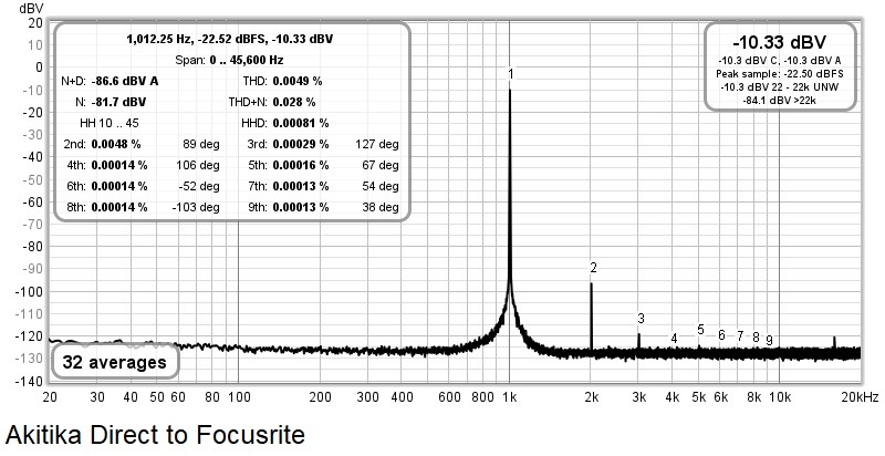

On December 3, I measured the Oscillator direct to the Focusrite and got this graph and THD measurement:

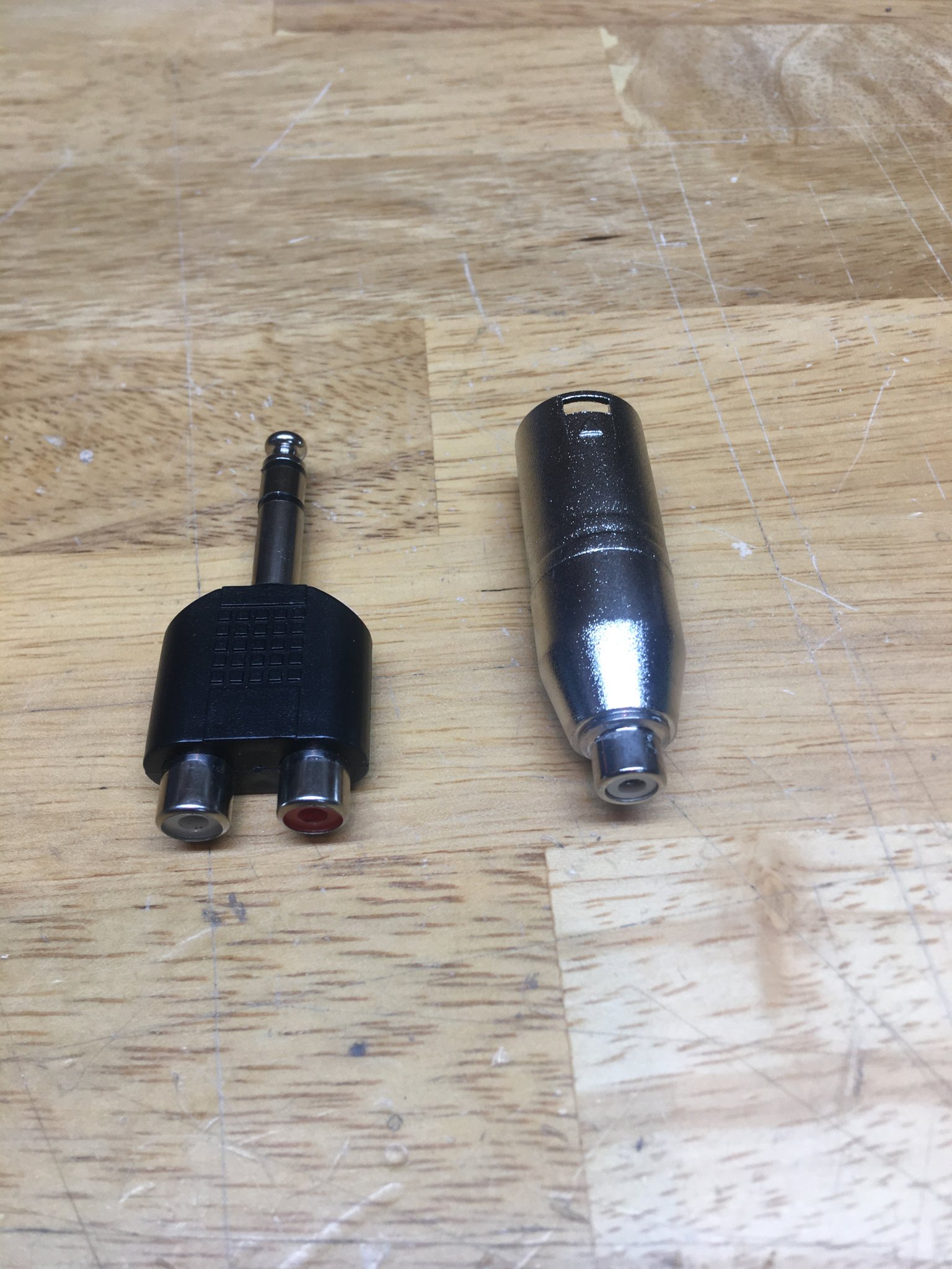

Today I made the same measurement (Oscillator direct to the Focusrite) changing only the adapter feeding the Focusrite:
The adapter on the left (TRS to RCA) was used for the Dec. 3 measurement. The adapter on the right (XLR to RCA) for the measurement today.
Why the huge difference?
Joined 2007
Shorting the other input doesn’t do much.
Keeping everything the same and just switching adapters, the TRS/RCA measures 20dB less than the XLR/RCA on the fundamental.
I suppose you could move the cable to the other side of the adapter and short the unused RCA and see what happens. But in the end you now know what to do - use the XLR connector. :)
I've got an idea of what causes the differences between the two adapters. The front panel combo plug, XLR/TRS, is used as "Microphone" input when TRS is used, and "Line" input when XLR is used. Microphone having a 2K impedance and Line having 10K impedance.
Reactions: 2 users
Joined 2012
Great researching. The microphone input (XLR) has the best specifications (noise and THD) and the instrument/line input (TRS) has the worst specifications.
So the XLR input is the one to use.

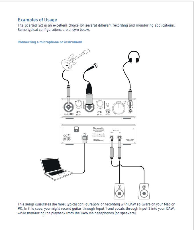

From the Focusrite 2i2 user guide (my 2i2 is a Gen 2):
