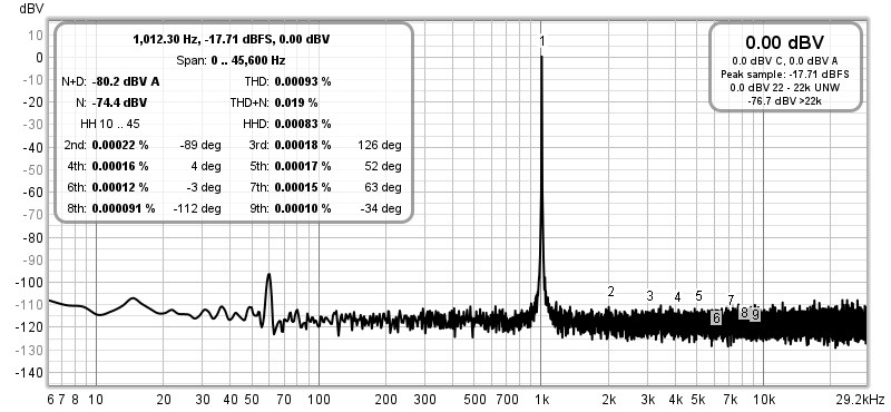

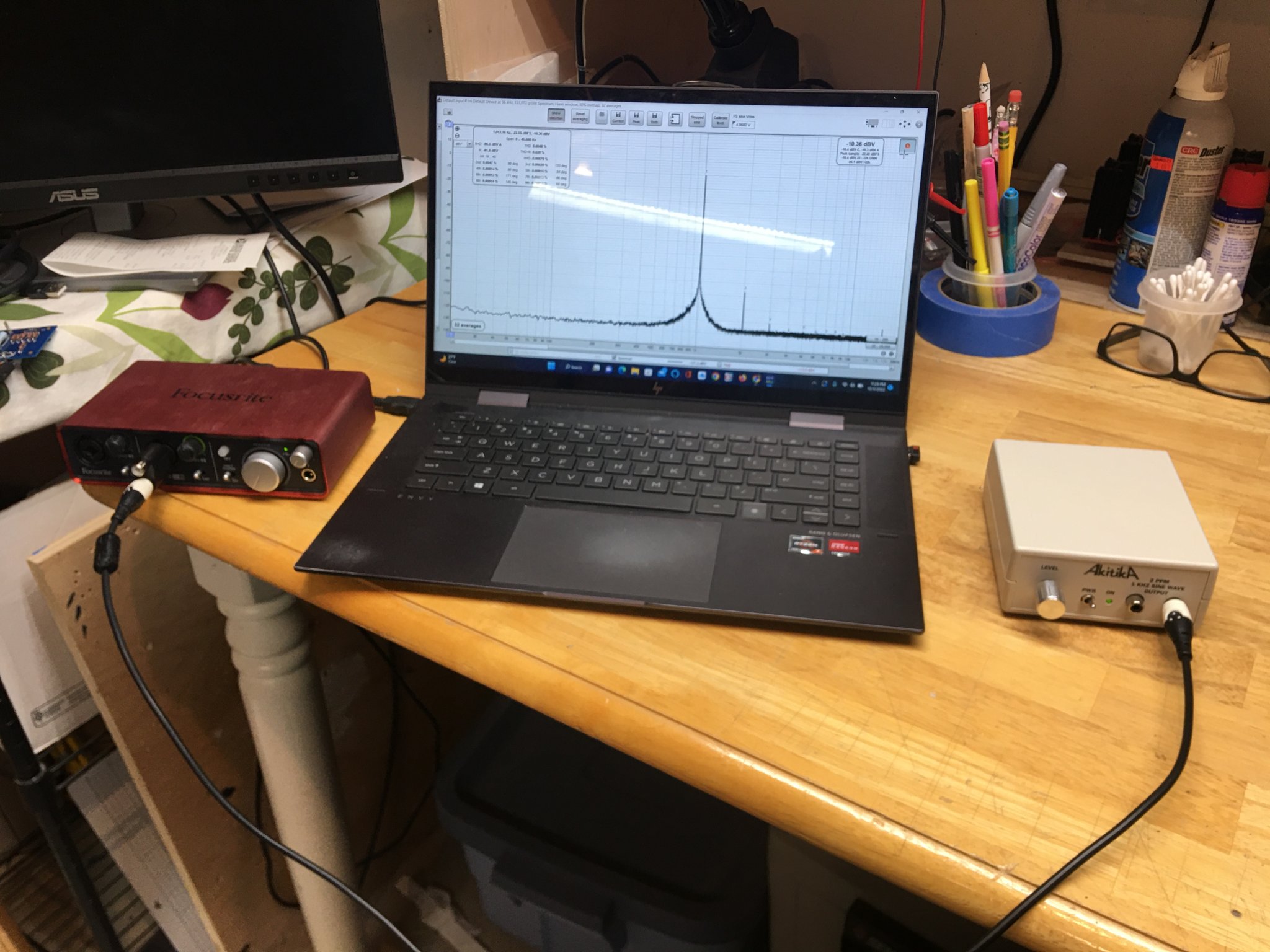

I suggest simplifying the arrangement - from dummy load to autoranger to Focusrite to computer.
Test both the amp board and oscillator with only the autoranger and Focusrite to computer.
Also test the oscillator direct to Focusrite as you can adjust the oscillator output so that you don't overload the Focusrite.
The Focusrite is supposed to be at its lowest distortion when its input level adjustment is at about 11 o'clock.
Sounds like a plan. I just need a longer BNC cable, or I need to rearrange all my stuff (which will be some work).

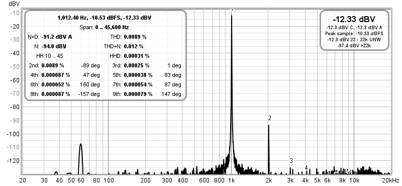

That's a lot better, much closer to 0.0002%.

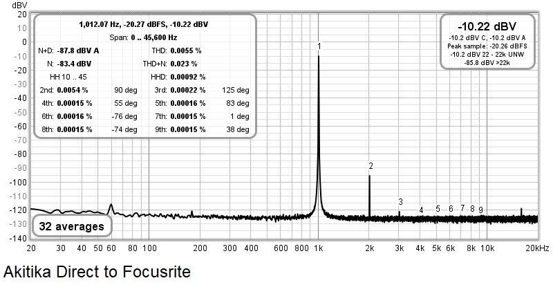

Try it with the Oscillator directly into the Focusrite, and adjust the level at the Oscillator, and set the Focusrite input at about 11 o'clock. You don't need to have the level at 0dB, which may increase the distortion as it may overload the Focusrite. I usually have the level at -10dB or lower.

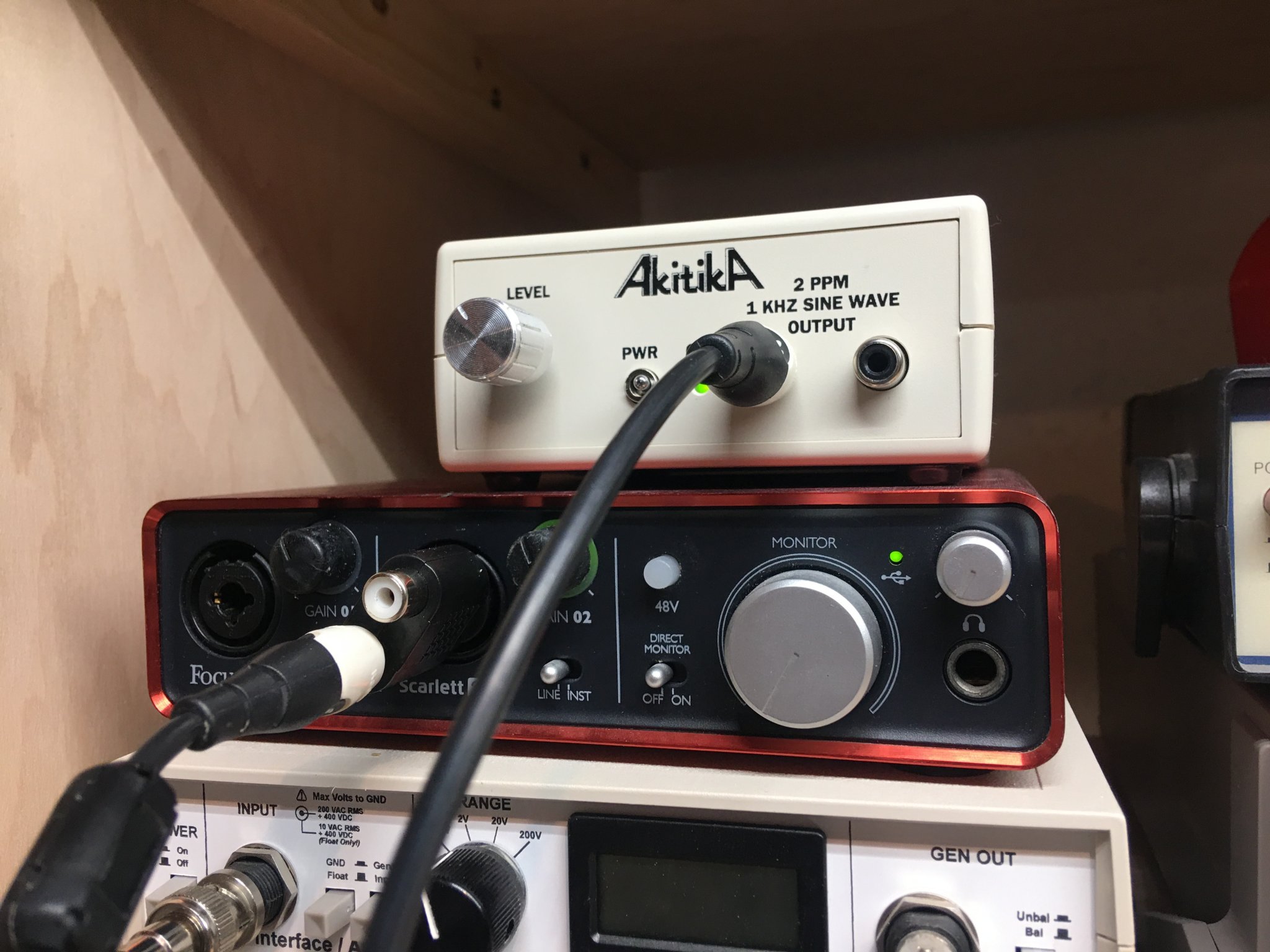

Akitika Oscillator connected directly to Focusrite Scarlett 2I2. Gain on Focusrite at 11 o'clock.That's a lot better, much closer to 0.0002%.

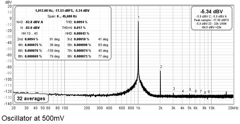

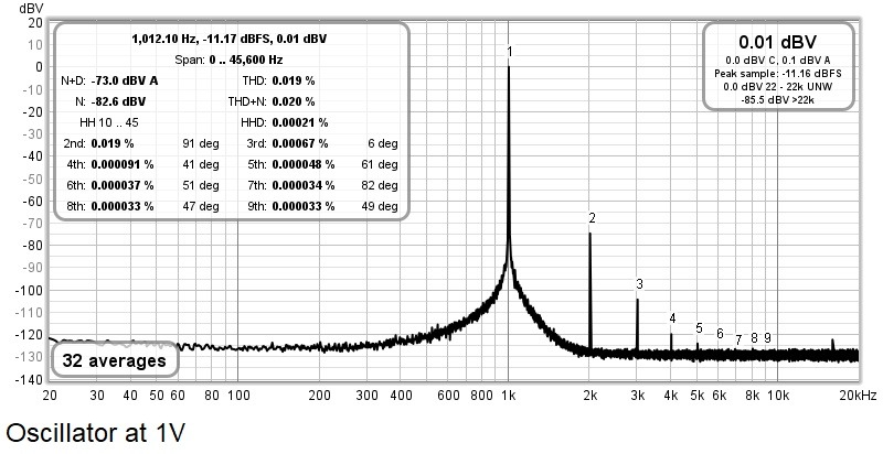

That's a lot worse. Try changing things. Instead of stacking the oscillator on top of the Focusrite, separate the two. The oscillator may be affected by magnetic fields. Try moving both the oscillator and Focusrite around and see if that changes the distortion level.Akitika Oscillator connected directly to Focusrite Scarlett 2I2. Gain on Focusrite at 11 o'clock.

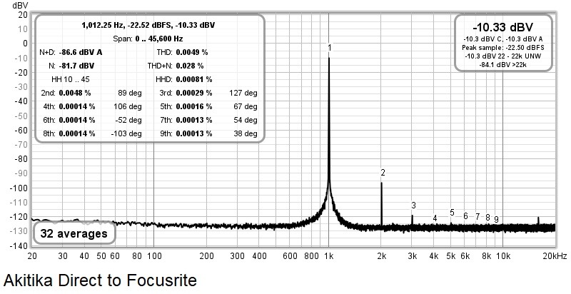

The 1V may be overloading the Focusrite a bit.
However the 500mV (-5.34dBV) showing higher distortion than the previous measurement at -10.33dBV does not seem like a good thing to me.
Can the setup and results of post #2164 be repeated? (Edit: Whoops, didn't read the previous post carefully).
I wonder whether something has changed with the oscillator?
Another thing to check is to go into REW's Preferences to see if the setup is still correct.
I measure the oscillator with a Keithley 2015 and nothing has changed.I wonder whether something has changed with the oscillator?

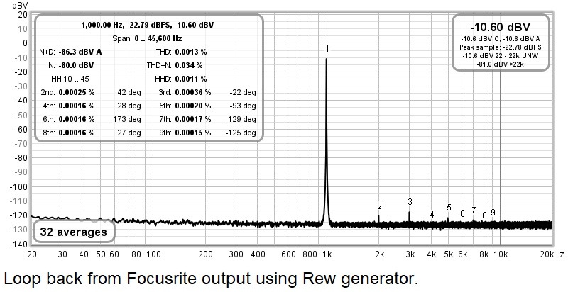

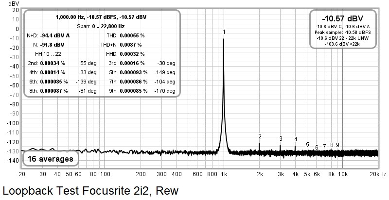

Distortion measures low...too low for the Keithley to even measure it.Meaning the distortion also measured high or the distortion measured low?
I can get the graph and THD measurements below making a loop back thru the Focusrite using REW.If there is nothing wrong with the oscillator, then your REW and Focusrite setup needs to be checked.
So what does that tell me? about Focusrite/REW setup? Oscillator?
