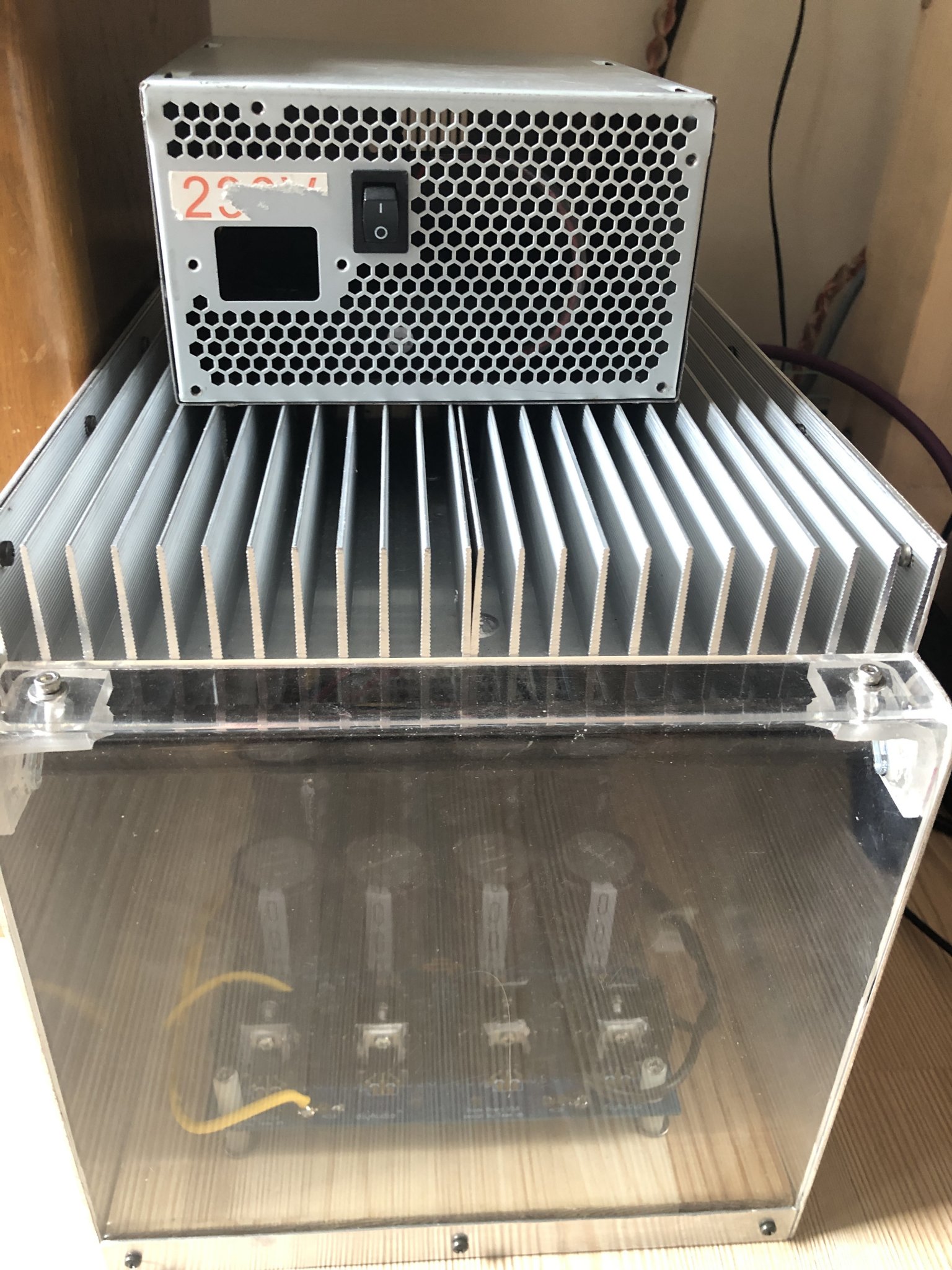

Heatsinks also reach 55-60 degrees C, so I use a small fan on top to keep it lower. I am attaching my design’s photo too so you could picture.

What design are you talking about? 'Surge protector' for voltage spikes or inrush current?
Sorry, I obviously confused inrush current with voltage spikes. (Sorry about my inadequate knowledge. I am in fact a retired professor of molecular biology with strong interest in audio electronics). So you recommend Cl-60 in series with my tranny primary. Certainly. Just that Cl60 is not easy to come by here, would NTC 10D-15 suffice?

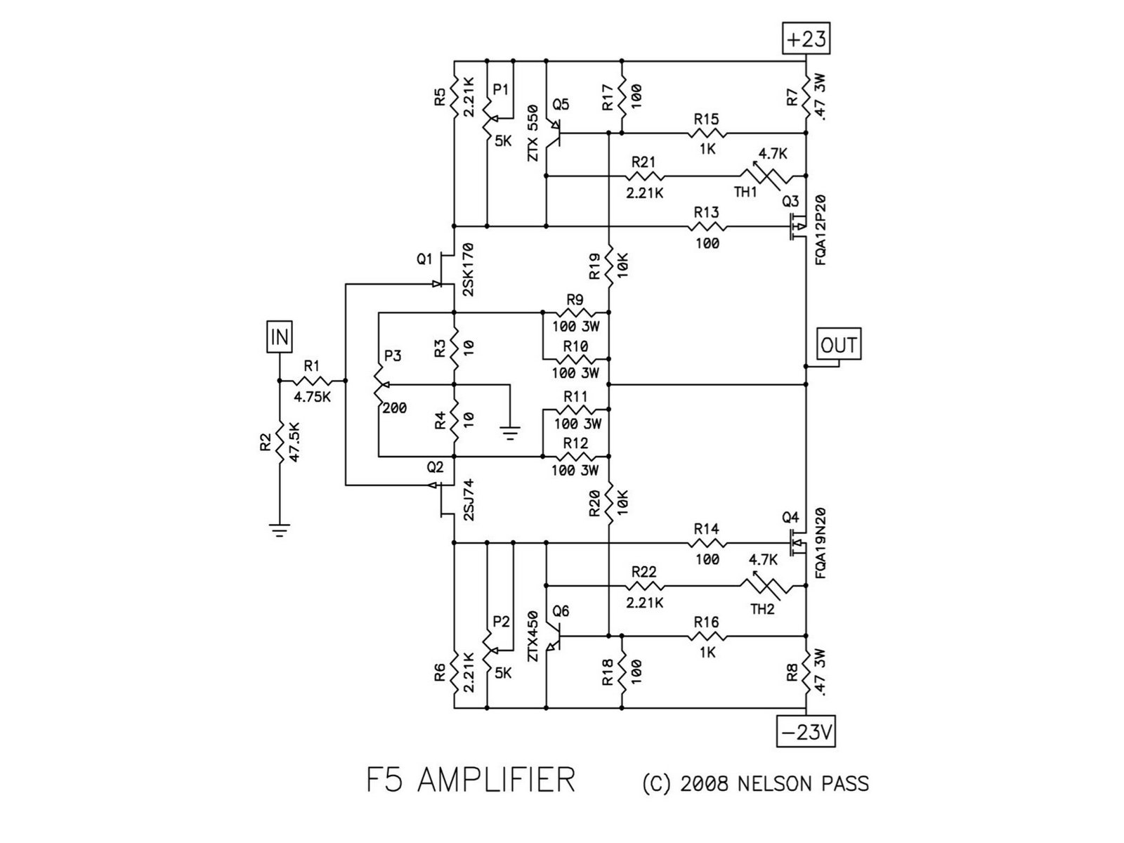

Dear Andy,
Thank you for your valuable opinion and for your suggestion!
It took me a bit longer to evaluate the second channel and to look back into the problem with the first one. However, I think that I found the problem.
With the second channel I was able to get 0.598 V and 0.602 V on MOSFET source resistors with 10mV bias offset. Which is, in principle, should be acceptable.
I then checked all the resistance values on the first channel, and find out that R2 is measured as appr. 15.8 kOhm on the board. I desoldered it, and it was all normal at 47.5 kOhm. I soldered it back in the board and checked resistance between several points on the board which having R2 involved - all gave non-correct values.
I started to suspect JFETs, I desoldered them and checked. I found that one of them is showing resistance between Gate and Source of 18.2 kOhm and 18.8kOhm depending on the polarity of probes.
I decided that it is a malfunction, which probably caused the uneven(unsymmetric) behavior of N and P parts of the circuit and lead to such a difference in currents. May be I handled it badly, or overheated while soldering...
I ordered new JFETs and will check the operation with them. They should arrive next week.
Maxim

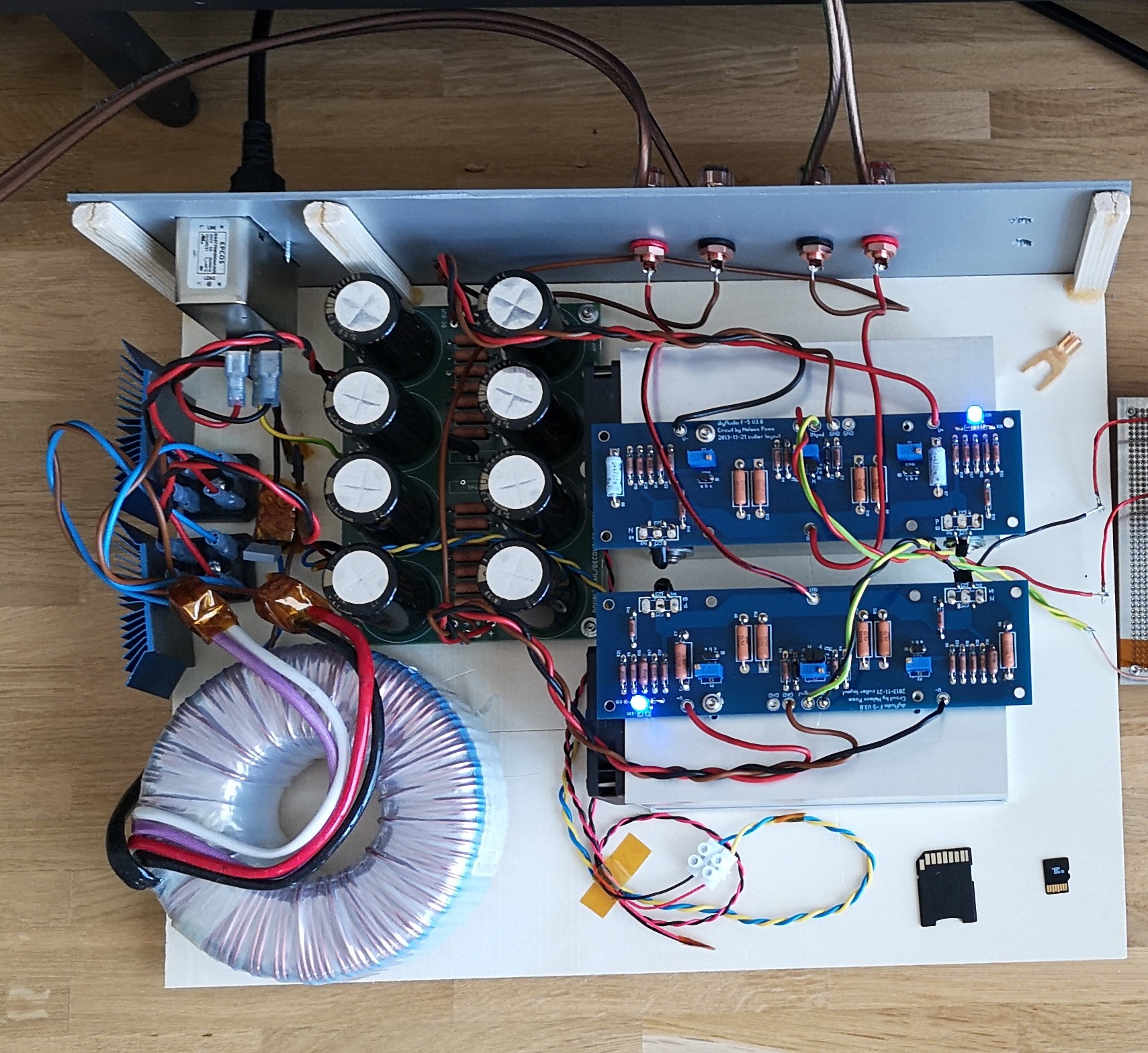

I just wanted to follow up on my issues with F5 build and to come to a certain logical conclusion :)
But first of all, I wish to thank to all participants of this thread. Reading it, in general, and receiving answers to my own questions, in particular, was very educative and very helpful!
It took quite some time for me to come back to my F5 build after I received new JFETs, but now the amplifier is up and running for nearly 2 weeks.
However, I still wish to comment on my troubles with different currents in MOSFETs in one channel. Replacing a pair of JFETs did not bring any measurable difference. I still had about 15% of current difference in N and P MOSFETs. Thus, as a last resort, I decided to replace R7 and R8 to the new ones. And this was it.
After patient adjustments I obtained ~0.61V across R7 and R8 with <2% difference between them and <5 mV offset at the output (Very similar to what I got previously in another channel). After that I decided to stop and listen to music :)
I am not sure yet about an enclosure, so my F5 is in transportable prototype mode. But it has no hum and sounds really great to me.
I use 400 VA transformer and my power supply with 8 x 10mF capacitors is based on Jeff Young boards design of Decoupled stereo PSU layout (I found Gerber files provided by Jeff on this forum). MOSFETs are mounted on heatsinks cooled by small fans.
My system at the moment is simple and straightforward. F5 is connected right to the output of my DAC (Pro-ject Audio DAC Box S2+, 2V output specified) using a 10-KOhm pot in between for volume control. My loudspeakers are DALI Oberon 5 with a nominal resistance of 6-Ohms and 88 dB sensitivity.
